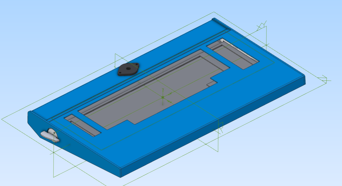

No problem! if anybody needs the measurements, or cad drawings of the cutouts for enter key mechanism - i can provide some. In the meantime, here is a case idea i had for the factory keyboard modules. Mostly to test out some ideas before building the fullsize version out of two keyboards.
TNT
09 Jul 2024, 00:07
Cool! What is the socket in the middle for?
browncow
09 Jul 2024, 08:19
TNT wrote: 09 Jul 2024, 00:07 Cool! What is the socket in the middle for?
to plug in the relay you can see in the video :)
