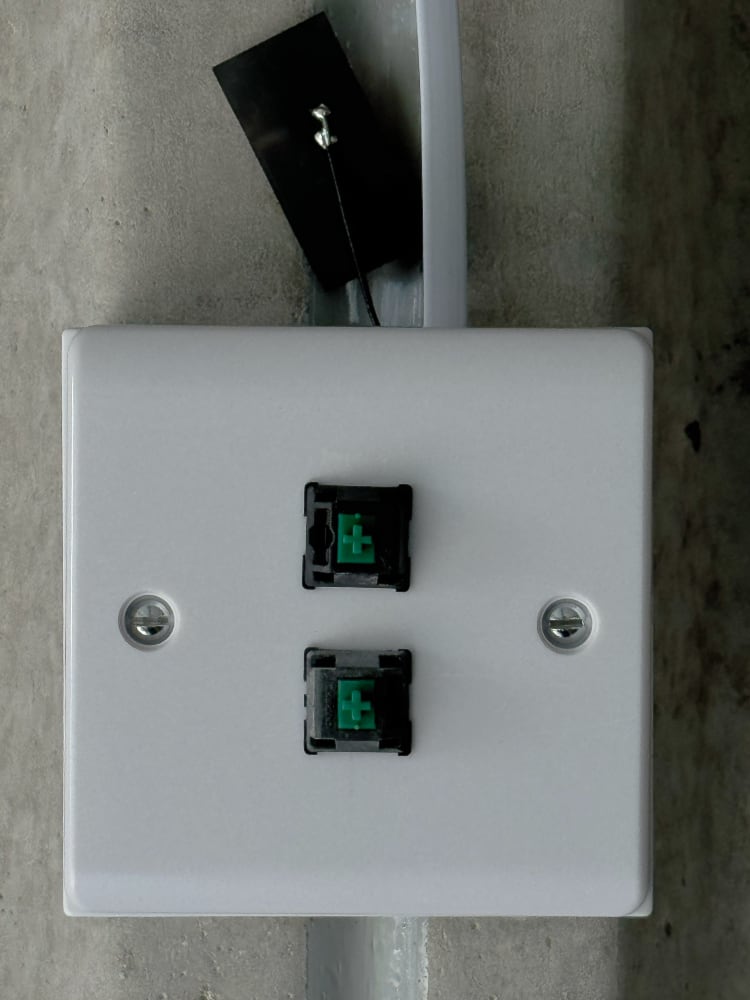

Yes, this opener is now powered by MX. These switches are much smaller, easy to install, pleasantly clicky, aren't fussy about concrete dust, and, of course, come with an unparalleled choice of caps:

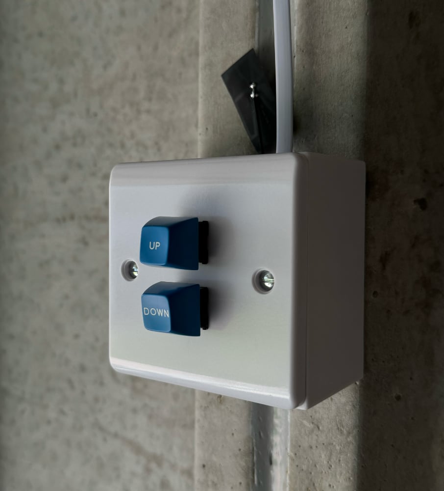

These look the best but I don't fancy yellowing and shining them unnecessarily:

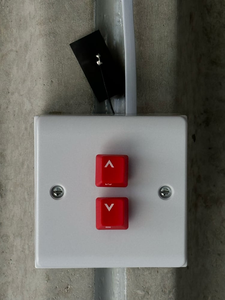

So he's actually wound up with those red keys, which were spares with my NovaTouch. I don't mind if they go a little grubby with use, and up on the wall they look pretty good.

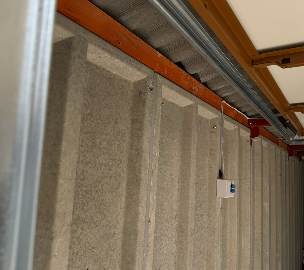

Now his garage is remote controllable via Siri shortcuts and anything else he cooks up to connect to it, reliably closes itself when it's windy, and has a reassuringly clicky wall panel.

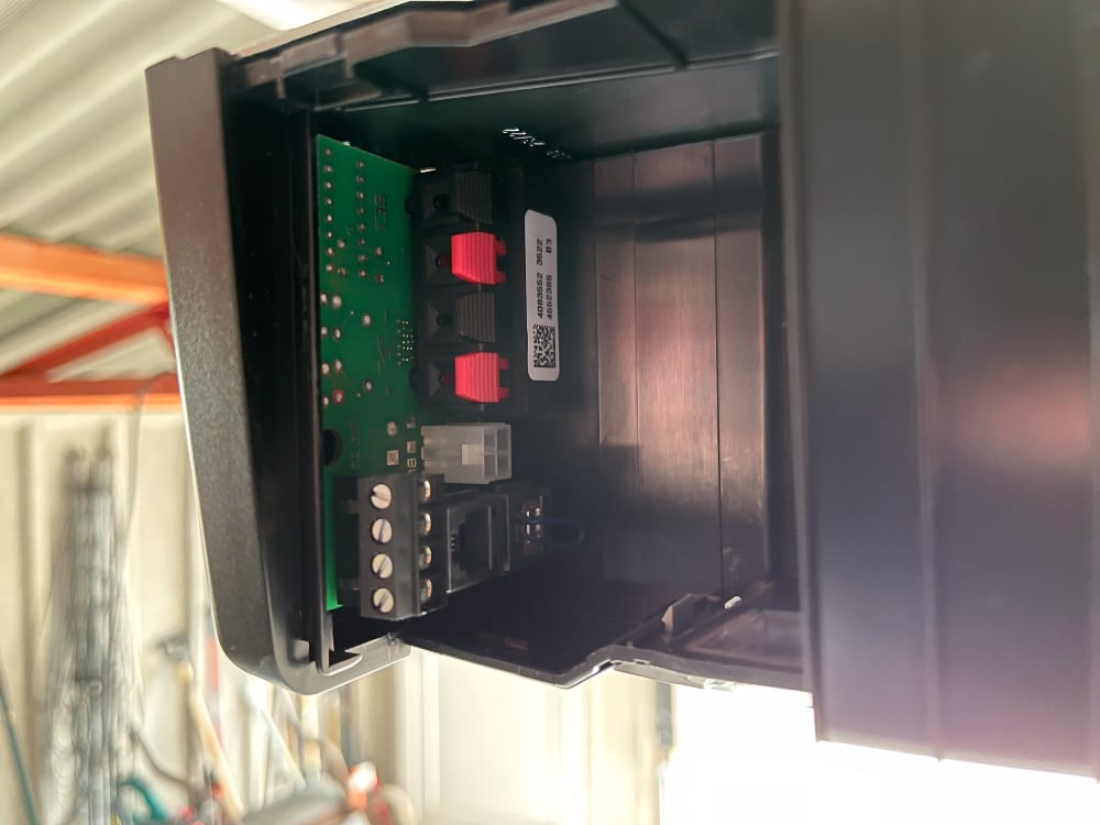

As soon as he showed me the lack of space inside the box, I knew this was the perfect job for MX. I let him choose between linear and clicky switches. MX Green it was. Reassuringly clicky. Their audible feedback comes a half second or so before the motor kicks in, removing much of the sense of delay.
Here's the motor overhead which this thing controls:
His description:
That’s the panel inside the door opener. The spare RJ12 socket there is an RS485 serial bus. I wired that up to an RS485 to UART adapter to the ESP32-C3.
Okay, so he put the switches in random orientation, but otherwise a pretty good first custom mechanical keyboard build. :ugeek:
