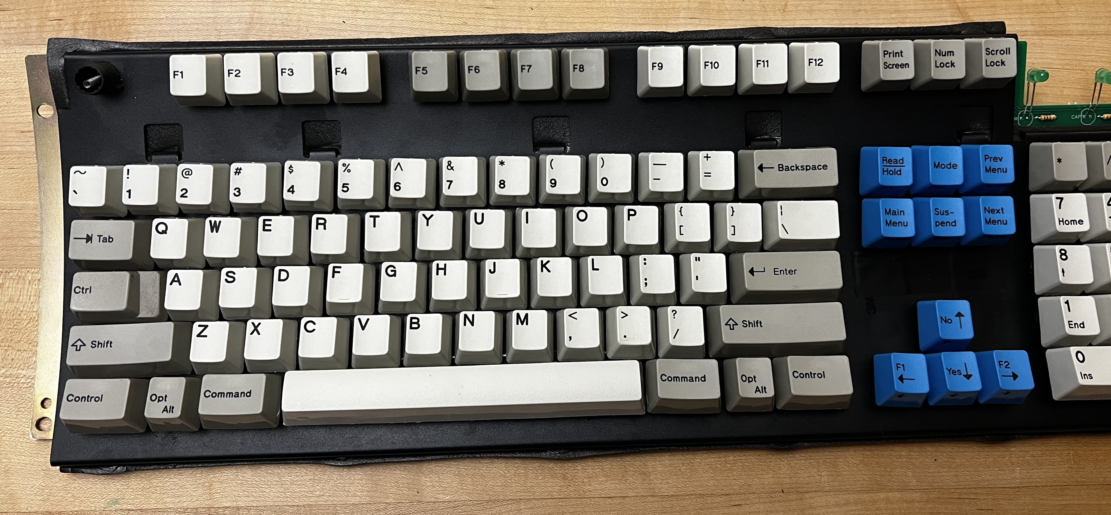

Okay, took some time to work on my keyboard and wanted to post another update with some photos - so I can get a little more time testing out the keys.
I'll start by saying that all of this is subjective at this point. I own umpteen Model Ms and four Model F ATs. I used two model Fs as daily drivers for a good ten or 15 years - one at the office and one at home on a mac. I will fully admit to being more than a little particular when it comes to keyboards.

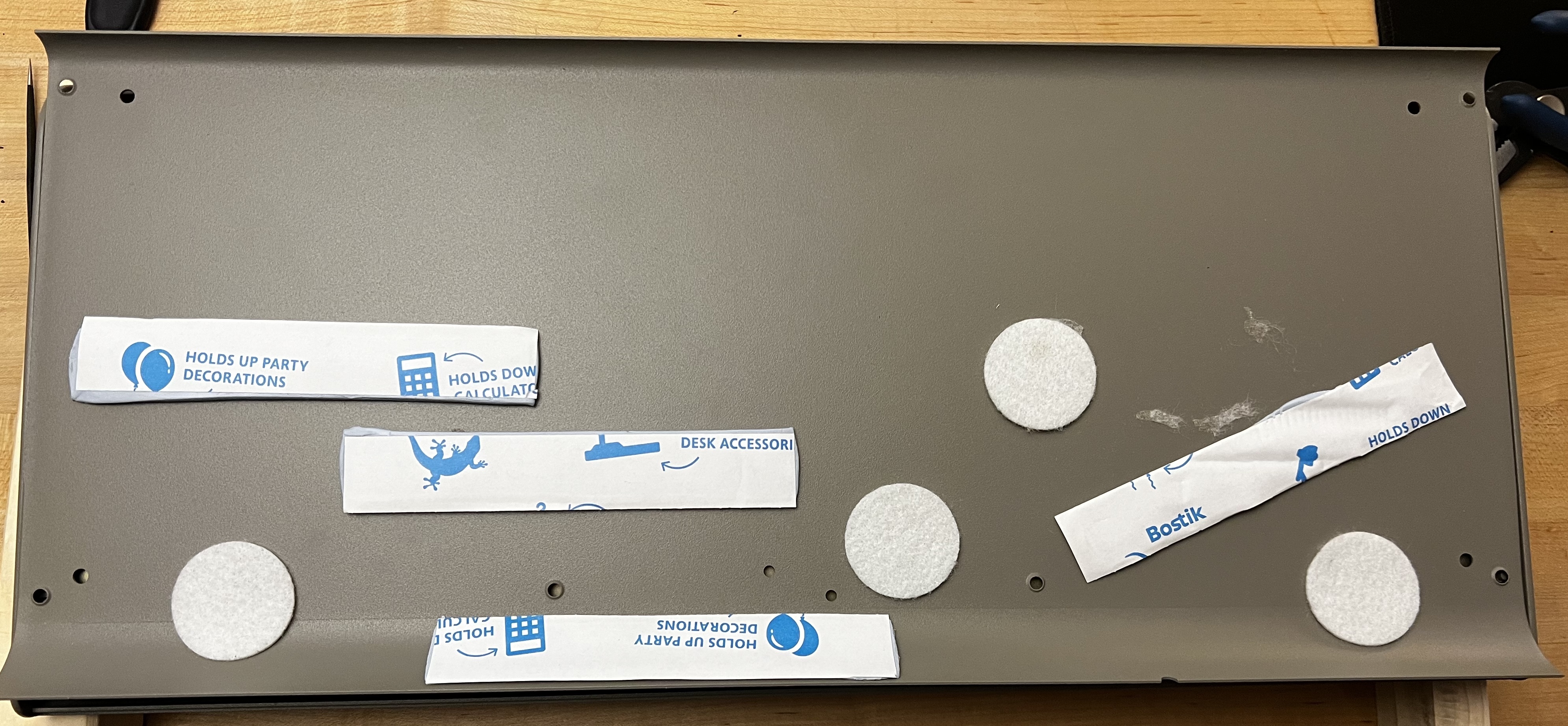

As I said in my earlier thread, I could hear the rear panel ringing a bit and added some blu-tack. Foam probably would have done, but why use foam when you can add even more mass? Really, it's just that is all I had at hand that would dampen anything. I tried a few felt stickies, but those didn't do enough. Here's what that looks like:
It sounds better than it looks. The panel produces a dead thud instead of a ringing.

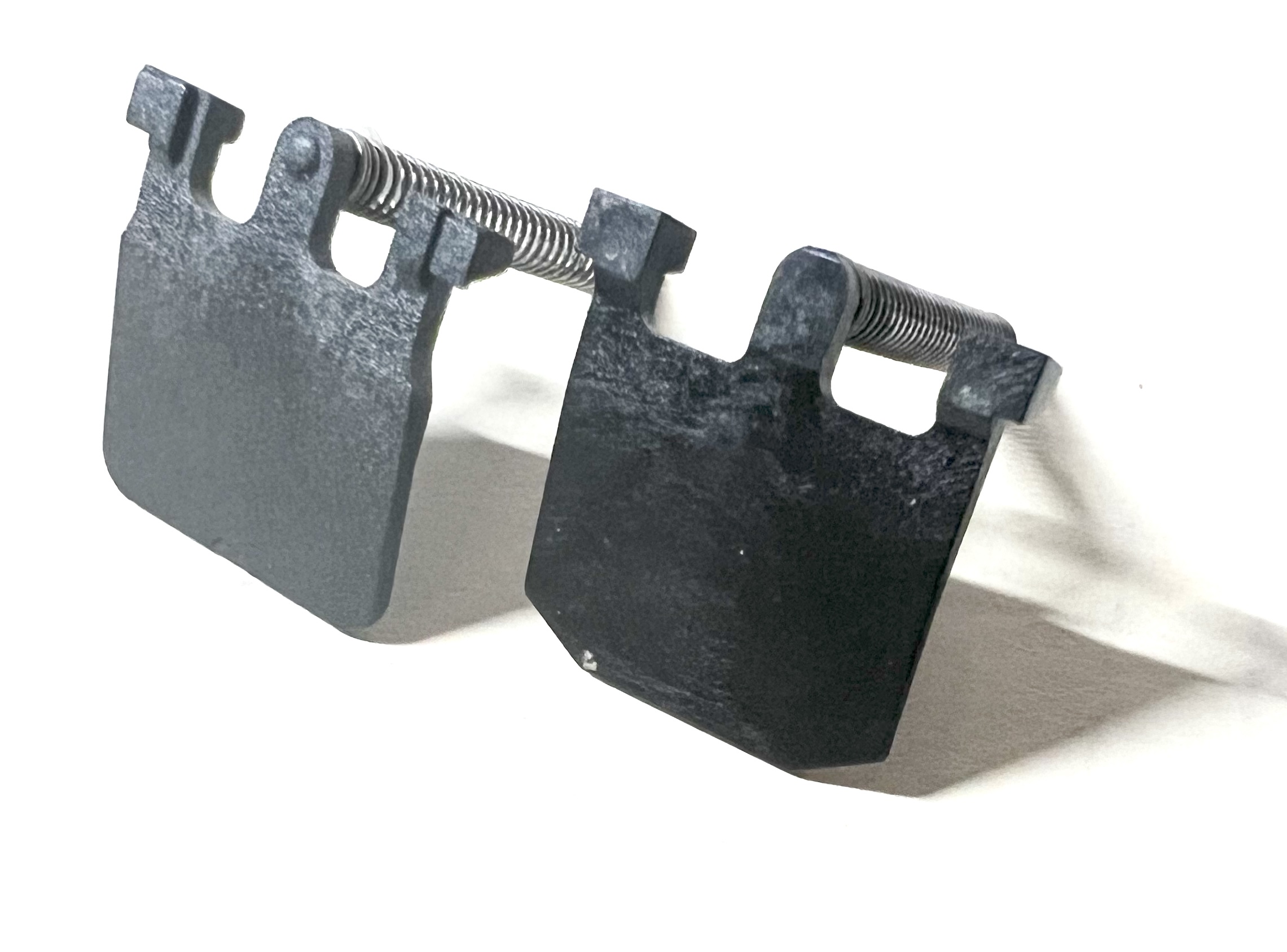

So, I decided to go a little more drastic. I wanted to see what the differences in the Model F AT and the Model F 104 were on the inside, so I took the panels off, exposing the barrels and flappers for both. I noticed that the barrels had no noticeable visual differences, but there was a difference in the flappers.
The 104 Flappers in both shots are left. I think the main difference that provides some acoustic impact is that the front-to-back depth of the pivots is just a tad bit shorter on the 104 than the AT. This means that there is just a tad more room for it to move around... but there could be anything else about those as well that are producing some acoustic difference.
No matter - I'm transplanting them to see what impact it has!

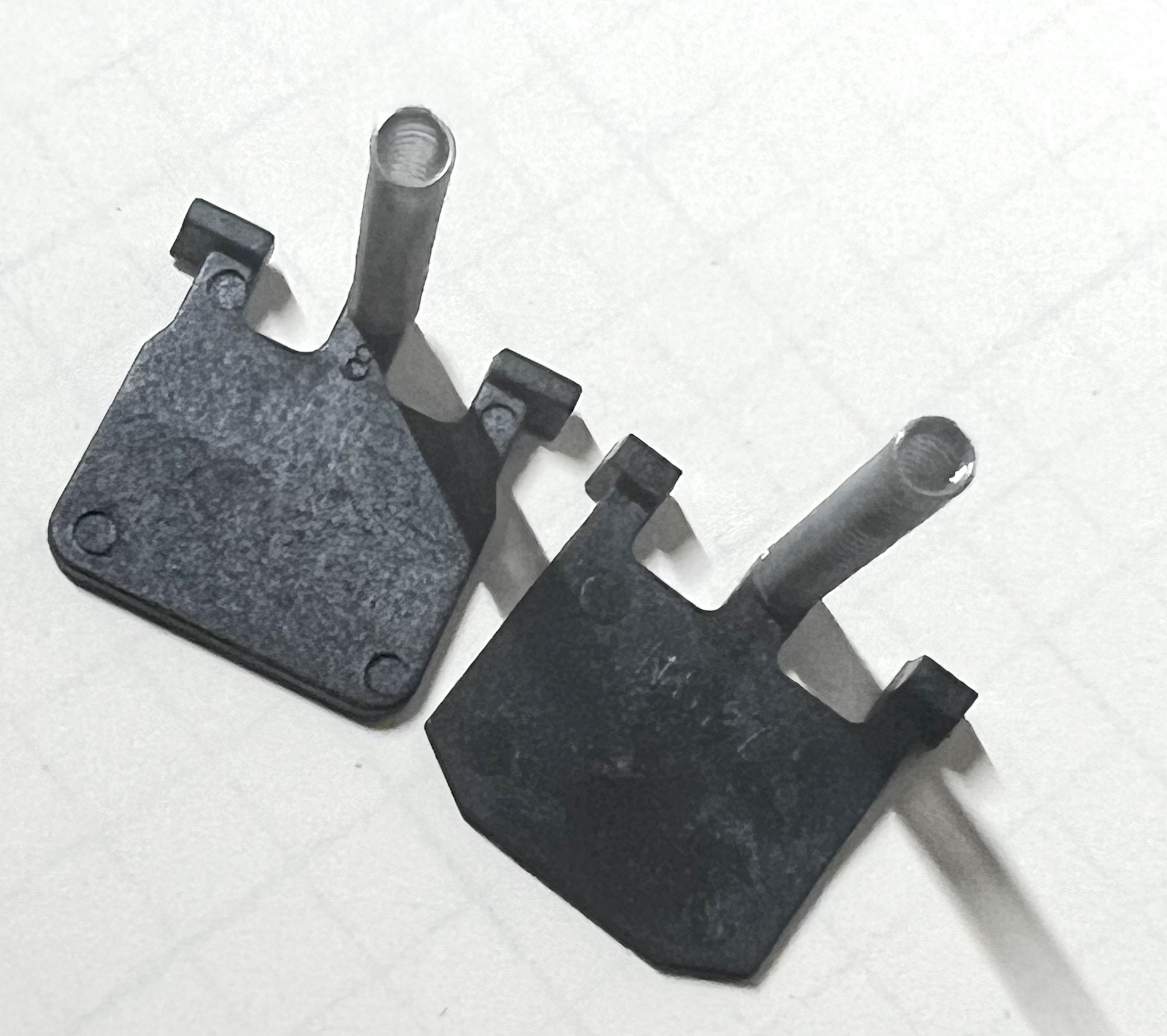

Interesting. Okay so I took as many barrels and flappers from the AT and swapped into the 104. And Viola!
Ha! I don't know if you can see from here, as it also looks a bit like lens distortion, but the barrels from the AT are at a different angle!!! OMG that would have driven me insane.
So I opened it back up and swapped back in the 104 barrels, but left the AT flappers on just the main alpha/control keys, arrow keys, escape key, and the like.
