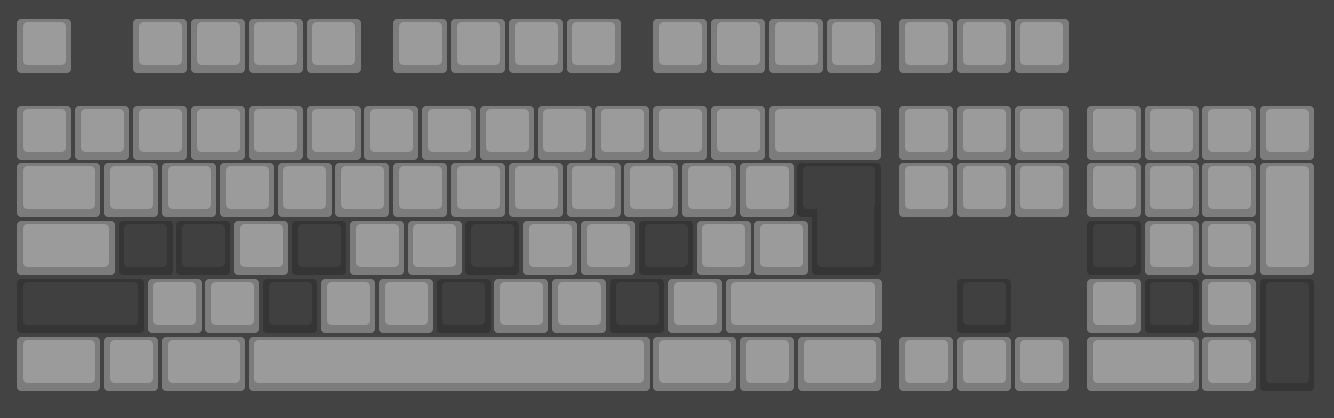

I have a new Model F which is demonstrating an intermittent fault in which a whole bunch of keys stop working. Here is the output of the VIal Key Matrix Test:
Vial Matrix Test
Vial Matrix Test
Screenshot From 2026-02-26 14-55-29.png (10.4 KiB) Viewed 785 times
This first happened a few days ago. At the time I didn't have time to do anything about it, so I unplugged the keyboard, put it aside, and used another one. Yesterday, I reconnected it with the intention of seeing what diagnosis I could do and, to my surprise, it worked perfectly - all keys working. Later the same day, the fault had reappeared. Unplugging it for a few minutes and plugging it in again solved the issue and, as I left it last night, it was working. This morning, the fault was back.
Are all the keys in that test result on the same row or column of the matrix and, if so, what could be the reason that line stops working after a while, only to work again after the power has been off for a few minutes? I know there is an auto-calibration but why would that drift after the KB has been on for a while?

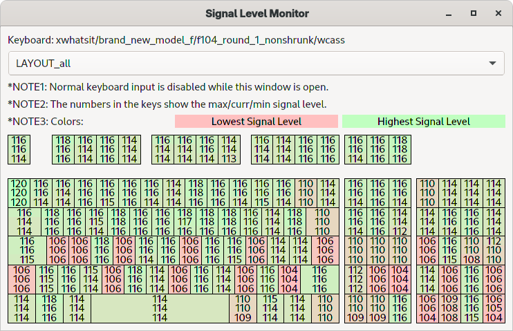

So I finally found a link from the manual to someone else who had helpfully worked out how to compile the pandrew utility*
Running that, even before pressing any keys, it seems to suggest there is a fault with one of the matrix lines, not with individual keys. See:
Signal Monitor, upon connection, layout view
Screenshot From 2026-03-04 20-18-29.png (79.46 KiB) Viewed 670 times

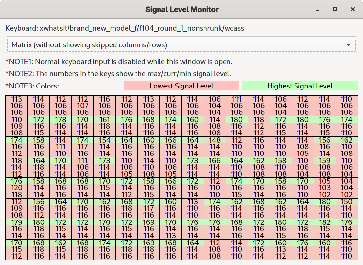

The keys that don't work already have a noticably different signal strength at around 104-106. Switching to matrix view shows a complete line that appears faulty:
Signal Monitor, upon connection, matrix view
Screenshot From 2026-03-04 20-18-46.png (85.92 KiB) Viewed 670 times

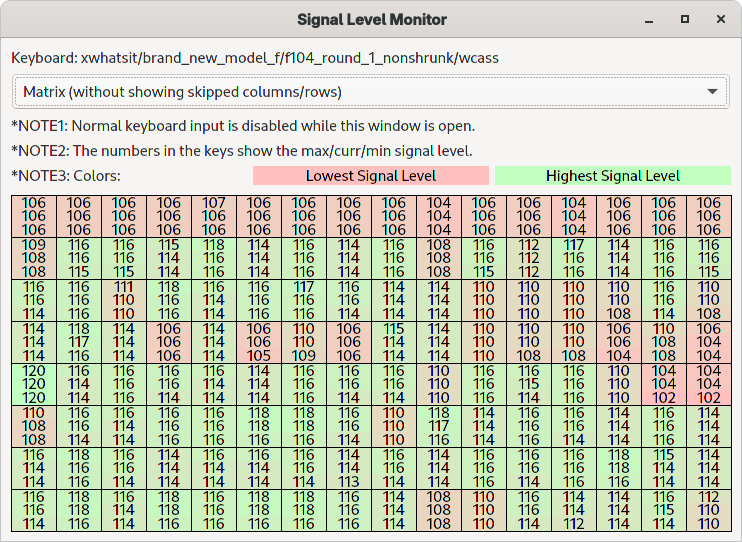

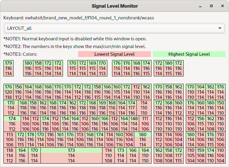

Doing as the manual describes and pressing each key gives:
Signal Monitor, after every key pressed, layout view
Screenshot From 2026-03-04 20-22-00.png (99.62 KiB) Viewed 670 times
and then in matrix view:
Signal Monitor, after every key pressed, matrix view
Screenshot From 2026-03-04 20-22-12.png (111.46 KiB) Viewed 670 times

So you are saying that the manual provided the correct instructions to compile the utility that you wanted? If anything was no longer accurate or if any details were missing please write them in your reply so I can update the manual.
Regarding keeping all the code in one place, I have just messaged Rico, ploxiln, and NathanA to see if everything can be combined into one repository on the project's github https://github.com/ModelFKeyboard
For now, the latest xwhatsit release and source code is noted in the manual below:
Additionally, as of 10/27/25 there are updated (beta) precompiled Linux and Mac pandrew utilities available here: https://github.com/ploxiln/vial-qmk/rel ... newfxx_r5c
Good detective work with the signal level monitor! Looks like you'll need to pick up a screwdriver kit and touch up the solder for that particular trace on both ends of the ribbon cable. So that we do not further beat a dead horse here once again, it is important to emphasize the manual's reminder that these keyboards do require maintenance and that end users are strongly cautioned against any expectation that the keyboard will run without maintenance; for years we've discussed why I don't take back entire keyboards to solder one wire or fix any other functionality that the user can fix themselves by following the manual.
