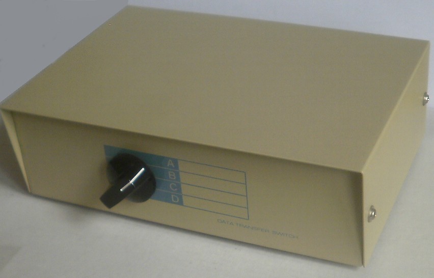

The front switch has four positions: A, B, C and D:
switch front.jpg (33.42 KiB) Viewed 1847 times

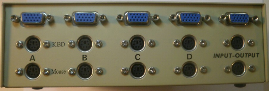

There are quite a few sockets on the rear:
switch rear.jpg (60.8 KiB) Viewed 1847 times
Anyway, only the PS/2 sockets will be used, so let's make the others invisible :D :
switch 00.jpg (48.58 KiB) Viewed 1847 times
Selecting any of the positions of the front switch will connect
- the corresponding upper row PS/2 socket to the upper row INPUT/OUTPUT socket,
- the corresponding lower row PS/2 socket to the lower row INPUT/OUTPUT socket.
(There is no connection between the upper row and the lower row.)

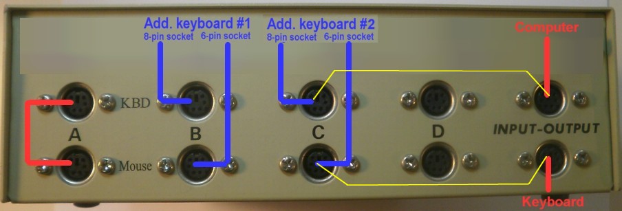

Now connect your first Tipro additional keyboard (depending on model, attached cable or cable connected to the 8-pin socket of the keyboard) to the upper "B" socket, and connect the lower "B" socket to the 6-pin socket of the keyboard using a male/male PS/2 cable.
switch 03.jpg (58 KiB) Viewed 1847 times
With the front switch in position "B", the additional keyboard is now connected to the computer and the main keyboard is "plugged" into the 6-pin socket of the additional keyboard. In other words, the additional keyboard now is the main keyboard and vice versa. Both are fully operational, but the interesting thing is that the ChangeMe software will now identify and program the "B" keyboard. Input for programming is done on the "usual" keyboard. No need to plug or unplug cables any more.
Same for connecting a third and fourth keyboards. All you have to do is to put the front switch in the desired position.
