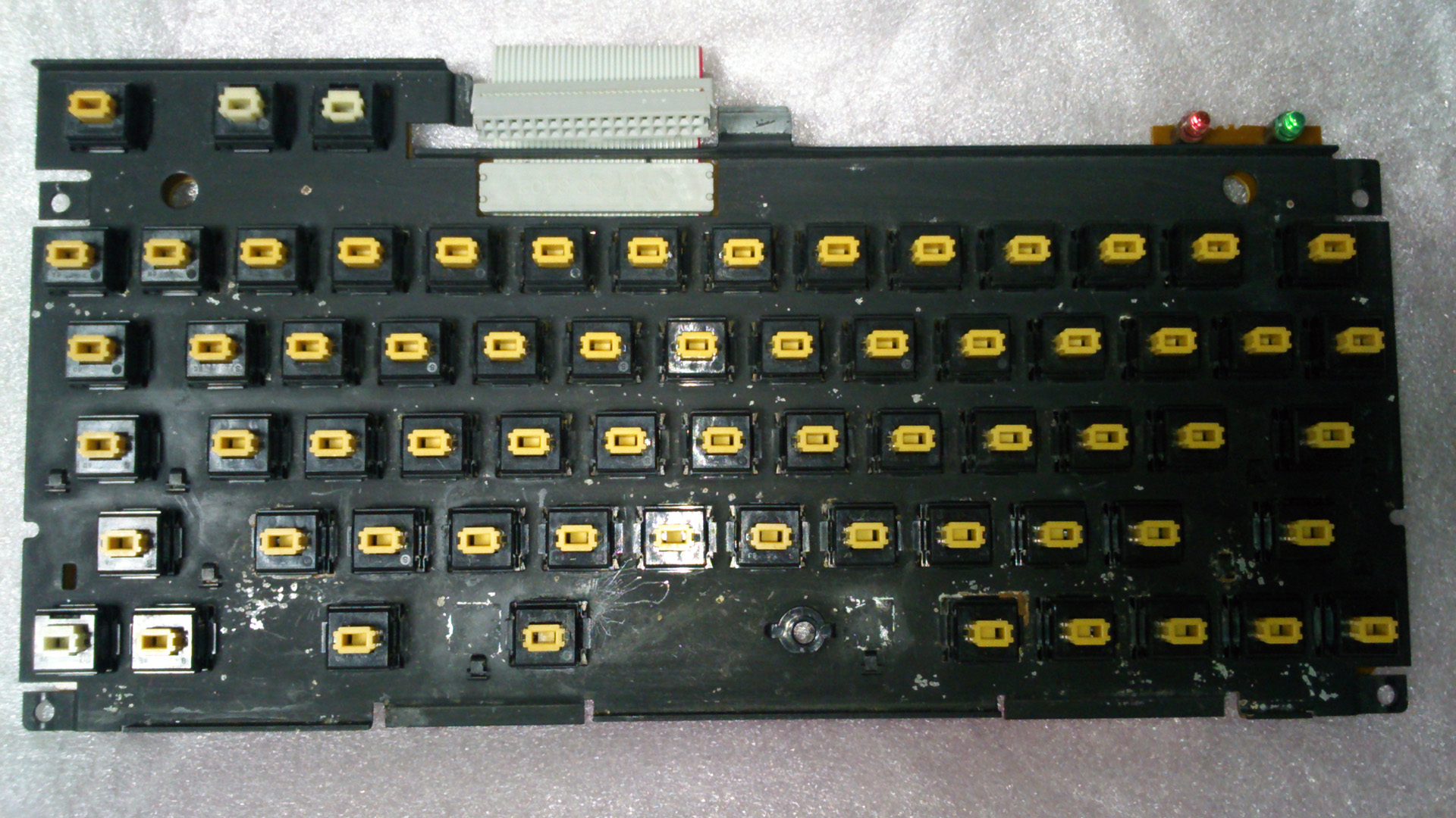

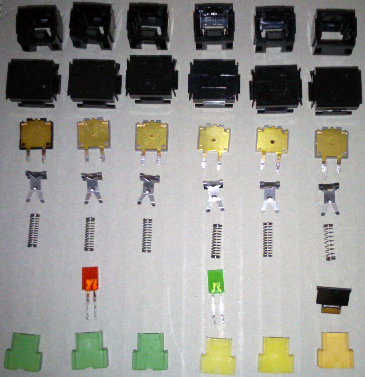

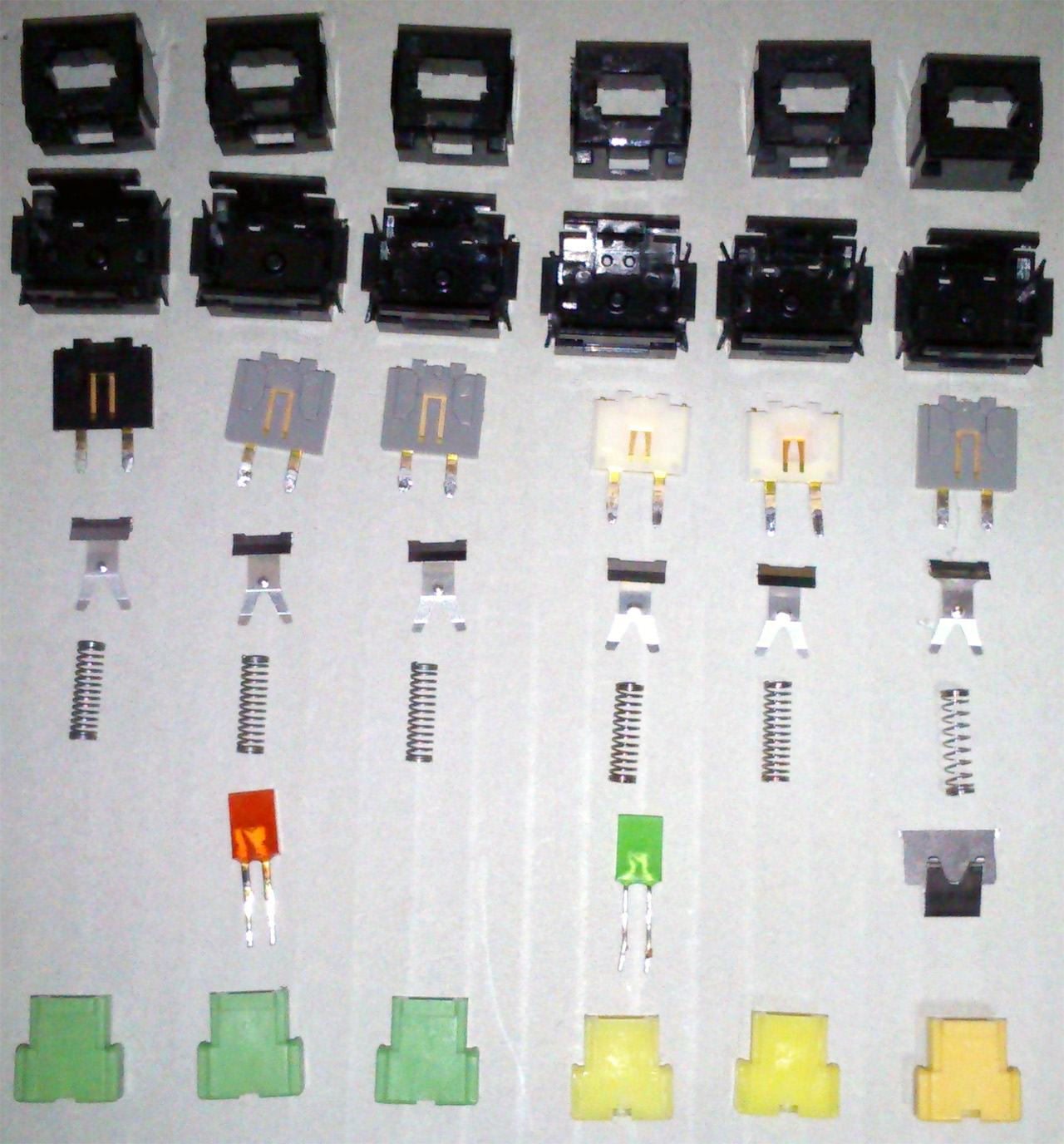

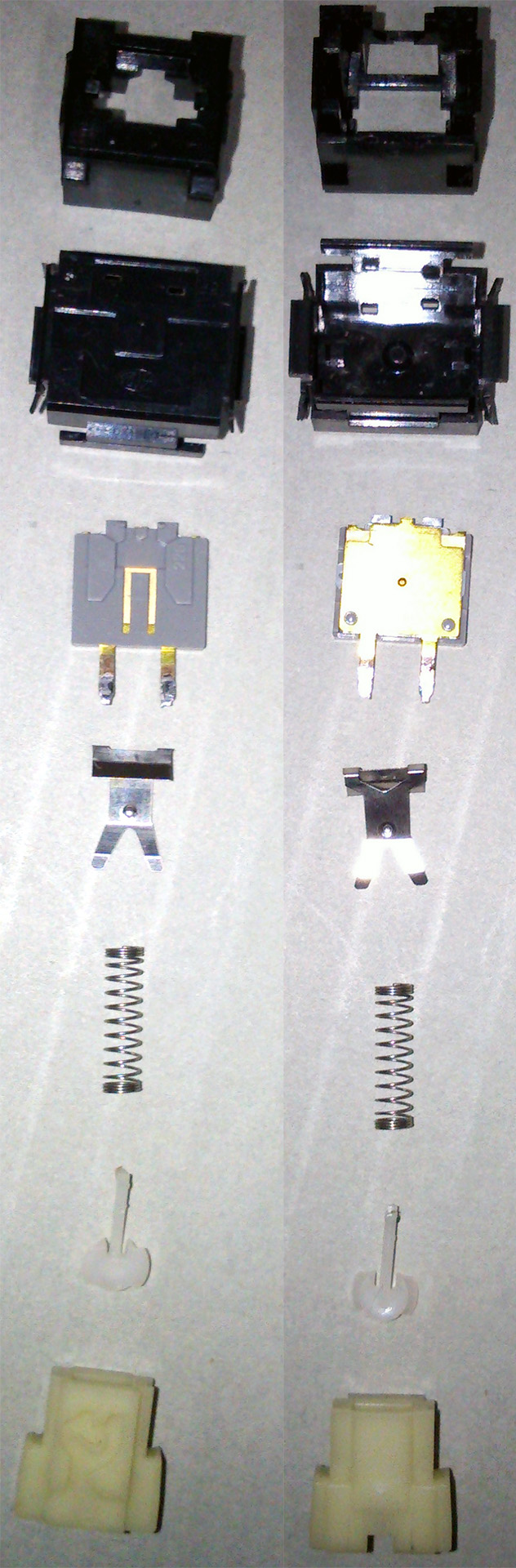

ALPS Yellow Slider click. Deep yellow like an OMRON orange axis.
Weight is comparable as ALPS brown Slider.
Touch which made the ALPS white axis heavy by the firm click. Gray point of contact.
A lock key is the same structure as Locke of M3501. Also click this.
Heavy one is regrettable although it is a very good axis.
ALPS黄軸クリック。OMRONオレンジ軸の様な濃い黄色。
重さはALPS茶軸と同程度。しっかりとしたクリックで、ALPS白軸を重くした感じ。
灰色接点。ロックキーはM3501のロックと同じ構造。これもクリック。
非常に良い軸ですが、重たいのが残念です。

Your dismantled switch pics are way better than mine, I should learn from you! :)

Trouble is I have no idea what he's photographed or why. The final switch of the six is from the Apple IIc, and is clearly notable for being yellow and clicky, which is just Alps being senselessly random. (Yellow is already documented as being linear with LED cutout as you can see above.)
Interesting to see a black switchplate though — another oddity.
No idea where the other switches came from, or their year, or force, or anything.

>Daniel Beardsmore
These Sliders were photoed in order to compare Yellow Slider. I am sorry that explanation is insufficient.
From the left.
ALPS green Slider black switchplate "IBM 5556 Multi-station Keyboard"
ALPS green Slider gray switchplate and LED type "ZENITH Z-150"
ALPS Yellow Slider White switchplate and LED type "ZENITH ZKB-2"
ALPS Yellow Slider gray switchplate in Click "Apple IIc"
Although it is a digression, there is also linear brown Slider.
http://www.kbdmania.net/xe/521827
