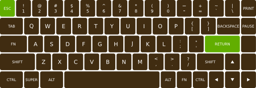

Let's say you want a Poker-like layout but with Alps switches, or an HHKB with Cherry, or a 75% layout, or a completely original layout. Make yourself the following questions:

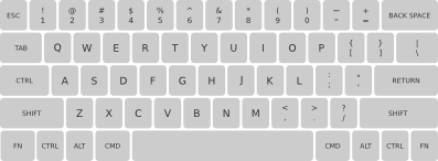

Keyboard design
Okay, time to get your hands dirty.

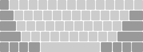

I've redacted here for you an SVG template you can use to design your keyboard. I set up a Poker keyboard as a test but you can play with it and make any design.
You'll notice a complex grid in the template. That should help you aligning the keys correctly. Zoom in to move the keys otherwise they won't snap correctly. The blue grid represents the key units. The space between 2 vertical lines is 1/4 of unit. 4 vertical blue lines is 1 unit, 5 lines is 1.25, 6 lines is 1.50 and so on. The red dots help you to space the keys. The space between two keys is always the distance of 4 dots.
Next time I'll try to post an Inkscape tutorial.

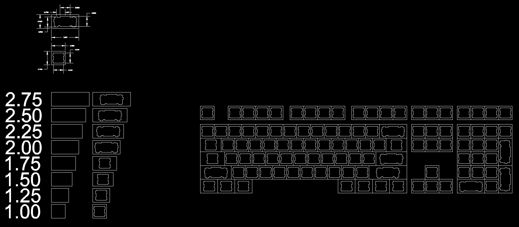

TD22057 wrote:I have a DWG file that contains the plate cutouts and switch outlines for the various switch sizes that I could post if anyone is interested. It makes it very easy to try out different plate designs.
I was thinking of doing the same for this thread. There are some things to look out for, that a good "plate clip-art library" should have correct. For instance, there is a small bug in the Phantom's stabilizer mount holes that makes it impossible to open a stabilized switch without desoldering - and this error has been copied into several plate designs that I have seen on Geekhack.
Another thing to look out for with the Phantom plate is that some switch holes were deliberately made a bit wider than one switch to allow for different positions on the PCB for different types of keys caps, for instance Ctrl keys with centred or offset stem. The problem is that the switch will not be stabilized sideways -- it will slide left and right, and stress your wiring. If you do direct wiring under an existing plate, then you need to fill those gaps to the side of the switch.

Findecanor wrote:Another thing to look out for with the Phantom plate is that some switch holes were deliberately made a bit wider than one switch to allow for different positions on the PCB for different types of keys caps, for instance Ctrl keys with centred or offset stem. The problem is that the switch will not be stabilized sideways -- it will slide left and right, and stress your wiring. If you do direct wiring under an existing plate, then you need to fill those gaps to the side of the switch.
definitely, if you go hardwire the holes must be perfect fit. I actually even removed the small dents to be able to open a switch.

Attached is my plate template file. I added dimensions to the single holes and the stabilizer holes - take a look and correct anything you see is wrong. The single holes are originally from user jdcarpe and modified by me to be at the cherry dimension. I believe the stabilizer holes came from a phantom plate file so those should be checked. I wasn't planning on a traditional space bar in my design so someone should definitely add several examples of those as well.

This seems a simple question, so I bet it's not! What sizes of keys are the easiest to find?
I get that 1.0, 1.25 etc. up to 2.75 units are available. (All by 1.0 units – I'm talking about the usual rectangles here, ANSI style.) But what are most common? Say, for simplicity, that I'm going DSA so I don't have to be careful about rows. Although other first timers may well need that info. I'm also keen on blank caps all round, anyway, which is another move towards keeping things easy.
The Poker layout Matteo created is 15 units wide. Seems sensible to think inside those dimensions so I can have my choice of Poker / Pure case for my first build. But it's the bottom row I'm looking at.

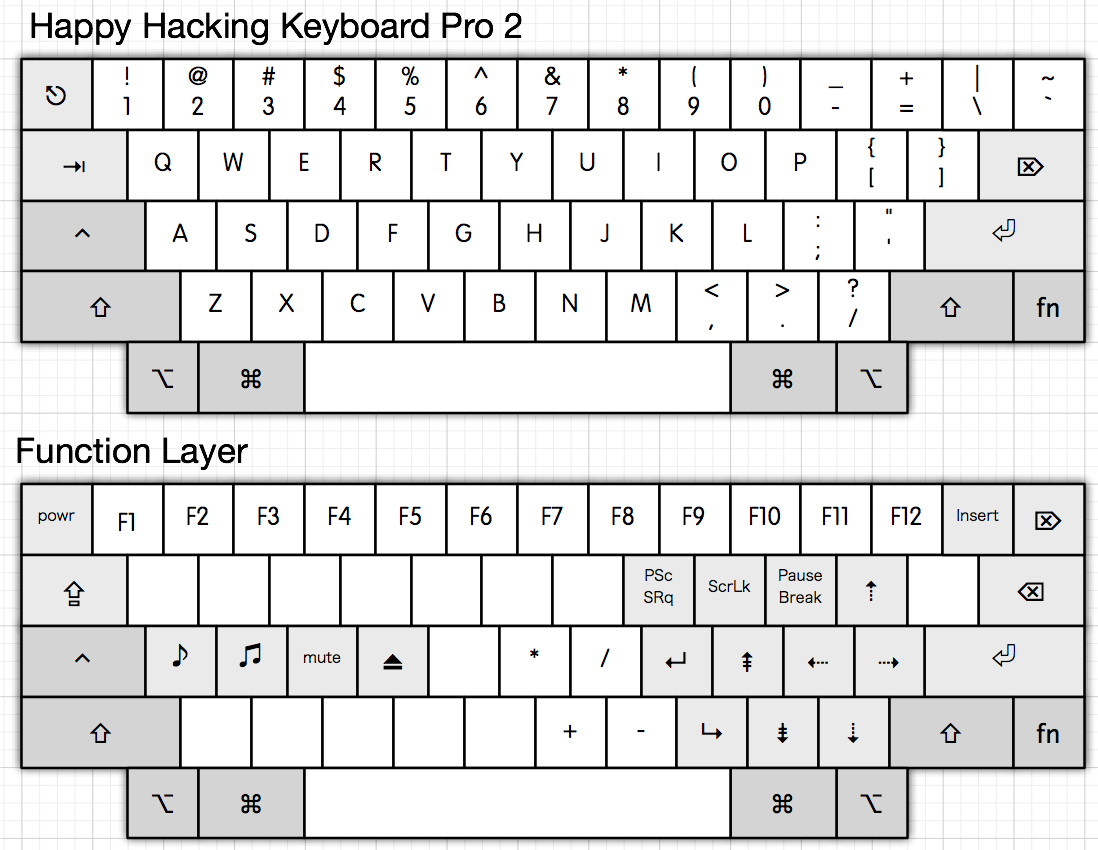

I'd like to keep it consistent with the Mac keyboards I'm used to. They have four modifiers to the left of the spacebar. They are 1.0, 1.0, 1.0 and 1.25 units wide. Even on my desktop keyboard. Then the spacebar – even on my ten year old PowerBook – is 5.0 units across, lining up under CVBNM precisely.
Are 5.0 unit spacebars a problem? It's not vital, but this is the part of the process for identifying what's a wise direction and what isn't.
Besides that, I'm thinking of a lot of square modifier keys as I'm already used to them and they allow me more space for cunning plans!

12 May 2013, 10:05
Thanks TD22057 for the DWG, I'll review it and add my notes. I actually use a template created from scratch in millimeters. Everyone was telling me that the standard units are inches, but it turned out that it totally works in mm and the local laser cutting services are definitely happier if I use a sane metric :P
Muirium wrote:This seems a simple question, so I bet it's not! What sizes of keys are the easiest to find?
No it's not easy at all :) I myself needed quite some time before understanding all this key units madness.
Let's start from the spacebar.
In DSA family you can find 6, 6.25 and 7 units. But as far as I know only DSA retro has all this variety, so you are pretty much limited to that set.
DCS has all spacebars from 4.5 to 10.5 units (5 included), but anything that is not 6.25 or 7 is very hard to find. Maybe you can source them from some keyboard (maybe an old Apple keyboard that you can dremel to change the stems).

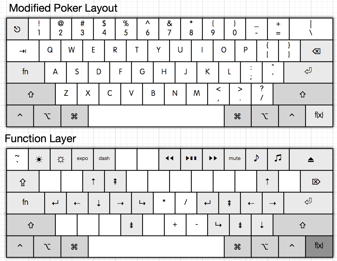

In DCS family the keys in the spacebar row are angled by 16deg and can be found from 1 up to 3 units. 1 units are not hard to find since they are often used in winkeyless or tsangan variants, but I doubt you could find the right legends for them.
This might be a DCS feasible Poker-like Mac-friendly version (with standard 6.25u spacebar).
You are going to use FN a lot in a 60% so I made the left FN a little bigger.
If you got DSA Retro you have more freedom, we had mods in all sizes and flavors and you could use a 6units space and have symmetrical mods (the right FN could be 1.25 too).
But maybe if you want to build a Mac keyboard now you could find an Apple Extendend Keyboard II (or similar) for the caps and build a custom ALPS keyboard. It does not have 1u modifiers though.
12 May 2013, 12:03
I like your suggested layout, Matteo. I'm thinking of an HHKB position for backspace, too. And I'm trying to work out Fn layer options for the arrow keys. The appeal to going custom is all in the layers!
As for 5u spacebar: it's nothing set in stone. This is the right stage for finding out what the sensible constraints are.
Here's an interesting point: most keyboards with a function key don't pass its state along to the computer, I presume? (Instead it's used by the controller to decide on what layer to use when picking the appropriate key?) On the Mac, Fn is like Shift, Command, Option and Escape: it shows up on the keyboard viewer and you're free to use it in keyboard shortcuts. Hitting Fn twice triggers speech recognition for instance.
I may need my own layer select key in addition to Fn. I'm fine with that. Indeed, I'd put it on the far end of right shift like the HHKB. Layers layers layers!

12 May 2013, 12:39
You should be able to grab a DSA Retro in the near future, but unfortunately you can't make a 100% blank keyboard with it.
If you go MX and DCS you can easily find blank PBT sets, but you'll probably need to grab two if you want to move some of the keys around.

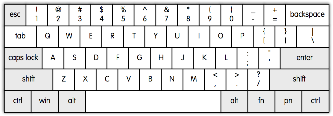

The following will be the Brownfox if anyone cares :) I'm not yet sure about some of the mods, but it's 90% final.
Most notably note the left FN position (in lieu of the caps lock). The two blanks to the right are to be defined yet. Probably vol up/down.
I find the FN position in mac keyboards very good but the control is awful. You have to bend your thumb too much to reach it (I am a long time mac user too, but I'm gradually converting to linux in recent years).

12 May 2013, 12:57
The following should be feasible with DCS. You need 1 set of blanks + some spares.

Your problem is that you need two 1.5u in the second row. So you probably need to buy two sets just for that. Also you need two additional 1u in the first row.

matt3o wrote:Thanks TD22057 for the DWG, I'll review it and add my notes. I actually use a template created from scratch in millimeters. Everyone was telling me that the standard units are inches, but it turned out that it totally works in mm and the local laser cutting services are definitely happier if I use a sane metric :P

Right, here's my current thinking. I went with the Poker / Pure / Poker II layout and simply remapped the keys to see what I could do. Thinking inside the box! Practically everything I want from a compact keyboard actually fits.
I just cobbled this up in OmniGraffle as I'm used to using it. The 0.25 unit grid is visible in the background. And, yes, I spent some quality time in Unicode to dig up all those symbols for the keys…
Poker II Custom Mac.png (113.34 KiB) Viewed 263153 times
The colours indicate modifiers versus ordinary keys, and whether f(x) is pressed.
Some notes:
Two different function keys!? WTF?
Yeah. I probably need a better name for that. I want to keep the standard fn key for shortcuts that I'm used to and for occasionally accessing the entire F1-F12 row. OS X can see it separately. My function layer, meanwhile, needs a separate key. That's f(x) in the bottom right corner. For now.
Why all those arrows?
I like the HHKB. Its function layer seems smart so I borrowed it for cursor control. And then I duped it on the left side, but mapped around ESDF instead. Why? Because there's plenty of room. I think letting both hands have full arrow key / home, end / page up, down control within reach is pretty nifty. At least I'd like to try it.
Where's your function key row?
Behind fn as usual. I'm used to screen brightness / volume controls etc. on the top row of the keyboard by default, then accessing the actual f-keys via fn anyways. Honestly, I use them so rarely a double modifier is all they deserve.
Crazy symbols, dude.
Yeah, I know, I probably overdid all that. Looks better to my eye than a tiny font spelling out Page Down etc. but you can easily see where I failed on 3 and 4 (meant to be Exposé and Dashboard) and the volume controls (couldn't find the Unicode glyphs for various speakers).
Anyways, I'm sure I've overlooked something entirely obvious in all my newbishness. Spot it?
13 May 2013, 00:02
Here's the HHKB by the same process.
That's a 6.0 unit spacebar, if I haven't made any mistakes.
I've included the layout files on the off-chance that anyone else here uses OmniGraffle.
Poker & HHKB.zip
(129.43 KiB) Downloaded 1252 times
There's a sensible version in there of the Poker with text labels for all the keys instead of those Unicode symbols, from right before I delved into them. Pity that VAG Rounded looks a touch like Comic Sans in lowercase!
Poker II ANSI Layout.png (52.95 KiB) Viewed 263137 times
(It all makes sense now…)

Great work Muirium. thanks for sharing your source.
I use the arrows so much and together with shift and control that I can't really have them in the FN layer, but I see a lot of love for 60% layout so it must be just me.
Apart from that I'd just revisit the 2u \| key of your modified poker layout. That's really a huge key.
13 May 2013, 00:23
Yes, it is. The first two physical changes I'd make are those already taken by the HHKB.
1. Split that top right 2u key into a pair of 1u.
2. Stick another 1u key at the right end of right shift. I'll come up with a use for it sooner or later…
Staying within the Poker's constraints really helped me get to my first draft of a layout. Sometimes less is more.
