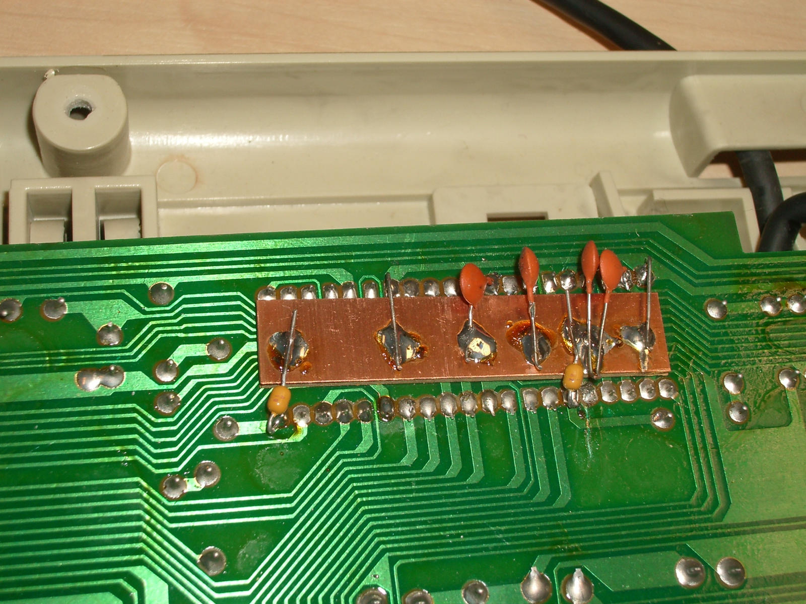

I had my Tulip ATK 030244 (Monterey K102) apart earlier, and for the first time I pulled the plate out. I found this on the bottom of the PCB:

lol, even i could made a better solering job...
Soarer
06 Sep 2013, 00:32
Best dead cockroach ever!

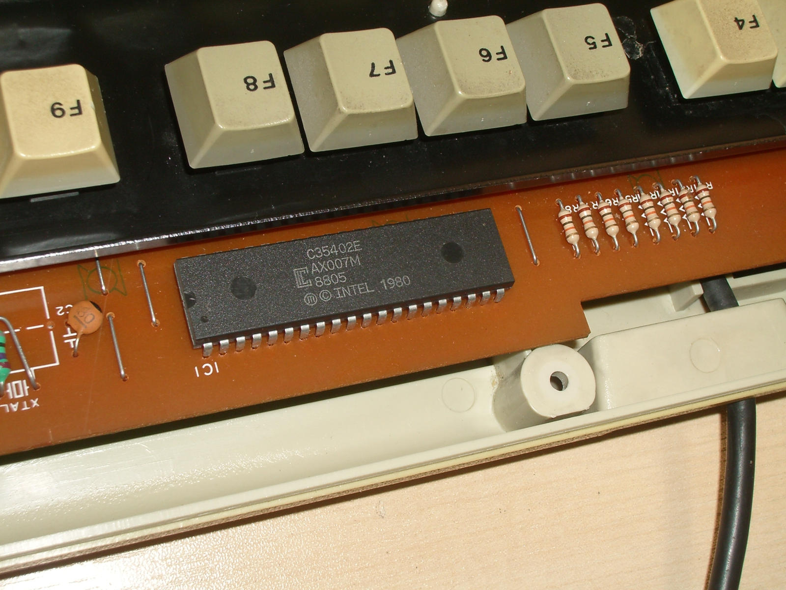

This is the actual IC:
Actual chip.jpg (277.36 KiB) Viewed 2239 times
What the rubbish on the back of the PCB is for, I have no idea. Reminds me of Jeri Ellsworth's tale of getting the C64 Direct-to-TV manufactured, only even more drastic.

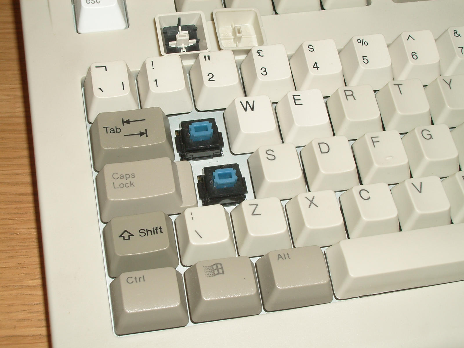

Nearly 50% of the switch uppers (upper shell, return spring, click leaf and slider) are now in my Dell AT102:
AT102W with semiblues.jpg (187.94 KiB) Viewed 2239 times
I'm also using the doubleshots from the OK-100M instead, as they're far nicer than the lasered keycaps from Dell. However, in addition to obvious mismatches (1u vs 2u backspace, space bar, ctrl/alt etc), the caps lock keycap stem is slightly offset, so it won't fit. (I left it in that unfinished state to illustrate doubleshot vs lasered, just so I can slag off laser etching as I hate it.)

It strikes me as a patch. Like they had the PCB manufactured in numbers, and then found a bug. It had to be fixed cheaply, hence the dirty patch and lousy, time constrained hand soldering.
06 Sep 2013, 01:26
I gathered that (cf Jeri Ellsworth and the C64 DTV), but why are they wiring half the controller back to itself using a bus bar and a load of capacitors? I wouldn't have thought that you could screw up addressing a keyboard matrix that badly …

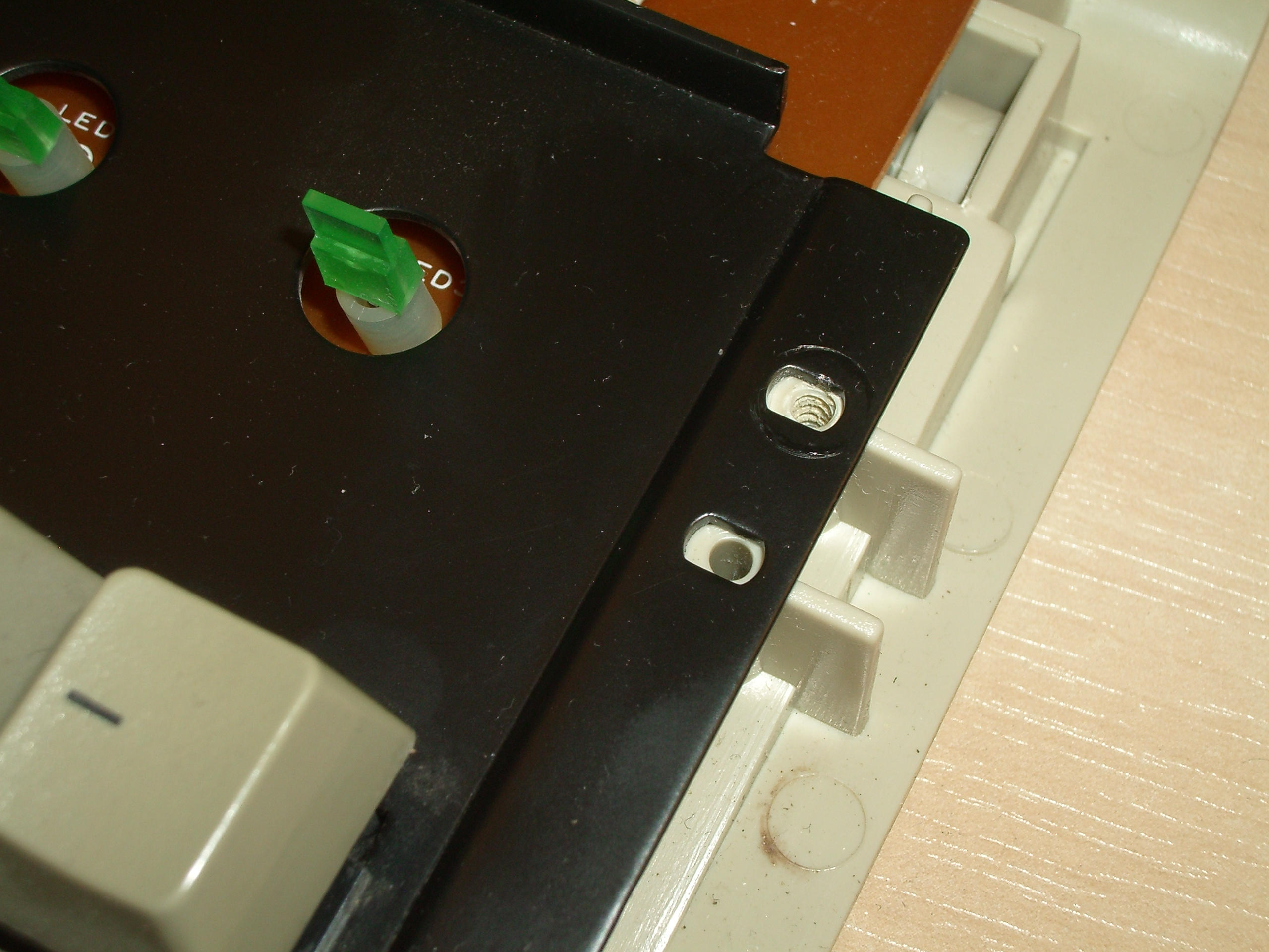

It's a weird keyboard. The plate mounting holes are stamped out in pairs, which line up with matching pairs of holes in the shell:
Tulip ATK 030244 -- unused plate mounting holes.jpg (412.37 KiB) Viewed 2232 times
They only tapped every other hole, too, unless they're self-tapping the holes (it's only soft plastic, after all).

That's what a real patch looks like! Today's software patches is just not the same thing.
