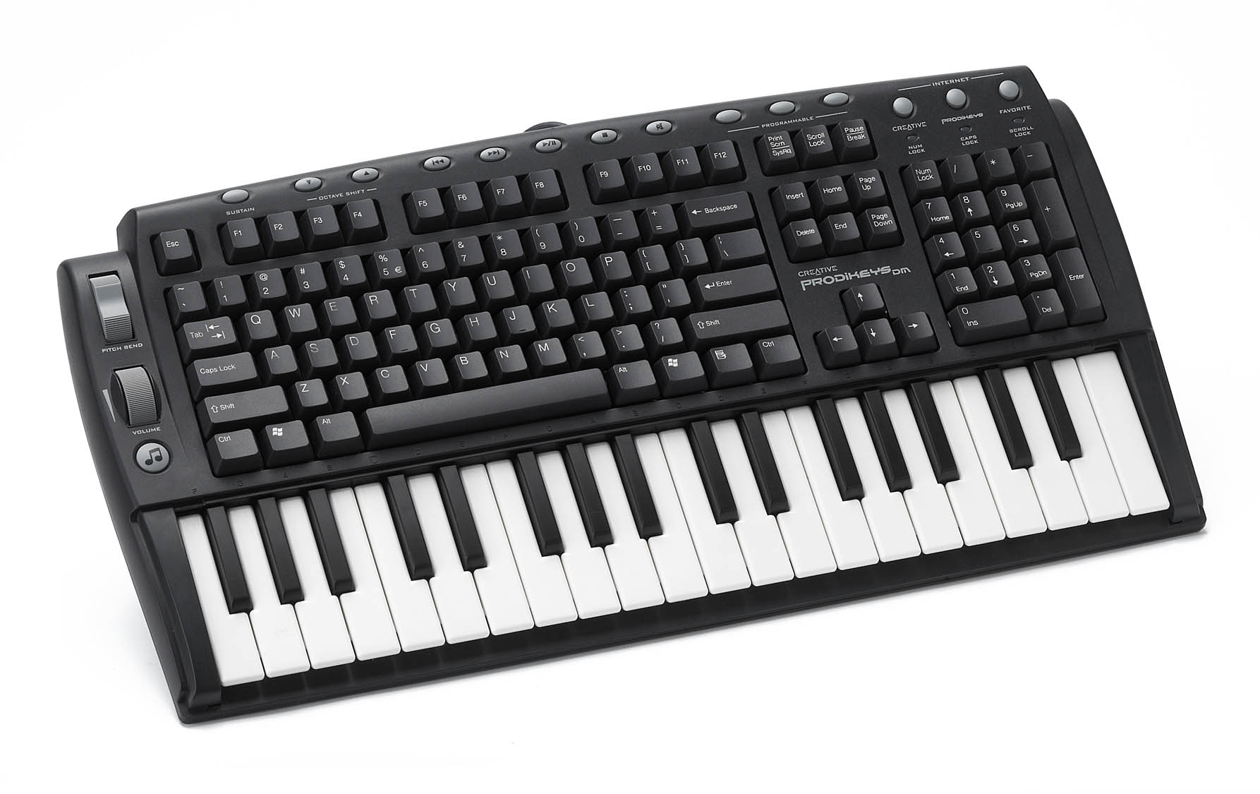

Reminded me of this :
Knowing Creative, the keyboard is probably just rubber-dome mush ..
Maybe even both of them :(
Nice typewriter btw ..
22 Oct 2013, 17:53
Peter wrote: Knowing Creative, the keyboard is probably just rubber-dome mush ..
It really is! I saw one at a radio club junk sale and gave it a poke: not good. Most Creative! Absurdly, it was literally the only keyboard on sale there.
