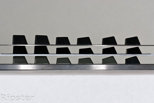

Then there is this (one of several) comparison pictures that was posted once:
Keycap profiles (Ripster).jpg (96.93 KiB) Viewed 4338 times
I believe they are top:Filco, middle:Cherry, bottom:Realforce, but I am not sure.
Maybe these images could be traced for drawing the diagram, but missing are OEM row 0-profile (Ctrl key on Kinesis) and Cherry row A-profile (really old bottom row).

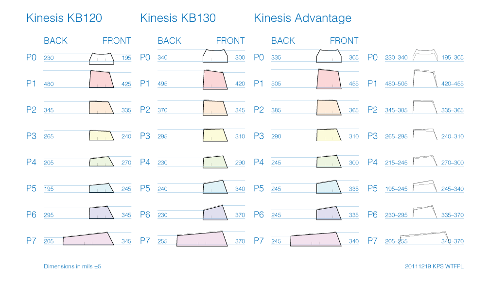

I've done this for the keycaps on three generations of Kinesis keyboard. The measuring gets a bit tedious.
Drawings and measurements for cylindrical profiles represent the lowest point of the curve, and heights are relative to the bottom of the stem, not the bottom of the skirt. (I do have the offsets recorded somewhere.) Some people on GH have said that the original (KB120) caps are SP DCS.
Vector form attached (DT doesn't think SVG is an image format)
kb120 kb130 advantage.svg.zip
(5 KiB) Downloaded 245 times
