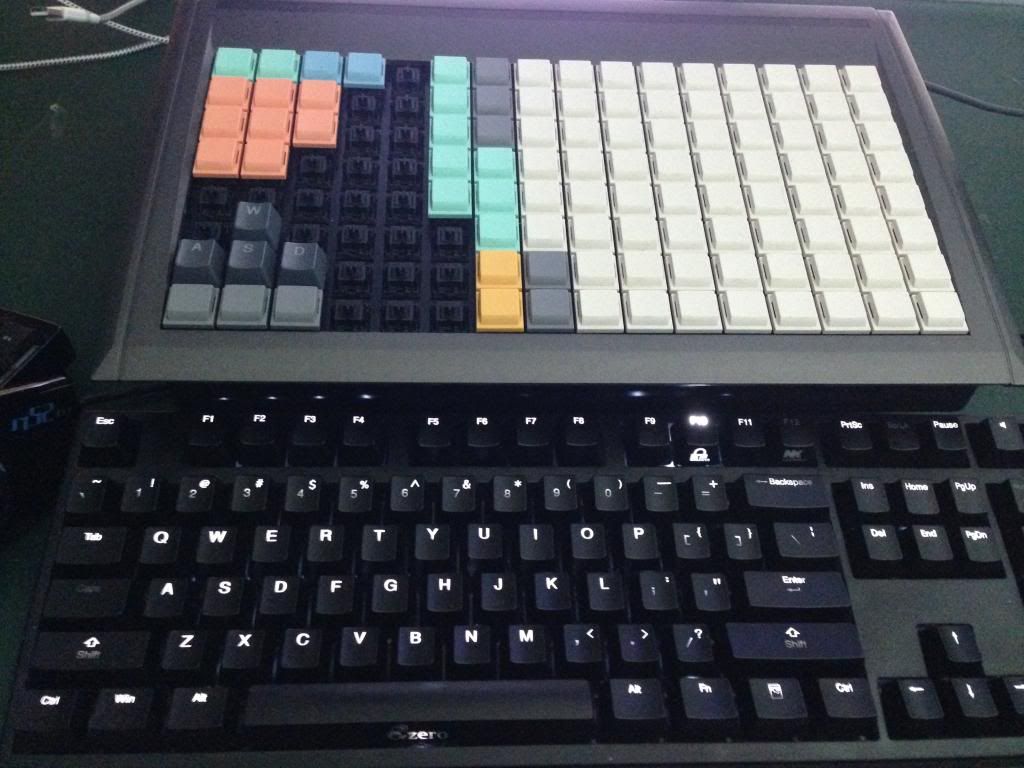

I just don't understand why you are asking what the Tipro ChangeMe software can or cannot do.
You can download it free of charge if you haven't yet, and find out by yourself.
And of course you can chain Tipro keyboards, several of them if needed.
You can even mount them together to have them behave a a single keyboard:
This one is a staggered MID series Tipro with a 8x8 matrix keyboard on either side,
you can do the same with their KMX series (I think 7bit has staggered Tipro KMX boards for sale).

cool I think I might try and copy above setup .. are those MID series pcb mounted or plate mounted?
I know changeme is free I have it but just haven't got round to testing it yet.. that is good news that you can mount them together
if the above is pcb mounted I might try and replicate that above setup .. any other ideas ??

Let me mumble-grumble off-topic first:jond_keyhack wrote:[…] mid series vs kmx series number of programmable layers?
Tipro's MID and KMX series both have 8x4, 8x8, 8x12 and 8x16 matrix units and also staggered units (those only in ANSI, by the way - mine is modified).
Tipro discontinued their MID series, but as such professional keyboards are pretty expensive, it's second-hand stuff we are considering anyway.
Tipro's staggered units are slightly non-standard, by the way, although in a different way for the MID and the KMX series.
- In MID keyboards the Enter key is 2 units wide (instead of the standard 2.25) and the key immediately left of it is 1.25 (here again mine is modified, thanks again to CeeSA for his splendid work).
- In KMX keyboards each row is staggered exactly by 0.5 unit from the one above it (instead of the standard 0.25 for the ASDF row).
In both cases Tipro obviously did not want any key to be wider than 2 units.
And Muirium is right, Tipro keyboards are always plate-mounted.

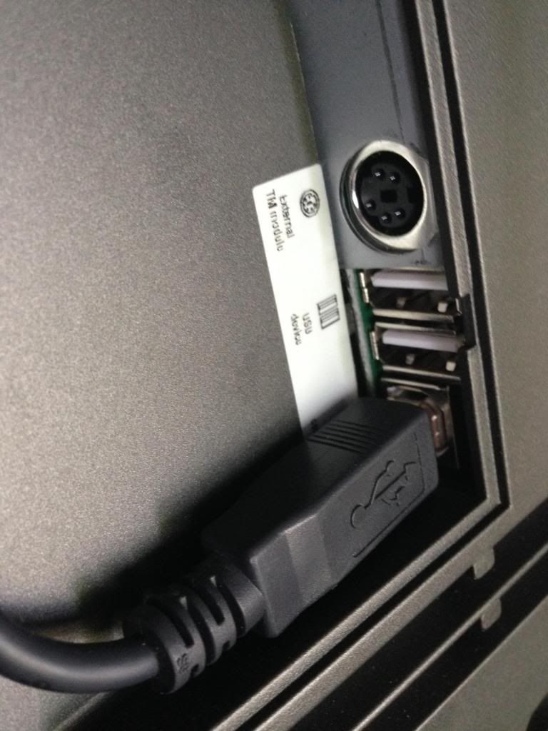

cool , awesome, amazing, erm. Which versions of the MID have the usb controller ? Are there any popping about online?
By controller usb or ps/2 do you mean the cable is external? So programming only works (for MID) with a native (internal) ps/2 socket? I was under the impression I could program my tipro through the usb and not have to link up the ps/2 cable to it.
In any case is there some information elsewhere about replacing the sockets or as to the whereabouts of a MID (model number) post 2002 that has a usb power socket / controller.
My tipro KMX has an external usb but I have just noticed that there are two power points for usb connections and a ps/2 socket. They could be usb 2.0 so I could charge my phone on them or even sync data. chuffed

this is the back of my tipro kmx usb
