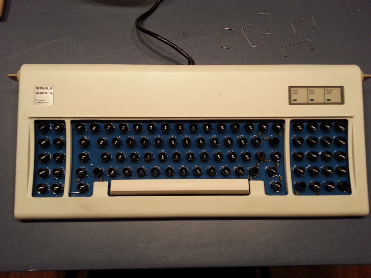

How i make replacement foam ...
print out my template at 100% on paper big enough to fit it (just a few cents at the office supply store).
check measurements are accurate. if too small/big, adjust scale and re-print.
stick thin double-sided tape on the back - just outside the boarder.
unroll new foam material on top so that it sticks to the tape.
use dies/mallet to punch out the holes.
use a razor to cut the slots.
use scissors to cut the boarder.
For foam material i use 1/16" neoprene. It compresses easily to .5mm and is cheap.
http://www.mcmaster.com/#8647k102/=s0yd5e
I got my die set from HF. They go on sale from time-to-time.
http://www.harborfreight.com/9-piece-ho ... -3838.html
Some folks punch a single big hole that goes around the notch. I prefer to make two punches. Ether way will work. My template for the Kishsaver is below. TBH, i have not used this specific template myself (my foam was in like-new condition) so double check the positions. I have templates for the AT and 122 also; PM me if you need one.
