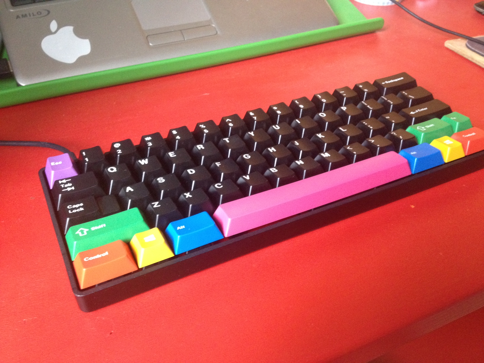

Finished the first one. Love the board, the default layout is close to HHKB but I will have to tweak it a little.
But for the moment I'm just enjoying it.
The soldering took around 30min, the solder pads are good quality so I had no problems at all. The hack for the short RSHIFT is a nobrainer. I'm really happy how it turned out. The switches are some old broken in MX Blacks, bit heavy for me, but I will replace the springs with some Korean ones soon.
Next step is hacking the layout and finding the best one for me :ugeek:
P.S: many thanks to Tinnie for this GB and also to matt3o :D
