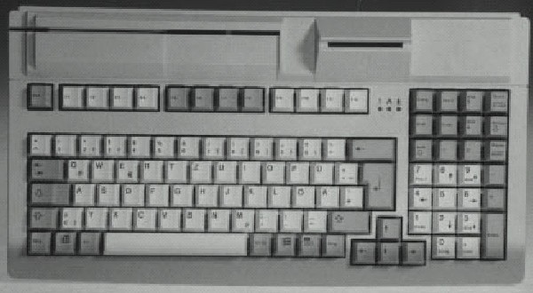

Ok, I knew it would be hard. Do you know what keycaps this german keyboard has.
http://www.ebay.de/itm/Cherry-Kassentas ... 566a658d09
Nuum
29 Sep 2014, 17:44
It has thin lasered PBT keycaps. You can look that up here: http://deskthority.net/wiki/Cherry_article_numbers
Only Cherry keyboards with scooped F and J keys have thick keycaps, the ones with little bars on them are always thin.
HzFaq
29 Sep 2014, 17:47
Also, that's a G81, the stabilizer mounting points on the larger keycaps might not be compatible with Cherry MX stabs.

Does it exist grey keycaps like this that will fit on G80-1800.
_
IvanIvanovich
07 Oct 2014, 16:49
It's possible it exist in beige doubleshot, but I can't recall seeing them for sale ever so good luck. Probably find it in lasered PBT without too much trouble though.
HzFaq
07 Oct 2014, 16:57
I got a DE ISO beige doubleshot set with 1u bottom row from Ascaii a few years back...Pretty much the only one I've ever seen though.
