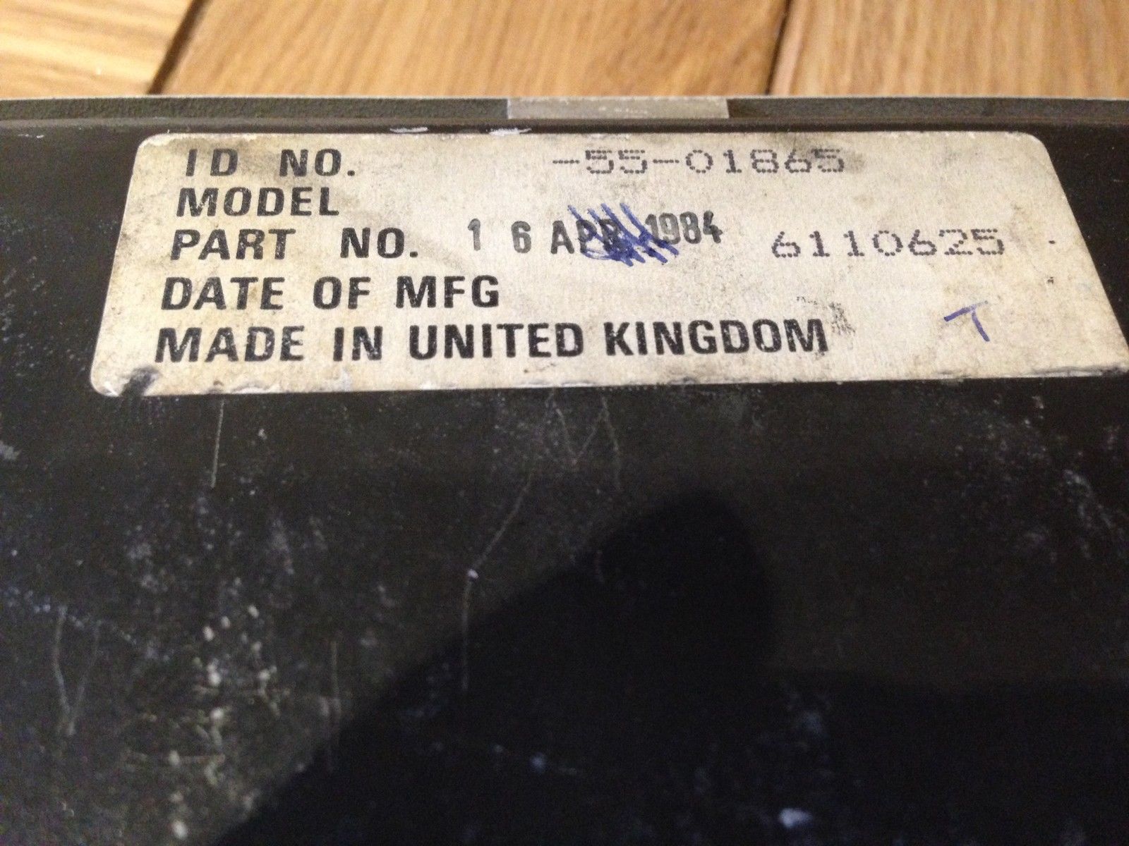

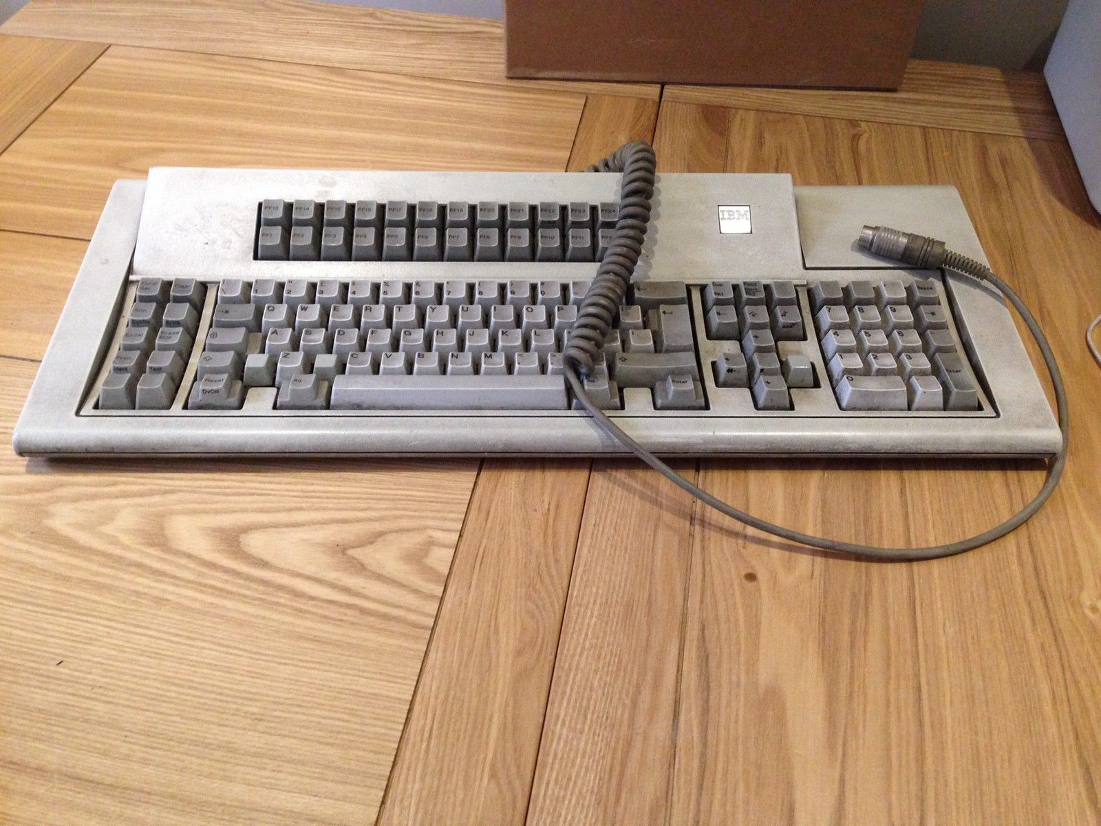

Hi,
I've been using the database here and browsing the forums for a while, and I thought this could be the place to help me identify an IBM keyboard I bought the other day. I've never posted before, so I apologise if I've put this in the wrong place or there's a dedicated thread for identifying keyboards I've missed.
Its currently being shipped to me, but I have a couple of photos, the model number and the "birth date" to go on.
It has replaceable keycaps (a couple are missing), the model is 6110625, it was made on 16th of April 1984 and it is a 122-key terminal keyboard. It was made in the UK. I've looked around but can't find this model number in any of the keyboard databases, and was hoping someone could tell me a bit more about it, and whether I could make it work with Soarers Converter?
Here are the pictures.
View of keyboard with side view of connector
Front of Keyboard.JPG (313.7 KiB) Viewed 10278 times
Birth Certificate of keyboard
Rear of Keyboard.JPG (262.57 KiB) Viewed 10278 times

Looks like a Model F 122 key to me. The underside isn't beige plastic like the later, less sought after 122 key Model M. And the label down there looks more like my (Model F) XT's, which is another good sign.
I'm no expert on 122 key Model Fs. But it looks to me like you lucked into one! Well done. Very hard to find them in Europe.
daedalus
Buckler Of Springs
24 Oct 2014, 13:33
122-key Model F, UK 3270 layout.

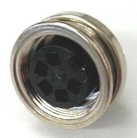

The cable plug looks odd. If there is an additional metal piece screwed onto the main plug, I would be curious to see what it looks like by itself.
That looks like the standard 240-degree, 5-pin DIN connector with a sleeve that screws into a connector like this:
24 Oct 2014, 16:12
it is but the outer sleeve is missing

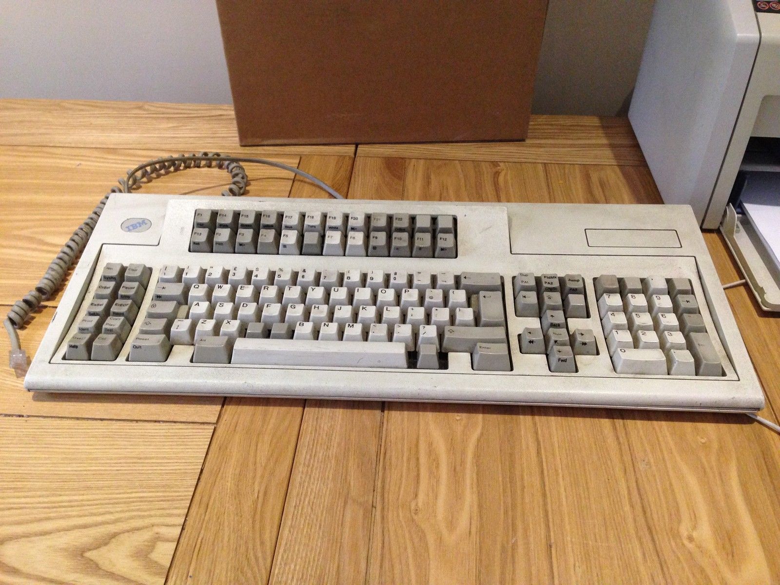

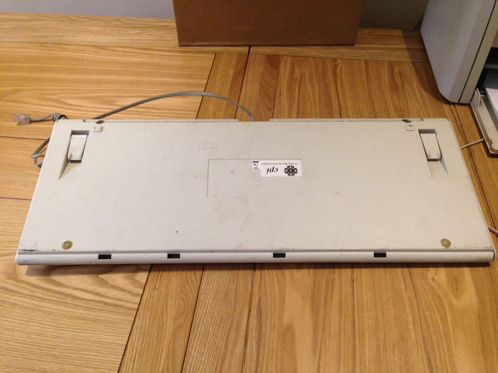

Here are the photos of the second keyboard, which I'm pretty sure is a standard model M terminal
IBM Terminal
IBM Terminal
Front of Keyboard 2.JPG (324.27 KiB) Viewed 10142 times
Rear IBM Terminal
Rear IBM Terminal
Rear of Keyboard 2.JPG (249.83 KiB) Viewed 10142 times
