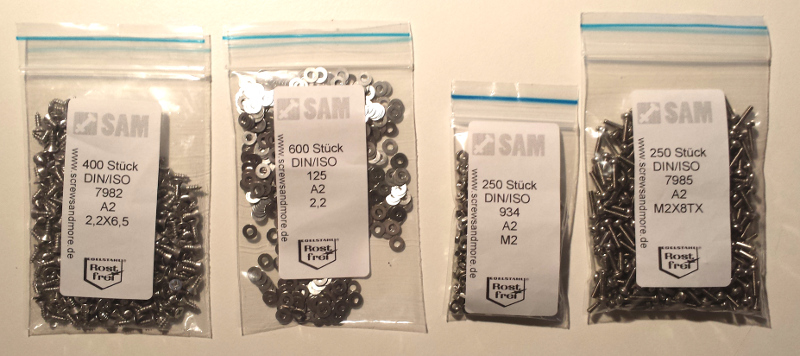

That is the screw size i use:
The middle row can be done with nut and bolts, and for drilling the holes i use 1,5 mm drill bits.

Keep in mind the size of the holes:
Will have to go out and find some appropriate screws then!
With the screws that I copied from Madhias, I had to use a 1,5m hole.
When I used nut/bolts I used a 2mm hole.
With Madhias' DIN/ISO 7982 A2, 2,2x6,5 a 2mm hole is too big. It simply does not work.
I also noticed that I created more pressure with the screws that with the bolts. I had to lose them to have the keys properly working. In particular the long keys (Enter, shift, backspace ...) were too hard and got stuck. It took me some time to understand the problem.

When i did the normal bolt mod i used 1,5 mm holes too, so i could use the screws i mentioned! If the hole is too big, you gotta have to use bigger screws of course.

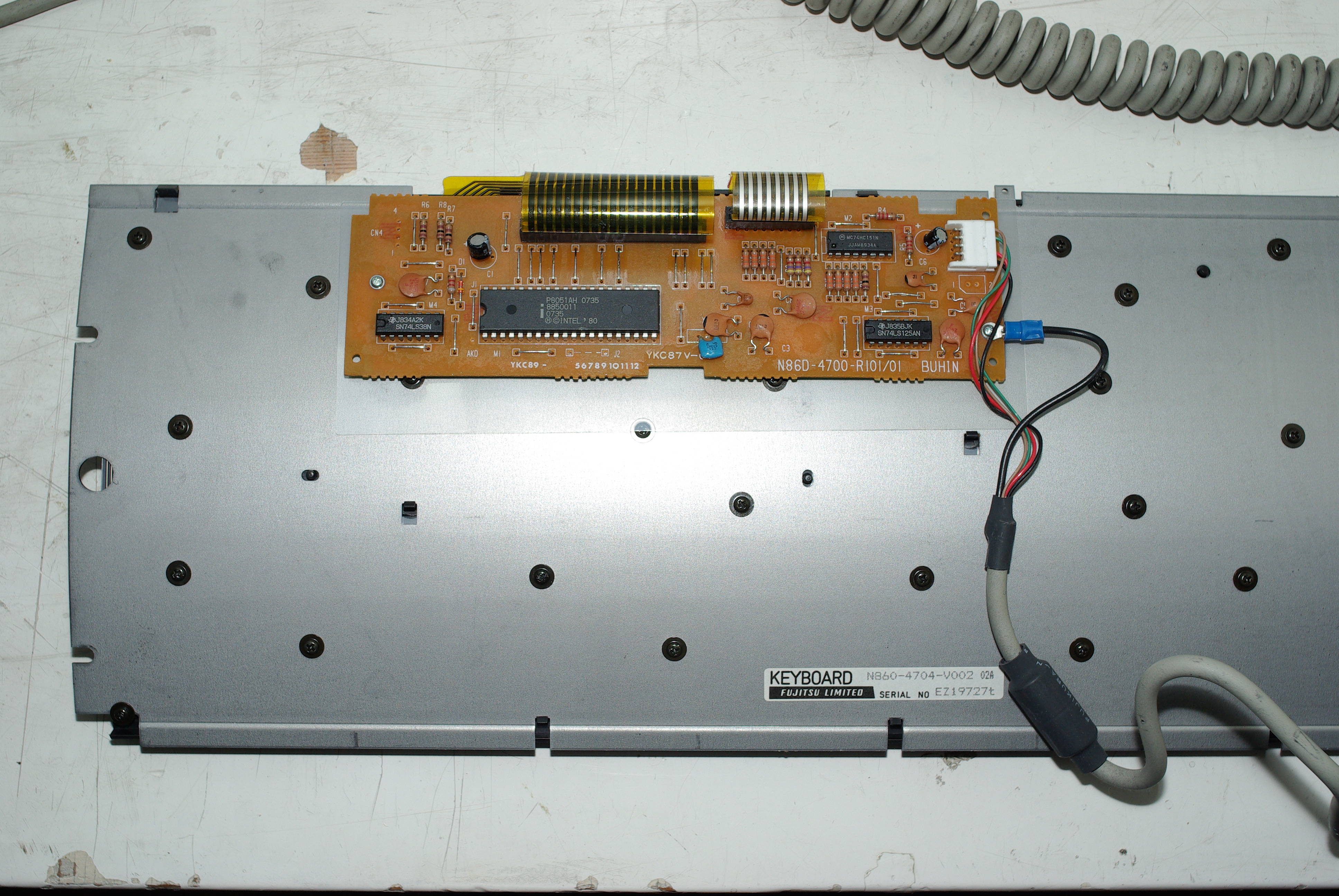

Interesting picture of this Sanyo keyboard!
09 Jan 2015, 12:00
Madhias wrote: Interesting picture of this Sanyo keyboard!
here's the rest:
http://deskthority.net/photos-f62/fujit ... t9119.html
