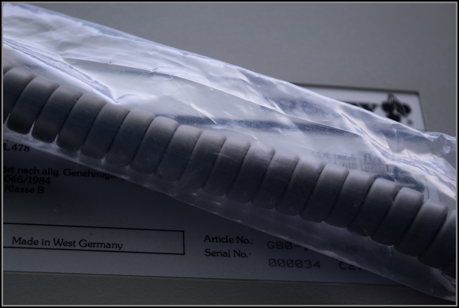

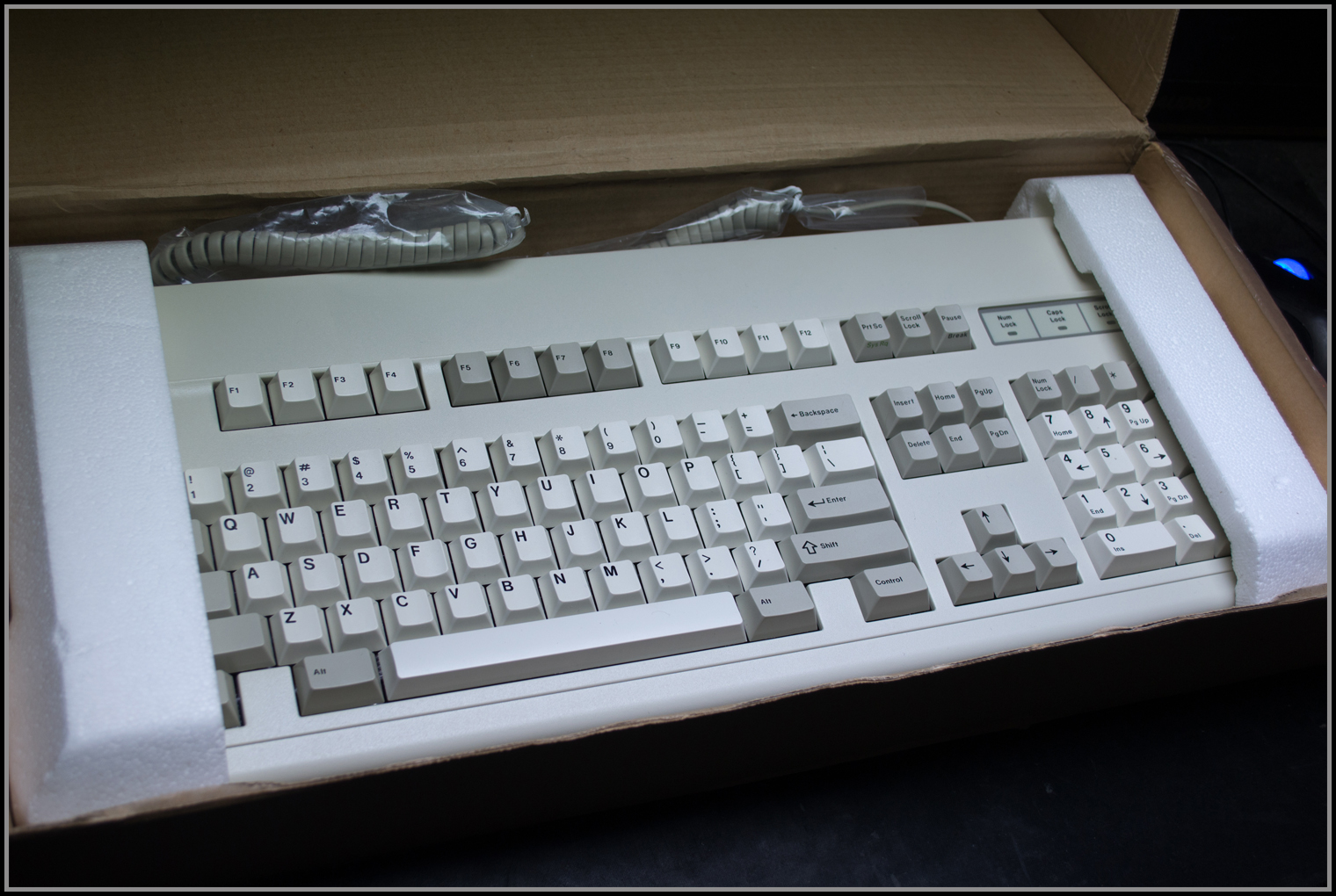

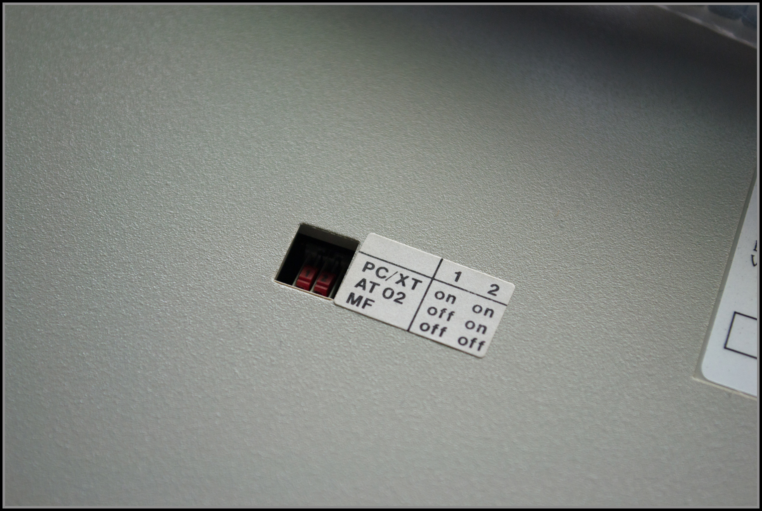

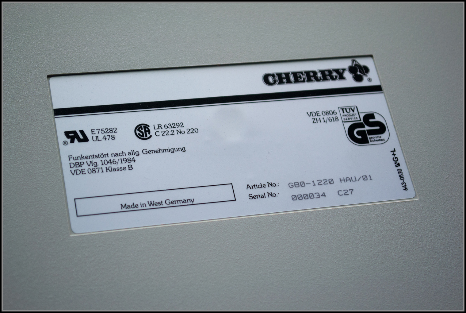

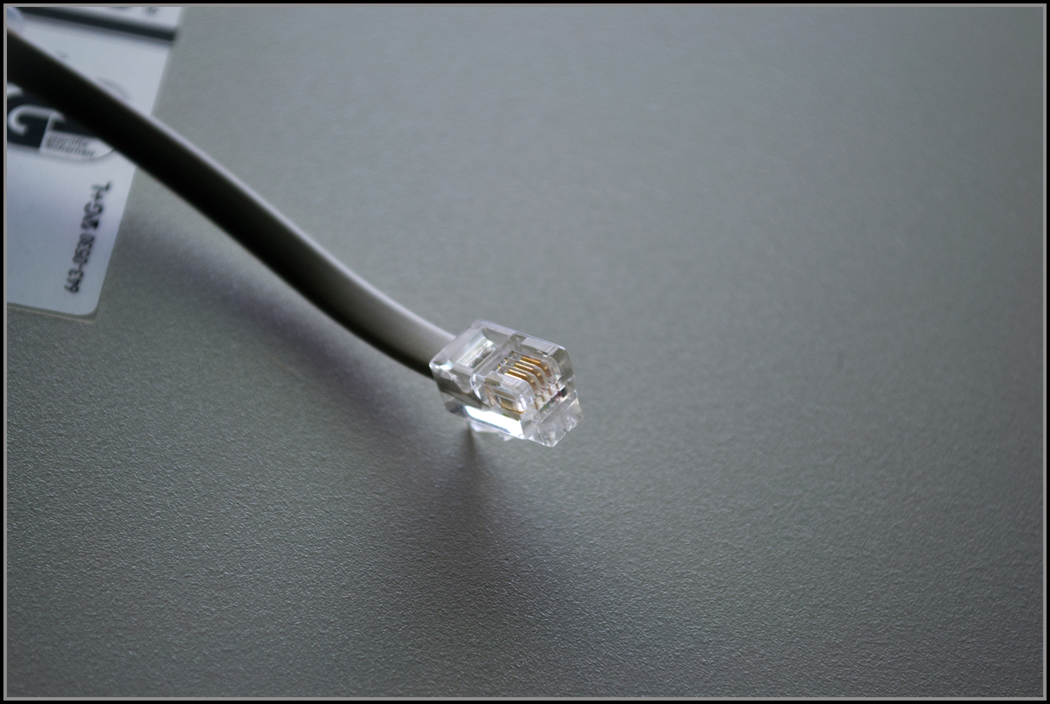

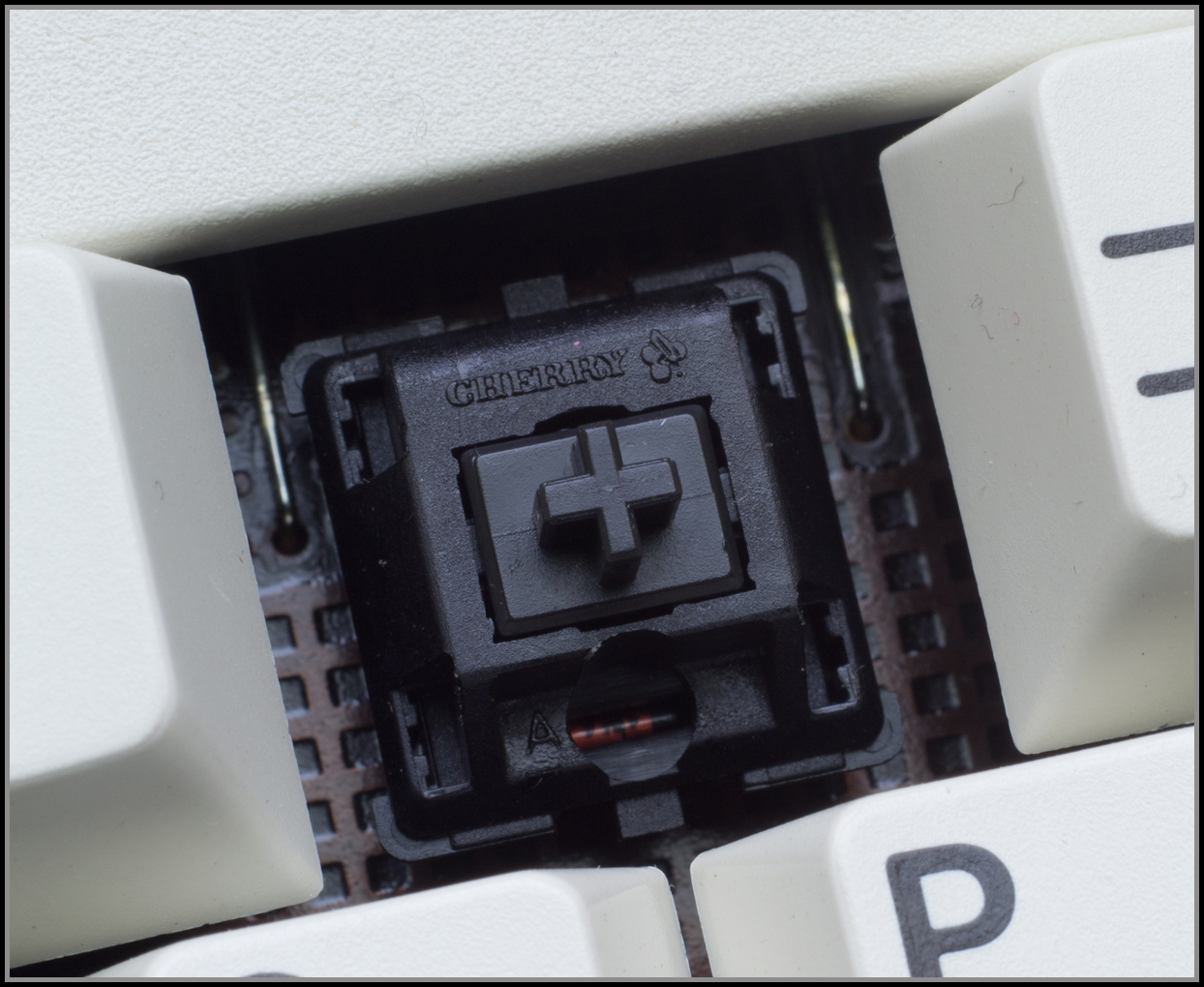

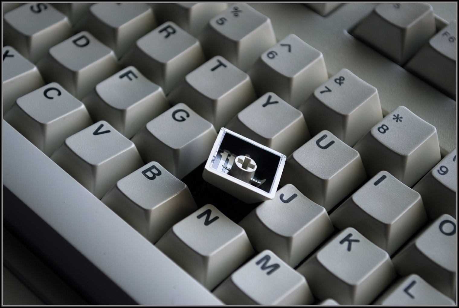

Got this earlier today. A lovely G80-1000 series from 1990 with MX blacks and doubleshot keycaps. Unlike most others, it has a serial connector. Since there is an interface switch on the back which includes AT, it's my hope I should be able to get this working with full NKRO [see diodes in switches] with a passive serial->PS2 adapter. I'll just need to get the pinout right.

Nice board, I don't think I've ever seen a serial G80...I'm guessing as its got a strange product number it was for a specific customer.

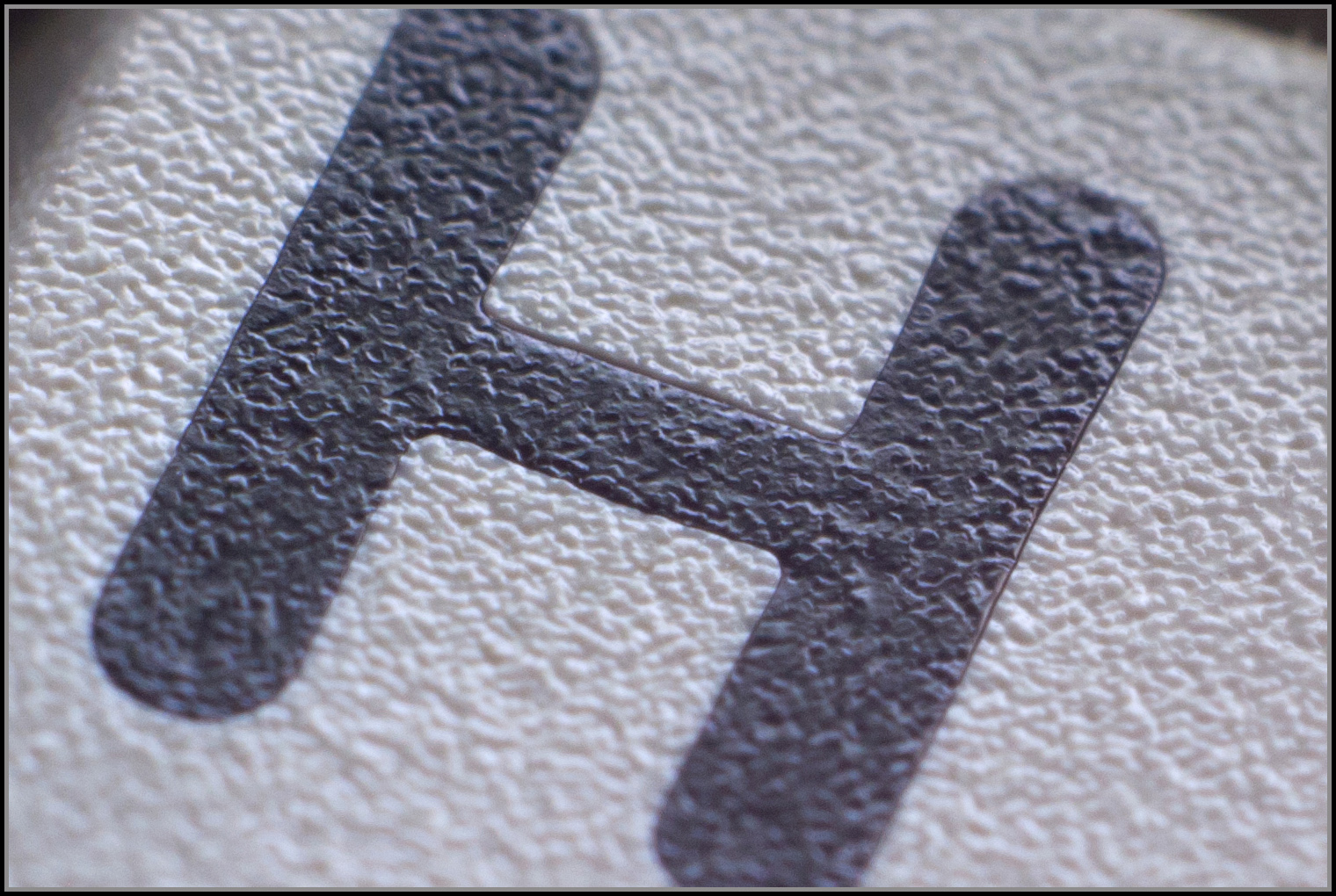

those close up detail keycap shots of yours keep getting better and better. Awesome. Congrats on that G80.

Thanks for the offer Ascaii! I've already got plenty of cables though, and I don't want to actually touch this board. I'll be making an extension cable that adapts serial->ps2.

Nice find! Nib?

Yes, but the box is ruined by tape and marker.. :cry:

It 4P4C connector, just same as Dolch... if it does speak AT it have high chance of being same.
To be sure, you'll have to get a look at the cable pinout on the PCB to make sure it match AT on normal 1000 model. Should be simple from there.

IvanIvanovich wrote: It's not serial, it 4P4C connector, just same as Dolch... if it does speak AT it have high chance of being same.
There lies my problem. I cannot remove the PCB because of the way it's attached :lol:
