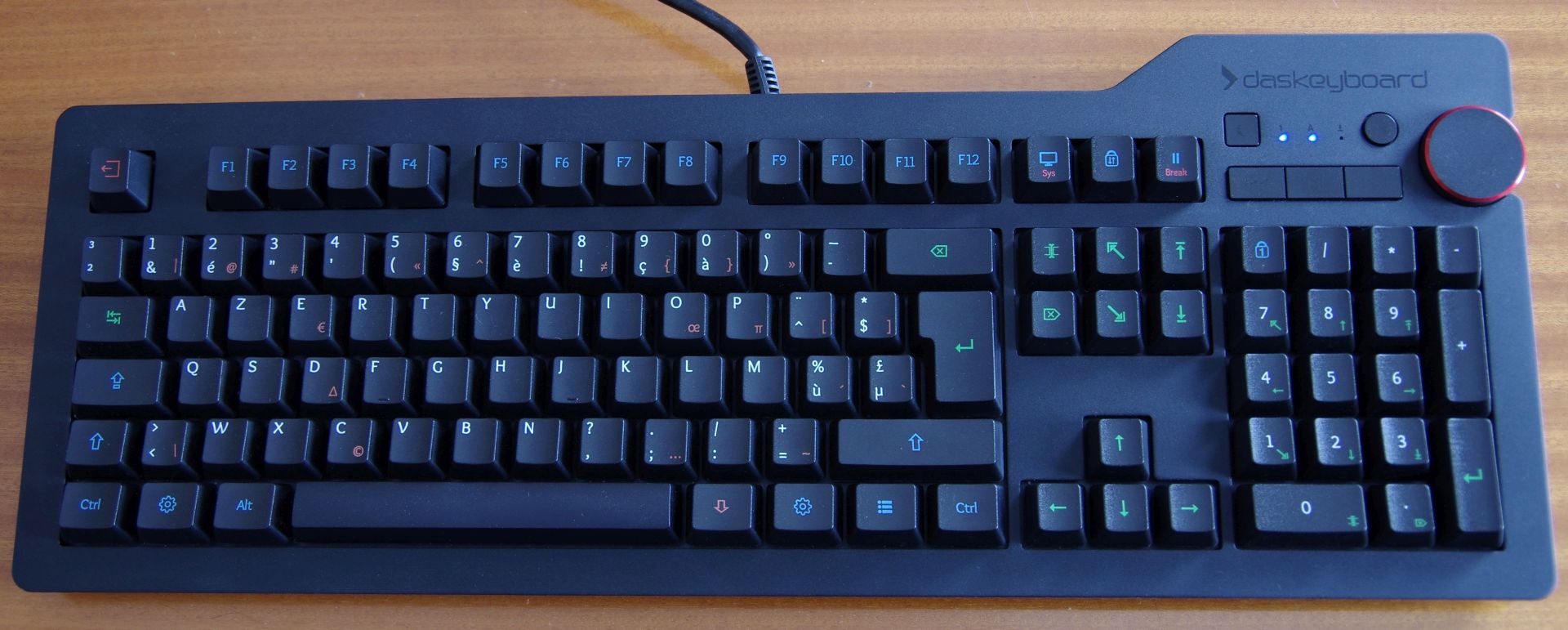

Since there are no international keycaps on the Das Keyboard 4, I finally decided to make a custom one. Started with the blank keys but it was sometimes a bit annoying when I had to type with one hand, for confirmation codes and so on. Right, the perfect excuse ;)
[url=http://"http://support.wasdkeyboards.com/"]WASD Keyboards[/url] made a wonderful job, overall I'm very satisfied! They did have to reprint a couple of keys, but the difference from the specs was very minor, barely noticeable, and they were quick and reactive to the problem, even gave away a few stabilizer inserts I needed for free :)
The material is pleasant to the touch, which was my main concern. It's still ABS but I find the touch feeling on par with the original keys from Das Keyboard, even slightly better, perhaps a tad rougher and thus less slippery due to the UV print process - that might not be true if you compare to the printed keycaps of the Professional version, I couldn't say since I have the Ultimate.
If you want to swap the keycaps on the Das, don't forget to get those Costar stabilizer inserts, you'll need 6 pairs (the spacebar has Cherry stabilizers and doesn't need any); Metadot had the stupid idea of gluing their inserts to the keycaps, so most of them can't be recovered! Other than that, the keycaps are completely compatible with the Das Keyboard.
The colours are quite correctly rendered, though if you look the keycaps from a low angle you may notice process artefacts. It looks a little like the result of a dot printer: successive horizontal bands. But it's only the background, and if you look at extreme angles under a grazing light source, under normal circumstances it is not visible. You can see what I mean on the right of the photograph below, especially the numpad return key. The foreground has zero defect or artefact, and it's much sharper than laser etching of course.
For reference, the font I used is Overlock, this is an open-source font, easy to find. Don't forget to remove the fonts from the .svg when you send it to WASD, it's not mentioned on their website but you have to do it. Here's how:

I'm really happy with it, the only small regret is the initial choice of an Ultimate, for some obscure reason they decided not to print the "daskeyboard" logo and the media keys, the Professional version is looking better IMHO. At least they kept the red edge of the volume button.

On the assumption that it looks exactly like the photo, with fairly muted colours, that scheme works really well — very tasteful. However, I suspect that the JPEG compression has affected the colour and that in reality it's a lot less subtle (I always leave chroma sub-sampling disabled with JPEG images to avoid excessive colour damage).

The photo hasn't been altered, though the light conditions gave a feeble blue-ish touch to the colours, it's snowy winter.
Chroma sub-sampling makes sense to compress images, given the rate you target it's an efficient way to remove information vs the perceived quality of the result (which is arguably subjective and hard to quantify). Disabling it means more alteration to the luminance, which will be worse. Since it was a quick shot and honestly I'm not equipped to take professional photographs, I didn't care to extract the raw file and apply a lossless compression, I don't think it would have added much to the post anyway :)

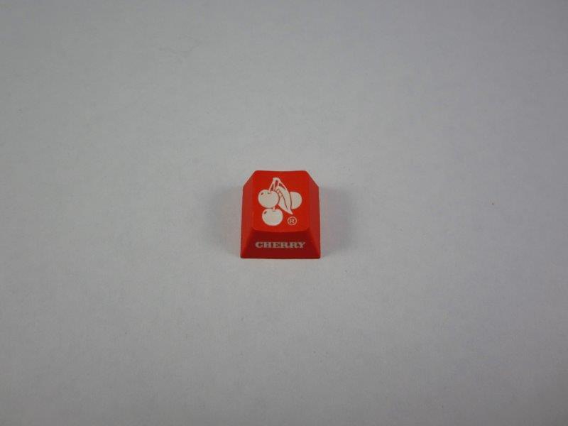

The other one is red corruption. Take the attached image, that I stole from some post recently (attached to stop phpBB from altering it).
Observe how the top of the keycap beyond the cherry exhibits banding. There are dark bands across it. This is caused by chroma subsampling (they're not there if you convert to greyscale), which for some reason always causes large red areas to show dark bands and blotches. If you imagine what the image started out like, there's no reason for the chroma to be downsampled to include dark bands. I've even seen this across huge red areas with nothing dark in sight.
This is probably the issue that I showed Thorsten when I wanted to know what was going on.
There are some pretty nasty problems caused by chroma subsampling, and the drop in image size isn't great enough for me to worry about switching it on and off on a per-image basis. I leave it permanently off. Quality of course is program-specific; I use IrfanView, and 75% quality for most images.
It's been years since I studied the effects of quality and subsampling, but I found that subsampling just did more harm than it ever did good.
Of course, it wouldn't surprise me if my visual perception is different to everyone else's.

That image deserves an award for incompetence! A well composed plate of horrible.
I see the dark junk on the red area, too. But look at the noise in the grey background. That noise is because whoever shot this did so with about a tenth as much light as they should have. Yet noise is actually quite demanding of a compressing algorithm. You know how percussion, and especially cymbals (which produce a nice rich range of noise) squelch badly in low bitrate mp3s? In fact, they drag down the quality of the other instruments whenever they are hit. The same is true for all high frequency domain stuff in digital compression. And camera sensors produce a load of it, which dominates the true signal when underexposed. That noise wasn't filtered out in this case, so it hogged the bandwidth! And I suspect it's smeared across the red area, leaving that wake of destruction.
Red and blue are the hardest colours for sensors, of course. As they lie at the extreme ends of the RGB sample range. Pure red is black in two channels. And black is badly affected by foolishly compressed noise, which is what I suspect is going on here.

Gee, I didn't take that photo, but this is precisely the kind of comment that makes me think twice about posting one. :( I have a very modest camera so I seldom take photos, anyway.
27 Jan 2015, 13:52
Nothing personal. We all take shitty photos. That's how you learn to take ones that suck less, until they're good!
What that picture needs is LIGHT. Cropping out the background would be good, too. And maybe getting closer to the cap, if at all possible with the current lens. Three big things, dominated by one that's very wrong indeed.
To their credit, the angle's nice and straight! Usually, bad pictures are shot all skewed, by someone who very clearly doesn't care about what they're doing. (Ebay sellers!!) This one makes me think someone was trying, and could improve.
27 Jan 2015, 20:19
I am not sure why the person who took that photo is due so much ridicule. It's not fair to expect everyone to be a visual person, and it's just a random photo from the classifieds that caught my eye because of the damage caused by chroma subsampling. It's not like it's a wiki photo!

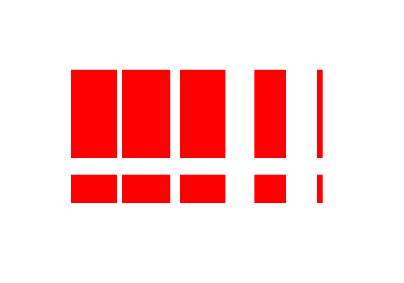

Here's an example that doesn't involve noise. Simple test image involving red and white, which you can inspect.
I've saved two JPEG images from it, one with chroma subsampling enabled (at whatever setting IrfanView uses), and with it disabled.
With chroma subsampling enabled, all the red areas get an inner fringe of dark red. Also, you'll see that the chroma spills out around the red areas, with the white becoming pale red. With chroma subsampling disabled, the edges are sharper and cleaner, with no red spill and no dark fringing.
I don't pretend to understand it; I only know empirically that chroma subsampling causes undue damage to images. This is why I expressed concern that the legends shown in the photo may not be the colour you see, because of alteration of apparent luma, as well as chroma spill, in addition to the obvious problems with JPEG at any hard boundary.

Seeing your objective tests, here's a couple of jpegs I just made on Mac OS X from your png reference file:
Red 20k.jpg (19.86 KiB) Viewed 7803 times
Red 12k.jpg (11.86 KiB) Viewed 7803 times
Can your app tell you if they have the chroma downsampling you're focussing on? Because the only difference between them that I made was pulling down Preview's slider to force a smaller file size with the second one. Looks like simple over-compression to me.
The mathematical details of how jpeg goes about this are on Wikipedia. All looks quite hairy and well worth using wisely, in moderation instead of extreme!
