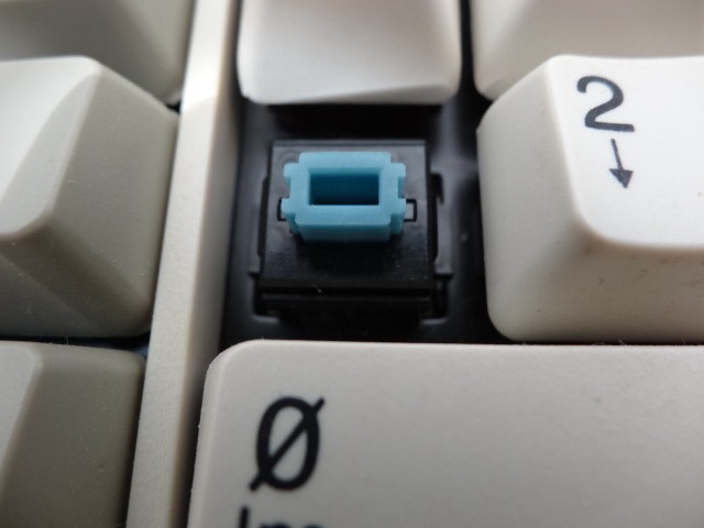

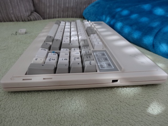

Hi,
I would like to ask you about this keyboard - or mainly about the switch: What type of switch is it?
It is tactile, according to the label the keyboard (sorry, new one, uncleaned yet) should be NMB RT-101+ model, however it is not hi-tek space invader (as noted here wiki/NMB_RT-100/RT-8200_series) so probably it is another NMB type. I did not find it here (wiki/NMB_keyboards), so I am curious what type of switch is it. Thanks a lot.

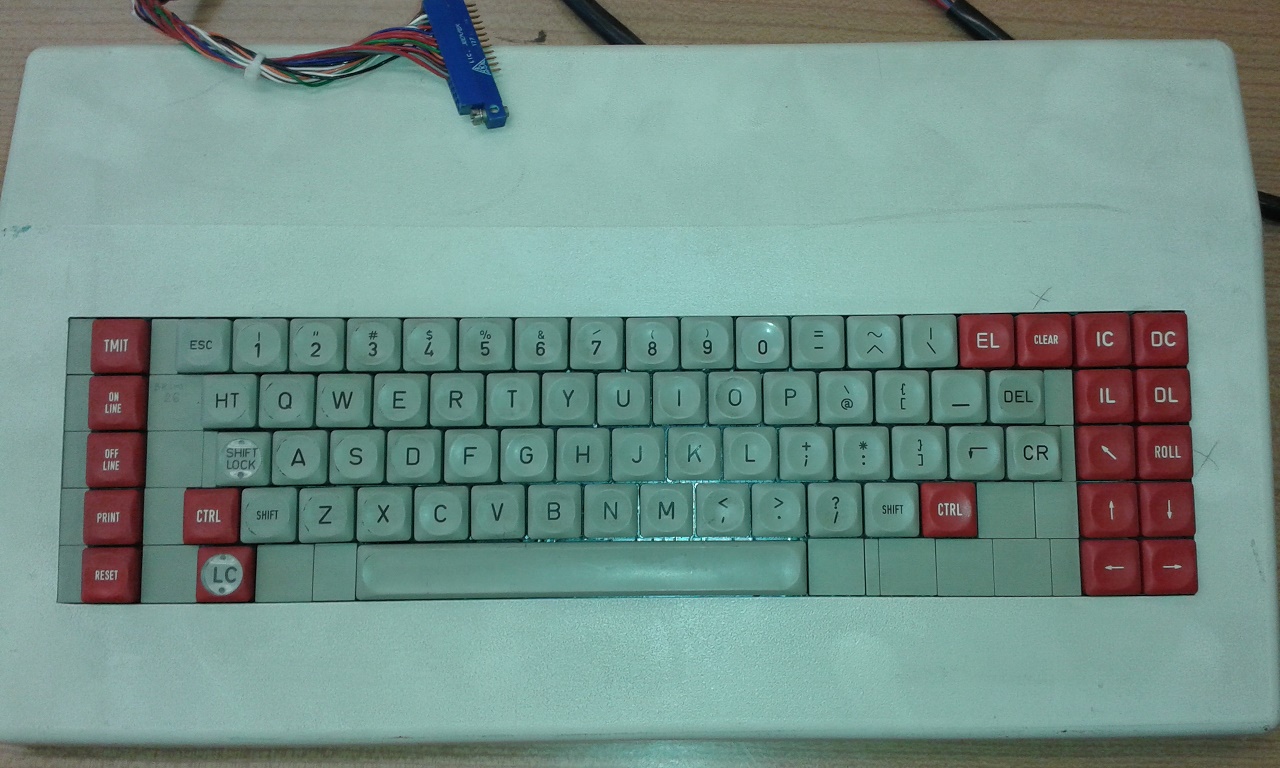

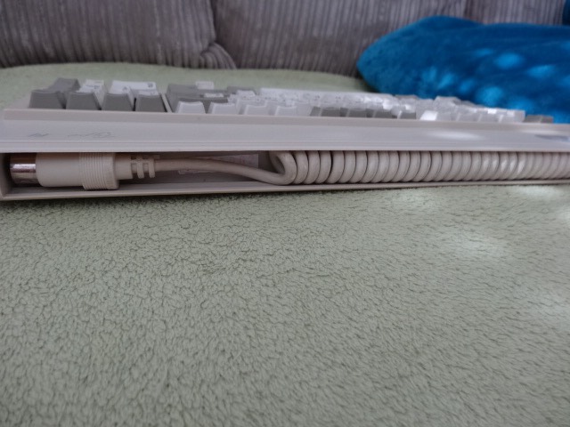

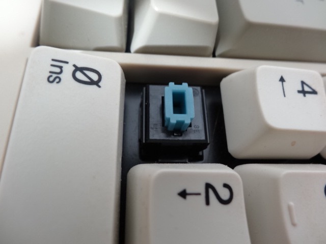

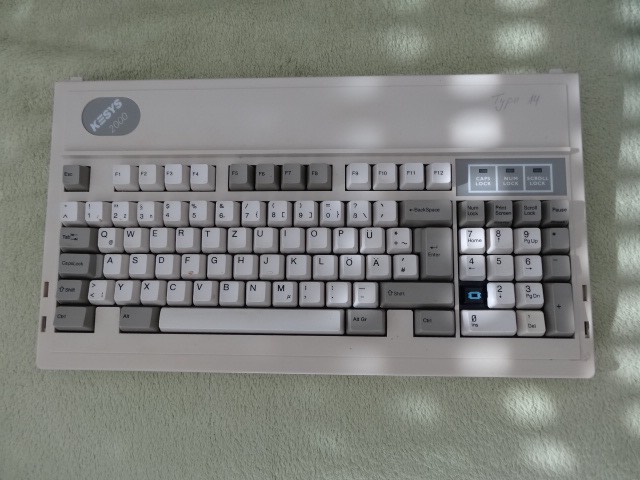

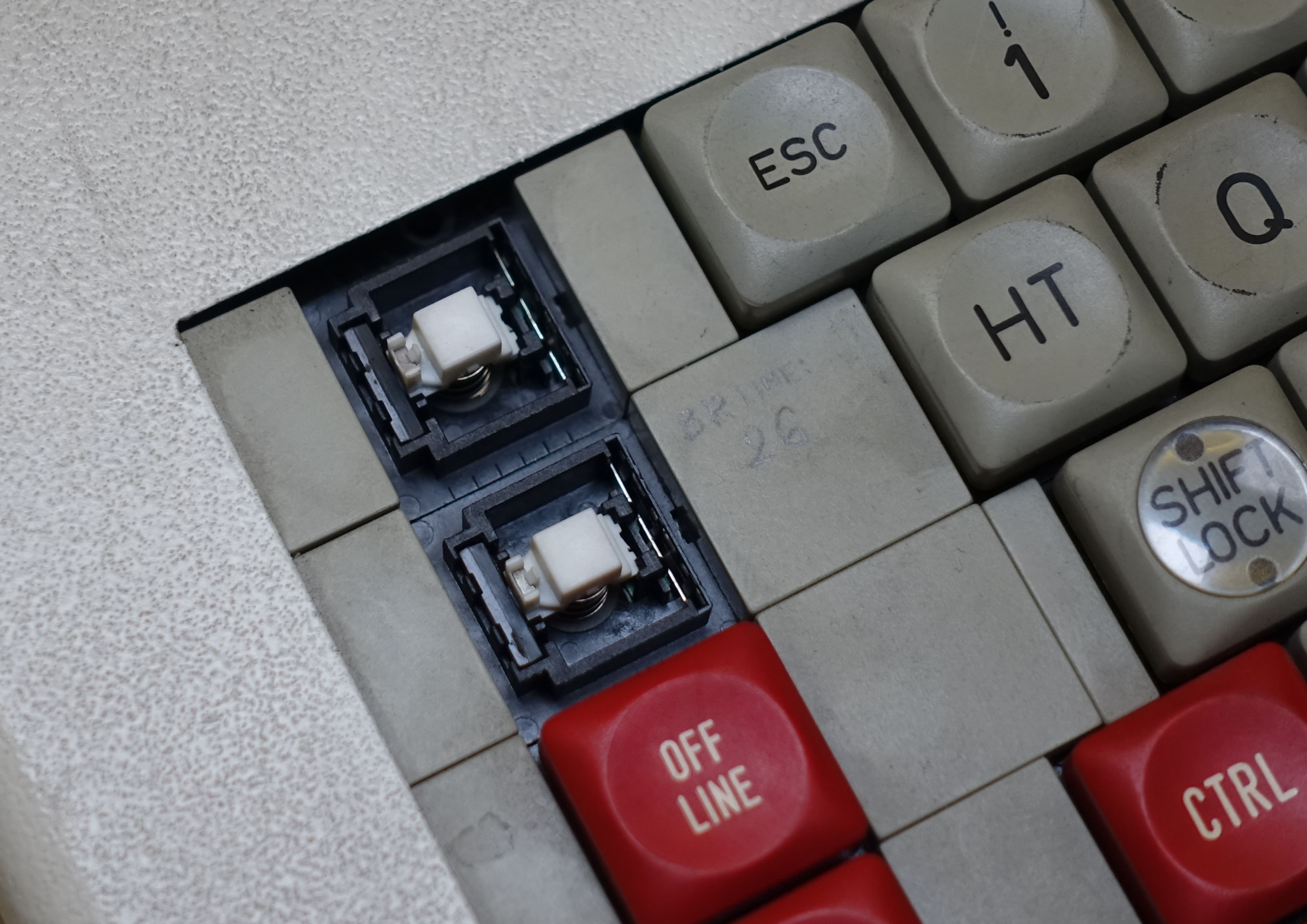

Well, I got lucky! This has NOS quality blues (from being dust-protected inside the portable setup and carrying bag), probably dyesubs and a nice compact layout with a regular DIN connector, so it can be used via USB easily...
Red_October wrote:Only thing I've ever seen that looks like that is an Acme (really) portable computer which used clicky white Alps switches. It also needed a custom PCI card to adapt the signal from the VGA socket on the regular graphics adapter into something the flat panel could make sense of. Which, of course, it was missing.

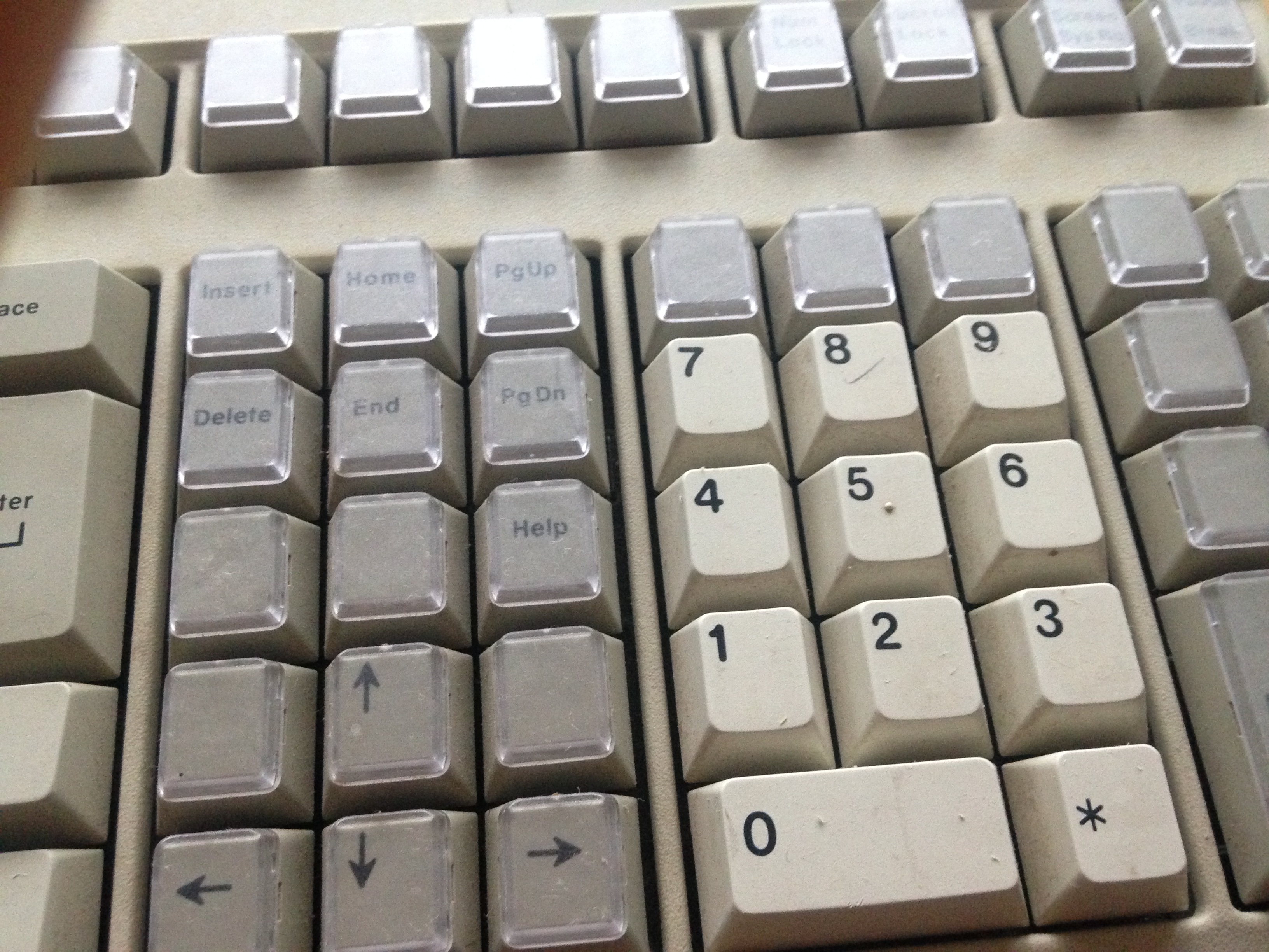

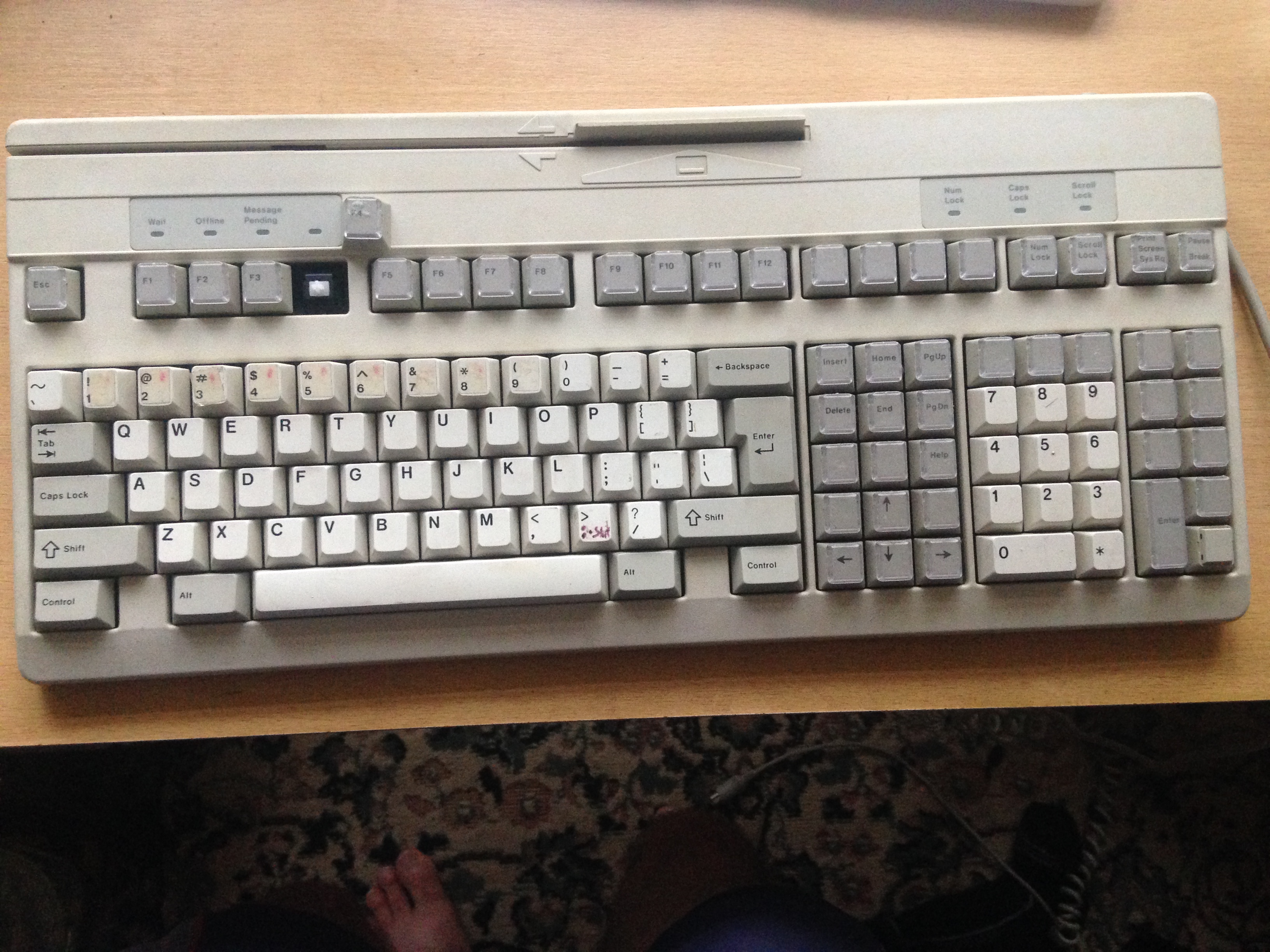

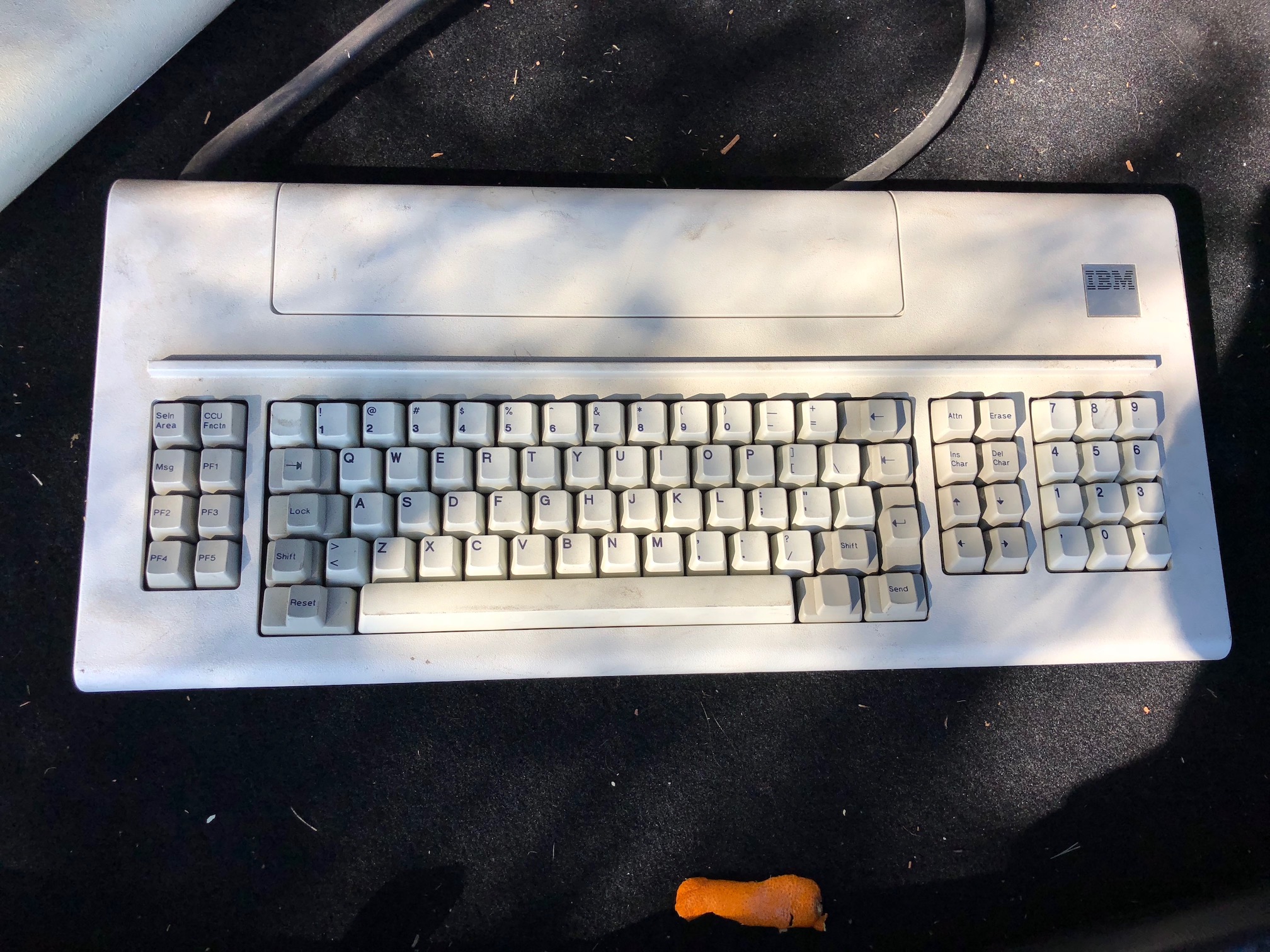

Which model/brand this one might be? No label on the back, some keycaps are with clear plastic tops/covers /see detail photo/, keyboard is with card reader. Cherry MX-clear switches.
Thanks

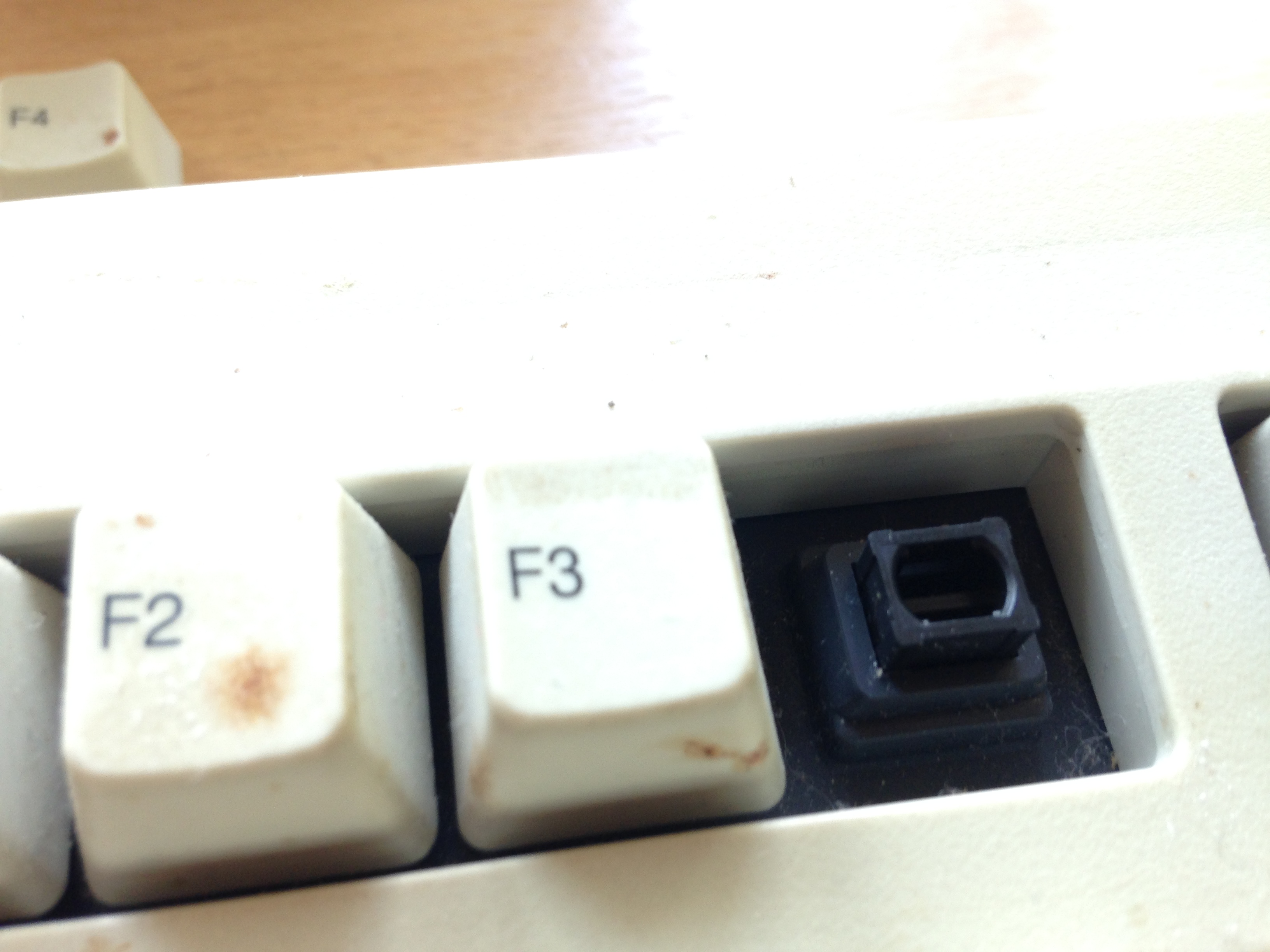

Anyone know what kind of switch this is? It's cherry mount, linear, and scratchy as all hell!
Thanks!

Did you get the whole unit, or just the keyboard? I seem to remember this stuff was at a recycler...Keybug wrote: Well, I got lucky! This has NOS quality blues (from being dust-protected inside the portable setup and carrying bag), probably dyesubs and a nice compact layout with a regular DIN connector, so it can be used via USB easily...

Excellent! If it is indeed an "Acme" it won't say anywhere on or in it. The only way I know what the one at work is is by virtue of having the bag it came in, with a thick sheaf of papers which turned out to be a printout of the manual. It is also through this sheaf that I learned of the graphics adapter-adapter necessary for the flat panel display. If yours has such a card please pass on to me details of it!

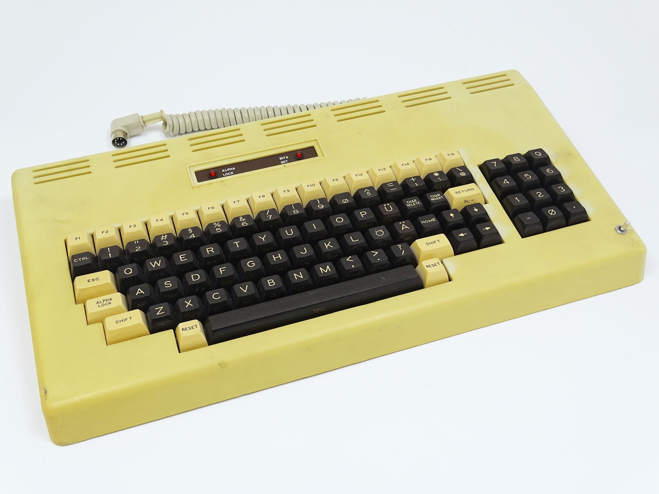

Hi!
Can someone identify this keyboard/keycaps please. I'm interested in the keycaps mostly.
The keyboard look like some custom stuff but they keycaps are familiar. I saw them somewhere, not in red but in grey. It has a label T6093 and a serial 156/84.
I'm thinking about buying it. It's around 37 USD / 32 EUR in my local currency.
Thank you!
EDIT:
Keyboard: TKI T6093
TKI - Telecommunication Research Institute, Hungary
Manufactured probably before 1989 (somewhere between 1976-2000)
Switches: RAFI RS 76 C
Pic in
Thank you!
EDIT:
Keyboard: TKI T6093
Pic in

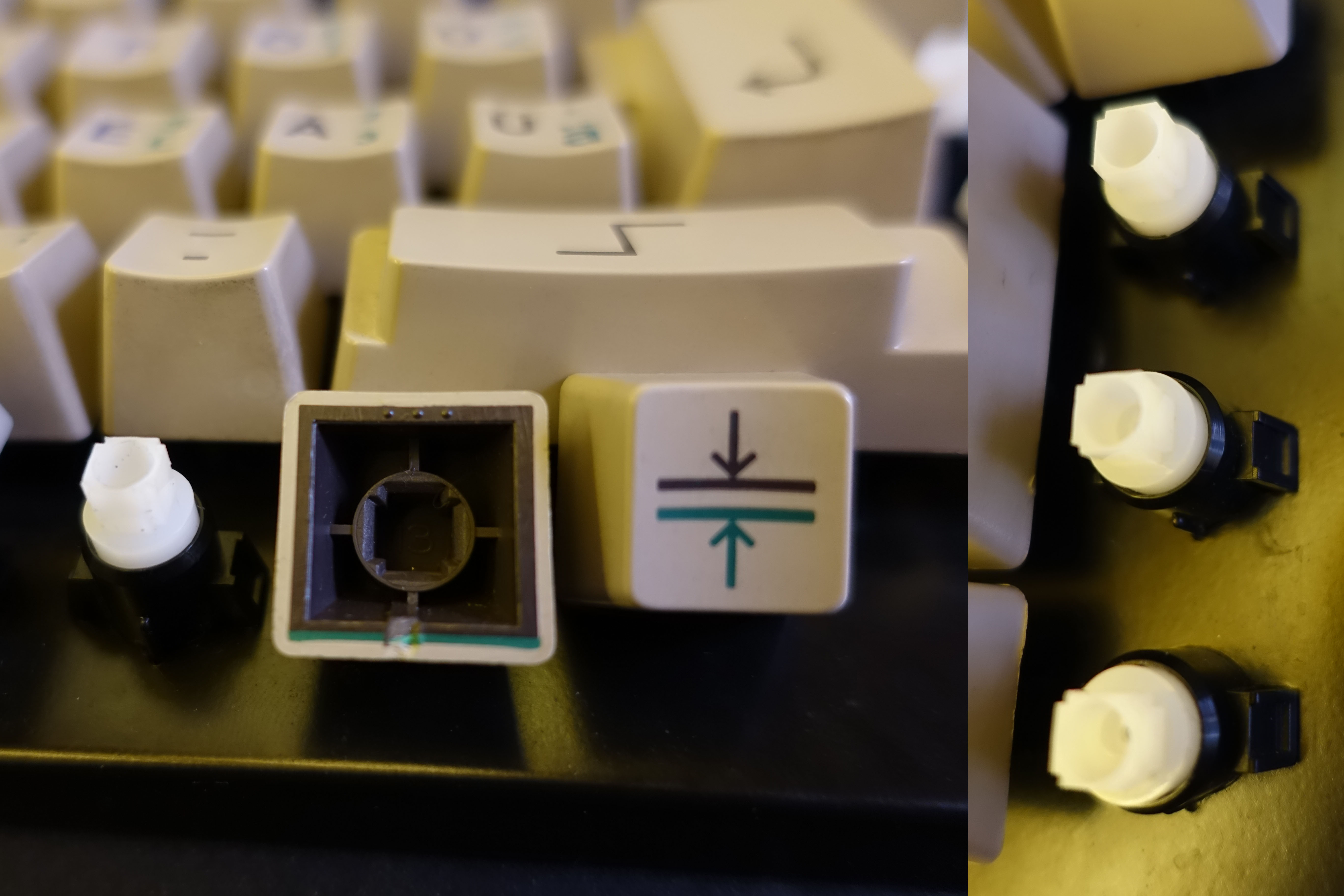

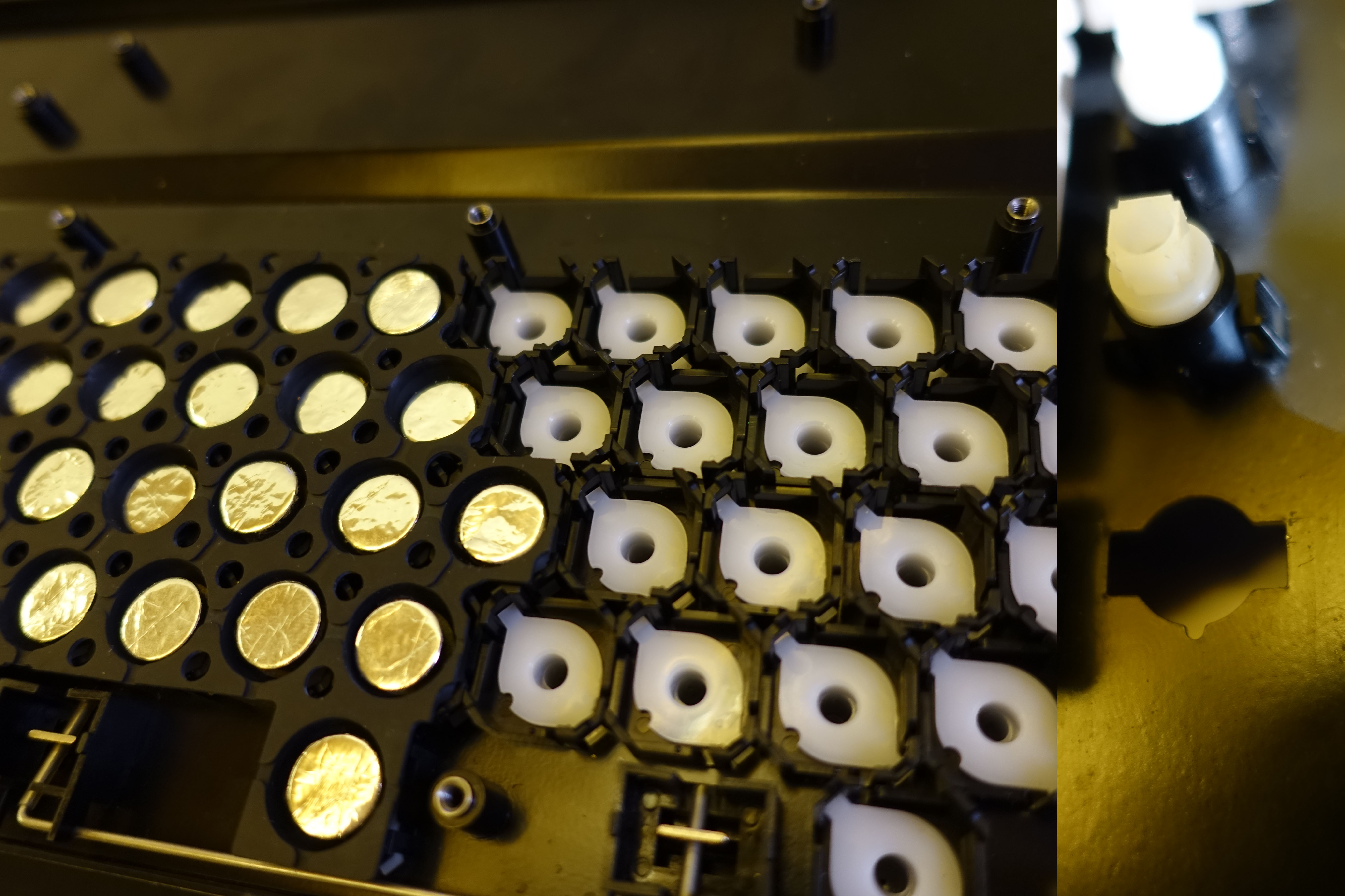

Hi!

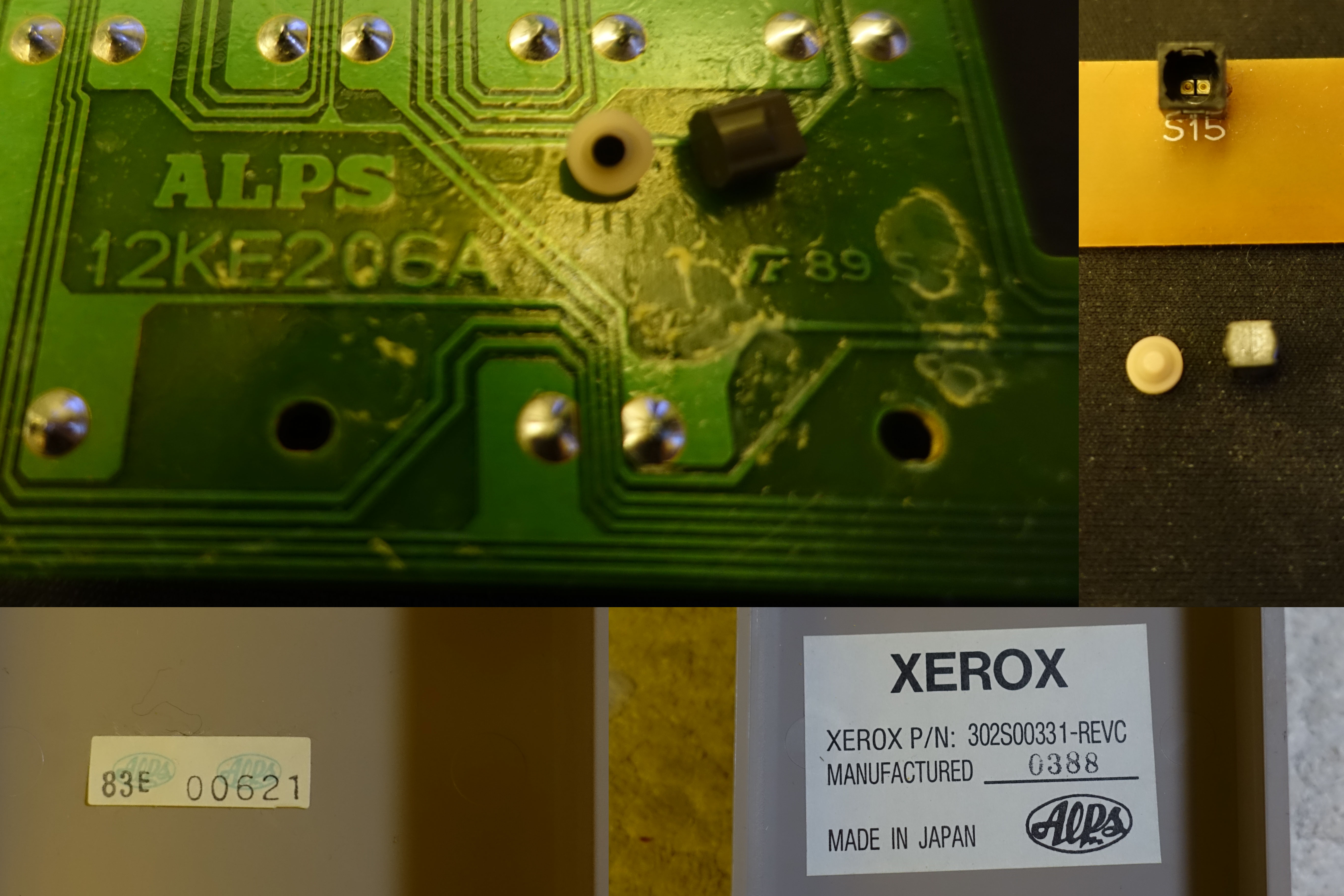

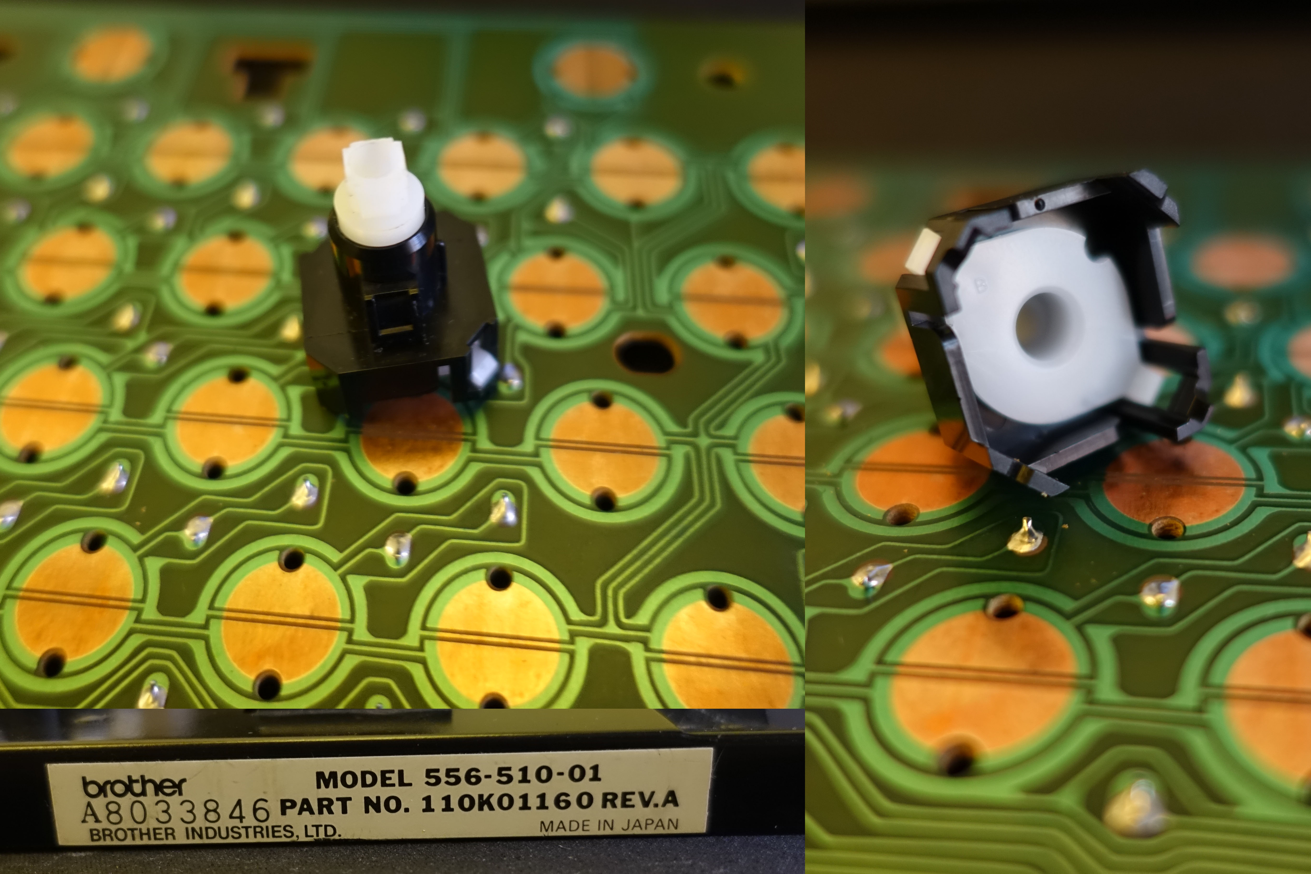

I'm here with a new question. Today I bought a Xerox 6020 memory writer. It has foam and foil keyboard assembly made by Brother. The PCB is very similar to the Minolta KY-1 PCB I saw on the wiki. The sliders have this extra fat cross mount. The switch plate is 1 mm with circular cutouts with 2 squares on each side. The keycaps are double and triple shots. I was browsing the wiki but I don't find more info. I have déjà vu again. I saw these mounts and the pads somewhere maybe it's in the wiki. My question: is this keycap mount available on any vintage mechanical switches or its just foam and foil.
Thanks a lot again!
Thanks a lot again!
- Chyros
- Location: The Netherlands
That system actually looks quite a bit like Brother's DOME and foil system, often nicknamed Prototopre - although the mount is different.
Maybe it would fit Honeywell/Micro Switch?
N9vem
- Location: Hungary
- Main keyboard: Roccat Ryos TLK
- Main mouse: Roccat Nyth
- Favorite switch: something not clicky
Can it be something alps related? The keyboards upper part which have rubber buttons was manufactured by alps. The mount are a bit similar to the alps magnetic reed's cylindrical slider also.
Thank you for helping me out again.
