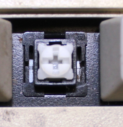

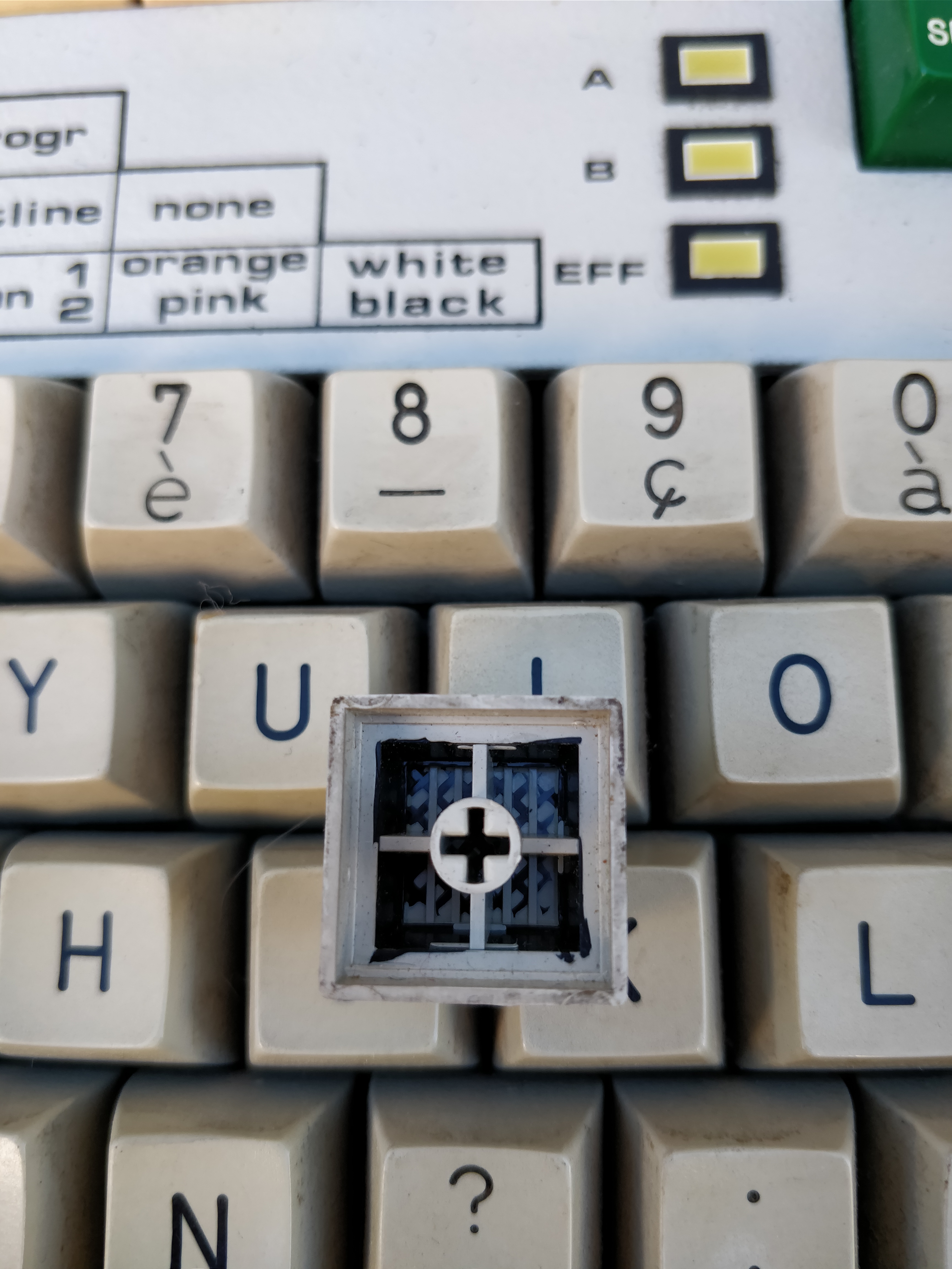

I have seen a nice keyboard on a local ad webiste. One key is broken (keycap missing) and the seller has provided me a picture of the switch to help me identify it. Though I have not been lucky checking Deskthority database.
It looks like a Sasse series 25, though the cross in the middle is not protruding but recessed ... (or head of switch broken)
Not very sure...
Here is the switch :
29 Mar 2018, 23:29
Since you are in France, it will be [wiki]Clare/Pendar low profile reed[/wiki]. Clare-Pendar Series S880, the US series, is virtually identical.

Macence wrote: I have seen a nice keyboard on a local ad webiste. One key is broken (keycap missing) and the seller has provided me a picture of the switch to help me identify it. Though I have not been lucky checking Deskthority database.
Not very sure...

The momentary switches are rated at 50 million (France/Belgium) and 100 million (US) cycles. It's the alternate action switches that have a low rating (1 million for the European series), which will be the limit of the latching mechanism. It's normal for alternate action switches to have a much lower rating than momentary switches. 1 million is fairly high for alternate action; even Cherry's super smooth locking system was only rated at 500 thousand cycles. For Datanetics DC-50 series, it was 100 million for momentary and 50 thousand for alternate action!
By the way, this may be the first ever keyboard we have ever found with these switches (certainly true if they're the European-made variety).

"Unfortunately" I am sure it is a US switch, probably wiki/Clare-Pendar_Series_S880 All the case has english video editing text around keys and the brand is American. I was hoping the keycaps were Cherry MX compatible but very unlikely, yet eager to push the keys and see.
30 Mar 2018, 00:23
I am not sure I've ever seen the US ones in a keyboard either (except one keyboard that has S882 alternate action). The tall US ones (S820) have been found in exactly one keyboard to date.These are very rare switches!

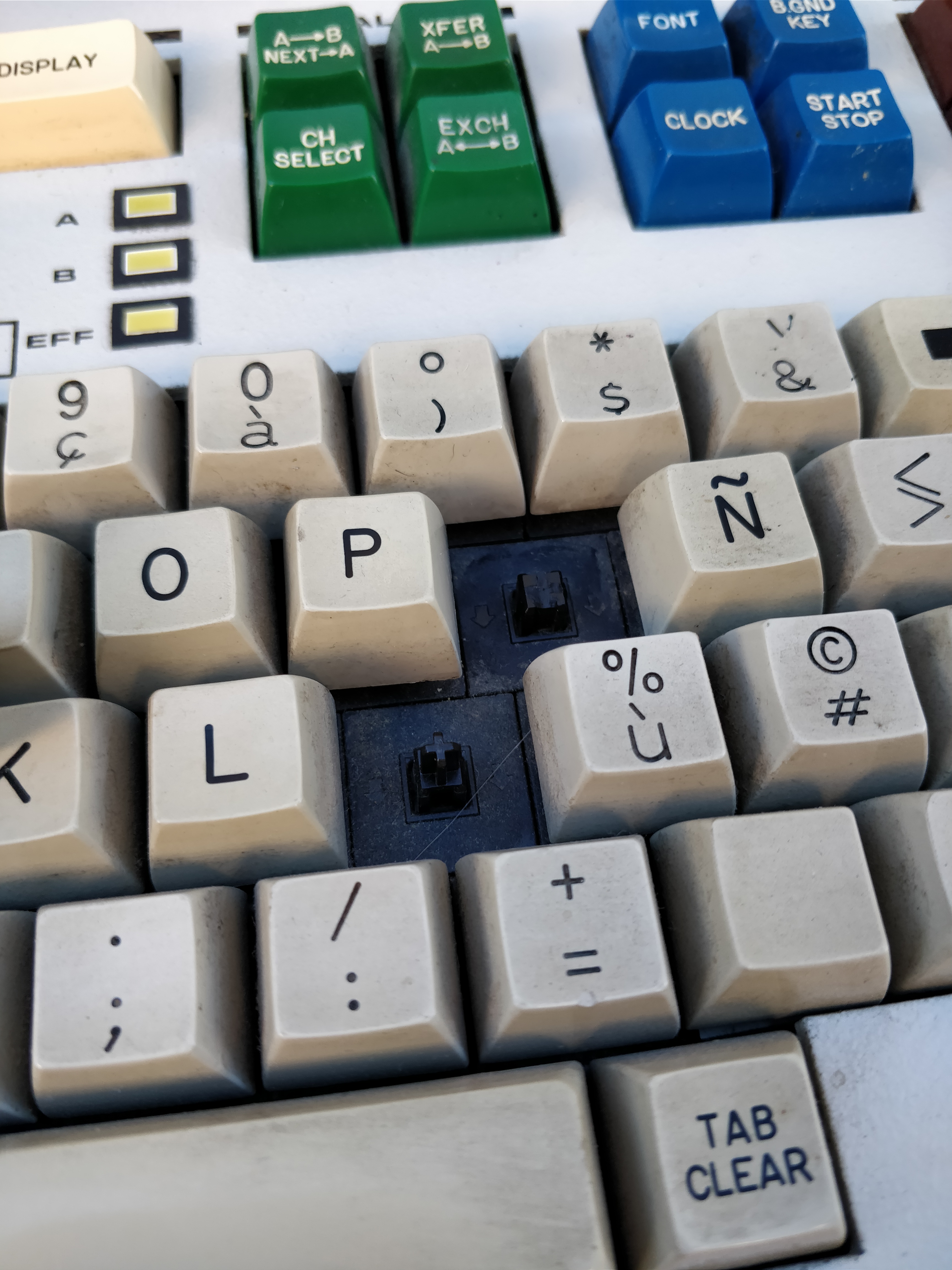

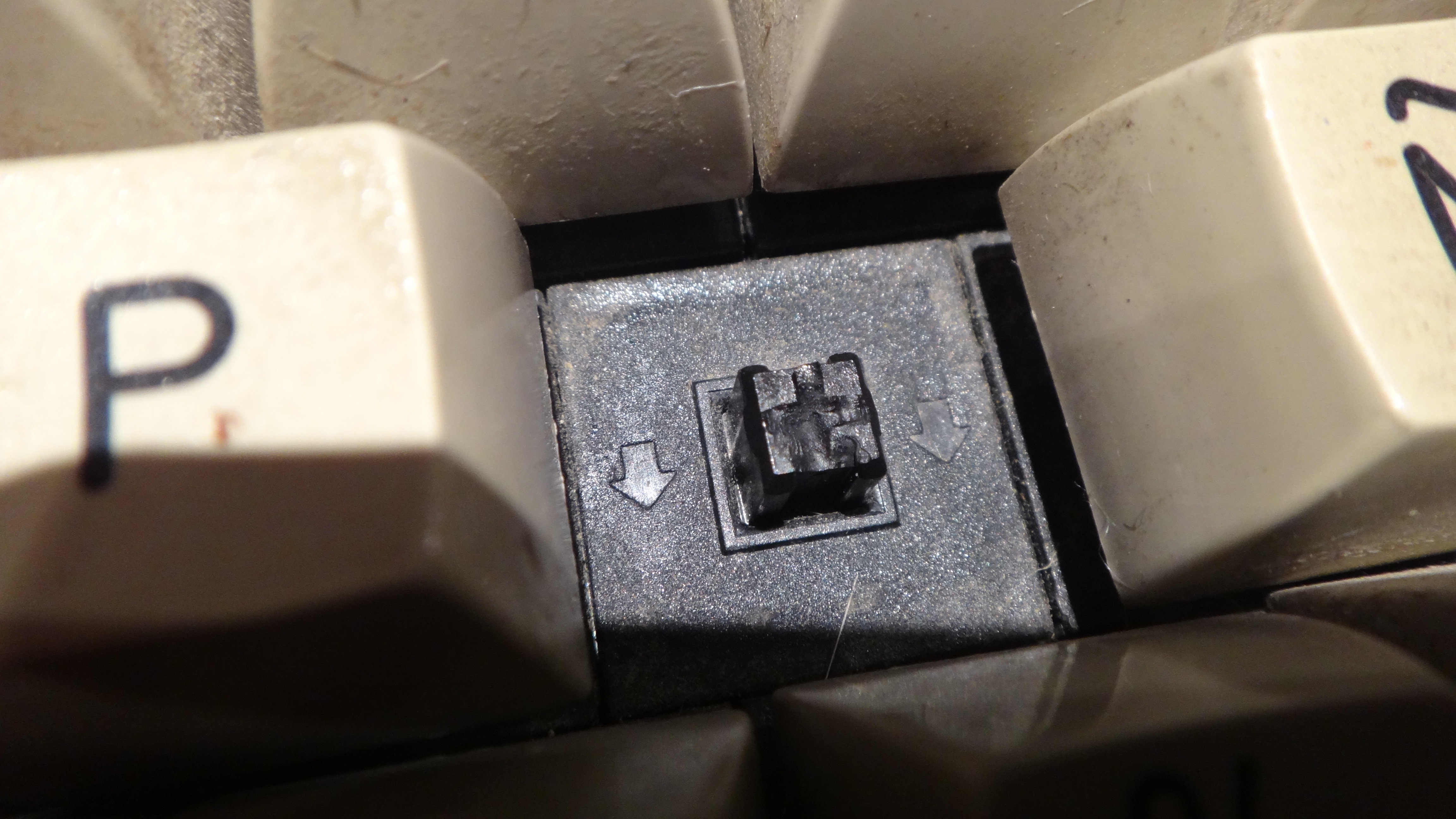

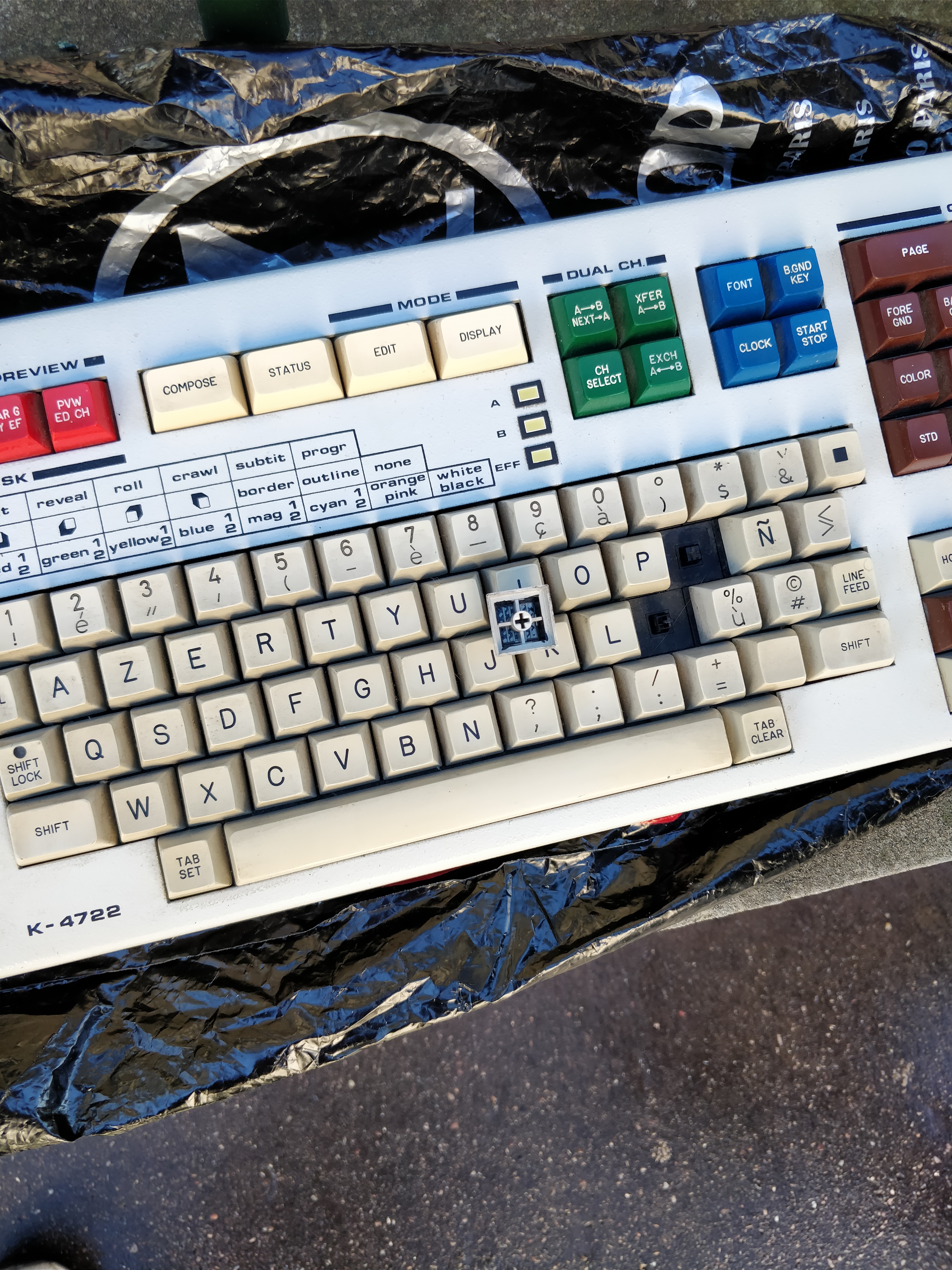

Hello. Well it was indeed a board with aforementionned switches. Though I didn buy it eventually.
Here are a few pics from my phone :
2 reasons that me hesitate :
* The caps colors were not as vivid as on the ad ( https://www.leboncoin.fr/collection/137 ... tm?ca=12_s ). Actually the top right keys are more of an 8o's brown, rather than a deep purple that I thought it was based on the pics. Red keys and yellow keys are really nice though.
* The switches are not that much satisfying. They are light linear switches such as MX reds but with mushier feeling. I guess the age of the keyboard is helping here. One huge drawback is the keys stability: keycaps were very wobbly and moving a lot when pushed laterally. Actually I have never seen such in an SA profile ( but I haven't been able to have a big experience with mechanical keyboards yet). Also I could't remove caps from the large keys but they felt even mushier.
Other info : caps are very close from Cherry MX compatible and connector is a RJ 11 / RJ 45.
31 Mar 2018, 18:20
These switches are damped, either with little damping prongs (something I've yet to photograph — my photography is just not sufficient to do justice to my collection of ~41 Clare/Pendar types, so that job remains pending) or with a rubber mat (as seen on the wiki under S880). This may be what gives the mushy feeling. The rubber mats can be removed easily.
It's still an interesting find regardless, due to the extreme rarity of these switches. As for the colours, they look a lot better in your photos under natural light. The photo in the advert seemed to be some kind of light source with terrible colour rendering.

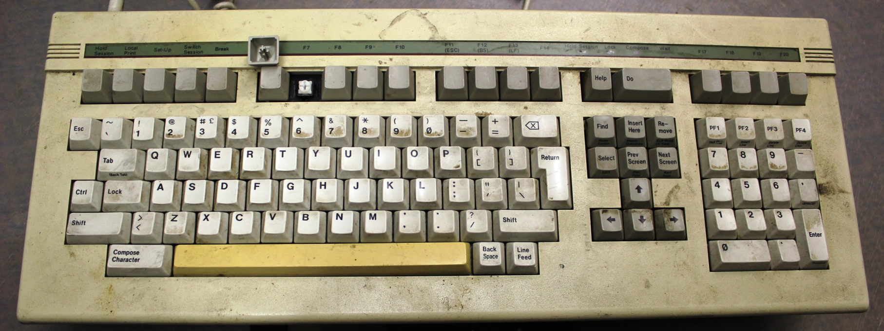

This keyboard is an LK-201 look-alike. I thought it might be a switch from here wiki/Inverse_cross_mount_recognition, but it has no screws or rivets on the corners. Can someone please identify it for me?
Blaise170
ALPS キーボード
11 Jul 2018, 21:58
I'm guessing slider over dome. Do you have it in hand?
elecplus
11 Jul 2018, 22:13
Blaise170 wrote: I'm guessing slider over dome. Do you have it in hand?
Yes, I do. It is linear.

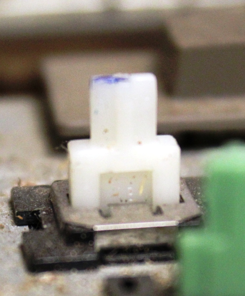

Daniel and I are having a discussion. The 2 old Canon typewriter keyboards have SKCC green, we agree on that. The question is the 2nd type of switch, found on Enter, Space, and Backspace. Please see https://www.elecshopper.com/2-old-keybo ... tches.html, and look at the cloaeup pics. These are white switches with a navy blue stripe on them. Attached is a close-up pic, and yes, I know the switches are filthy.
The metal plate has a tab that fits into a groove. When pressed, the switch moves down until the tab meets the groove, then stops.
Identification of switch, please? Does anyone else have these?
