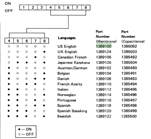

1389106
1351710 blank caps set
1370580 trackpoint M4-1, M5-1 or M5-2 cable split keyboard mouse ps/2
6480185 1390120 box
