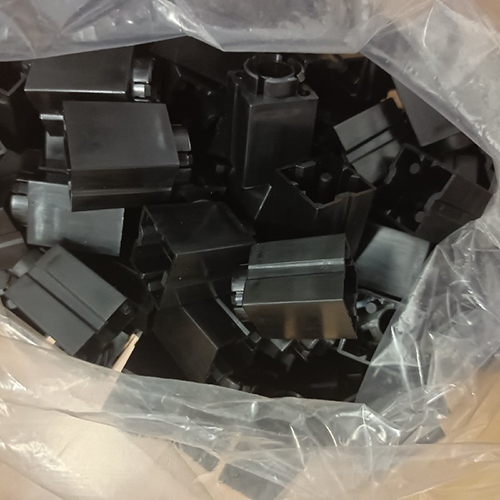

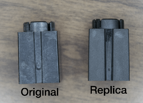

The key module. The replica is a sample mold, and the finish isn't final.
The finalized mold will be more consistent with the glossy surface of the original.
I received this picture this morning of the finalized mold, and they certainly seem more similar to the original.

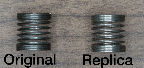

The compression spring. The replica is shiner due to age and material.
The replica is made using stainless steel, while the original uses music wire (which is prone to corrosion).

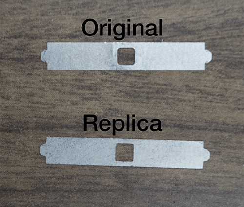

The beam spring. This part was particularly hard to produce due to its extremely thin height.

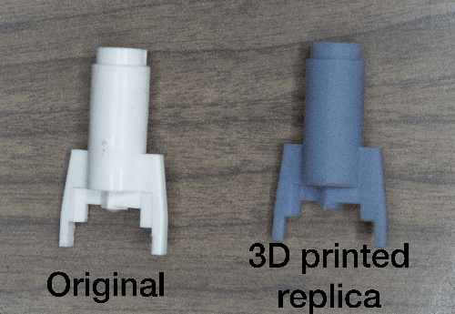

The key Column. As the injection mold for this part will be quite complex,
I only currently have a 3D printed version.

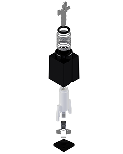

Rendered assembly of a beam spring switch using my CAD files.
Once I have all components produced, I plan to fully release all the design files.

In the original switch, the beam spring is insert molded onto the key column. Meaning, the spring is placed in the mold, and the molten resin flows through the square cutout and forms a sort of "cap" holding the spring onto the column. There's no denying that the large cutout produces some structural weakness in the spring, but I imagine the large cutout is necessary to ensure a strong flow of material through the spring to form the cap. It can be very difficult to get molten resin to properly flow in small gaps.
I really like the idea of using a small screw! Due to the logistics and tooling needed for the insert molding, the key column and beam spring assembly will likely end up being the most expensive part. However, using a screw and possibly a small washer would eliminate the need for such tooling. Using standard parts such as M3 screws could also reduce costs as you wouldn't need to produce your own screws. You could also reduce the size of the gap in the middle of the beam spring and increase its integrity as previously suggested. A side benefit would be the ability to replace the beam spring if damage occurred to it as well. The only initial downside I can imagine would be that this wouldn't be a true reproduction if I went that route, but I think the pros far outweigh the cons in this instance. I will immediately start exploring using a screw to fasten the beam spring to the column.

So, this last week I experimented with using a screw to fasten the spring to the key column. I no longer think this is a valid solution, for a couple of reasons; Primarily, molding threading is a very difficult task even with large threads. The precision needed to mold the threading for the size of screw the beam spring needs simply isn't feasible (this is often why in laptops you'll see the over molded metal nuts in the plastic shells of the assembly). I really didn't want to custom tool a screw, so I looked at existing screws to use for this purpose. I settled with a wafer head m2.3 screw as it's readily available, and super small and low profile. The issue is, the screw barely even fits through the already large hole in the middle of the beam spring, so reducing the size of the hole wouldn't be possible anyway.
With this in mind, I will be exploring other solutions. I think DMA's suggestion of using a removable mold element to slot the spring in is very good. I will be experimenting with a friction fit design for a removable "pin" that secures the spring to the key column.
