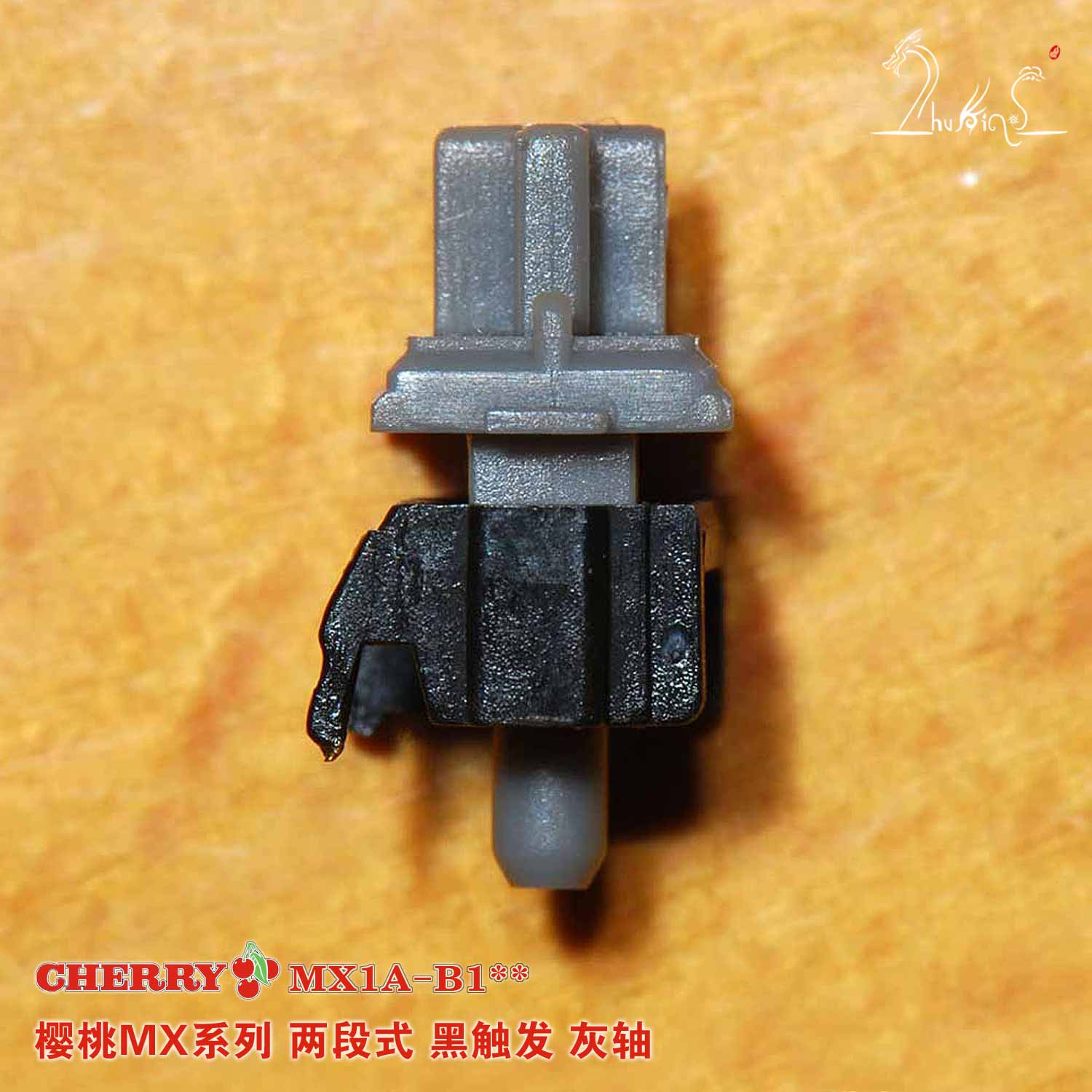

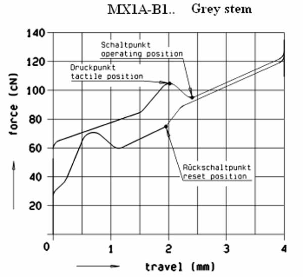

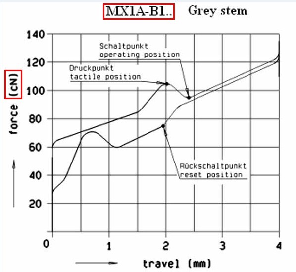

60cN for MX Blue? I measured activation in grams for a number of keys as follows:
               ESC       J         F5        4         E         B         ARRLEFT   Average
Filco 87MC     48.00     47.45     48.00     47.90     48.05     47.80     47.95     48g
I guess it's the difference between the Druckpunkt and the Schaltpunkt.

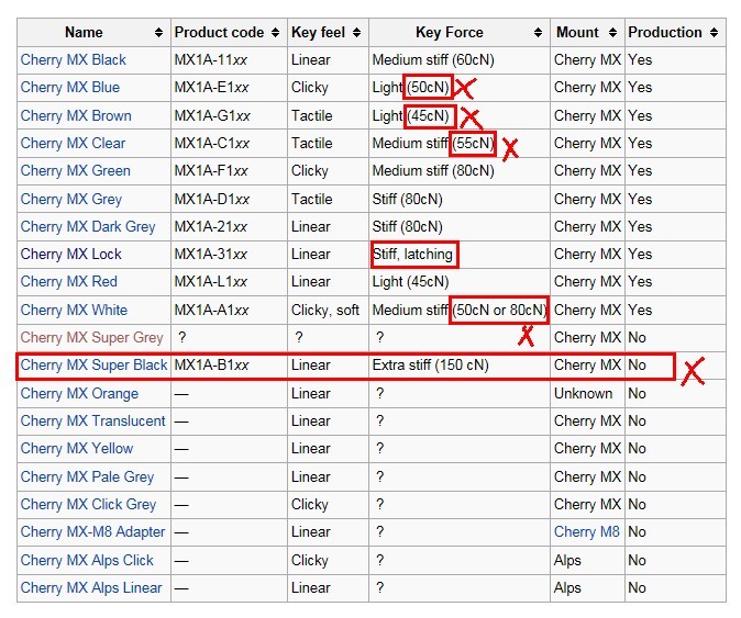

yab8433408
17 Oct 2013, 16:56
1CN ≠ 1g
MX1A-B1xx ≠ 150g

1CN = 1.02 grams of force, according to Wolfram Alpha. (The difference between assuming 10 and 9.81 ms^-2 for gravitational acceleration I assume.) In any case, not enough to explain the difference in these figures.

so thats a mx super blue in grey? :?
17 Oct 2013, 17:18
I think, what he want to tell us, is that the wiki entry is wrong and MX1A-B1xx is not a super black but a super grey.

yab8433408
17 Oct 2013, 17:28
7bit wrote:I think, what he want to tell us, is that the wiki entry is wrong and MX1A-B1xx is not a super black but a super grey.
@yab8433408:
Thanks for your great contributions!
:ugeek:
感谢您的解释,因为我不会英语,所以只能用图片表达我的意识……

It is called Super Grey in this version by 7bit:
http://deskthority.net/w/index.php?titl ... oldid=6044
Still Super Grey here:
http://deskthority.net/w/index.php?titl ... oldid=7389
Beardsmore! :twisted:
http://deskthority.net/w/index.php?titl ... oldid=9517 ("Super Grey is really Super Black")

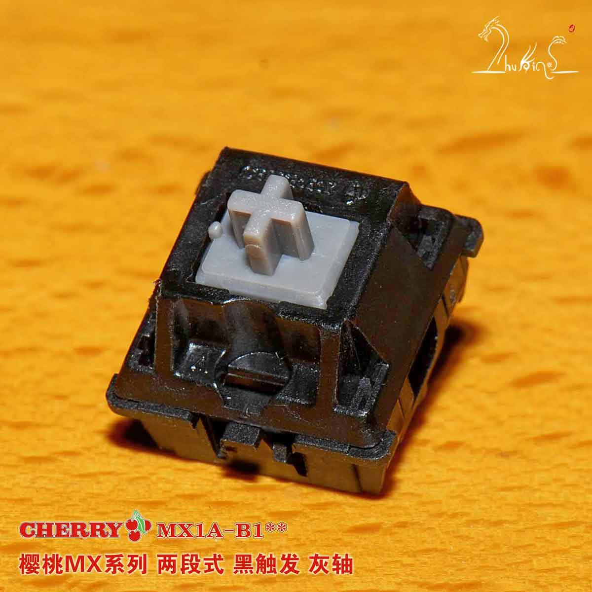

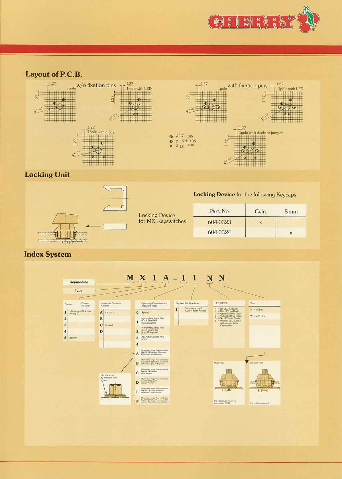

I don't remember now — shows how little attention anyone ever pays to anything I put on the wiki, if it takes a Chinaman to spot the mistakes … I'll update the data based on the catalogues I've got.
The one depicted in this topic is not a MX1A-B1xx though, as that's tactile (per the catalogue), and the depicted switch is clicky.

Dunno, but now this topic now has a photo claiming that click grey is MX1A-B1 :P

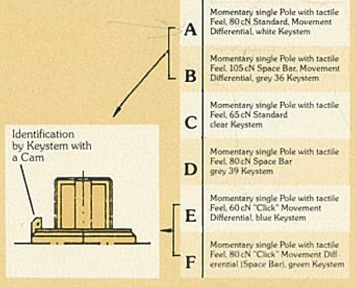

Actually, I think yab8433408 is correct, and Cherry are wrong.
The 1994 "Keymodule MX" brochure has white (A) and grey 36 (B) down as "tactile" with "Movement Differential" (hysteresis). It looks like the only switches that have hysteresis are the clicky switches (with this being generated by the sliding collar), and we understand white to be clicky, not tactile. Therefore, it stands to reason that, just as they missed the word "Click" from the description of A, they missed it from B, too, making yab8433408 correct: MX1A-B1xx is indeed click grey. (They write "Click" in quotes — they seem more concerned with hysteresis than the click in the brochure.)
As such:
  • No evidence to date that "super grey" exists; "super black" is confirmed, but has no known part number
  • MX1A-B1xx is [wiki]Cherry MX Click Grey[/wiki]
  • I've updated [wiki]Cherry MX[/wiki] per my 1994 brochure, except for the actuation forces, which are in dispute (e.g. the alleged 60 cN for MX blue) — all my newer brochures are useless and don't list all the variants
What's interesting is that there is a "cam" (bump) on the stem of the hysteresis switches: Cherry make a point of ensuring you can recognise these (see yabb's images above). This is further evidence that, since B has a cam, it should be clicky like white (A), green (E) and blue (F). I have no idea what this was meant to be about.

The way it is now, it makes much more sense!
MX1A-11xx linear normal (black)
MX1A-21xx linear space bar (grey)
MX1A-A1xx clicky normal (white)
MX1A-B1xx clicky space bar (grey)
MX1A-C1xx tactile normal (clear)
MX1A-D1xx tactile space bar (grey)
MX1A-E1xx clicky normal (blue)
MX1A-F1xx clicky space bar (green)
MX1A-G1xx tactile normal (brown)
MX1A-H1xx unkown
I, J might be left out ...
MX1A-K1xx unkown
MX1A-L1xx linear (red)
BTW: A color comparison between those greys whould be nice.

Daniel Beardsmore wrote:Actually, I think yab8433408 is correct, and Cherry are wrong.
I remember having a similar discussion with ripster in 2011, after I added a section on MX part numbers to the GH Wiki. He didn't like that I said 'click' for A and B. I compromised by adding { } around words that weren't directly from Cherry datasheets...
c = Operating Characteristics, Actuating Force and Key Style
0: Special
1: Momentary, single pole, {linear}, 2.1 oz / 60cN, standard, black keystem
2: Momentary, single pole, {linear}, 2.8 oz / 80cN, spacebar, {dark} grey 37 keystem
3: Alternate action, single pole, 2.1 oz / 60cN, {grey upper housing, black keystem}
4:
A: Momentary single pole with tactile feel, 80cN standard, {click} Movement differential, white keystem {obsolete}
B: Momentary single pole with tactile feel, 105cN space bar, {click} Movement differential, grey 36 keystem {obsolete}
C: Momentary, single pole, tactile feel, 2.3 oz / 65cN, clear keystem
D: Momentary, single pole, tactile feel, 2.8 oz / 80cN, spacebar, {light} grey 39 keystem
E: Momentary single pole, tactile feel 2.1 oz / 60cN, “click” differential movement, blue keystem
F: Momentary, single pole, tactile feel, 2.8 oz / 80cN, “click” differential movement, space bar, green keystem
G: Momentary single pole with tactile feel (ergonomic), 55cN standard, brown keystem {special order only?}
L: {Momentary, single pole, linear, 45cN, standard, red keystem} {special order only?}
I also hazily recall musing on the phrase "Identification by keystem with a cam". Clearly, it's a translation from German, but is it correct? I thought that "Identification of keystem with a cam", with cam meaning the sliding piece, seemed like it might be more correct. IIRC, 'von' can mean either 'by' or 'of', right?

Soarer wrote: I also hazily recall musing on the phrase "Identification by keystem with a cam". Clearly, it's a translation from German, but is it correct? I thought that "Identification of keystem with a cam", with cam meaning the sliding piece, seemed like it might be more correct. IIRC, 'von' can mean either 'by' or 'of', right?
Have you seen the German text somewhere (I haven't)? I think that by cam they mean the little marker (pin?) on the side of the stem's surface that e.g. whites have:
but clears don't:
So they mean that A and B can be identified by having the "cam" on the stem that A and B have while C and D don't.
18 Oct 2013, 13:28
Yes, that little blister is definitely the "cam", as pictured here:

Well, I think you're both wrong :D
Not that it matters now that we know that the identification means a clicky switch, and that's all we really care about, but still...
A cam is a rotating or sliding piece in a mechanical linkage used especially in transforming rotary motion into linear motion or vice-versa
There's no way I can think of to fit the meaning of Cam to the identification pin - it doesn't move, and nothing else moves because of it! Of course, there's also nothing 'rotary' about the sliding piece but, allowing for clunky translation, it fits the facts a lot better.
I haven't seen the German text... but what I say is plausible, right? It may have said "Identifikation vonTasten-Schaft mit einem Nocken", where 'von' could mean either 'by' or 'of', and if it meant 'of' in this case "mit einem Nocken" might be better translated as "having a cam", giving "Identification of a keystem having a cam".
Halvar
18 Oct 2013, 14:23
"Nocken" means both "cam" and "pin", so I still think it's a bad translation to English by the Cherry engineers.

Ah, I didn't know that 'einem Nocken' could mean 'a pin'... but nor do any German-English dictionaries on the web, it seems :lol:
Now we have two plausible mis-translations, even if the original German was that text - we could probably guess at alternative original texts and find further meanings - at the very least, there's no argument that it's a poor translation!
Is Nocken commonly used to mean a pin of this kind? Or would a German engineer tend to use a different word?
edit: They use 'Fixierpins' to describe the mounting pins used on PCB-mounted switches.. so, err, 'Pin'? :lol:
