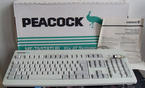

Jmneuv
27 Feb 2013, 23:08
Hmm the light&medium grey caps on the peacock G81 boards were lasered pom (and were normal without stabilizers).
