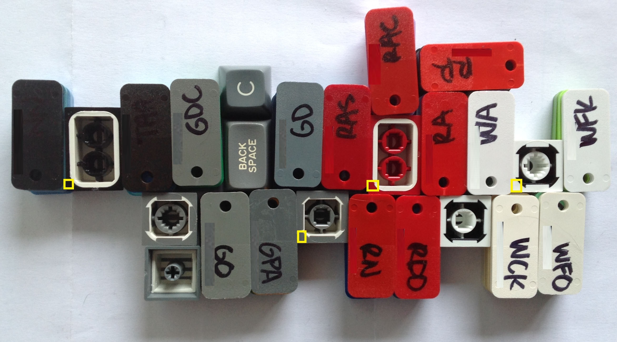

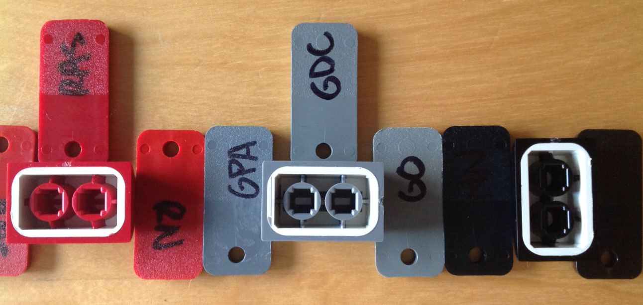

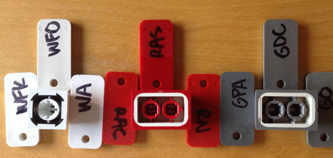

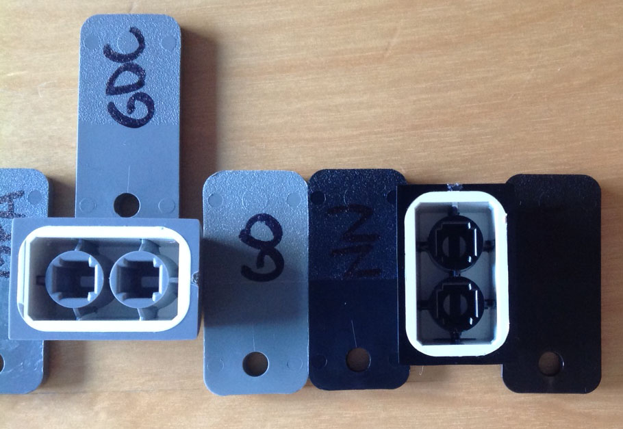

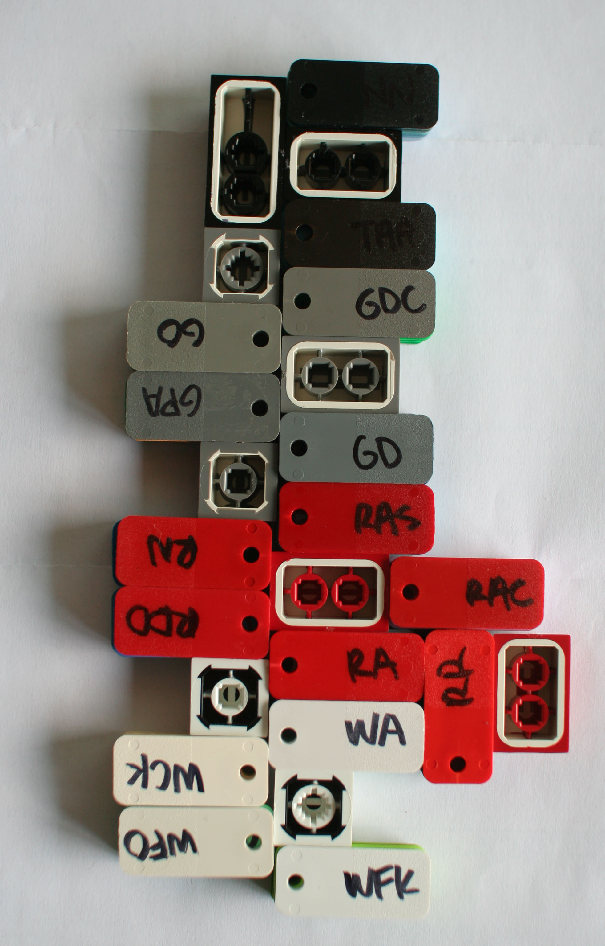

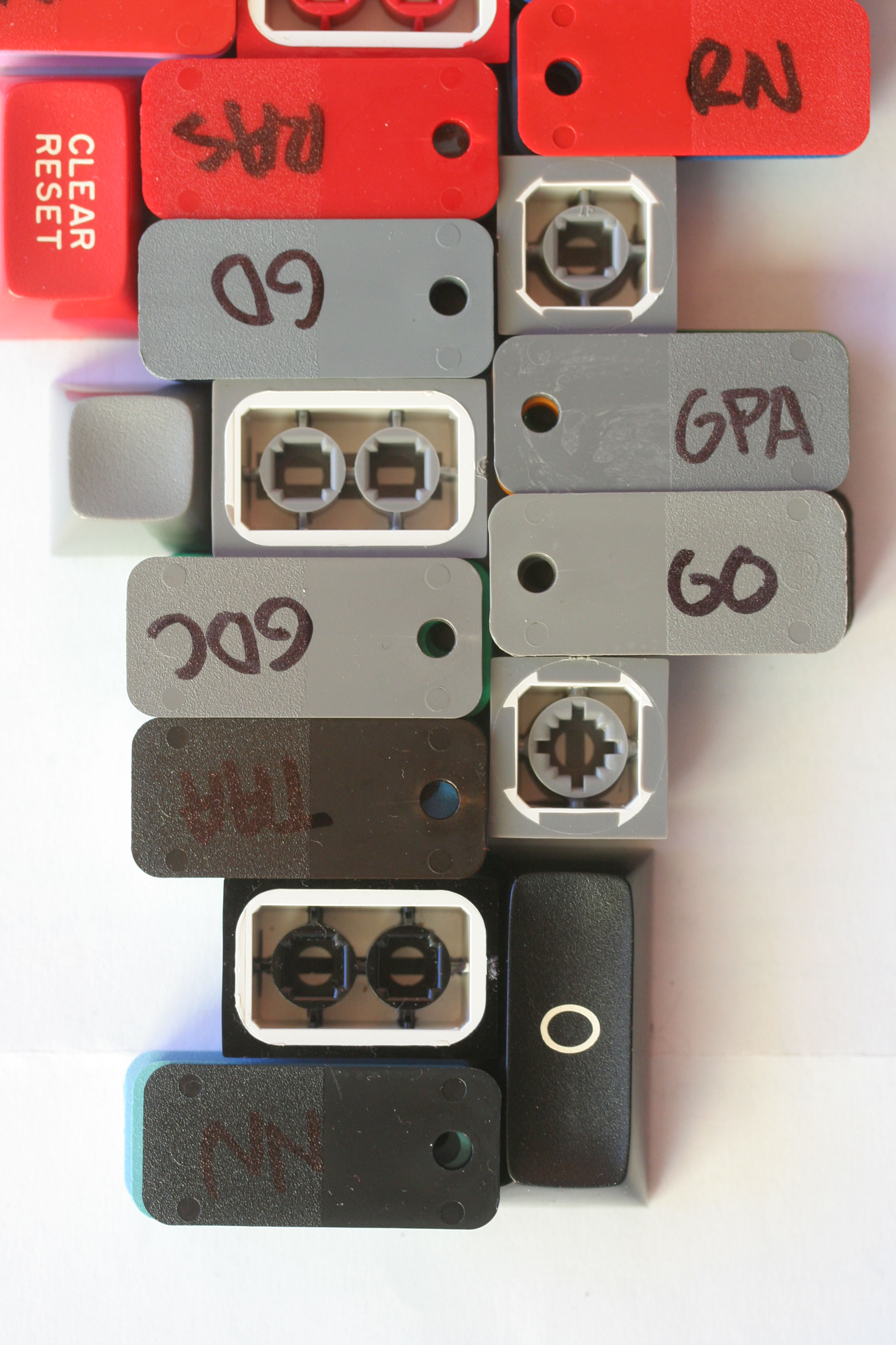

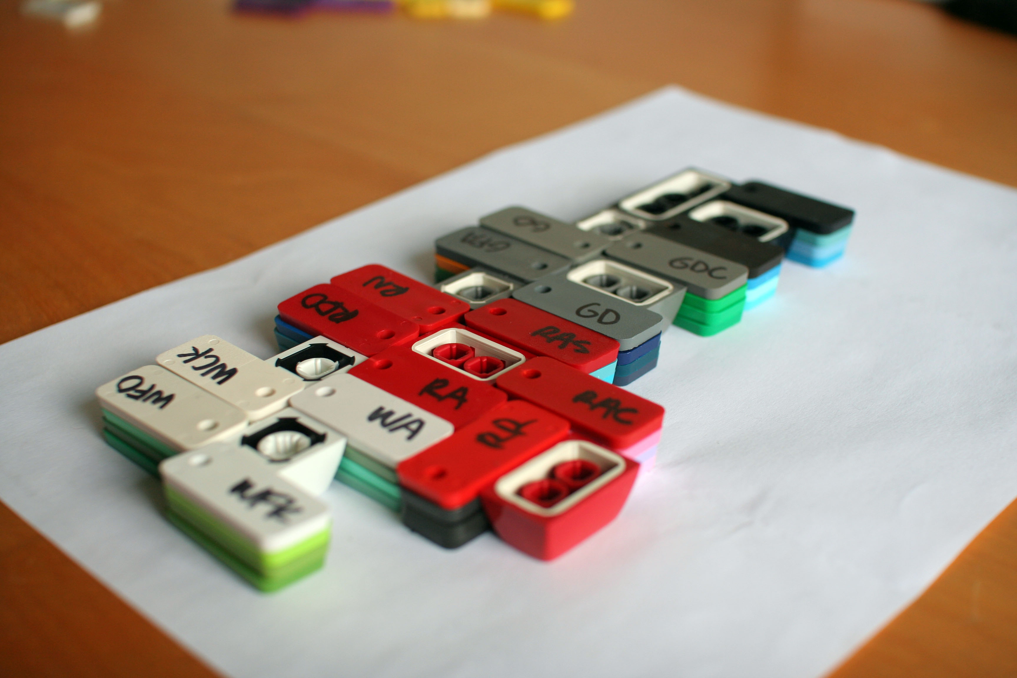

Signature Plastics' ABS samples are here and 7bit has set me the task of matching the original Honeywell colours for Round 5. I arranged them by shades on my desk and picked out the best candidates for each of the four colours. Matching is harder than it looks because these 30 year old caps have a very shiny finish (the tops are matte but a little yellowed) while the samples are less reflective. So, take a look for yourselves.
Natural light:
photo 2-1.JPG (146.63 KiB) Viewed 11516 times
photo 1-1.JPG (149.48 KiB) Viewed 11516 times
photo 4-1.JPG (119.68 KiB) Viewed 11516 times

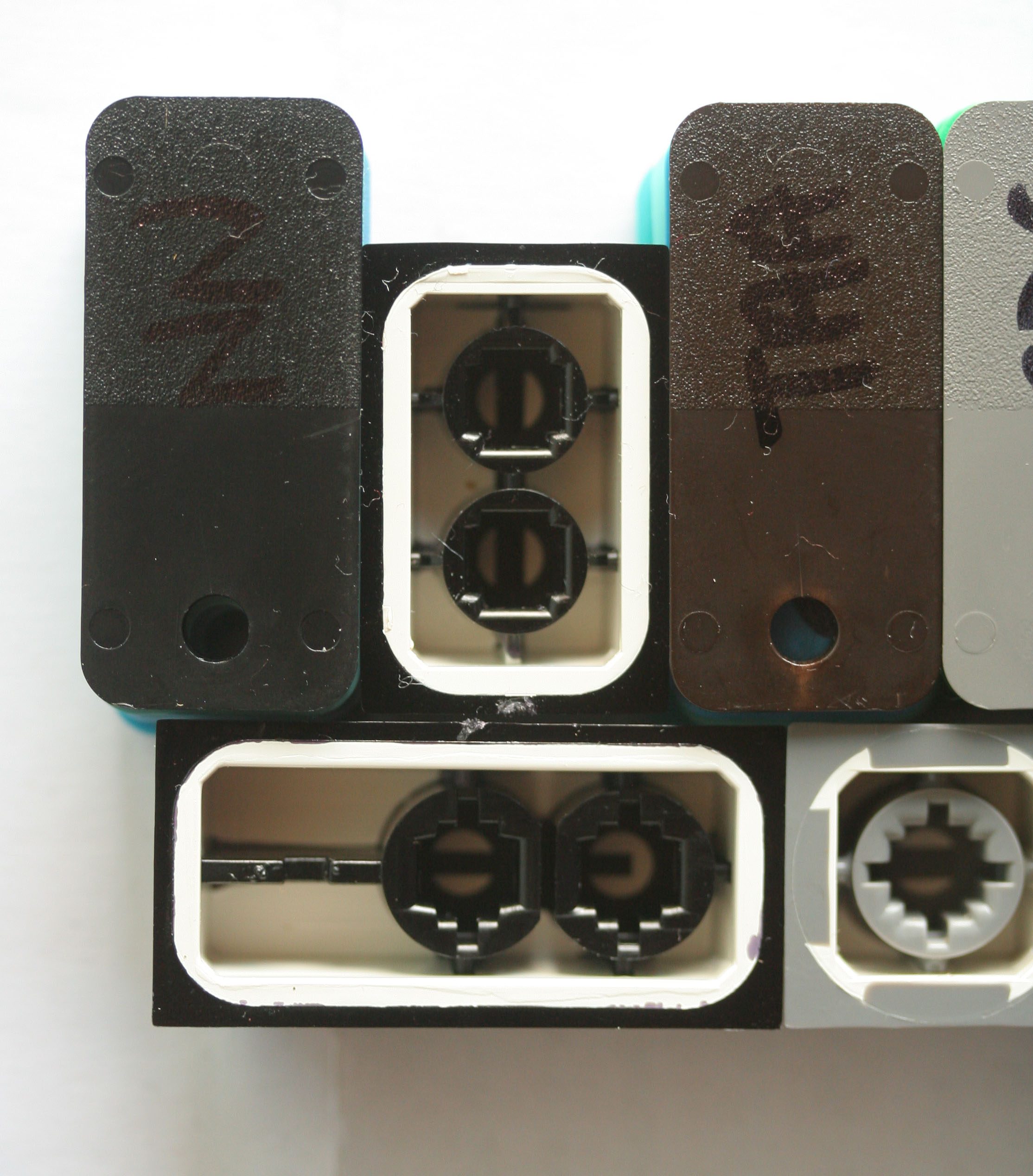

The blackest black in SP's set is NN, on the right. Yes, they write in black felt tip on those ones too! The Honeywell's black looks darker yet because it's shinier. (The difference is even more obvious in real life.) But NN is really, really black. So I think we're alright. It's just that super glossy Honeywell finish.

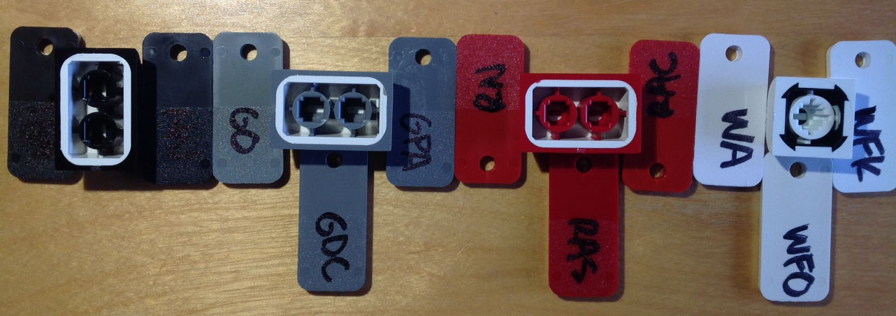

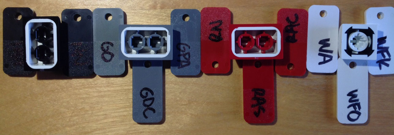

And with a boost from a harsh blue/white LED lamp:
photo 3.JPG (133.9 KiB) Viewed 11516 times
photo 2.JPG (125.24 KiB) Viewed 11516 times

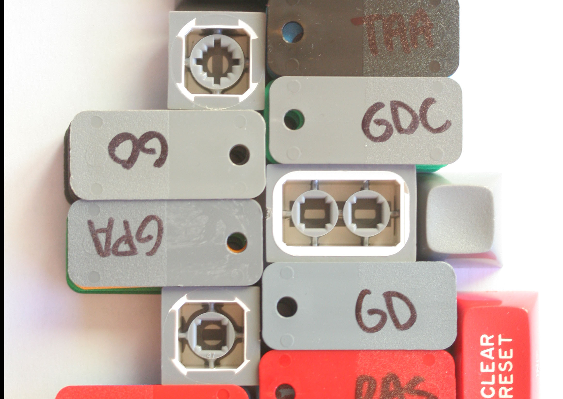

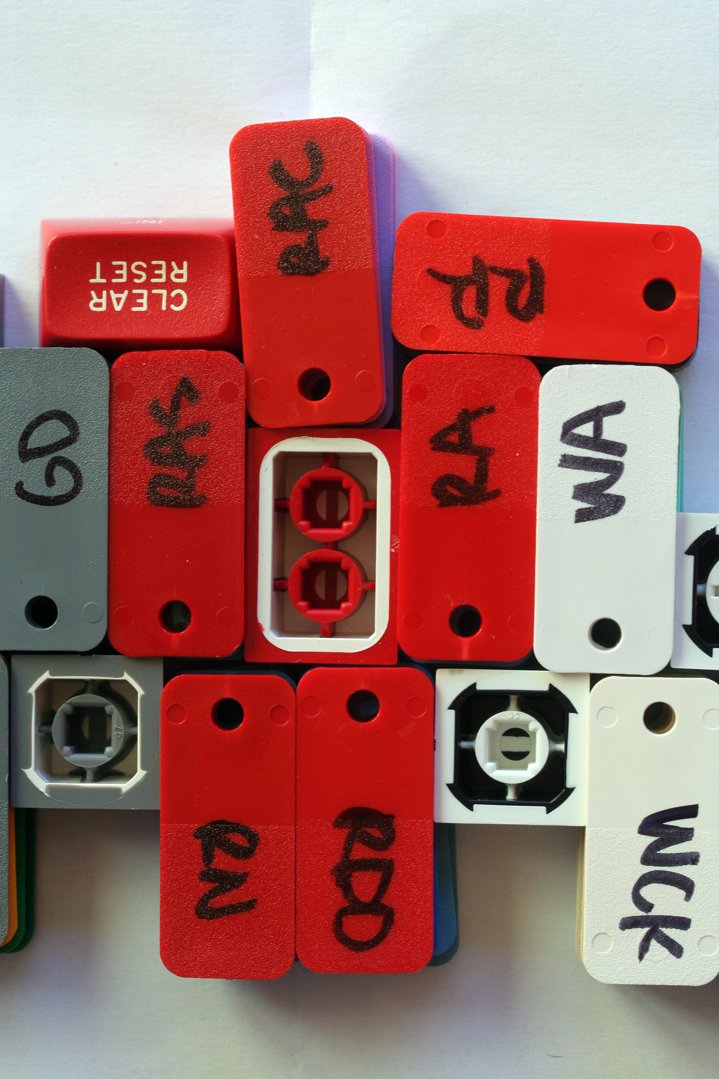

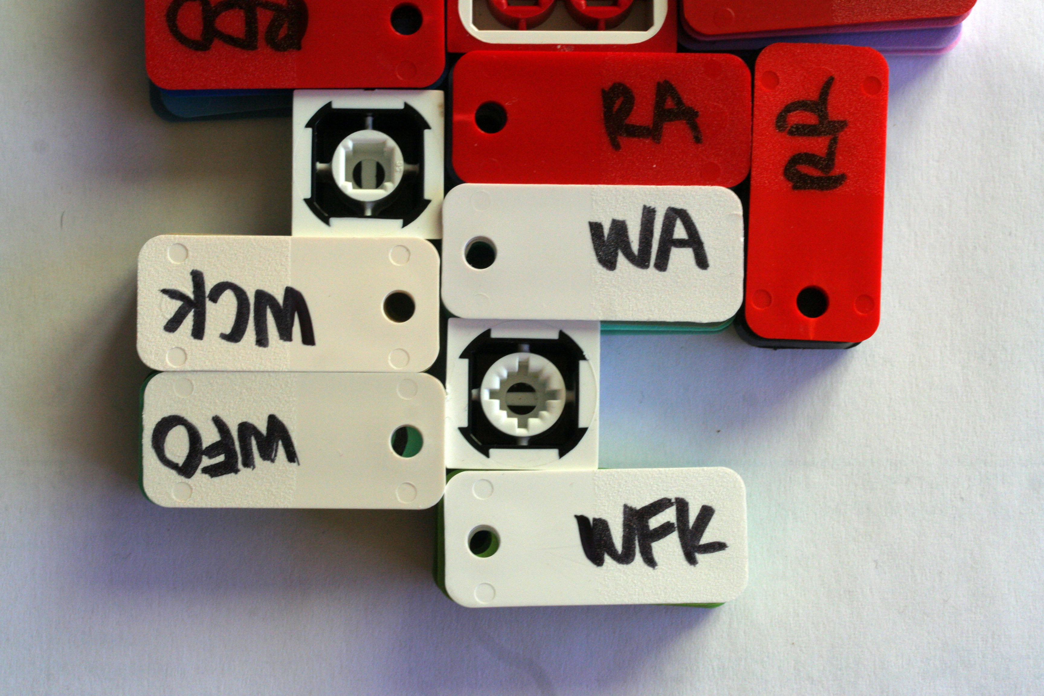

My IDs are…
Black: NN (including legends on white keys)
White: WFK (including legends on all non-white keys)
Grey: GPA or GDC, they're very close.
Red: RAS
I'm sure my first attempt at pictures will make our favourite GB-running robot cross. Suggestions are welcome before the sun peeps between the chimneypots again and I have a second go tomorrow!

Forget color-comparison under LED light. LEDs are for signal lamps.
08 Nov 2013, 19:38
True. I pulled it out to emphasise the difference in the greys. It overdoes it, but increases the contrast between those three a bit for comparison's sake.
tlt
08 Nov 2013, 19:43
Bright but not direct sunlight should be good for this I think

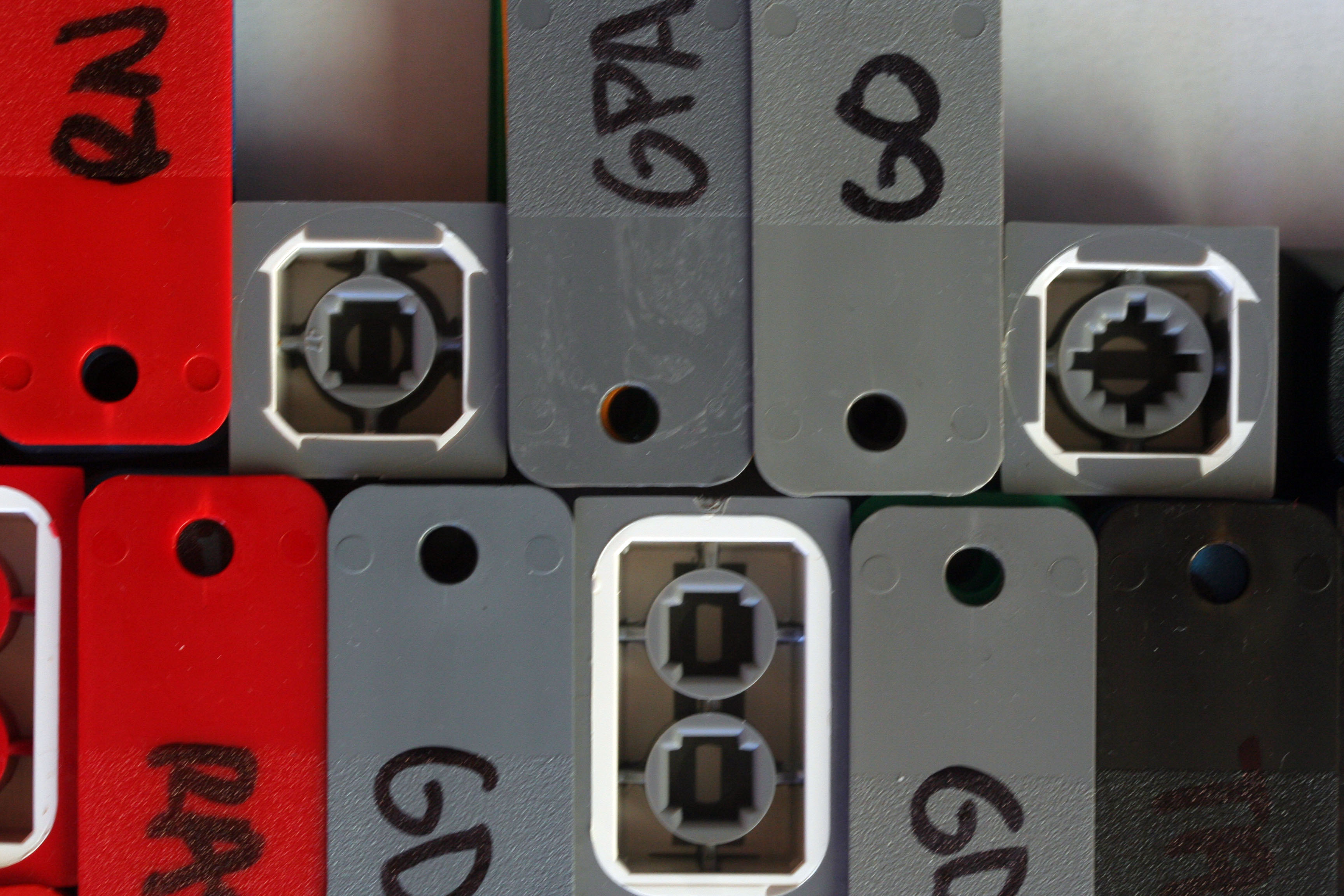

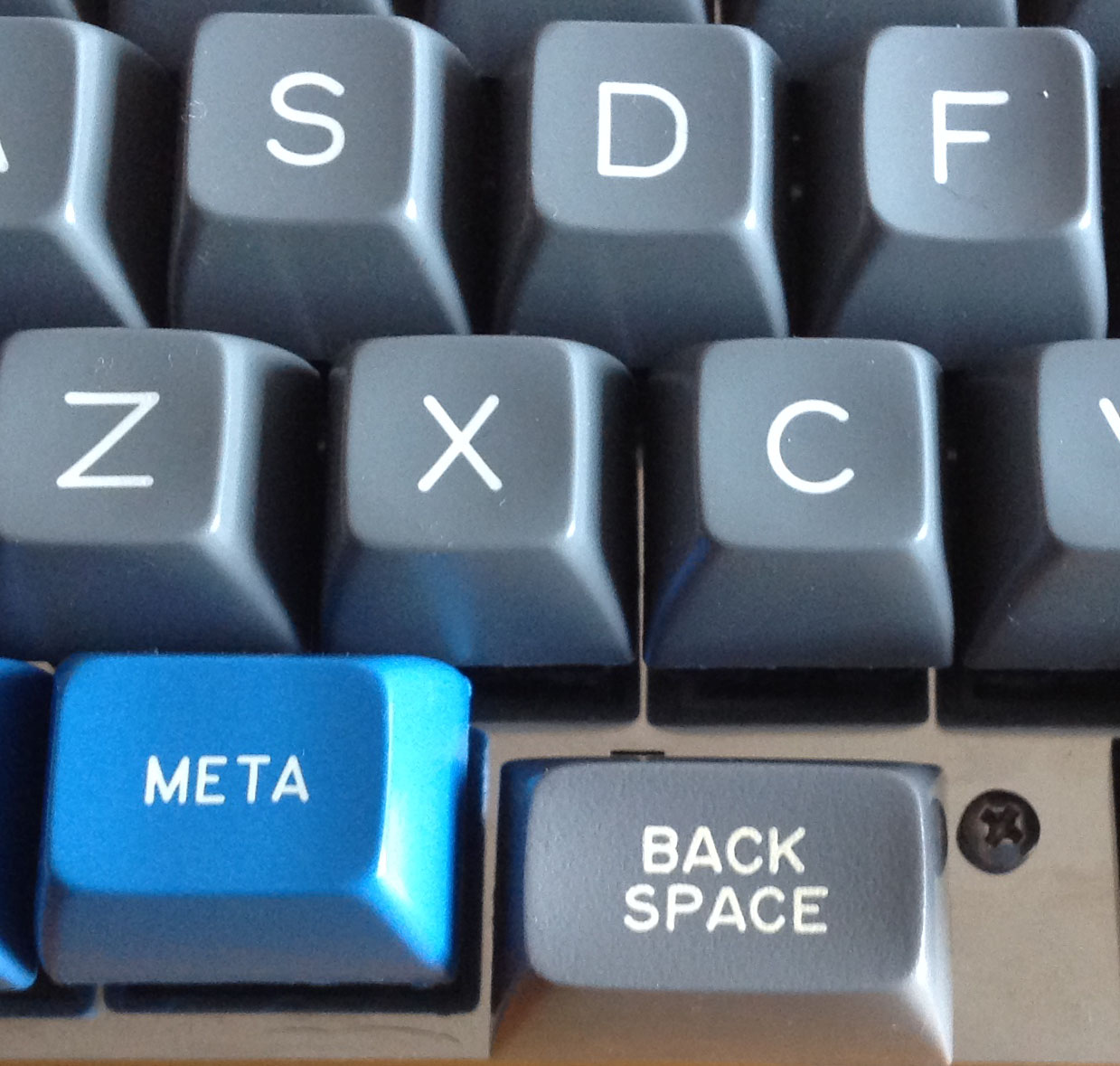

Is GD too different from the Honeywell grey?
08 Nov 2013, 23:39
GD's pretty close, actually. Let me guess: is that R4 SPH's grey colour?
Honeywell-SPH-SPH-Honeywell. (More pictures.)
RA isn't such a near match. Honeywell red is a bit darker in shade, more like RAS. I'll get them all out and shot tomorrow.
08 Nov 2013, 23:46
RA is a lighter red, that's true, so I think we should go with the darker one.

the only decent red seems RAS to me, RAC looks... cheap...
GDC looks pretty close, just a pinch too dark maybe? but GO is a bit off

Muirium wrote:GD's pretty close, actually. Let me guess: is that R4 SPH's grey colour?
That's right. I'm thinking that someone may want to combine the odd R4 and R5 SPH keys...
Personally, I am not interested in spherical keys - I just want to get the idea out there, unless it would be too bad ... so that's why I'm asking.

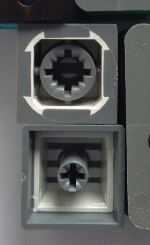

The greys are mostly a more neutral shade, closer to GPA I think than GD. Though not so far away from Round 4's SPH alphas, really. You can see the Honeywells are paler when they're side by side, but it's not the worst:
R4 SPH below a Honeywell. And what they're like above:

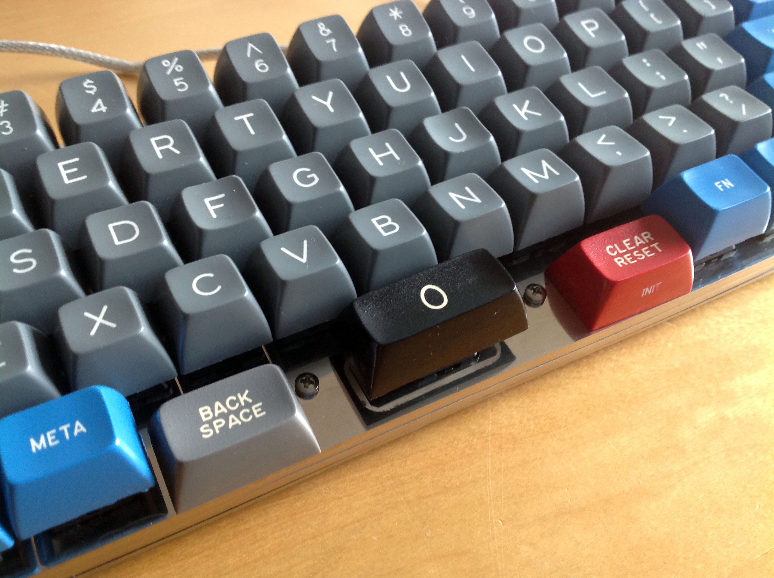

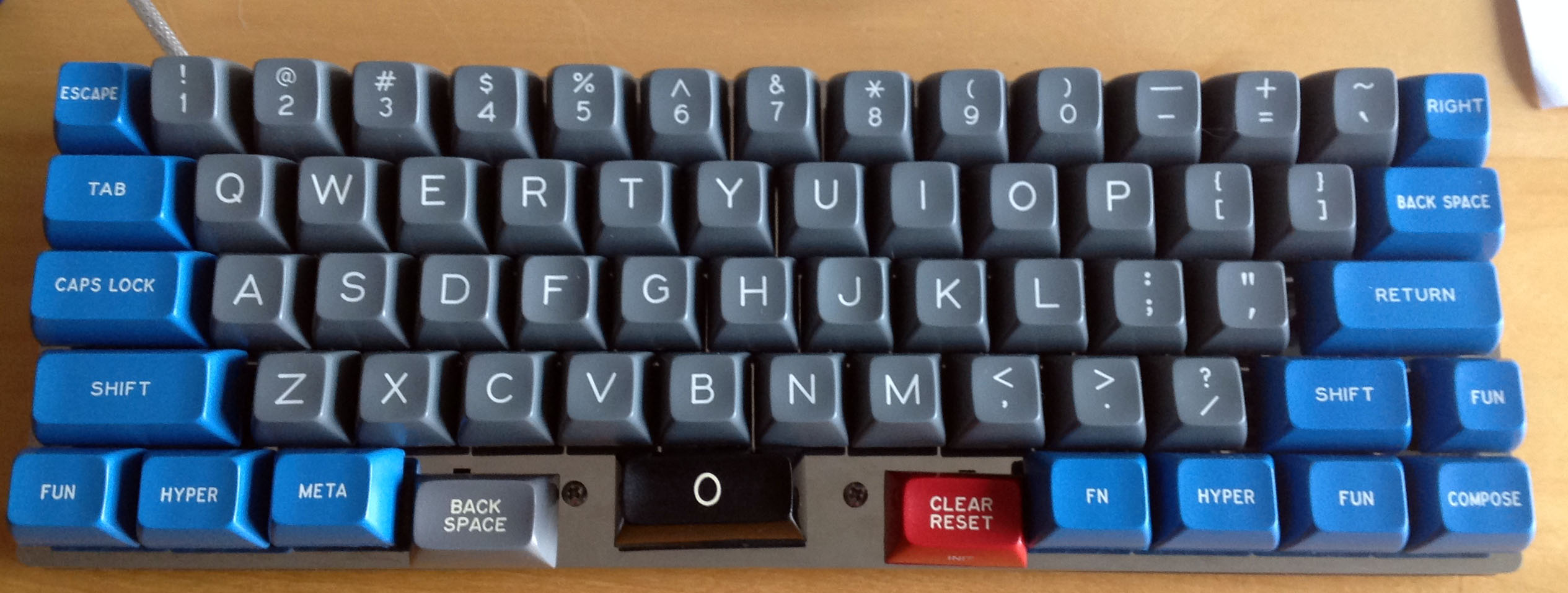

And here's a peek of the Rounds 4 and 5 combinations to come:
Honeywell grey, black and red sitting on my custom 60%. No, they do not fit. But they're already not a million miles away from SA, in font as well as profile.
I'm looking forward to mixing these up for real!

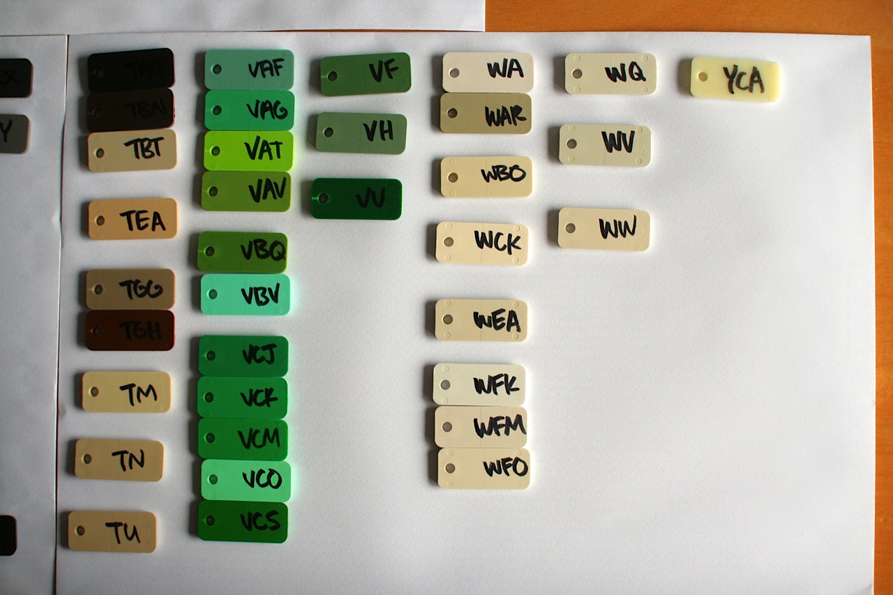

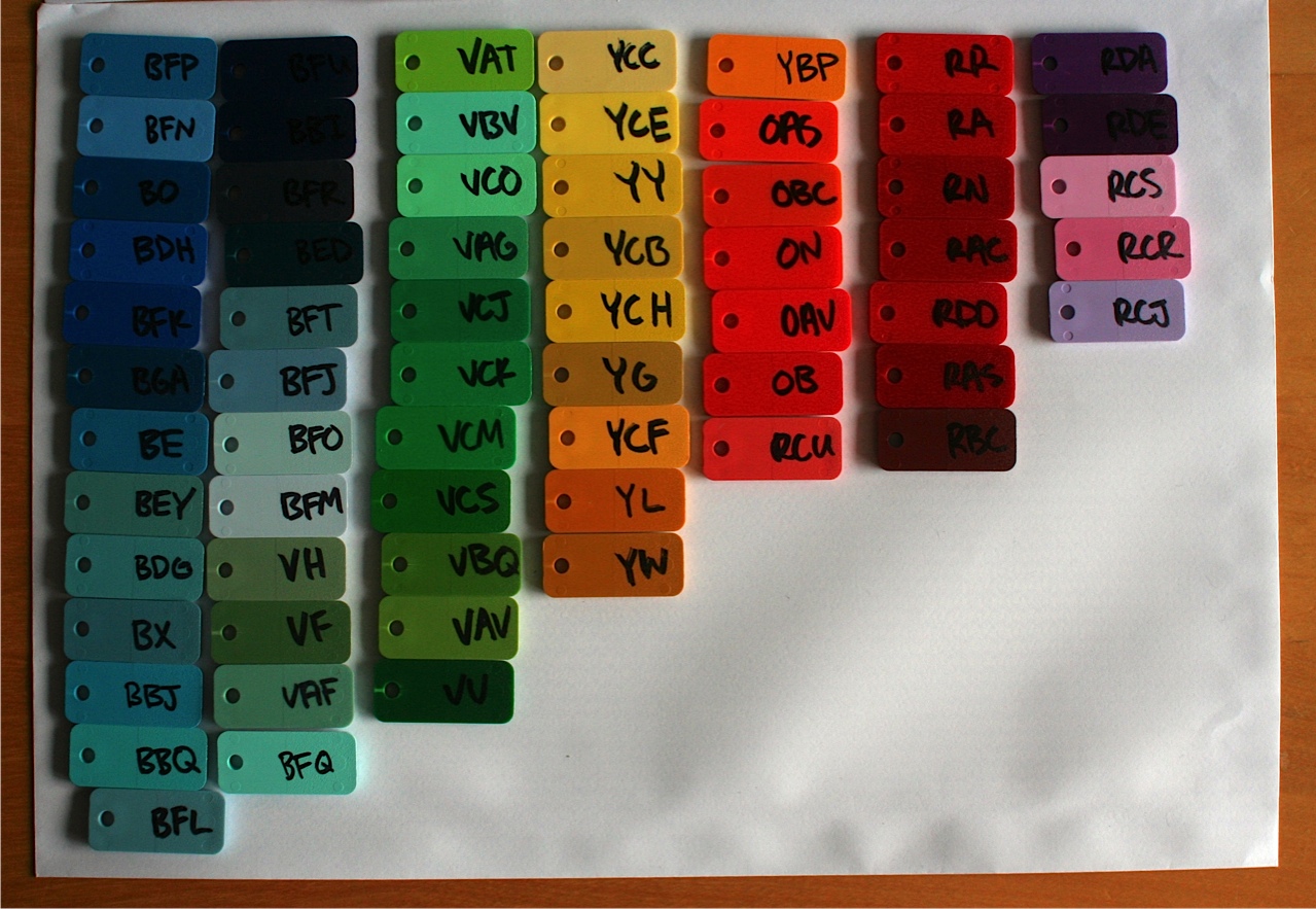

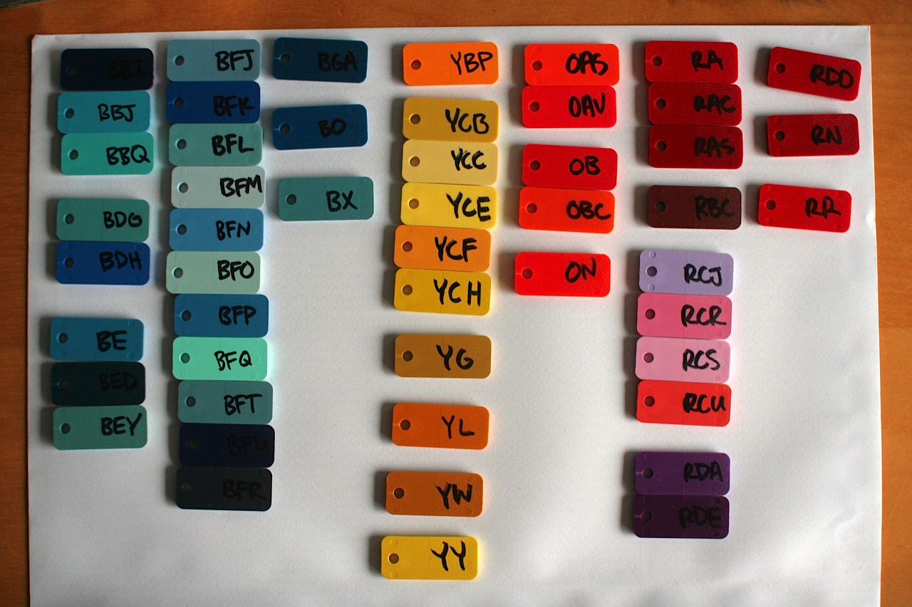

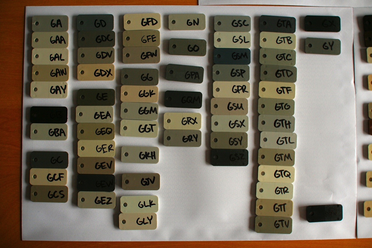

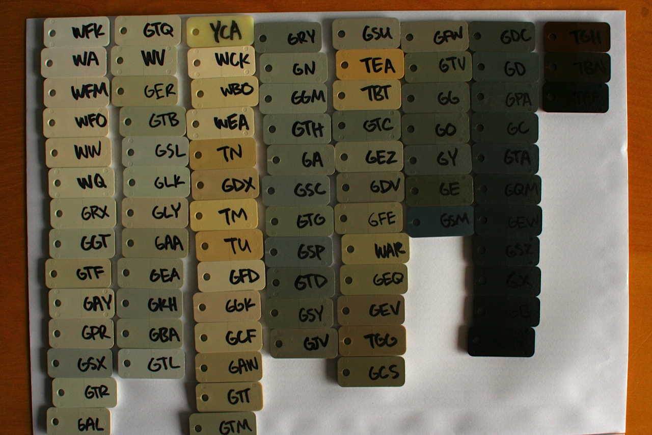

Here's the entire Signature Plastics ABS colour sample set, shot against white in neutral daylight for accuracy, in case it's useful to anyone.
The greys:
The strong colours:
And then grouped alphabetically by their code:
(Yes, YCA should be with YCB etc. but I only spotted that mistake after the set left my hands. Incidentally, YCA is quite translucent. It does look different to every other code in the deck.)
14 Dec 2013, 16:52
YCA is supposed to be glow-in-the-dark, no?
This is the wiki list from ijprest's measurements: [wiki]Signature Plastics ABS colours[/wiki] which appear at first glance to look roughly the same. I knocked up a simple linear template arrangement for the colour sample pages (i.e. separates out the HTML/wiki markup from the data), but it might benefit from some sort of logical arrangement. I was only interested in getting the data filed and accessible.
14 Dec 2013, 18:27
Glow? Damn it, I never thought to look at them in the dark! It definitely looked distinct from all the others. Pictures don't do it justice, it had a pearly depth to it.
