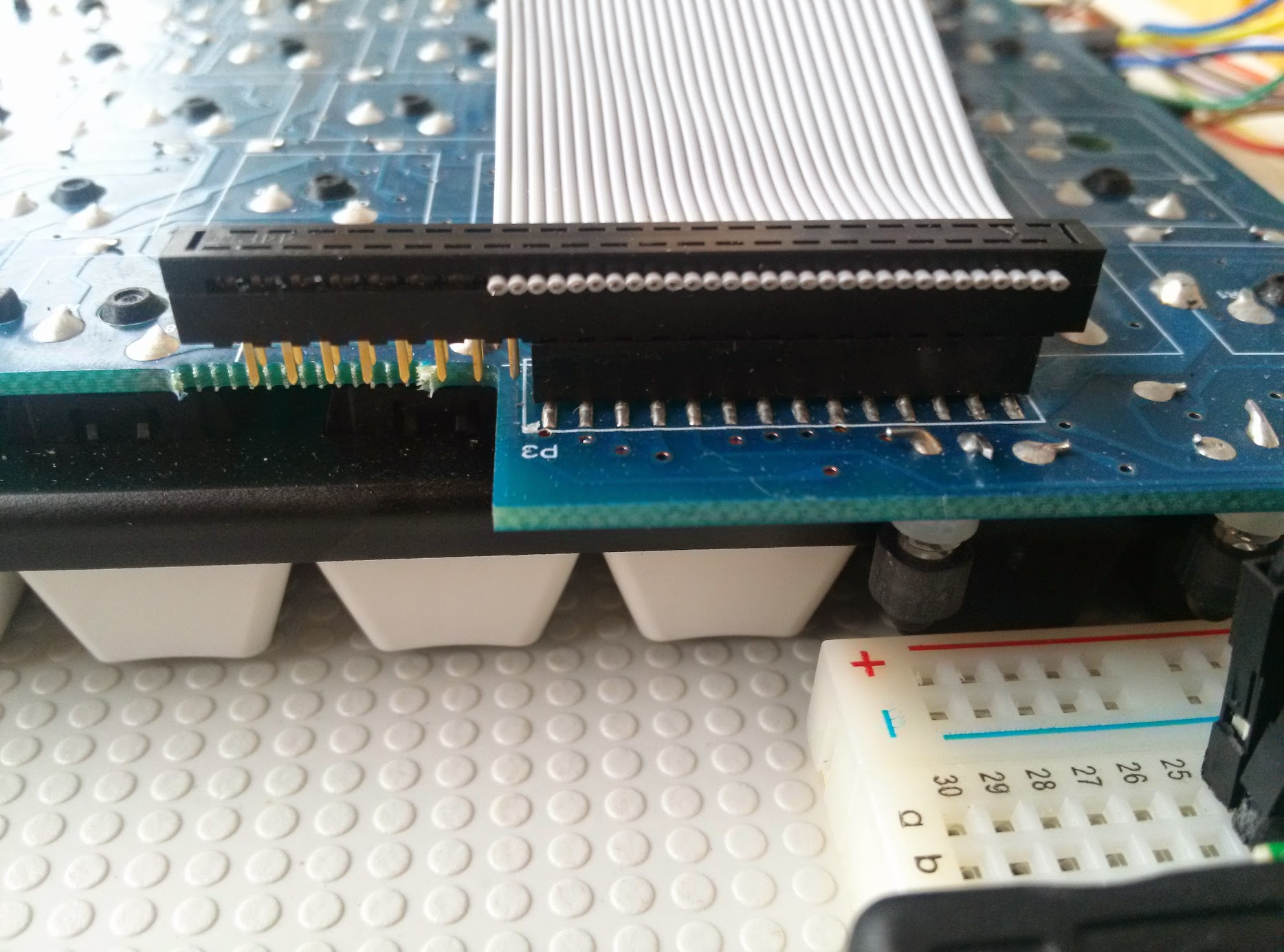

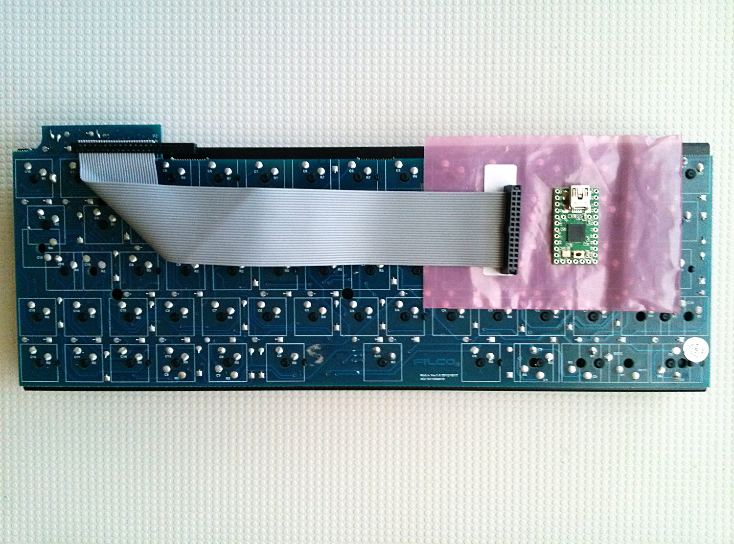

20 Mar 2015, 10:16
Some pictures from controller replacement.
I didn't found right connector and use big one :)
This one fits perfect in the keyboard.
