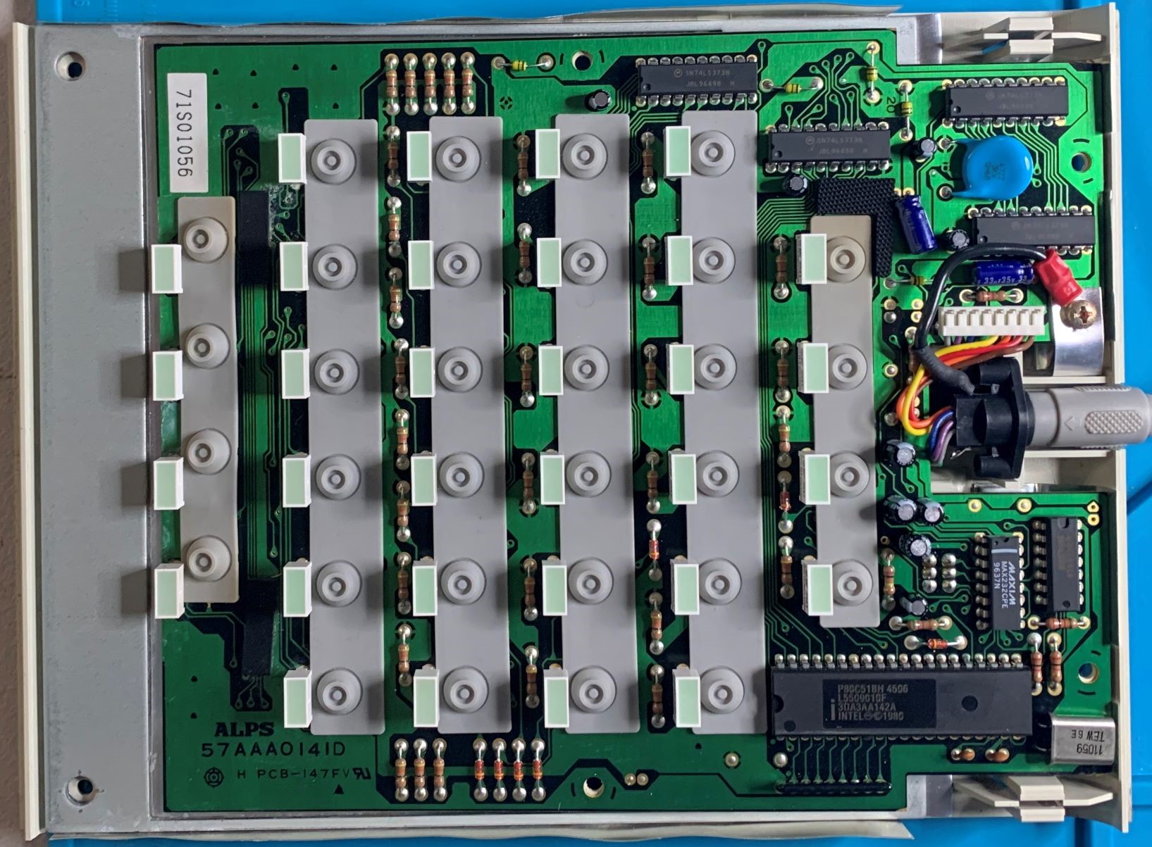

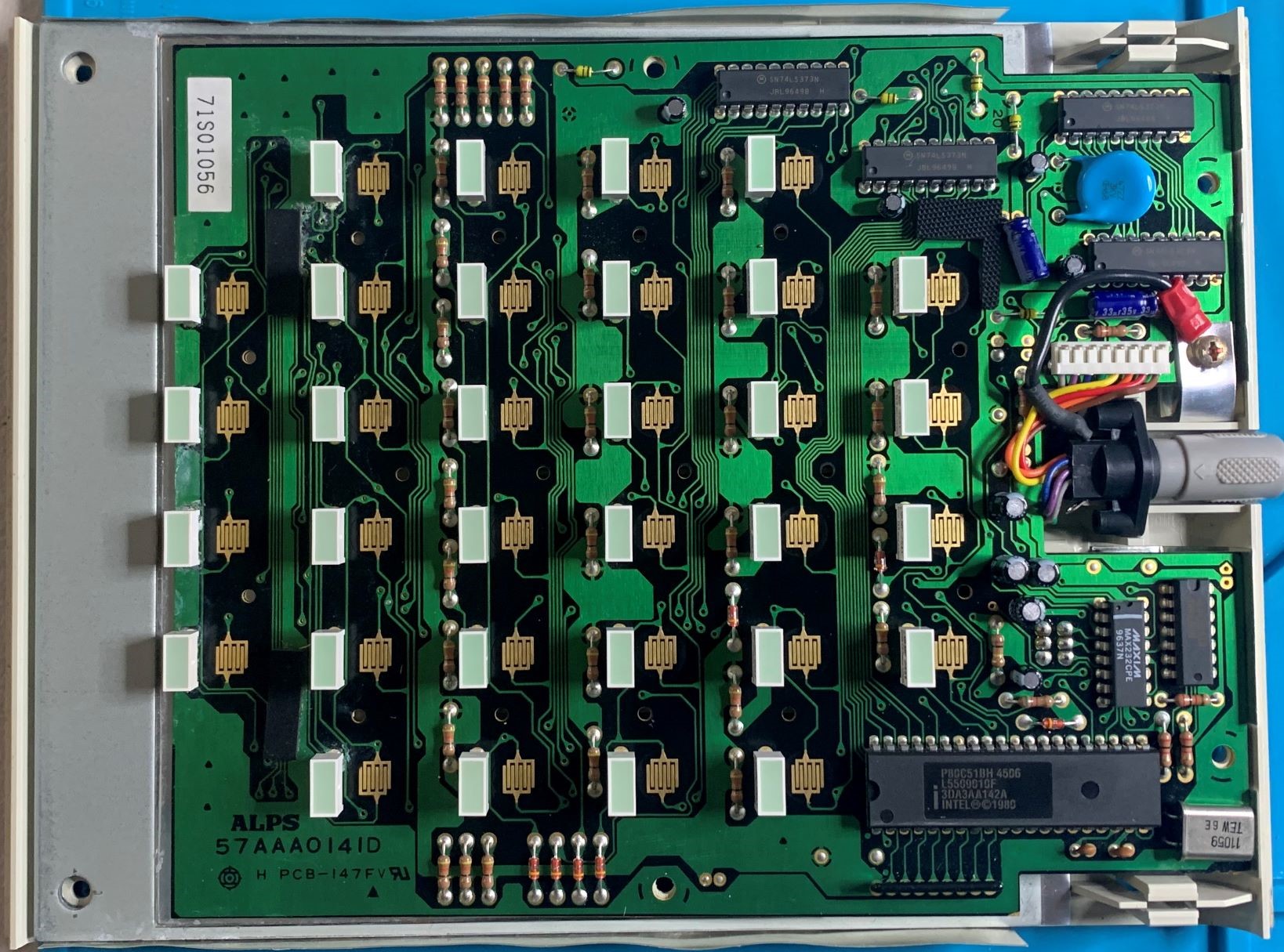

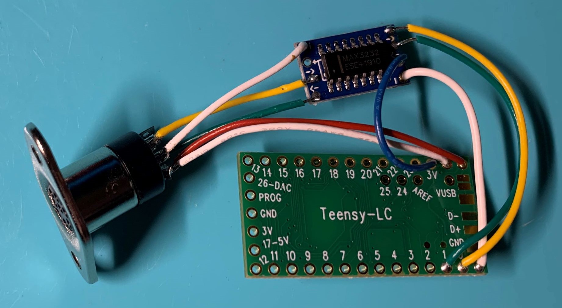

Here's what the PCB looks like, with and without the rubber domes.

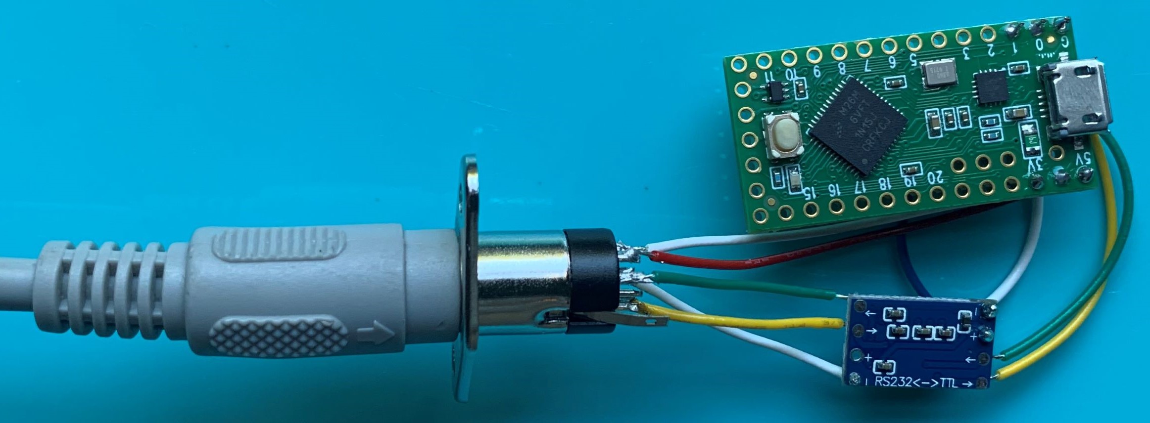

And here's a modern converter using a Teensy LC and MAX3232 into a (big) macropad with (single color / no PWM) LED matrix.

MMcM wrote: 17 May 2021, 08:40 And here's a modern converter using a Teensy LC and MAX3232 into a (big) macropad with (single color / no PWM) LED matrix.
Nice! Any instructions/parts list/firmware/etc. associated with this image?

18 May 2021, 02:31
raoulduke-esq wrote: 17 May 2021, 15:21
I think the initialization sequence still needs some work to reliably enable communication.

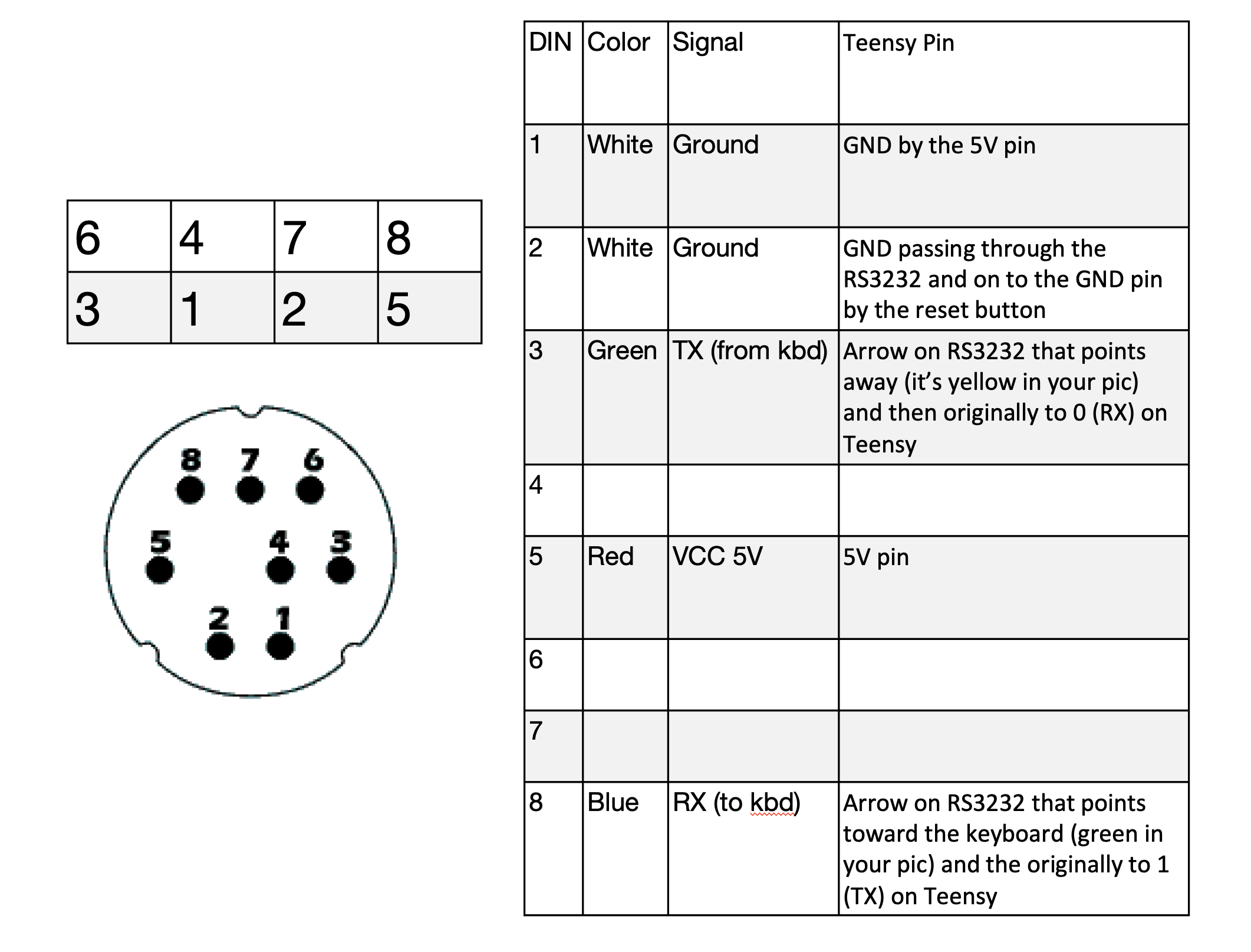

Tried to put this together based on the picture and I must have done something wrong. The firmware compiles and loads on the teensy just fine. The sockets I found were 90 degree PCB mount with a grid of 8 unmarked pins so I ripped one apart to map the pins and numbered them as match the numbers in my diagram. The pin coming out the back of hole 5 became pin 5 and I connected the 5V VCC to it. I guessed it was a 3v power lead going to + on the MAX3232 so I used the 3v and ground by the reset button. I figured that in the picture the green wires must be for (RX - to kbd) and the yellow would be (TX - from KBD) so I wired it like that to the pins in the sockets I found according to this diagram and put (TX - from KBD) to the serial RX pin on the controller and (RX - to KBD) went to TX pin on the controller. That way yielded nothing so I swapped the TX/RX on the controller. That time I got an endless stream of received key codes in the console.
Screen Shot 2021-05-31 at 9.00.52 PM.png (356.41 KiB) Viewed 8308 times
Any idea what I did wrong? Or can you elaborate a bit on the connections?

Hmm.
The pin numbering looks right. The way to keep from getting messed up by mirror images and male vs. female is that 3 and 4 are closer to one another than 4 and 5.
The table also looks right. 3 to RS-232 pointing into board and out from there to RX. 8 to RS-232 pointing out of board and in from TX.
Yes, 5V from USB to power the keyboard and 3V from Teensy's voltage regularly to power MAX3232 and set its TTL voltage.
Here are some photos of the one here from different angles. Perhaps this will make clear what is different.
Can you post a picture of your build?

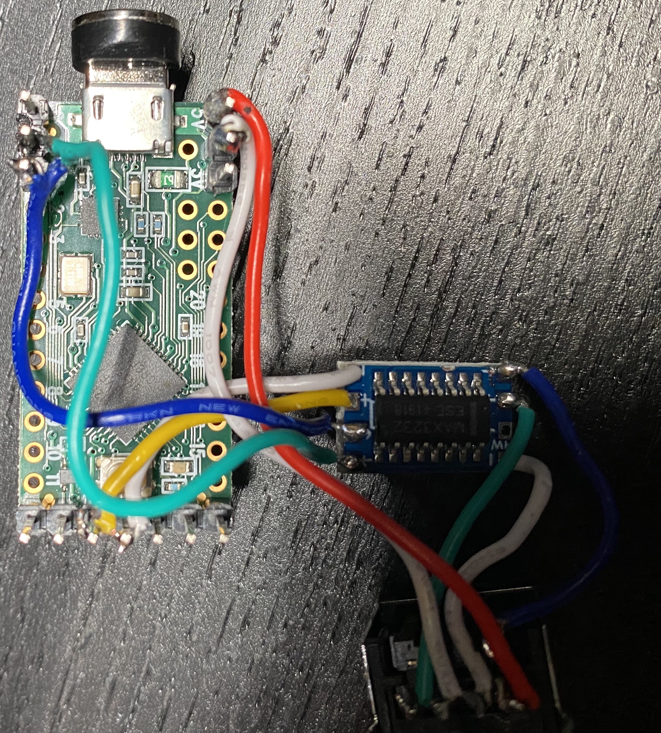

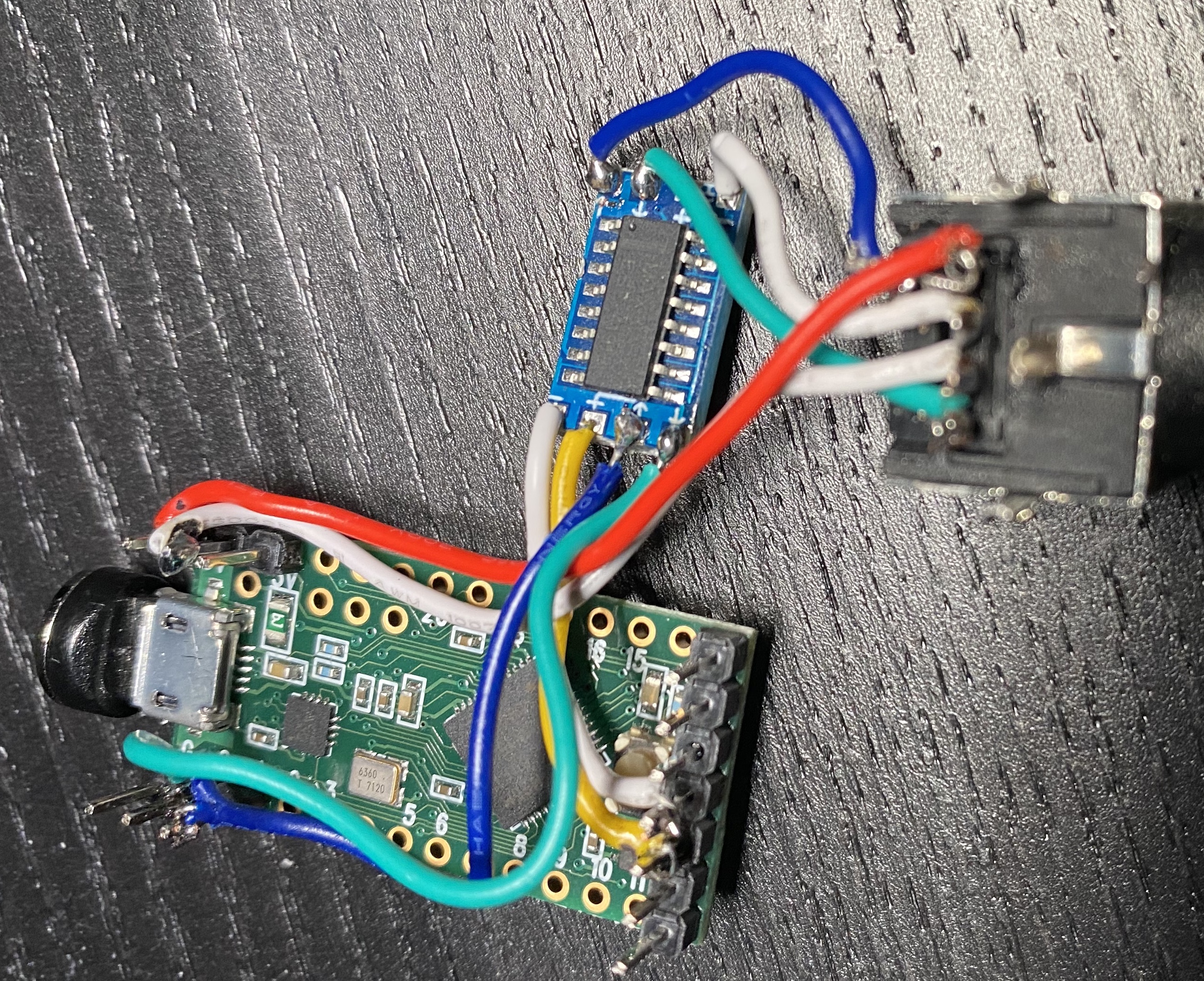

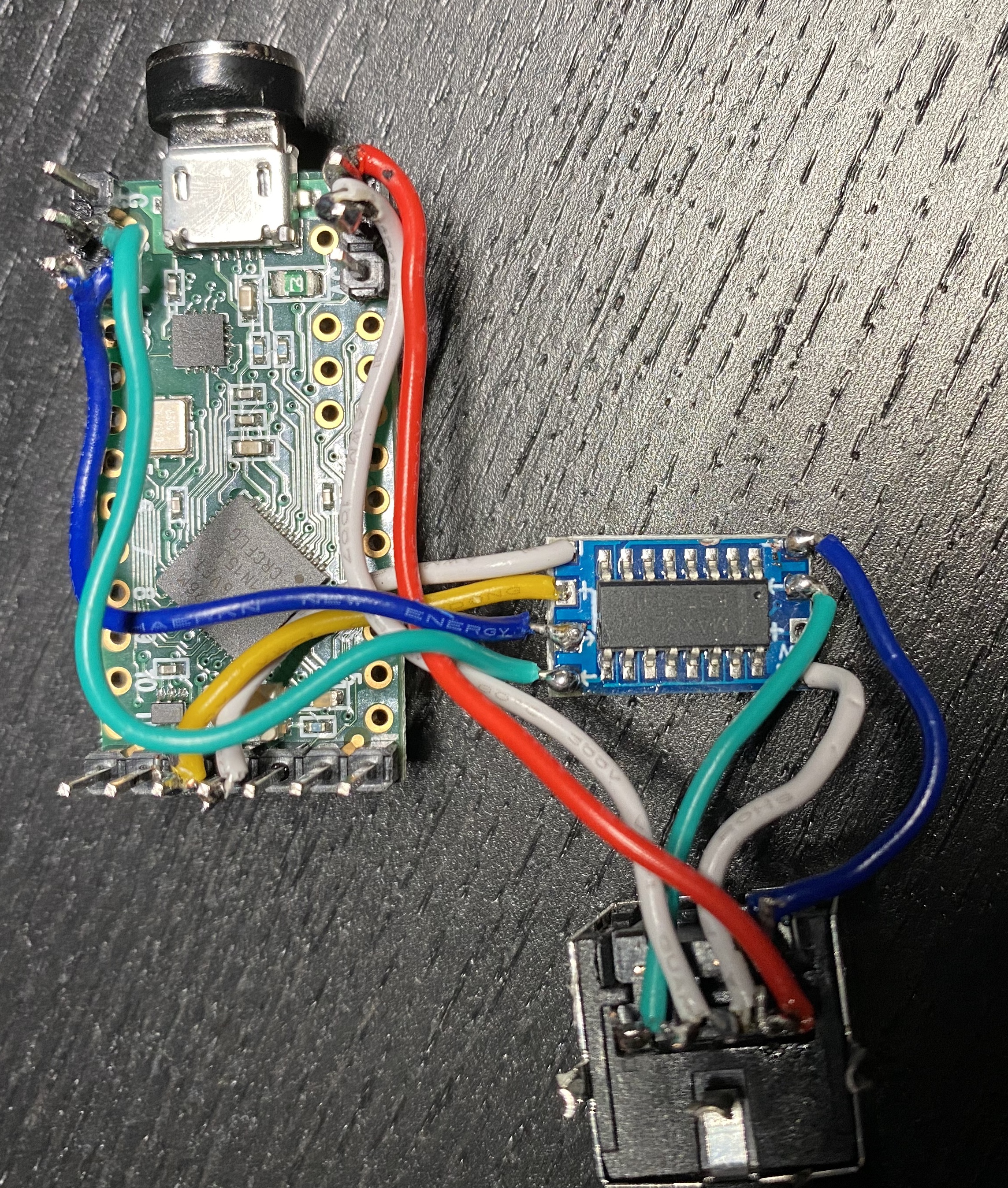

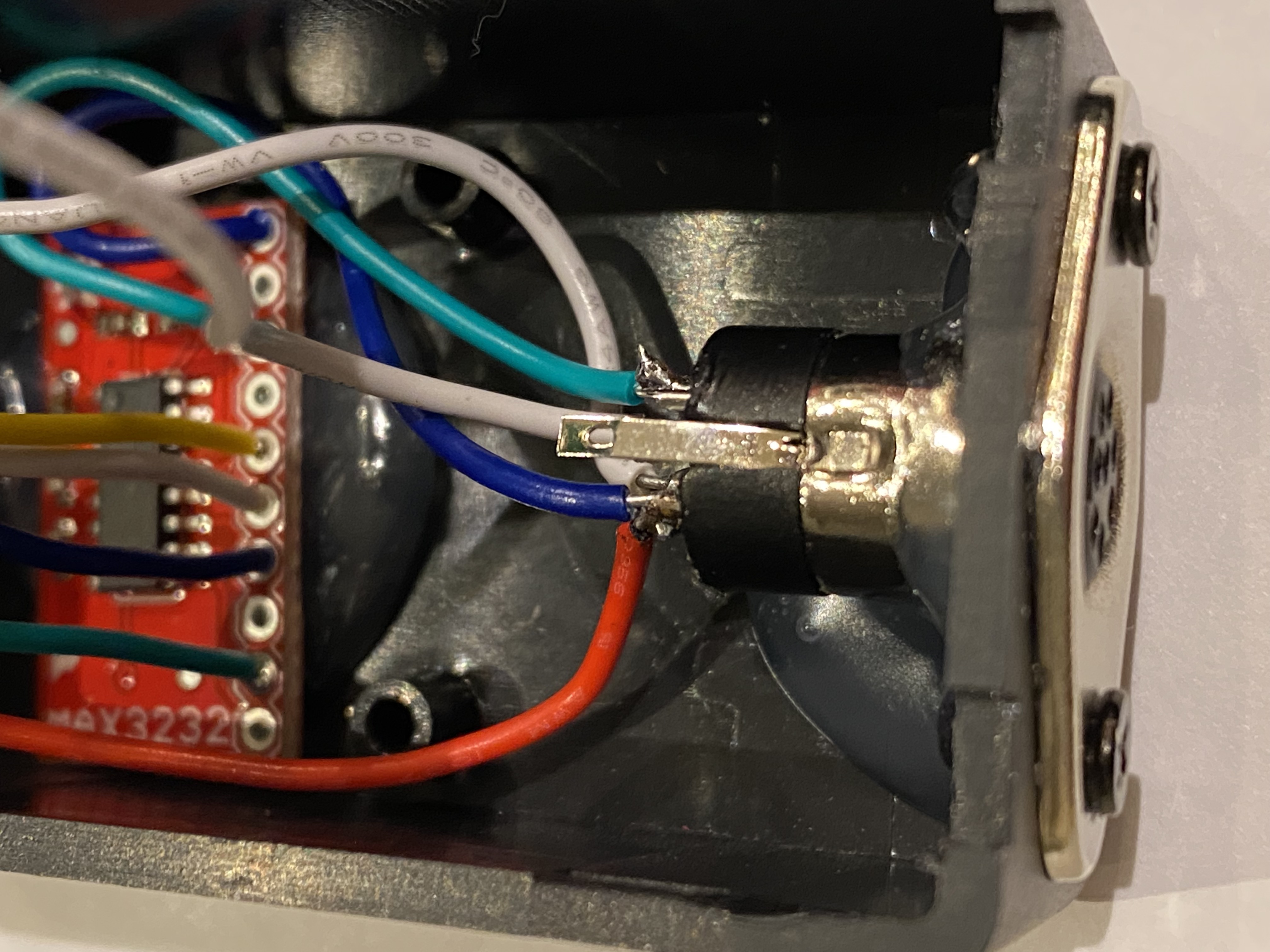

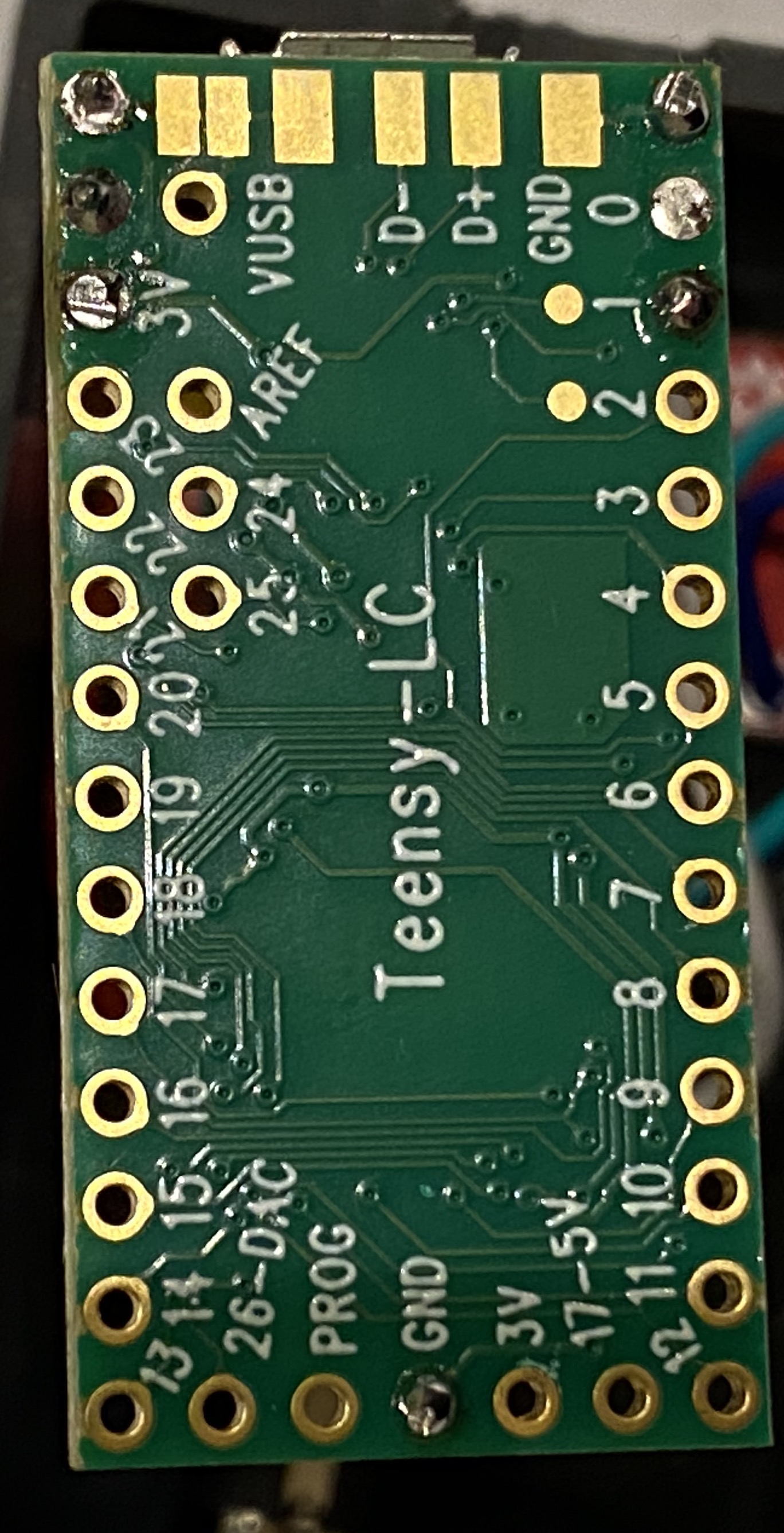

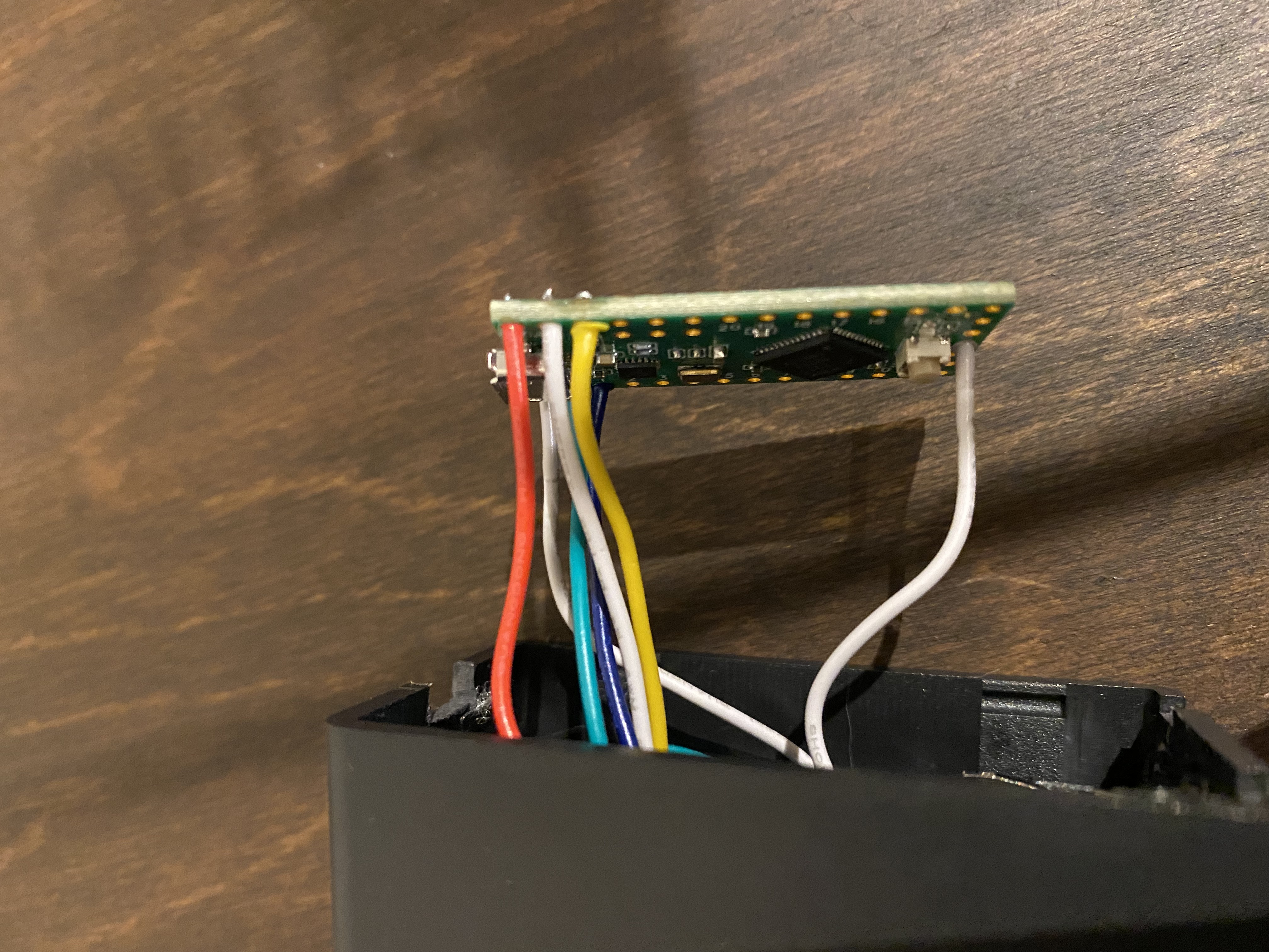

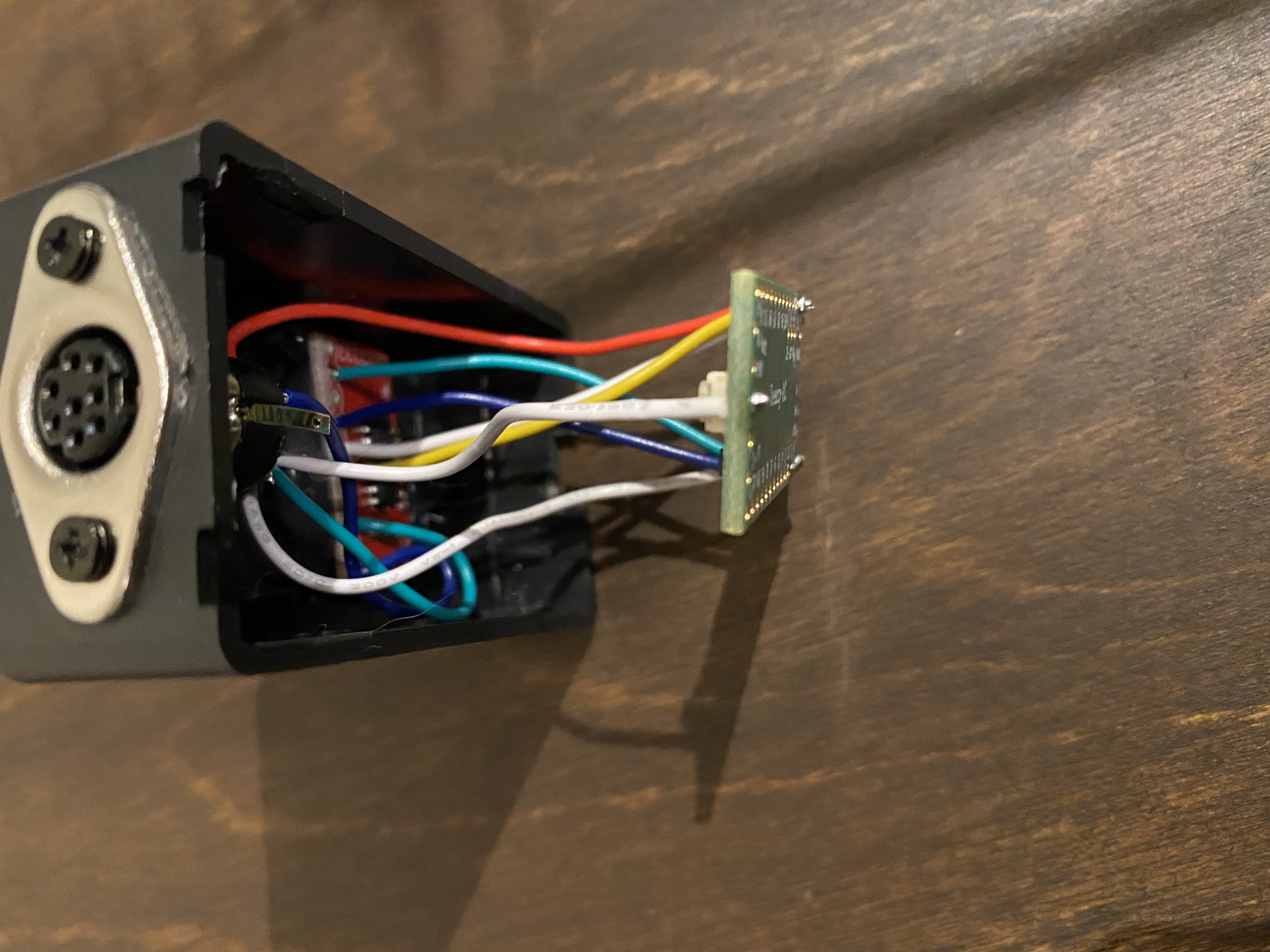

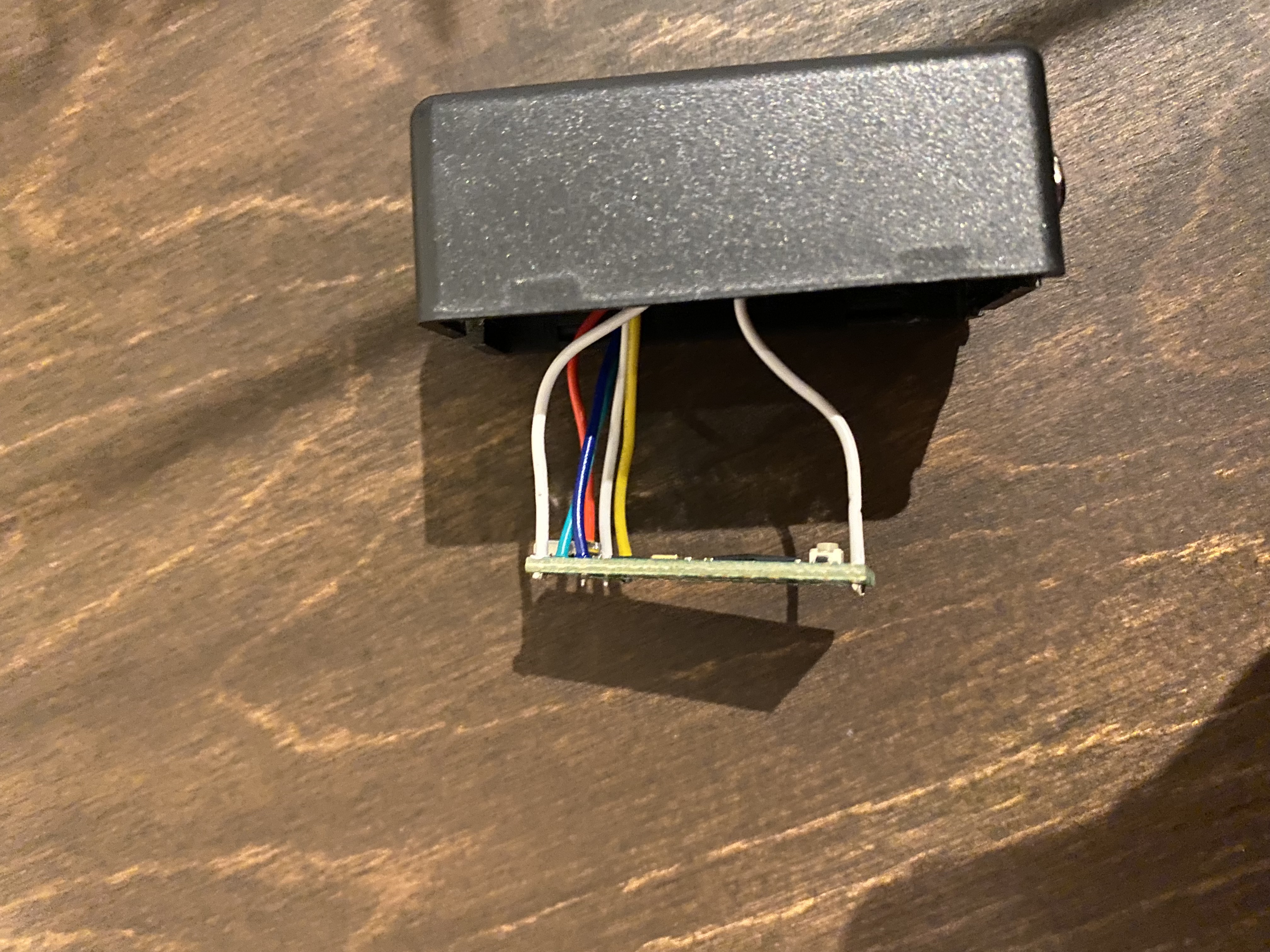

Here are some photos of my hideous work. I tried to build it all into a project box on the first try instead of piloting it raw like I usually do... Guess I learned my lesson when it looked like ass and I had to rip it all out. Then I thought I found the problem through rubber duck debugging while I was trying to type this out but...
IMG_0629 copy.jpg (3.18 MiB) Viewed 8204 times
Working with those little pads is dreadful. I think this generally resembles what you did though. The Yellow on mine is 3v from the Teensy going to the + and the White next to it goes to ground on the Teensy. White on the other side connects to 1 or 2, which are both ground. Green is from 3 and is TX from the keyboard. Blue goes to 8 and is RX for the keyboard.
IMG_0631 copy.jpg (2.61 MiB) Viewed 8204 times
This is hideous. Green goes to 0 on the Teensy and Blue goes to 1, which should be RX and TX respectively. The on the Teensy bottom to the left of center is 3v and the center pin at the bottom is ground.
IMG_0630 copy.jpg (2.76 MiB) Viewed 8204 times

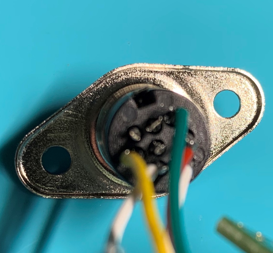

This shows the plug a bit better. Red is from 5V and connects to what I identified as 5 when I took the socket apart. Here's where I originally had a mistake... 5V was connected to 8 instead of 5. Hoping I didn't kill my keyboard with this oversight! I tested the fixed version on a spare and it didn't work either, so perhaps I didn't fry it. Anyway, I switched 5V to 5 where it belongs and put Blue to 8 (RX to keyboard) and tried again but still no luck.

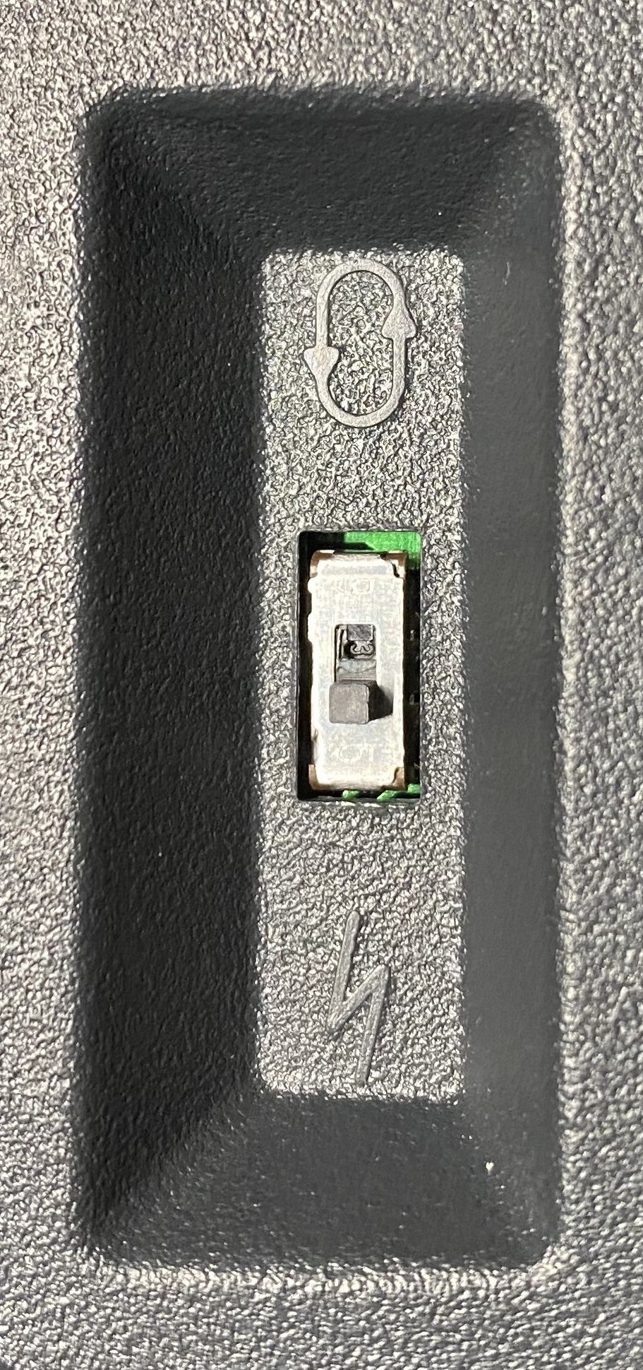

There's also this little guy on the back. I've tried it in both positions and had no joy.

MMcM
02 Jun 2021, 05:42
raoulduke-esq wrote: 02 Jun 2021, 04:04 Here are some photos of my hideous work. I tried to build it all into a project box on the first try instead of piloting it raw like I usually do... Guess I learned my lesson when it looked like ass and I had to rip it all out.
It's not so bad. Rework is the name of the game with these one-offs.
raoulduke-esq wrote: 02 Jun 2021, 04:04 Working with those little pads is dreadful. I think this generally resembles what you did though.
If I am not mistaken, the MAX3232 is backwards. That is, the left side with HW silkscreened on it is logic level and the right is RS232. In other words, rather than always being left-to-right, one side of the board is RS232 and the other side is TTL no matter which side is up.
But since this is so easy to get confused about, I wouldn't rely on my memory for this. Take a multi-meter to the pins and those of the chip and compare with the datasheet.
raoulduke-esq wrote: 02 Jun 2021, 04:04 Hoping I didn't kill my keyboard with this oversight!
In this case, I think that's pretty hard to do. The serial lines are connected to a MAX232 (earlier version) so it's prepared to handle moderately high voltages and even negative.
raoulduke-esq wrote: 02 Jun 2021, 04:04 There's also this little guy on the back. I've tried it in both positions and had no joy.
Ouroboros means loopback. In this mode a key press will light the corresponding LED. Nothing else happens, but that should tell you whether it's got 5V and whether switch / lamp type things are working.
Lightning-bolt is remote serial. That's where you want it.

Great observation about the MAX3232 having unique orientation. Makes sense. And it's not every day you get to discuss Ouroboros in a keyboard forum!
I tried changing the small chip to the other direction and still struck out. Normally I can put a few wires and some firmware that someone else wrote together successfully but this one continues to elude me.
As calmly as possible I yeeted (as the youths say) into the trash the Teensy and all of the extra chips and sockets I bought. I can't trust any of it now so I'll order again fresh... larger parts this time like that nice Sparkfun one and a socket that's panel mount or at least comes with the PCB if it's gonna be PCB mount.
Once everything comes in again I'll give it another shot. Hoping it's not a cable issue; I have just a regular 8 pin mini din cable from eBay where I had to cut down the rubber that squares off the plug to make it round again so it would fit the socket.

Ok... So my parts FINALLY came in! Enough parts for 2 LPFKs cost as much as one of the LPFK due to minimum orders, shipping, etc. from those boutique electronics suppliers. Amazon has spoiled me.
I'm as sure as I can be I put it together correctly this time. Same colors as last time. There's only 1 ground terminal on the SparkFun breakout board so I ran the 2nd ground from the connector to the Teensy instead of chaining it to the SparkFun, meaning that 3 ground wires are connected to the Teensy. That's the only difference. Paid close attention to what's TTL and RS232 and what direction.

Get it all connected up... Nothing. QMK toolbox recognizes the firmware, but that's about it. No LEDs. No keystrokes. Now I'm faced with the possibility that either my cable is bad or my NIB LPFKs are dead. Gonna start with a new 8-pin RS232 cable not from eBay if I can find one. Such disappointment.
