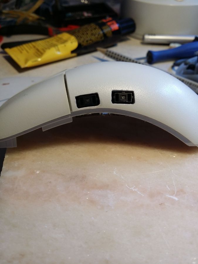

I need some sort of extended (?keep webs?) Cherry ML "keycap" as mouse button.
Pics are would me help to explain:
The hole is not as big as the switch. I would like to keep it that way .
But then the ?keep webs? of the keycap are a little short to fit...
Would anybody help to design a Cherry ML mouse button cap for me?
I have to measure how much longer the extension should be. At minimum it must be the thickness of the shell from the WMO (I think). I would like to use it for other mods too.

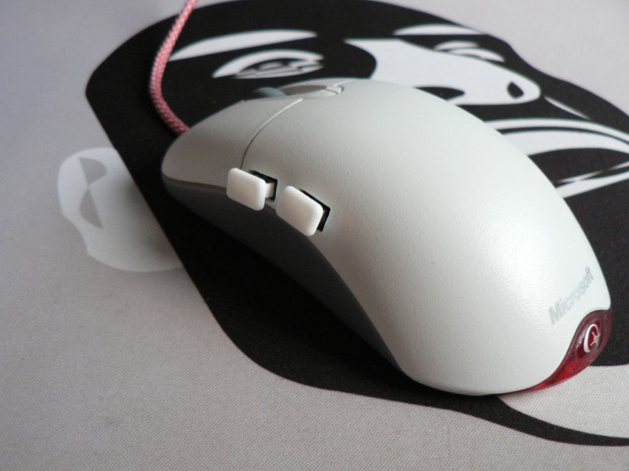

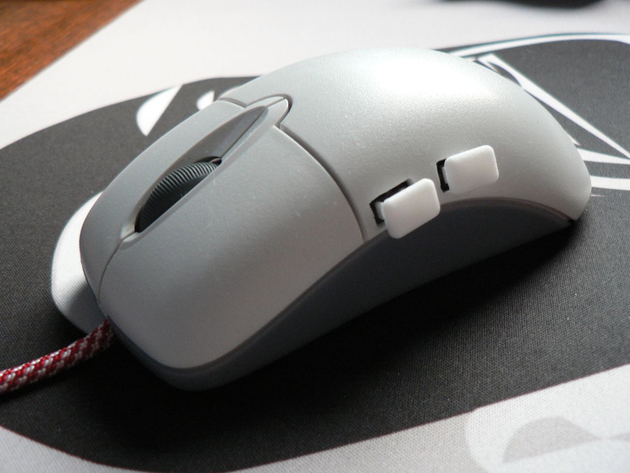

CeeSA
10 Jul 2014, 20:43
here with the mouse:
You could see that the switches are not "eye directed".
But I'll do it better next time.
The caps feel great because of the grip and the rounded edges.
Very comfortable.
Thank you very match suka! :)
guilleguillaume
10 Jul 2014, 23:36
I just saw the pictures on OCN too and I think it's a good mod but I guess it will be more comfortable if the buttons were more close to the shell.
Love that mod you did to your IMO 1.1 with 2 lateral buttons.

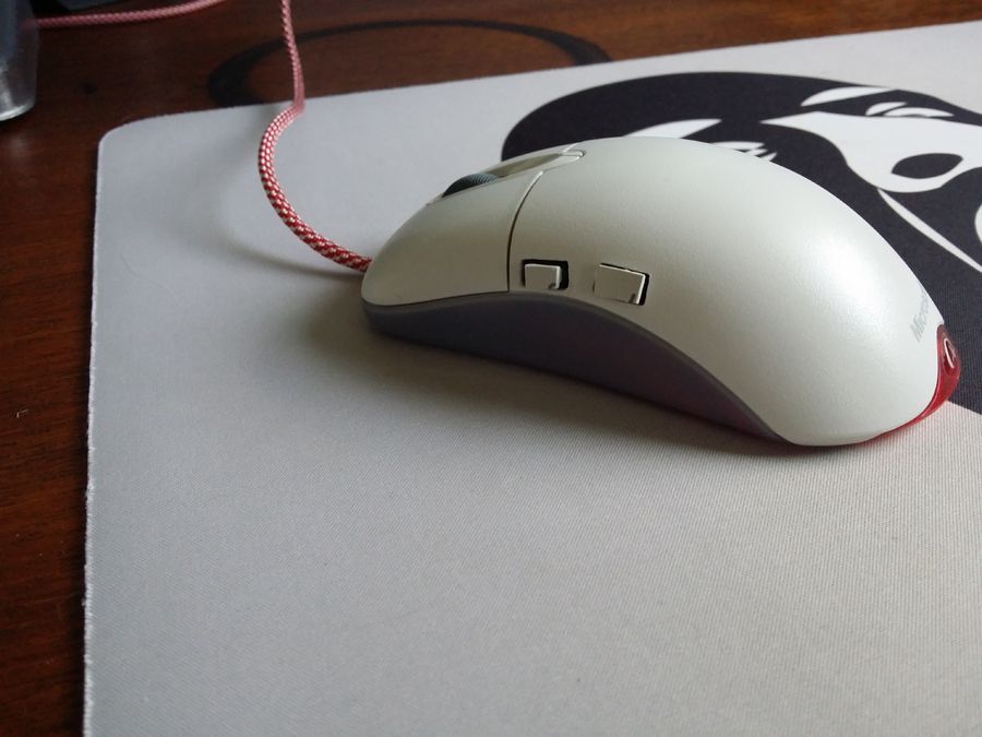

CeeSA
11 Jul 2014, 10:50
True, looks a bit odd. But the distance is inevitable. Until now I have no other solution for using a keyboard switch.
There is still an option to make a hole for the whole switch. But the final outcome would be not better thing in the distance.
It is comfortable to put the thumb under the side buttons and helps to have a good grip.
From here it is easier to press the buttons than it seems to be.

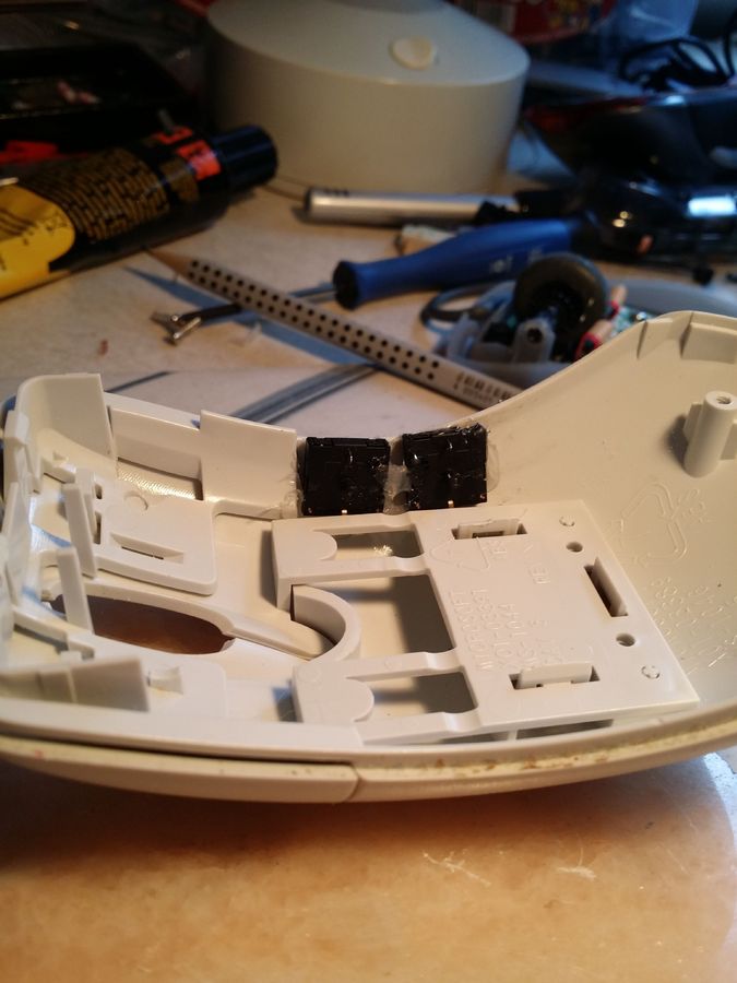

11 Feb 2015, 11:37
The buttons are fixed with hot glue (2nd pic).
To use the buttons as mouse button 4 and 5 I use 3 extra cables inside the sleeved cable.
The 3 extra cables are attached to a 2nd mouse pcb w// mb 4/5.
This pcb is from a RAT5 where the sensor stop working. But you could use every mouse that support mb4/5.
If you want more programable buttons look for a mouse w/ 4way mouse wheel. Left and right mw buttons could be program w/ X-Mouse Button Control.

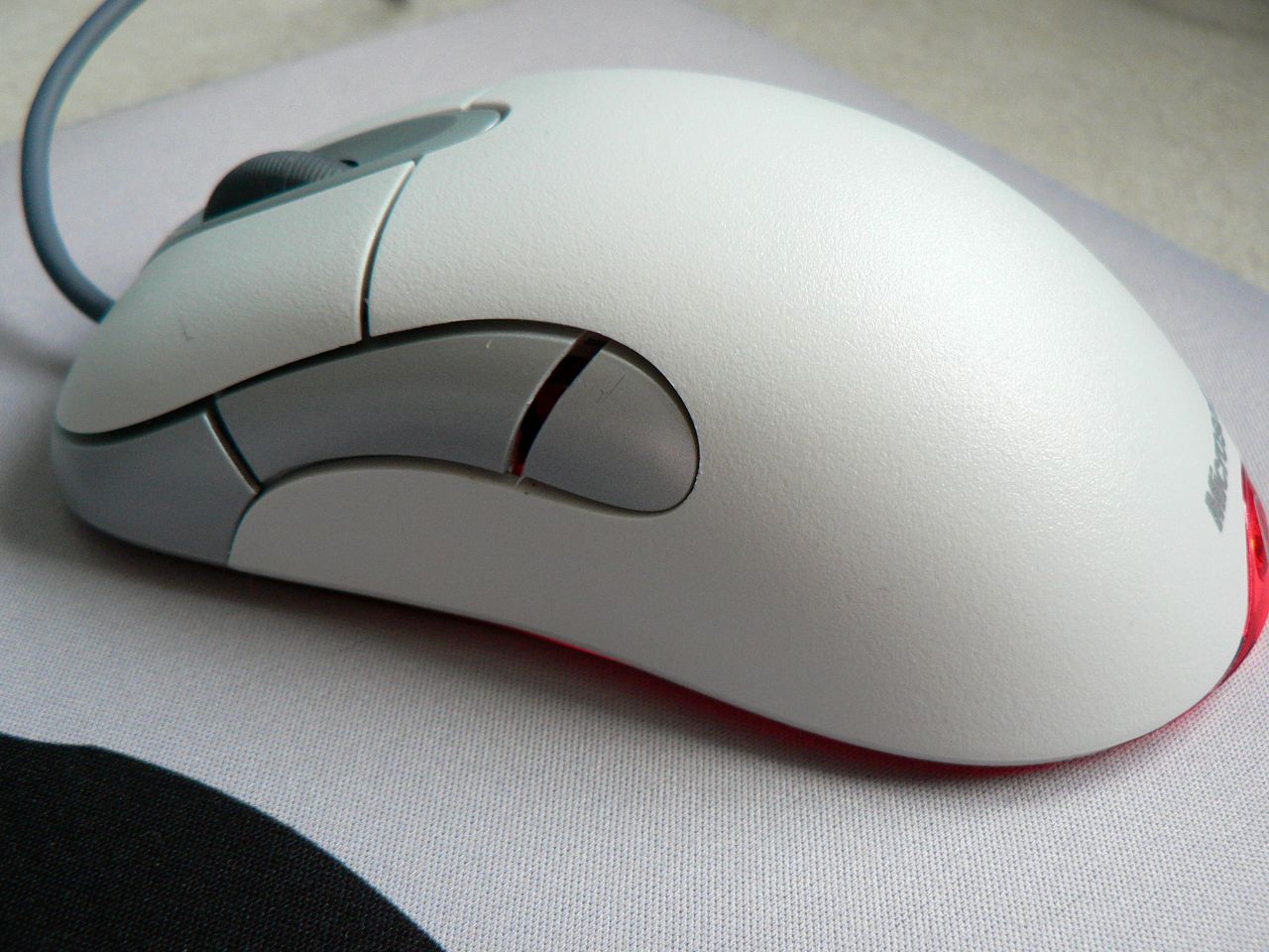

27 Feb 2015, 22:18
You could use a Microsoft IntelliMouse Optical 1.1A as an alternative:
