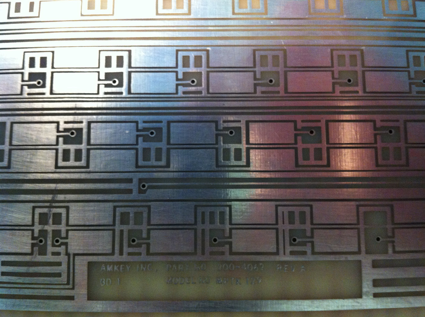

The “pad card” is quite interesting. The bottom side is simply a hashed ground fill (pretty!), with some hookups for the columns, no direct part played in the capacitive sensing:
The top side of the pad card is where the interesting stuff happens:
The funny bits (looking a bit like Chinese characters) inbetween the key pads is simply more ground fill. The capacitive part is formed by the over-under pairing of the two rectangular pads. The pads with vias connected to them are columns; the other side are rows.
This is quite a different system from what IBM used; they used capacitive coupling through no less than three capacitors formed by pads and the flyplate. The system Amkey used here I can see is more prone to stray capacitance (probably why they used a hashed ground fill rather than a solid ground plane, to mitigate some of that), but is resistant to electrical inteference without having to use the massive heavy bottom plates fitted to the Beamsprings and Model Fs.

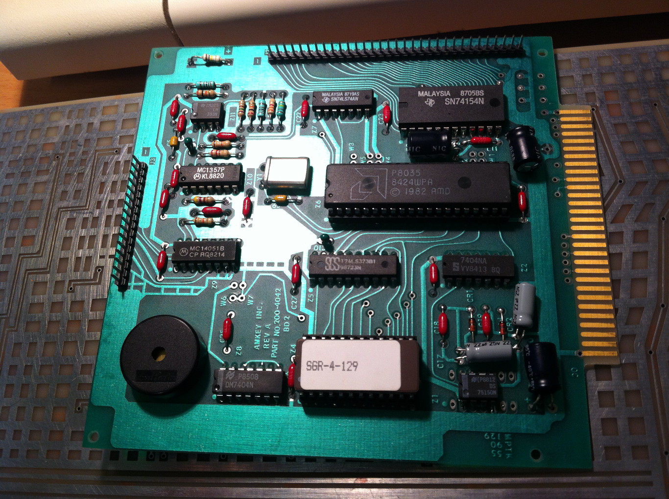

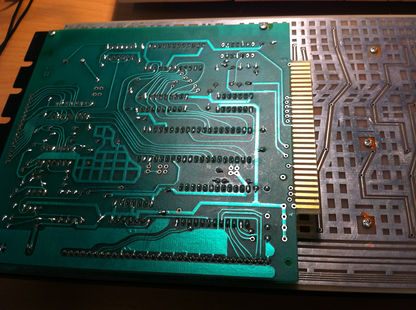

Let's take a look at the controller (don't you love that curvy hand-routing; one day Kicad, one day...):
Here we start to get an idea of how they're doing the sensing. The big AMD chip is some sort of micro; the chip at the bottom with the label an EEPROM. At the top right there is an 74154 to break out the 16 connections for the columns, so the micro only needs to drive four lines. The interesting stuff is over on the left, by the 16-pin row connector.
Here we have an MC14051 analogue multiplexer, to break down the 8 row sense lines into a single output. This is fed to the MC1357. What's that you ask?! Why, it's an FM amplifier! Something you would normally find inside an FM radio or a TV. Why is it here? Well, bearing in mind RF/radio is not exactly my area of expertise, the MC1357 is a certain type of FM chip. It's got a quadrature detector in it. This gives us a clue. Quadrature detectors are designed to carefully follow oscillating signals and pick out when they start deviating from a certain frequency. They are tuned to a certain frequency (the knob on your radio!), and then feed the signal through a capacitor which shifts the phase and allows the detector to measure how far the signal deviates from the centre frequency. Sound useful? In this implementation, the capacitors within the keyboard are used as part of the circuit, varying the centre frequency and with the use of a little comparator (8-pin LM393 at the top left) to scale the signal back to TTL we can read the pressed keys.
It's an inventive use of a part designed for something completely different, but would be highly effective and reliable. On the negative side, you could see you'd need to hit each column with a few square wave cycles before you'd be able to read the result, so it's not quite as fast as the IBM dV/dT method that I pinched for my controllers.

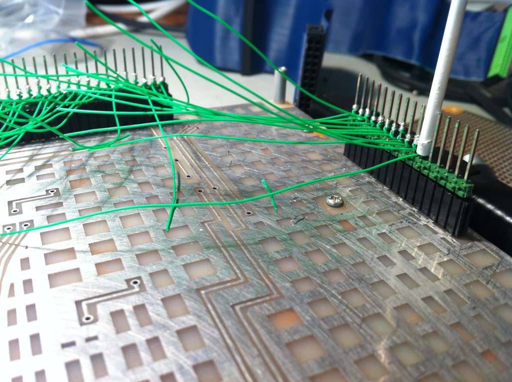

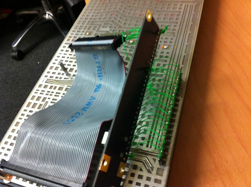

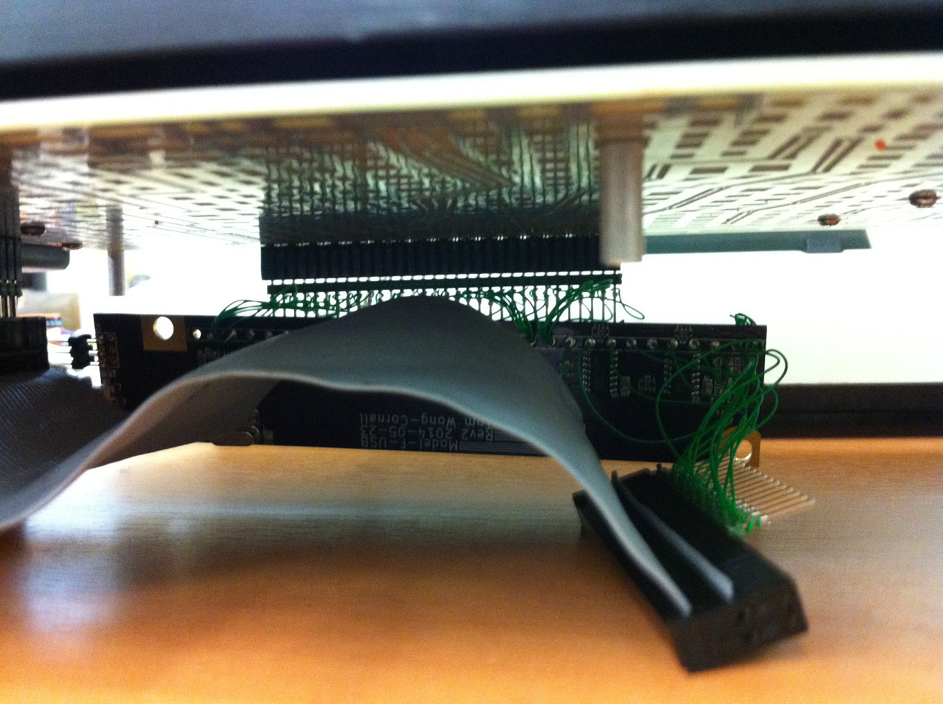

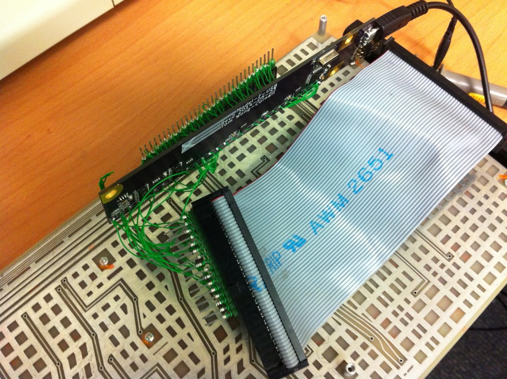

I needed to break out all the pins to wires; the method I used to do that was era-approriate for the keyboard: wire-wrap. I realised I had a bunch of long pin headers and some wire-wrap wire, so I made a wire-wrapping tool out of an old ballpoint pen and got to work. Here's the hideous results:
I then started hooking these up to the Model F USB controller. It got a bit hairy when I realised I had the controller backwards but that was fixed with a long ribbon cable:
Does it work? Kind of! I have a bunch of faulty connections (I tried just blobbing solder in there on the controller without stripping the wire; it often works with that thin Kynar insulation as it just burns off, but not 100% in this case), but nevertheless I was able to set a manual threshold voltage on the controller and press keys and get responses :D It's missing some columns and one or two rows, but nevertheless I can damn near use the thing.
Interestingly, changing the threshold voltage actually changes the “activation point” of the linear keys. I will have to be careful with my so-called debounce filter (there's nothing really bouncing here of course), as without the mechanical hysteresis of the IBM beam/buckling spring there's the potential to get some rapid toggling of state if the key is held half-down.
It's a bit over-sensitive and fiddly at the moment, but that fact that it's working at all in that state (with wires tangled everywhere, no proper grounding etc.) is excellent news. I'll have a bit more of a play with it to see if I can't get all the keys working (might have to tweak some constants inside the keyboard scanning logic), and then it will be a matter of deciding whether I can get by with a simple Model F USB -> Amkey adaptor, or whether I want to design a full controller. I'm leaning towards the second in terms of tidiness and cost at this stage.

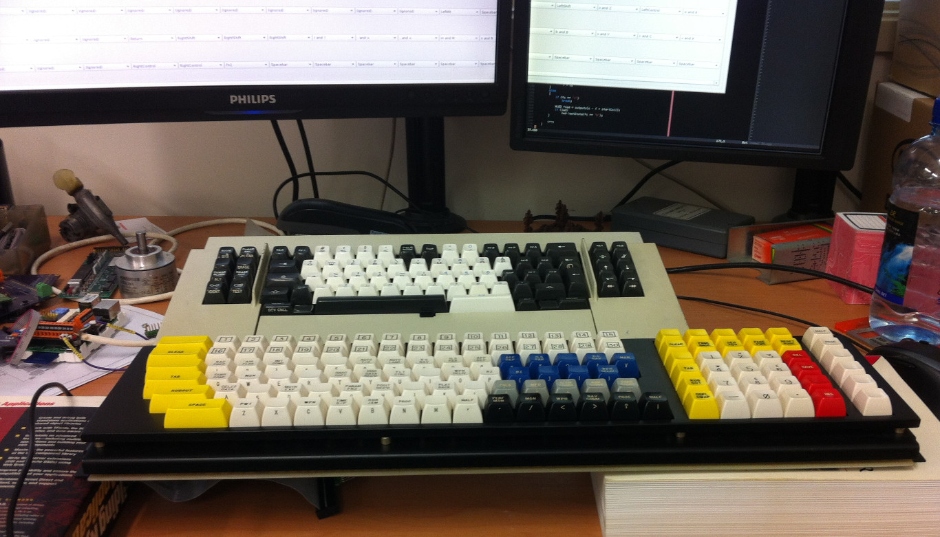

Well, I'm typing this post on the damned thing now. No weird key repeats, no glitches or ghosting, no scan issues at all! The only problem is proving to be me not knowing where to put my hands; I've mapped the whole thing up a row so I can use the bottom-most row as a many-keyed spacebar. The lack of a backspace in the usual place is also proving a bit mind-boggling for some reason. I imagine if you're into Maltrons and matrix boards and other weird things this will all feel perfectly natural but it's freaking me out :lol:
I simply fixed the dodgy connections I'd made yesterday, found a voltage threshold where all the keys worked properly (140 seems good), and set about mapping all the keys. There's no calibration nodes in the matrix, so setting a fixed voltage threshold override will be necessary, but there haven't been any nasty suprises! The hardest problem has been figuring out what scancode to map to each key... there's certainly no shortage of them! I've doubled up on a bunch of scancodes; for example, the three keys at the right of the main block on the third row are all Enter (including WPN DELIV... satisfaction every line ending).
I've got the whole setup propped up on books at the moment (there's obviously all my hairy prototype wiring hanging loose in there at the moment), excuse messy desk:
Underneath there's this mess:

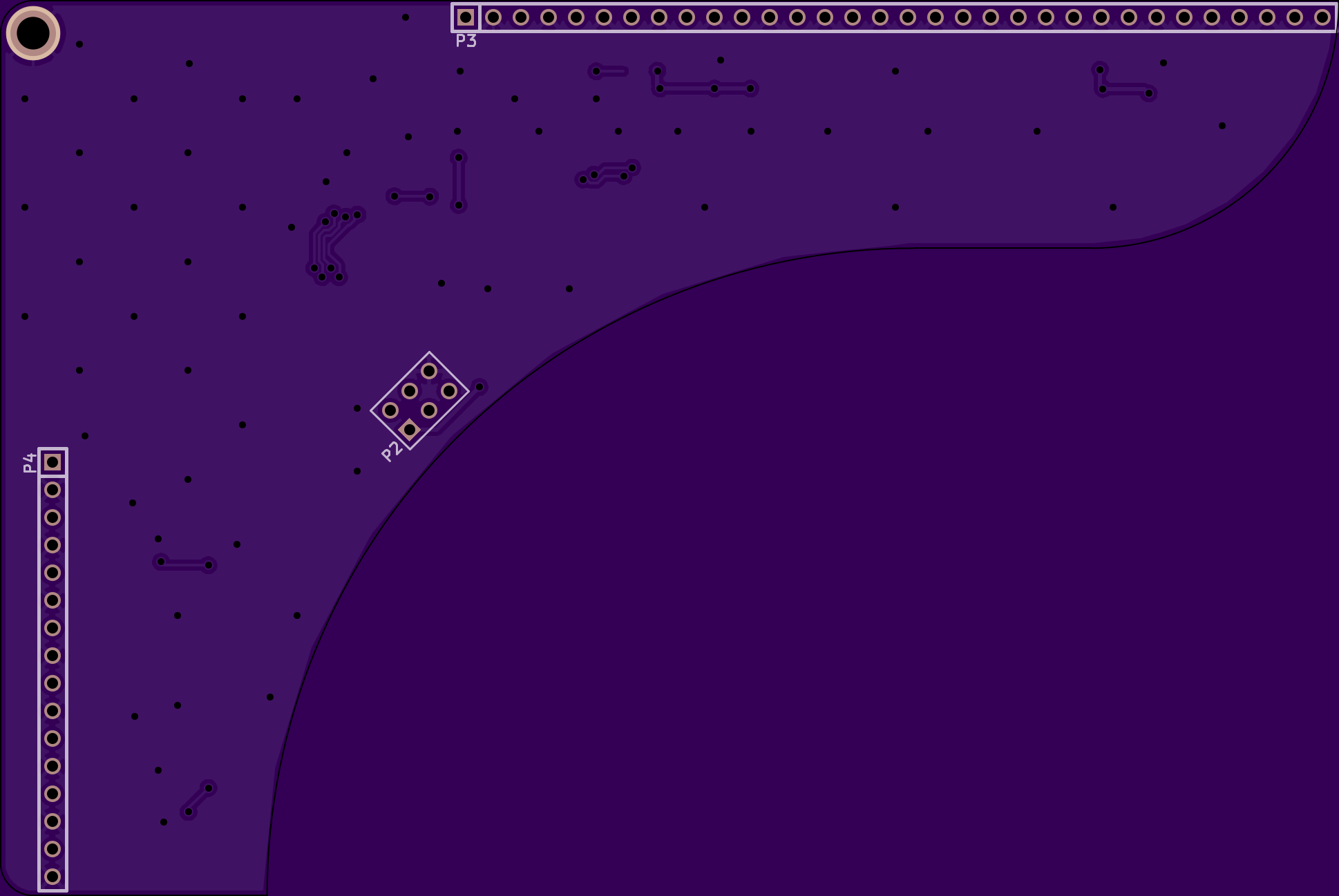

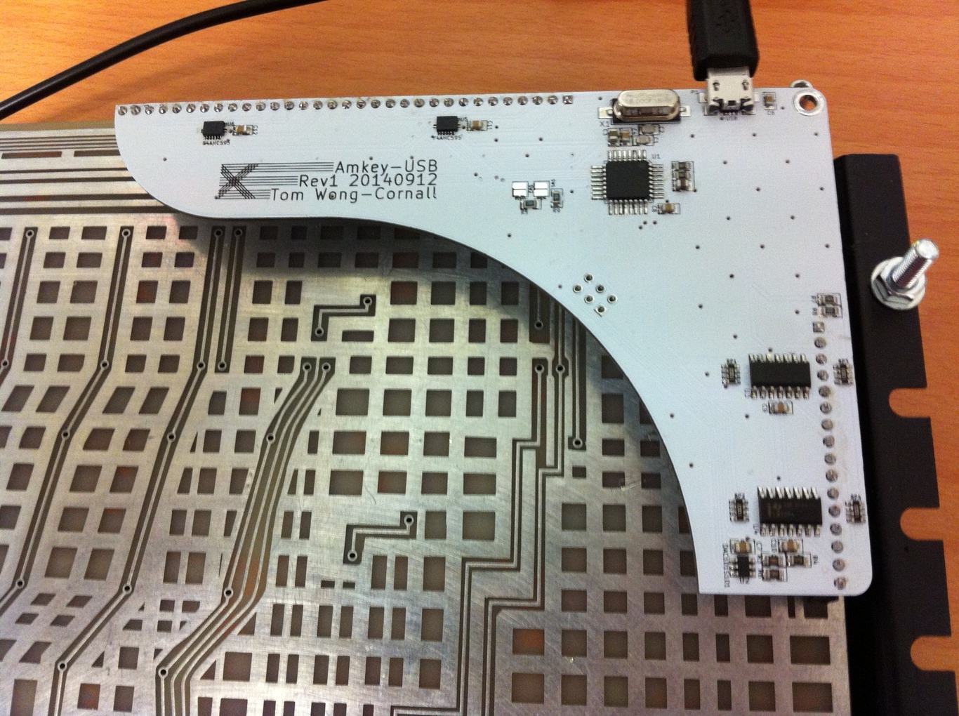

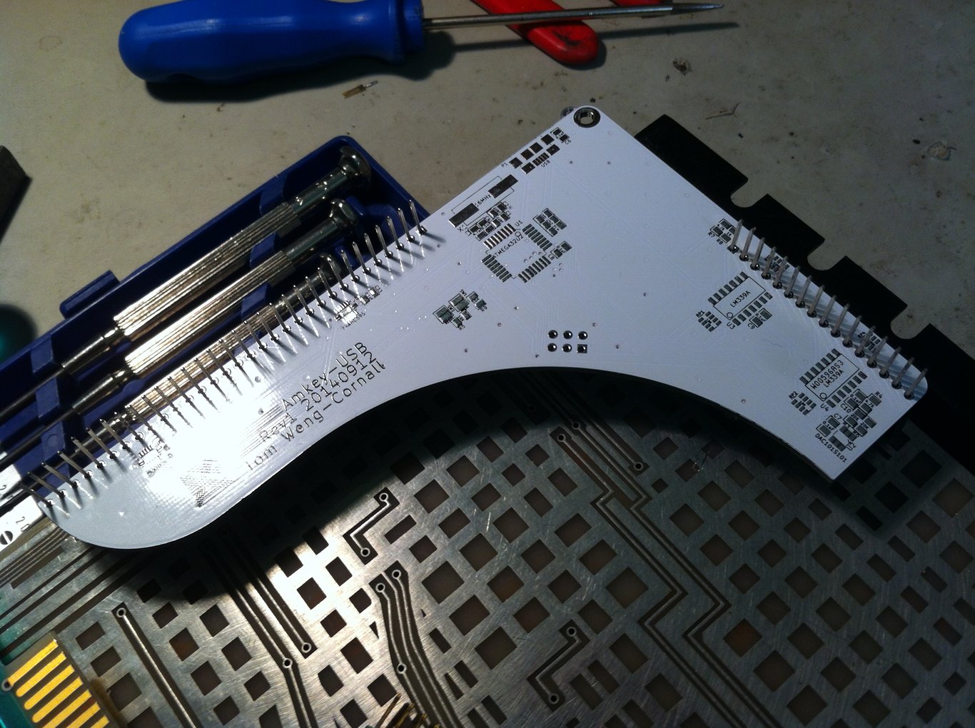

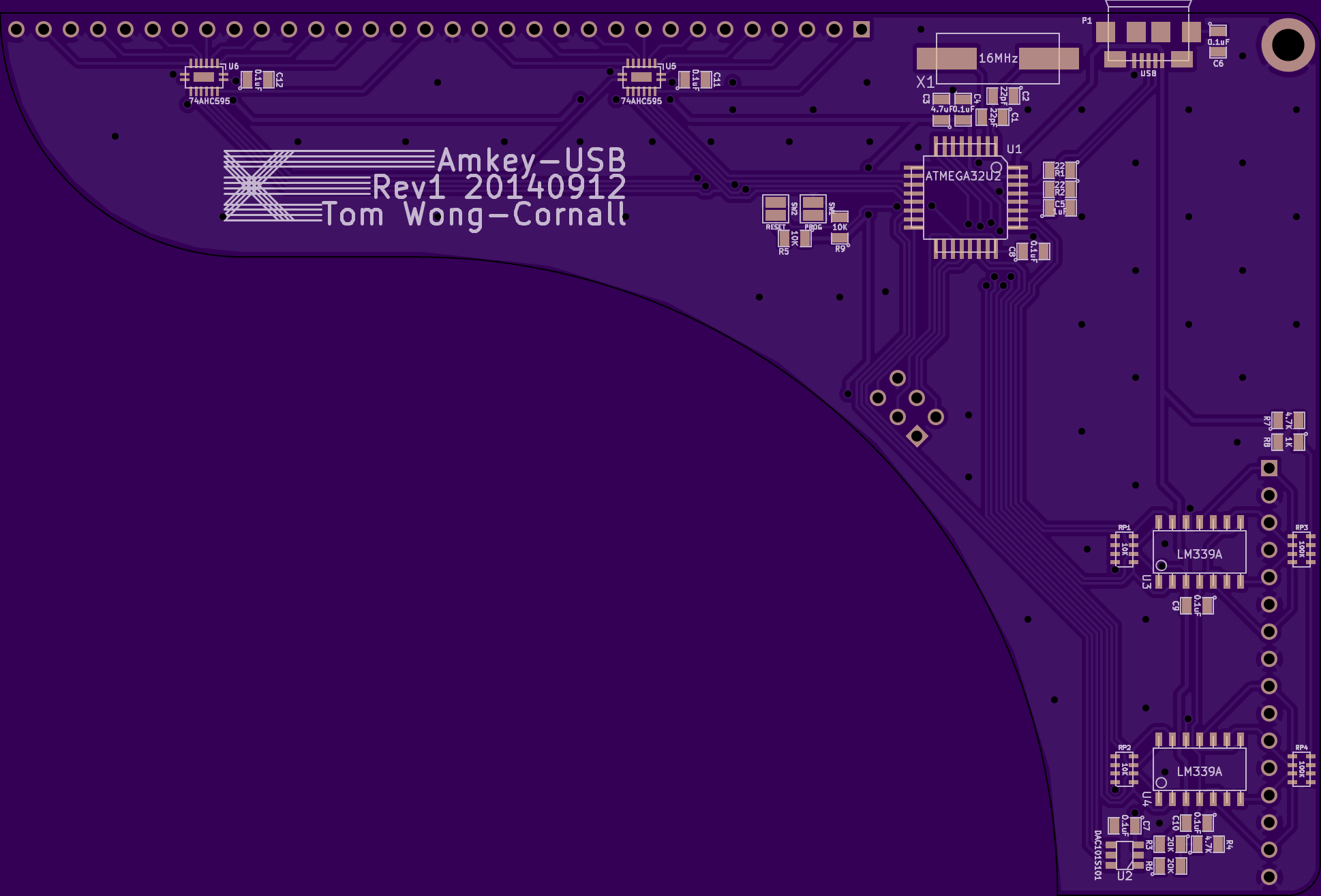

I think I've finished the controller... it's essentially the same circuit as the Model F USB, just with different pinouts to the keyboard itself etc.
top:
bottom:
I've placed all the components (apart from the 90° right-angle pin header/expansion header) on the bottom, unlike the original controller. All of the components are pretty low-profile so it won't really increase the thickness very much. It was just much more simple to lay it out this way, meaning much less crossing over of some of the delicate stuff near the columns/rows connectors to the keyboard.
It's a relatively large board compared to the other ones, just because the row/columns headers are placed physically quite far apart. You pay by the bounding rectangle at OSH Park, so it comes out as a relatively pricy board. I may get it fabbed at another fab I use sometimes for larger stuff. They also seem to have a faster turnaround time, and I don't have to stick with the skody old purple. The quality isn't quite as good as OSHPark (especially silkscreen and solder mask resolution/alignment), but it's perfectly acceptable for something with a relatively low-spec board like this. I wouldn't necessarily these guys for an 0.5mm BGA though...

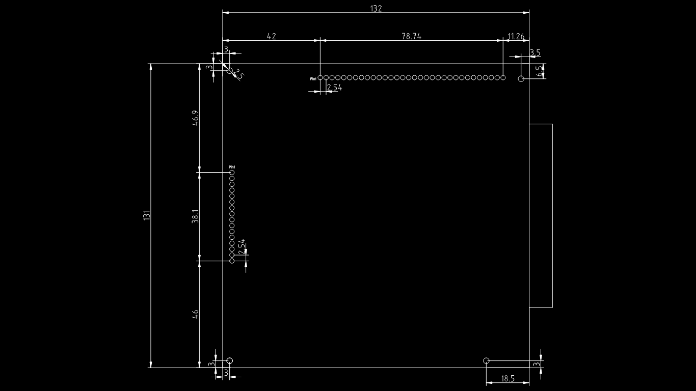

hey xwhatsit perhaps it would be possible to fit two boards in the same (or slightly larger) rectangle? in a sort of nested configuration (rotated 180o)?

chzel—do you mean duplicate the board and manufacture it as one board with OSHPark? They're actually not that keen on you trying to game them with tricks like that, they say one board per submission. The other trick is separating the boards, because they don't do V-scoring etc. And then I'd end up with six of the blasted things :lol: It's not a big deal; this other PCB manufacturer doesn't do too bad a job and I've been keen to try their white soldermask with black silkscreen anyway :)

xwhatsit wrote: chzel—do you mean duplicate the board and manufacture it as one board with OSHPark? They're actually not that keen on you trying to game them with tricks like that, they say one board per submission. The other trick is separating the boards, because they don't do V-scoring etc. And then I'd end up with six of the blasted things :lol: It's not a big deal; this other PCB manufacturer doesn't do too bad a job and I've been keen to try their white soldermask with black silkscreen anyway :)
That's exactly what I meant! I didn't know OSHPark's policy on this, but you can try SeeedStudio, I have used them before and they are nice quality and fair price.
They accept panelisation and multiple designs per board, but in its basic service don't do v-score. They do route external and internal shapes though!
Separation is a bit of a problem, but with enough clearance between boards even a dremel cut-off wheel works fine!

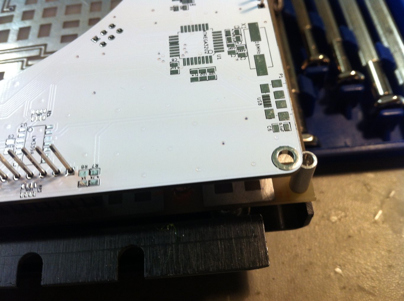

Yay! Shiny white goodness arrived this afternoon!
Sadly I made a balls-up; hopefully my only mistake:
That shouldn't really be an issue; having 48 pins holding the thing on is more than solid enough.
I won't have a chance to put this together this weekend (almost had to fly overseas for work), but I'll be tackling it ASAP in order to put my mind at rest :)

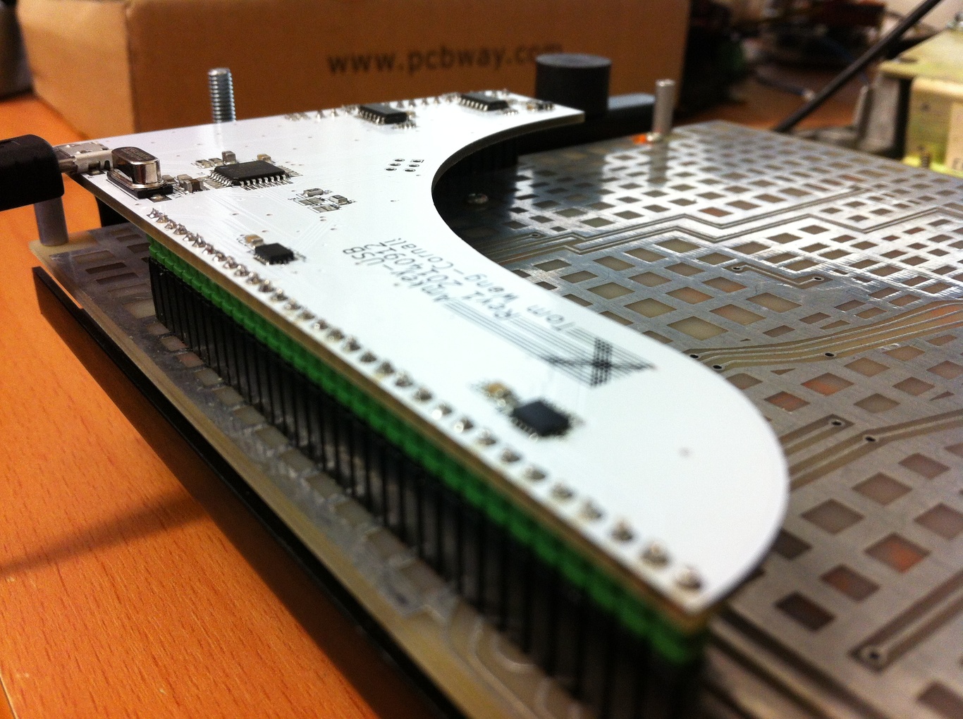

Manage to get onto this today (yesterday and the weekend were a write-off; there was a major substation fire which knocked electricity out to half of the city from Saturday to late last night—not my house, but my reflow oven is somewhere else :) ).
Good news, it works :D

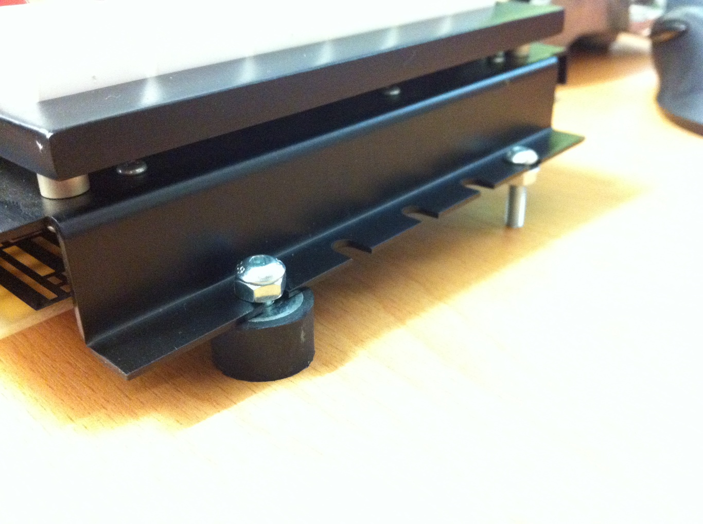

Oh this is my keyboard-feet solution:
A bit slidey but I ran out of more rubber feet. More of them arriving in a few days as well.

10 Oct 2014, 00:27

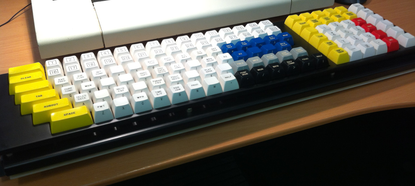

So my cow-orker (who madly decided “this is the keyboard I'm going to use today”) took the thing and started mapping usable keys onto it, an exercise which has proved reasonably frustrating, mostly because of the lack of a spacebar.
However we got to wondering how many keys it had; not being very good at counting we came up with various answers until we finally settled on 129 keys.
129 keys?! My controller can only support a maximum of 128 (16 columns and 8 rows), and of course the keyboard itself can only support up to 128, as it has just that—16 columns and 8 rows. After mapping every key on the keyboard to something we discovered the unfortunate fact that the Tab key on the top-left of the keyboard and the Tab key on the numpad are in fact internally connected together on the keyboard itself, so are inextricably linked together as the same key.
This would be a problem on a smaller keyboard, but is probably not as much of a big deal on this behemoth, which has keys to spare. Still, somewhat unfortunate! Amkey must have designed their keyboard and then realised they had one key too many, so just found two similar keys and wired them together.
