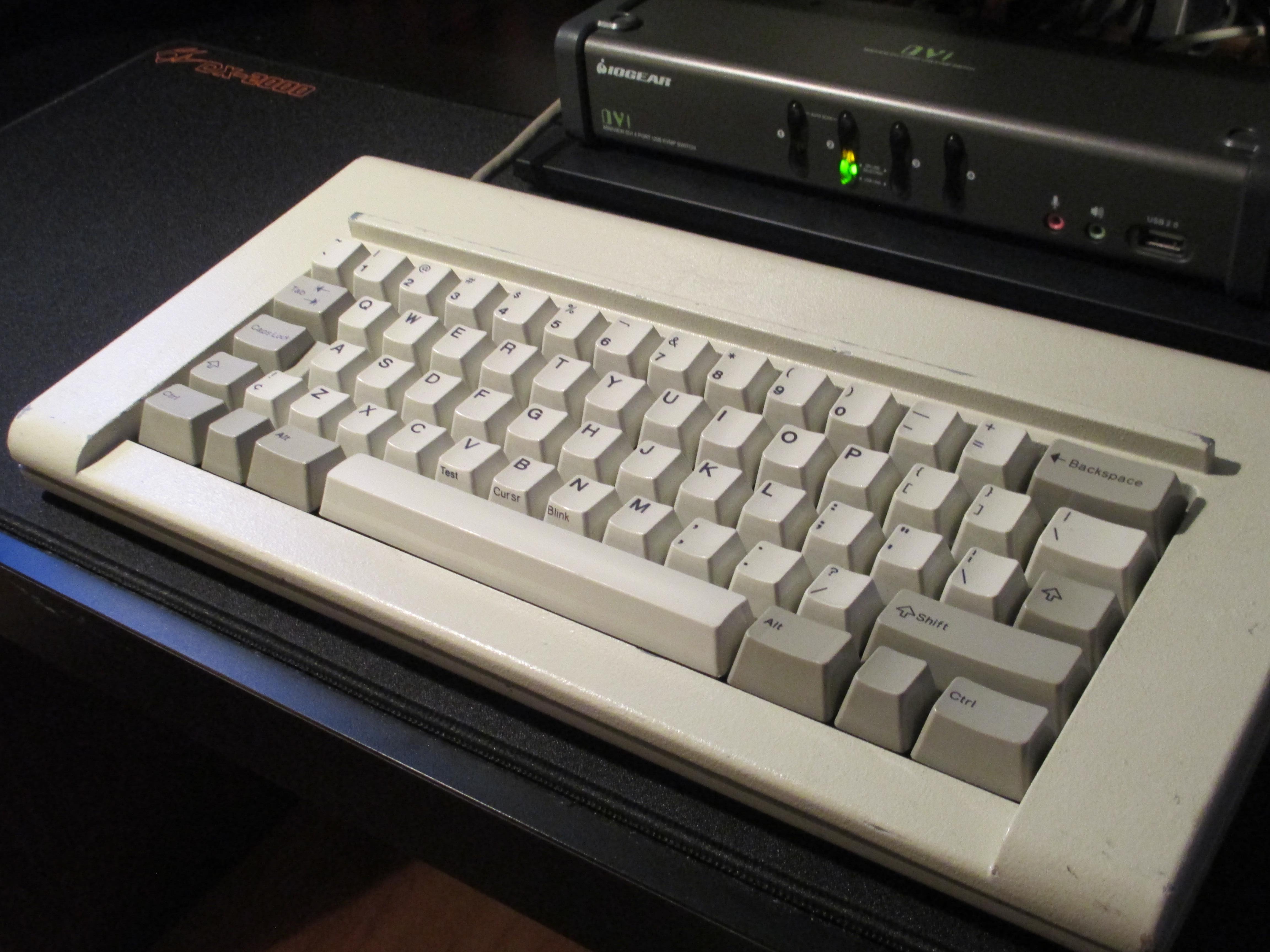

Look what landed on my desk, just in time for Thanksgiving!
This is my first "Before" pic of my "new" Kishsaver. It seems to be in relatively good shape, although I have not yet dismantled it. There is one bad spring/pivot plate assembly and it needs a new spacebar stabilizer wire (which I have).
This will be my only Christmas present this year, so it has to go back in the box to be opened on December 25. In the meantime, I am collecting parts and suggestions for the refurbishing and installation of an xwhatsit Model F controller (Rev. 2).
Among the things I hope to do:
-- Sand-blast and powder-coat the case and barrel plate. I am thinking of a dark gray, matte black, or "oil-rubbed bronze" for one of the dark color schemes I have seen on these pages and over on GH.
-- Change springs and inserts to yield an ANSI/Mac/HHKB layout.
-- Replace mods and spacebar with blank black keys; keep ivory-white alphanumeric keys.
-- Install a panel-mount micro-USB receptacle for a detachable USB cable. I would like to select the site for this in the case and do any necessary drilling before having the sand-blasting and powder-coating done. Suggestions welcome on where to locate the receptacle in the case.
-- Install an xwhatsit controller (Model F Rev. 2). Suggestions welcome on where to find the latest instructions and firmware with explicit instructions on installation of the hardware and firmware. My primary OS is Mac OS X (10.10.1), but I also have access to Linux Mint 17 Xfce and Windows 7 Enterprise.
What a great day! I am motivated as never before to get going on the restoration. Between now and Christmas I will be gathering suggestions and instructions.
