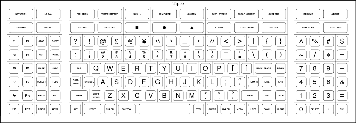

Here is my current layout.
As your can see, I need some more keys from Round 4.
Also, I still have to find suitable scan codes.
Some get blocked by the system, once the scancodes had been assigned a key code using setkeycodes(8).

So cool! A lisp keyboard! The parens are misplaced though ;)

Minskleip wrote:So cool! A lisp keyboard! The parens are misplaced though ;)
It is a mess-up of the Symbolics-, Sun-, and IBM-cultures.
