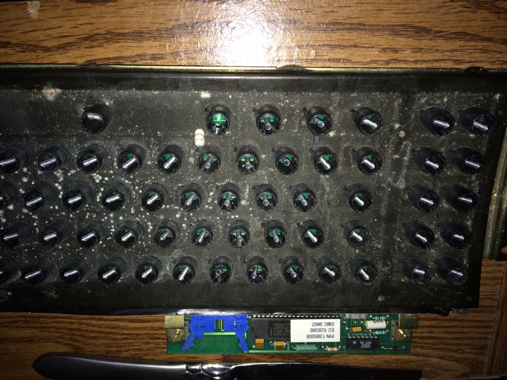

Controller board.

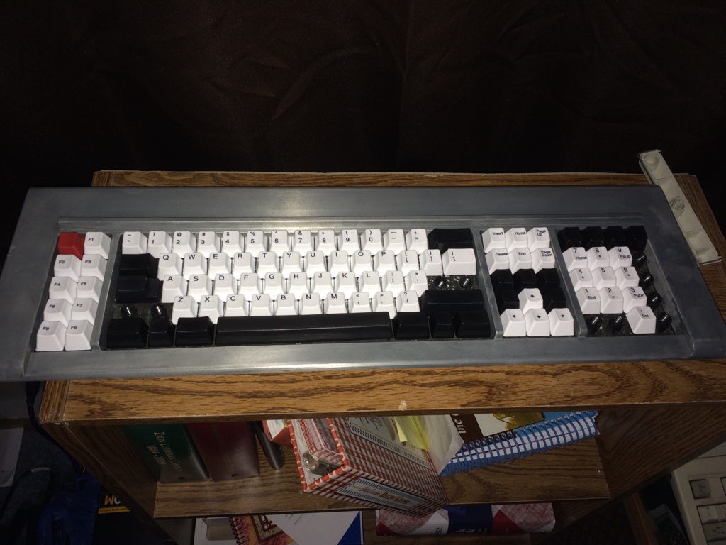

Small update. Finally got to finish stripping my case and I am clear coating it. I think it is going to turn out ok but I'll know tomorrow for sure. I snapped some pics right after I put on the 3rd coat.
[img width=640 height=853]http://i195.photobucket.com/albums/z274 ... 2623ef.jpg[/img]
[img width=640 height=853]http://i195.photobucket.com/albums/z274 ... f05b4f.jpg[/img]
In both pics the top case is wet, bottom case is dry.
On another note Unicomp confirmed my not so secret Christmas present from my parents shipped from unicomp. (My key cap set and inserts as described in the post above). I'm inching towards completion!

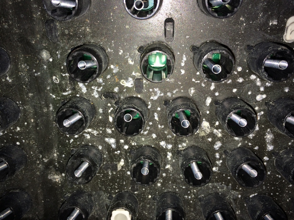

Tiny update. First took all the old keys off to look at the barrel plate. Pretty good shape. The white spots on it are from keys bottoming out. Secondly I just couldn't resist so I put the new keycaps I could on. Pretty happy. Unicomp gave me a black vs white space bar so a bit sad they messed that up but I guess I'll order a white one at some point. Also I would like to order a black backslash key. A red printed esc key. The alignment on the insert, home, and delete keys is pretty bad so I want to replace them at some point.
Potato pics
28 Dec 2014, 02:19
Come on, man!
You can't leave that nasty repulsive barrel plate like that inside such an exquisite artifact!
Bring it up to the standards it deserves. Even if you aren't actually going to fix it, a coat of Rustoleum "hammered" paint would do wonders.

Touch_It
28 Dec 2014, 02:22
Oh, guess I didn't say what my plans were. I fully plan on disassembling and restoring the barrel plate to glory. Open to suggestions on color and tips on prepping it. I have a lot of work to do, just wanted a taste of the finished product.
