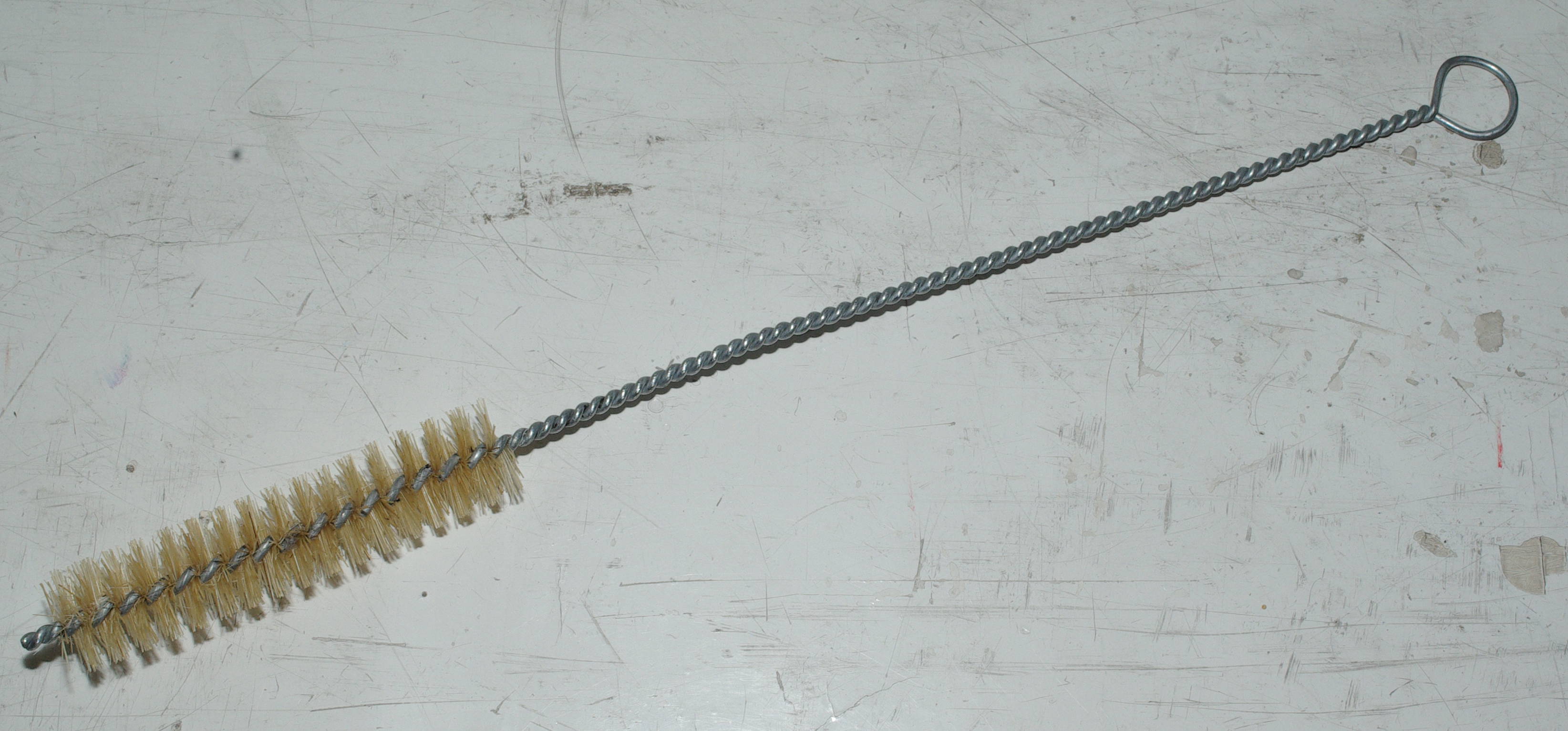

Good question crunch. Q-tips work but I find them tedious. I found this household cleaning brush on a metal stick (bendable) to work well on a lot of keyboards. Fits between the switches and saves time. Of course that´s only for removing dirt. But soaking is the best solution.
