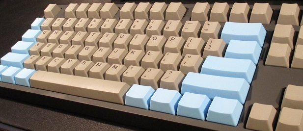

Cherry mx board and Costar-type stabilizers with thick PBT keycaps. A Cherry mx board with Costar-type stabilizers such as the WASD V2 87 cannot be fitted with some of the thick PBT keycap sets, because the stabilizer wire rubs against the inside front edge of the stabilized keys. Recently, I found this to be a major problem with a new Leopold thick PBT set. The problem seems most pronounced on the Enter key, which had some degree of friction with the stabilizer wire on thick PBT keycap sets from Ducky, Imsto, and Originative. Some people have been able to correct the problem by sanding down the inside front edge of the problematic keycaps. I ended up using Imsto caps, silencing the downstroke of the Spacebar by installing black 50A-R O-rings, and substituting an Enter key from a Wyse doubleshot set. This problem did NOT occur with the Granite set, but I found it difficult to type on the WASD keyboard using the Granite set -- the keys felt too light, and I was unfamiliar with the profile and spherical key tops.

Hybrid Topre. The situation starts to get complicated with the introduction of a hybrid such as the CM Novatouch keyboard, which has Topre switches with Cherry mx-compatible stems. With this keyboard, I found that the Leopold set worked quite well. The Granite set also worked well with the exception of the Backspace key, which apparently hits the stabilizer housing, creating a loud downstroke click that does not occur with any of the other keys. I alleviated this by installing blue 40A-R O-rings on the Backspace key. Oddly enough, I found it much easier to type with Granite caps on the Novatouch than on a regular Cherry keyboard, such as the WASD. The sound and feel of the Novatouch was rather sensitive to the keycap set used and whether or not O-rings were added. Although it is fun to experiment, it can also be frustrating finding just the right keycap set for optimal sound, feel, and performance.

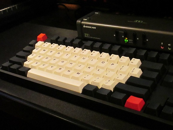

Keycap profile. I finally realized the importance of keycap profile while experimenting with my WASD keyboard. I like to bottom out with every keystroke. I like the bottoming-out sound. However, I could not get the same sound with the Enter key that I was getting with other stabilized keys on the keyboard. I thought that the Enter key felt relatively mushy and unresponsive. I kept replacing the Enter key with Enter keys from other Cherry mx sets with no luck. I thought the stabilizer wire might be rubbing against the inside front edge of the keycap, and so I tried shaving this edge with a sharp knife followed by sanding to a smooth finish. No luck. Then I realized that the stabilized keys that were giving me a satisfying bottoming-out sound were on different rows of the keyboard -- with different profiles. So, I replaced Enter with a Left Shift and -- voilá! -- I got the bottoming-out sound I wanted.
Most Cherry mx keycap sets are made with the Cherry profile, whereas keycaps that ship with many Cherry mx-switch keyboards are OEM profile, which is generally higher than the Cherry profile. I dug out an Enter key from an OEM set made of thin ABS plastic and put it on my WASD board. Again, I got a satisfying bottoming-out sound, which gives me the feeling (if not the reality) that the Enter key was properly responsive.
Incidentally, the Granite set did not cause problems with the stabilizer wires. I think this may be due in part to the profile of these keys, which are all the same profile but high enough and thin enough to avoid contact of the inside front edge with the stabilizer wire. I haven't used these caps long enough to know if I will like them. I am accustomed to keycaps with a sloped profile and cylindrical tops rather than the spherical tops on the Granite set. Aesthetically, however, the Granite set is arguably one of the handsomest in existence.

UPDATE: After considerable experimentation with the CM Novatouch, I have concluded that the best keycaps for this keyboard are high-qualify PBT in OEM profile. In particular, the dye-sublimated or blank PBT sets in OEM profile made by Ducky work extremely well.
