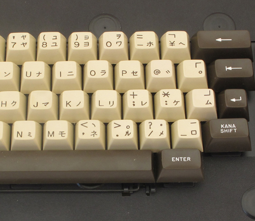

I got this Cortron/Licon keyboard (ITW magnetic pulse switches?) with Japanese double shot keycaps, made in Dec. 1980. (NOS)
It has an IBM 3270 layout, so it was probably used on a 3270-compatible terminal.
The switches are linear, quite smooth - Honeywell hall effect in feel but with a bit of a "clacky" noise coming from the keycaps when bottoming out and releasing, which I like. The keycap material feels a bit cheap though.
The PCB is an unusual shade of tan:
Notice the Licon logo. It is "Made in USA" - strange for a keyboard with Japanese keycaps. Licon also made keyboards for UNIVAC.
There is a protruding thing on the back of the PCB, which I assume is a solenoid:
The "P" key isn't working properly. Probably the spring in the switch is snagged on something. So it looks like I'll have to de-solder that switch, open it up and fix it. When I do, I'll post my first "switch dismantle" photos. (didn't want to, but now I have no choice)

In the second pics, some of the alpha caps look engraved. Is that contributing towards the feel, or is it entirely in my imagination?
But why did you have to post that link? How on earth am I going to stop myself buying one of them Univacs?
mr_a500
I think it's entirely your imagination.

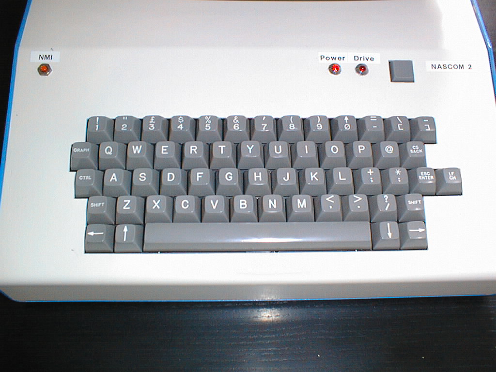

I used a Licon keyboard for years, easily the best keyboard I ever had. It was on a Nascom 2 computer (UK built Z80 based micro from the eighties). The capactive transfer switches have fantastic feel, far superior to the cherry browns I'm bashing at the mo).

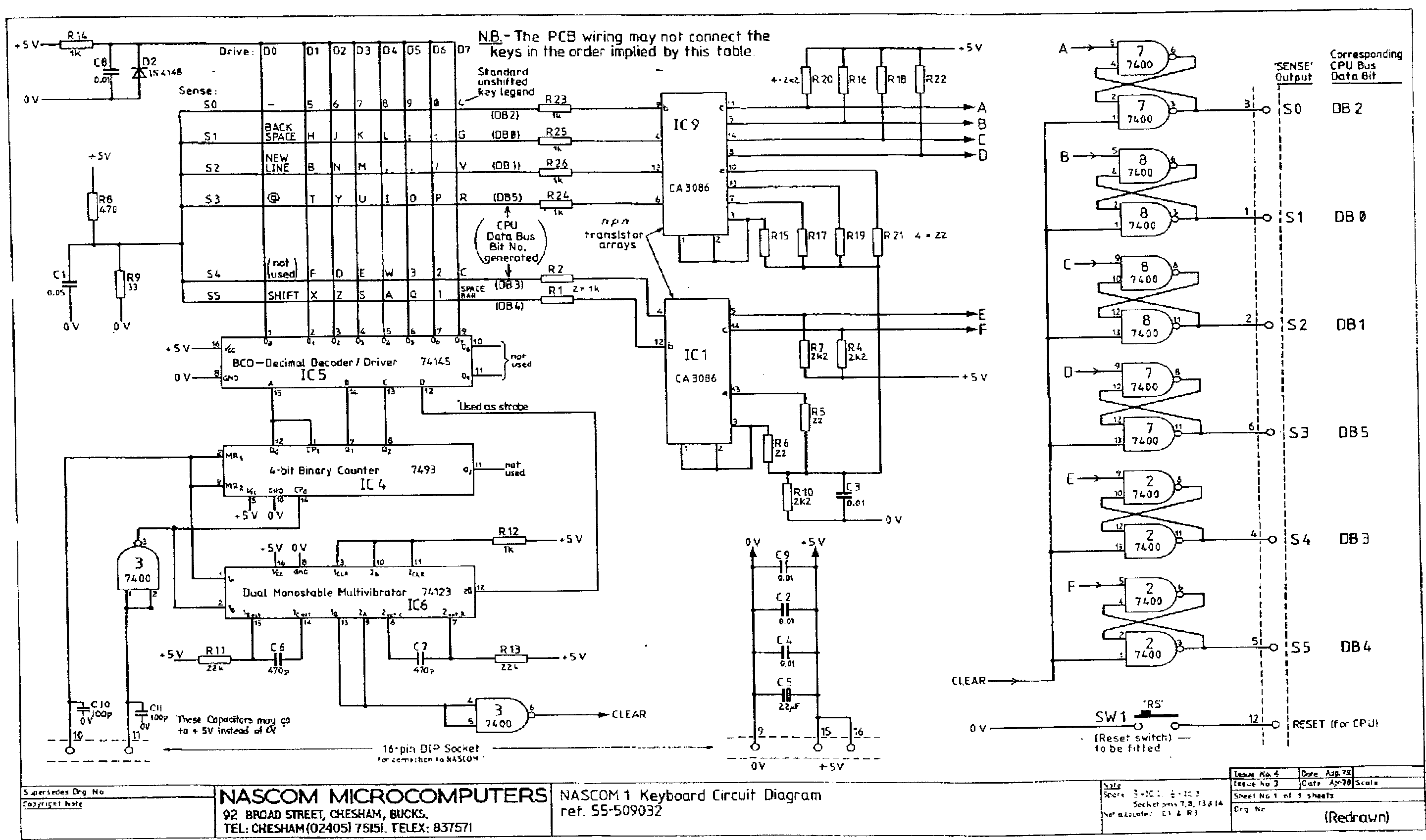

I have a circuit diagram of the Nascom keyboard which I've attached. It shows the interface between the physical keys and the parallel port the keyboard was attached to. I know there was some sort of 'scanning' routine in the monotor that sent pulses out through the port and read back states (basically a keyboard matrix). I'm sure a simple circuit could be made to to do the same, maybe using an Arduino to do the scanning and generate modern PC key codes. See attached...
- :Picture of an original keyboard (not mine).
- Nascom2Keyboard.jpg (136.82 KiB) Viewed 17127 times
- Image of circuit (as good as can be expected).
- keyboard.gif (101.3 KiB) Viewed 17127 times
