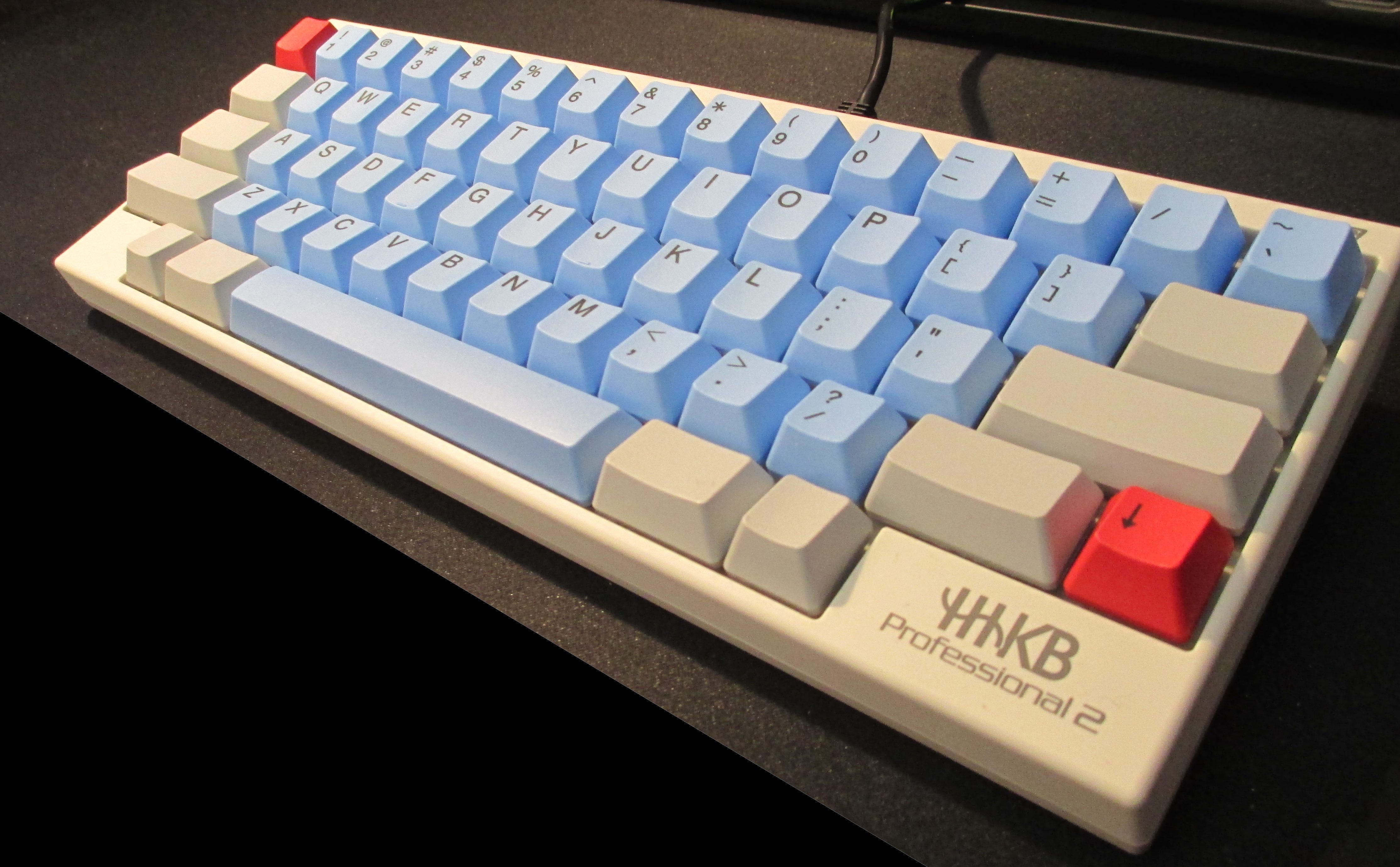

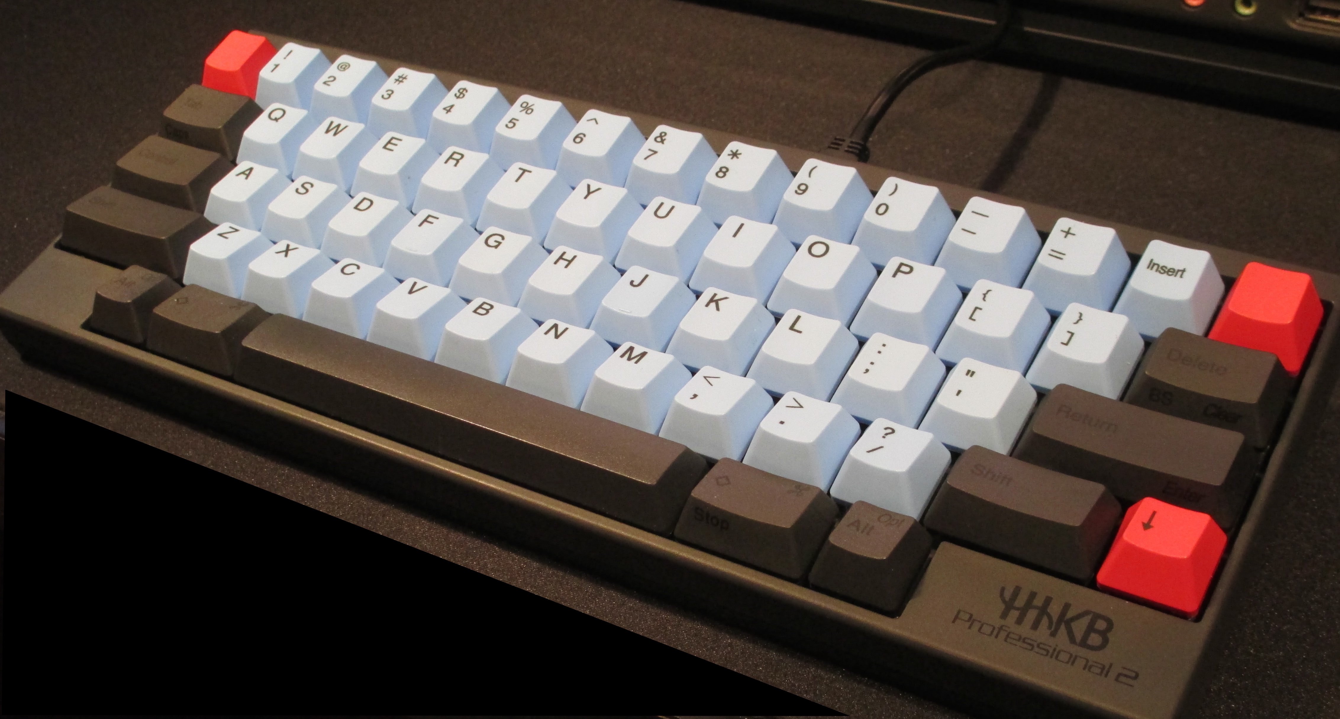

To lessen the reflectance of the Type-S somewhat, I have replaced the white alphanumeric caps with blue. I first tried black modifiers rather than the stock light gray, but these looked too stark against the white case. The legends also looked too busy, and so I replaced the mods with blanks. For a bit of extra contrast, I added a red Escape and a red arrow key for Function (Fn):
These aesthetic changes are possible because superb, albeit expensive, dye-sublimated keycaps are still available for the HHKB Pro 2. Black or white printed or blank sets can be purchased through EliteKeyboards (EK), and Topre sets in white, blue, green, yellow, orange, and red are available through eBay. EK also has Topre modifier sets, arrow keys, and Escape keys in various colors.
Eventually, I would like to transfer the Type-S sliders (with their damping rings) into a black case and swap the 45g domes with 55g domes from an RF board. If the slider and dome swaps are successful, I anticipate that the resulting black 55g version of the Type-S could become my favorite keyboard.

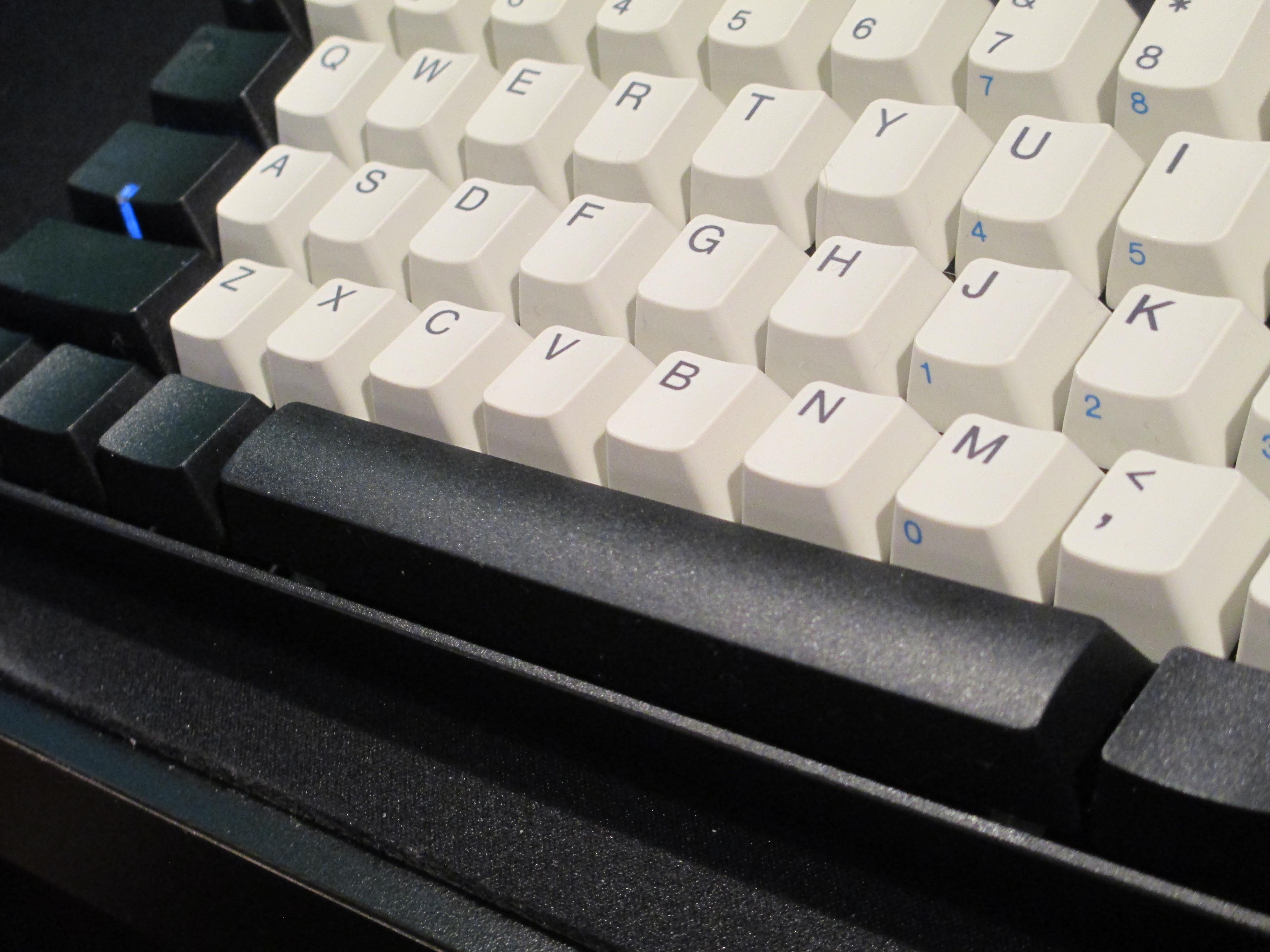

Poker II. Much of the popularity of 60% keyboards is due to the Poker II. It has a completely standard layout and Cherry mx switches, which opens up a wealth of choices for replacement keycaps. However, I have discovered that Cherry mx switches are my least favorite, and I have tried most of the sub-classes, including blue, green, red, black, brown, and clear. In addition, I like the HHKB layout so much that I use Karabiner software to remap all other keyboards to something as close to the HHKB layout as possible. Unfortunately, the Program (Pn) and Function (Fn) keys on the Poker II are hard-wired and cannot be remapped with software, and so on the Poker II, I have sacrificed the Right Control as Fn.

Great, thorough review. I absolutely dislike that the type s don't come in black as well. Isn't that their most popular color?
Just a question about the keycaps in the above photo. I love the setup btw. Is that a blue or a grey for the keycaps?

@redkeys: The keycaps on the black HHKB Pro 2 are blue alphanumerics and black modifiers plus spacebar. In addition, there is a red Escape and red arrow key for the Fn key. It is still possible to get some Topre keycaps from EK and Topre RF keycap sets from eBay.

Since posting the review of the Type-S, I have transplanted 55g domes from an RF into a black HHKB Pro 2 and swapped the sliders with their silencing rings from a Type-S into the black HHKB Pro 2. While I was inside, I lubed the stabilizers and slider rails. I also installed some self-adhesive rubber strips under the spacebar. I am typing this on my transformed black 55g Type-S; it has become my new favorite. The modded keyboard is quieter than the original Type-S and more responsive with its 55g domes.
