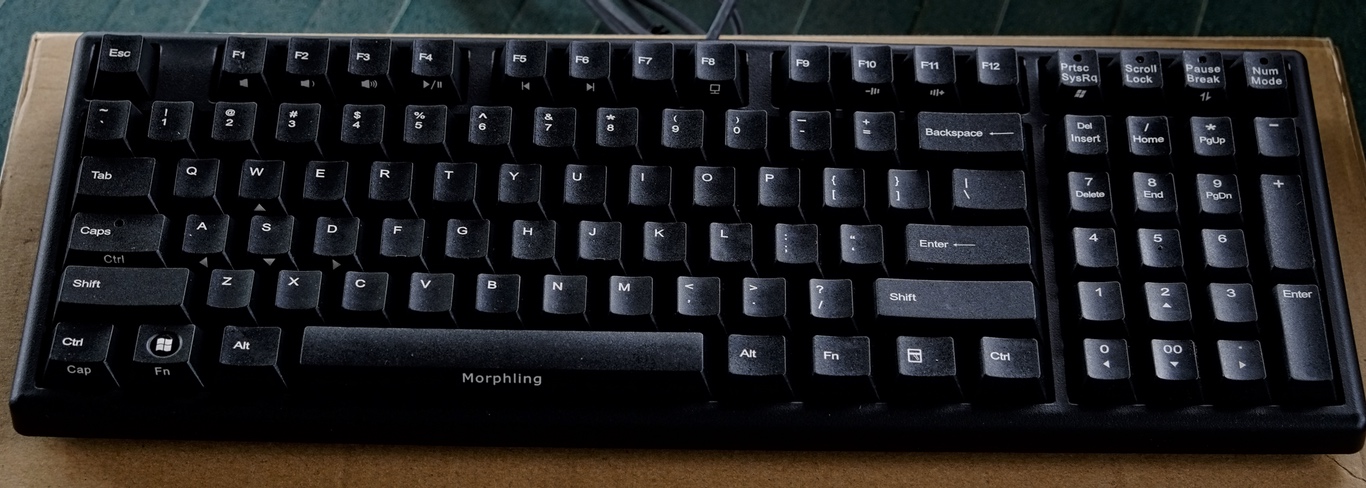

If you do lots of work in Excel or other numbers-entry-intensive programs you may consider a "TKL-size non-TKL" keyboard, like Plum MX 96 ... and I'm pretty sure there are other more easily available brands with the same features that I haven't seen. You can see bellow that when "Num Mode" (top right corner) button is pressed it enables the dedicated numpad ... anyways just an idea for people who do lots of numbers ...

zts wrote: ]If you do lots of work in Excel or other numbers-entry-intensive programs you may consider a "TKL-size non-TKL" keyboard, like Plum MX 96 ...
Or, almost but not entirely unlike the QuickFire TK, a Cherry G86-61400 or G86-62410 -- the latter currently available with Cherry MX switches here.

I know I was impressed by Tesoro Tizona separate number keypad, not so much by the numpad itself but by its flexibility in terms of attaching itself to either (left or right) side of the keyboard ... but they are more expensive.
