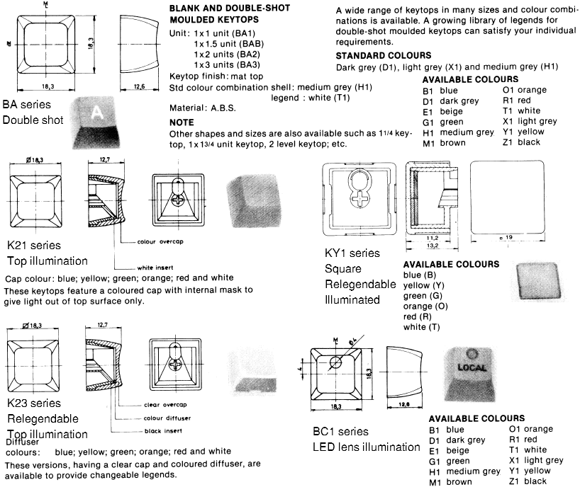

Clare-Pendar keytops
These are thought to correspond to pyrelink's TI Silent 700 terminal keyboard.
These fit the Clare-Pendar SFL Series low profile reed contact switches.
They are not thought to be Cherry MX compatible.
Datasheet: http://www.visualux.com/catalogues/kswitch.pdf
Initial interest check
Please post the part numbers and quantities you are interested in!
A quote request can then be raised to confirm MOQ and costs.
Product availability, MOQ, setup and unit costs are currently unknown.
Keytops
Two shot moulded keytops - BA series
LED lens keytops - BC series
Part number format: BAxN0N00000
Keytop type:
BA1: 1 space
BAB: 1.5 space
BA2: 2 space
BA3: 3 space
BA8: 8 space (space bar)
BC1: 1 space with LED lens
Note: Other shapes and sizes are also available such as 1¼ keytop, 1¾ keytop, 2 level keytop; etc.
Shell colour and Legend colour:
00: Blank (legend colour only)
B1: Blue
D1: Dark grey
E1: Beige
G1: Green
H1: Medium grey
M1: Brown
O1: Orange
R1: Red
T1: White
X1: Light grey
Y1: Yellow
Z1: Black
Legend:
0000: blank
0001 to 0139: see legend library
Legend Library:
Illuminated keytops
K21 series - spherical standard
K23 series - spherical relegendable - clear top with coloured diffuser
KY1 series - square relegendable - clear top with coloured diffuser
Type:
Spherical standard:
K21: 1x1 unit
K24: 1x1.5 unit
K27: 1x2 unit
Spherical relegendable:
K23: 1x1 unit
K26: 1x1.5 unit
K29: 1x2 unit
Square relegendable:
KY1: 1x1 unit
Colour:
B: Blue
Y: Yellow
G: Green
O: Orange
R: Red
T: White
This is an initial interest check

Enough to fit an 1800 style chassis would be awesome. I'm not sure why but looking at these and the switches makes me think of that or a Model F style with the F keys to the left of the main cluster. Do we have any ballpark prices for these?

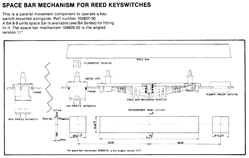

On the subject of space bars, they appear to require the special mechanism, a spacer and a plungertop.
Two versions of the mechanism are available, for the straight and angled plungers (stems):
Space bar mechanism (straight) 104607-00
Space bar mechanism (11° angled) 104609-00
Rubber spacer 102712-00
Plungertop 105104-00
I'll leave this for another day or so and will then put something together for quotation.
This is necessary to get MOQ and pricing information from the manufacturer - the distributor doesn't have the info.
The more precise you are with your items of interest, the easier this will be to do!
Nothing could possibly be binding at this stage - it's not known for sure which items are still orderable.
