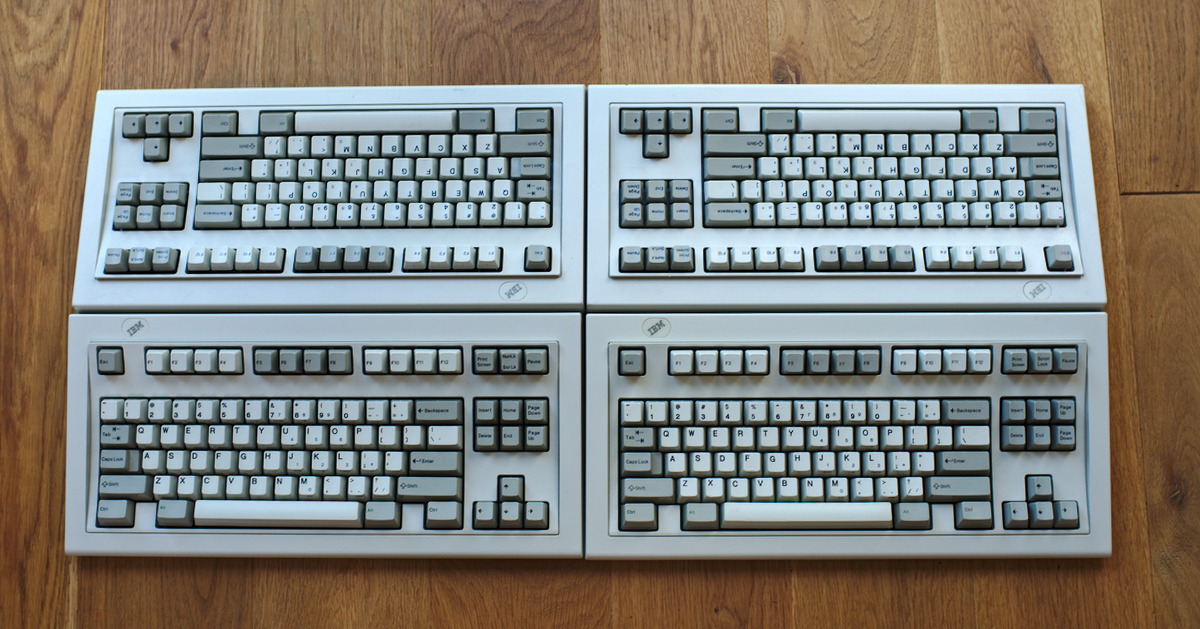

IBM M Repair centre :-) 3 x SSK

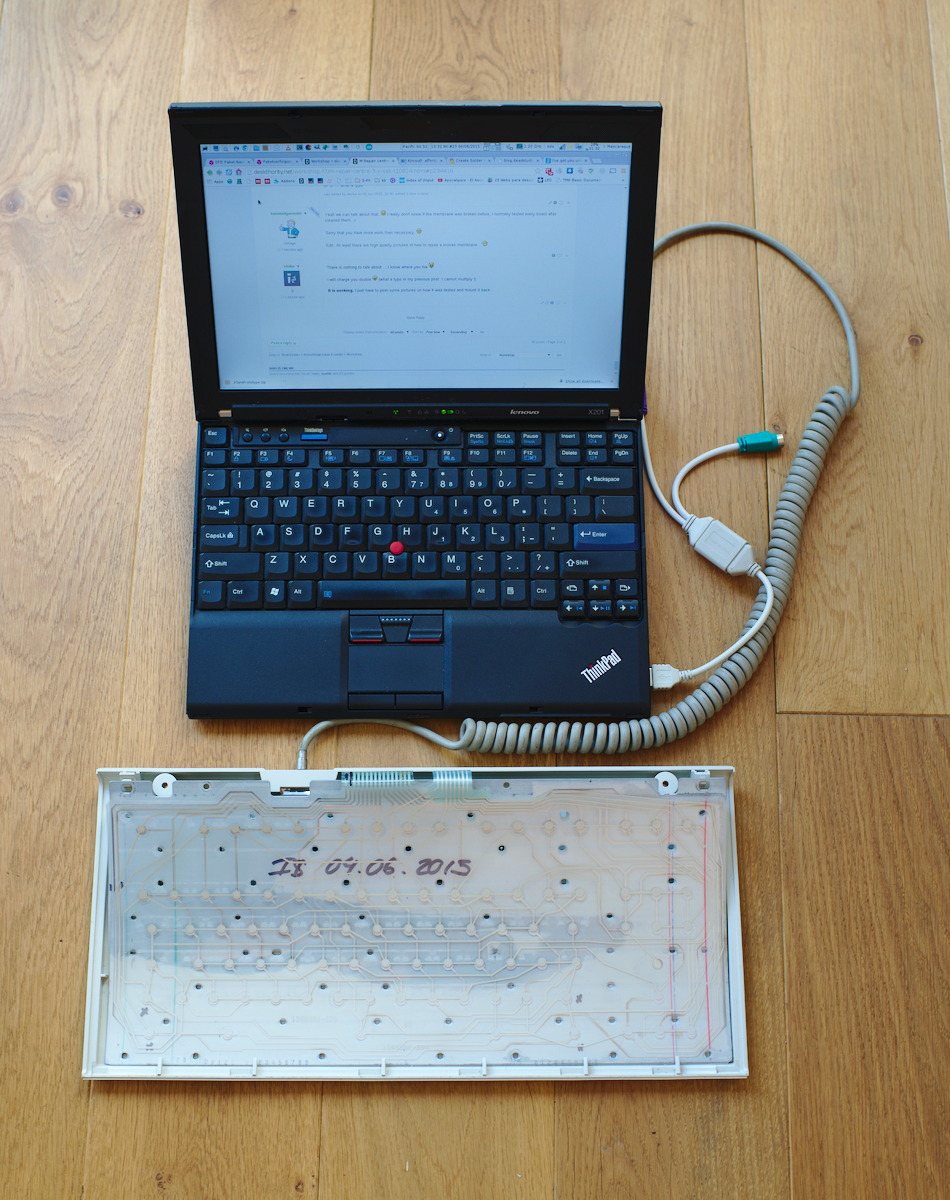

OK, this is how to test an M membrane. Pure porn !
And here the output of xev after the repair ;)
KeyPress event, serial 37, synthetic NO, window 0x5800001,
root 0x82, subw 0x0, time 47458029, (-61,-22), root:(490,311),
state 0x0, keycode 50 (keysym 0xffe1, Shift_L), same_screen YES,
XLookupString gives 0 bytes:
XmbLookupString gives 0 bytes:
XFilterEvent returns: False
KeyRelease event, serial 38, synthetic NO, window 0x5800001,
root 0x82, subw 0x0, time 47458197, (-61,-22), root:(490,311),
state 0x1, keycode 50 (keysym 0xffe1, Shift_L), same_screen YES,
KeyPress event, serial 38, synthetic NO, window 0x5800001,
root 0x82, subw 0x0, time 47459173, (-61,-22), root:(490,311),
state 0x0, keycode 37 (keysym 0xffe3, Control_L), same_screen YES,
root 0x82, subw 0x0, time 47459349, (-61,-22), root:(490,311),
state 0x4, keycode 37 (keysym 0xffe3, Control_L), same_screen YES,
root 0x82, subw 0x0, time 47461029, (-61,-22), root:(490,311),
state 0x0, keycode 105 (keysym 0xffe4, Control_R), same_screen YES,
root 0x82, subw 0x0, time 47461229, (-61,-22), root:(490,311),
state 0x4, keycode 105 (keysym 0xffe4, Control_R), same_screen YES,
root 0x82, subw 0x0, time 47461741, (-61,-22), root:(490,311),
state 0x0, keycode 62 (keysym 0xffe2, Shift_R), same_screen YES,
root 0x82, subw 0x0, time 47461981, (-61,-22), root:(490,311),
state 0x1, keycode 62 (keysym 0xffe2, Shift_R), same_screen YES,
The keys are registered. And I didn't even need to look for the tester :-)

- It is possible to screwmod repair 3 SSKs in 6 hours
- Membranes break and can be repaired
- The battery of my X201 running debian 8 last just enough to report the process (I still have 1h left !)
- i$ repair prices are cheap :-)
and ... that when three SSKs are travelling together in the same box, they may have fun and give birth to the future FSSK :D
The end !
