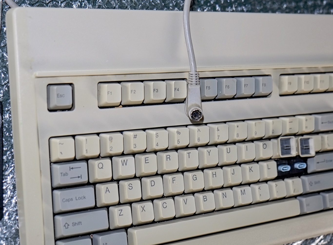

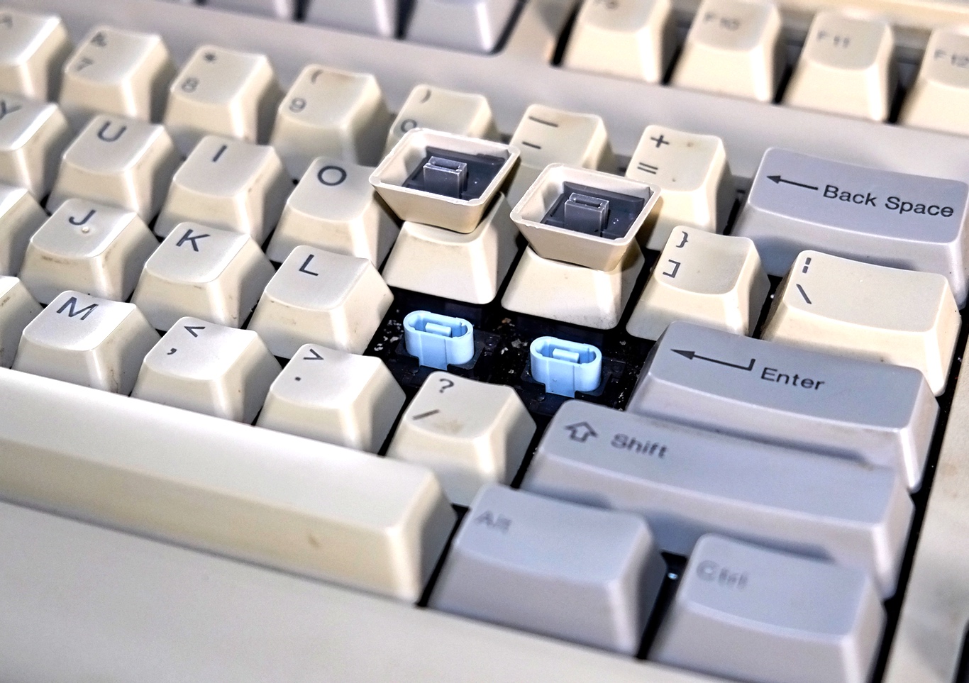

Do we know anything more about these switches? NEC proprietary? Nothing in Wiki and not much elsewhere either. Very light clicky. They feel very smooth but the actuation and click are at different points. These are from NEC APC-H412.

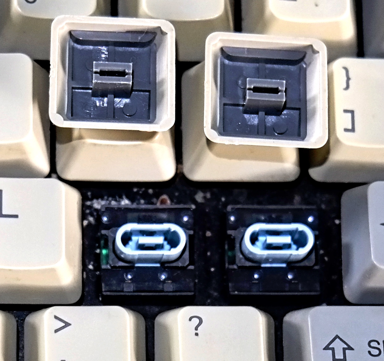

Yeah. With these it is really easy to destroy a switch with key cap removal. I'm going to tear into mine and try to develop a procedure that won't destroy switches. I think rolling them off - sort of the same idea as with Space Invaders - might work best.
The issue at hand is that the plastic plate at the top of the switch which holds everything together is extremely thin. If you pull straight up, and the key is stuck on in any way (easily true for a dirty switch), the force required to free the key cap from the blue slider will be greater than the force required to break the top plate and everything will fall apart.
Once it is disassembled, an assembly workaround would be to use something like Finish Line Extreme Fluoro between the key cap and the slider to make it easier to pull them apart in the future. IMO the best key designs depend on a latching mechanism, not friction, to stay in place. Yet another reason why buckling spring and Space Invaders are such great designs.

that's good to know XMIT. I'll be careful with mine next time. Phone pic:
[ XMIT ]
09 Jun 2015, 14:11
Yup. Those little four dots are rivets that break really easily.

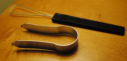

Alright, I just tried this. Here is the procedure:
1. Grab both sides of the key with a Topre style key cap puller. The key cap puller should be vertical, perpendicular to the keyboard.
2. Rotate the key cap puller to the right about the centerline of the key cap. The left edge of the key cap will rise and the right edge of the key cap will either stay in place or drop.
I successfully removed about five keys this way with no drama, no scratches and no broken switches. The key caps roll right off.
The Topre style key cap puller is the forward one in this (stolen) photo:
This should work equally well with a wire key cap puller but engaging the side of the key cap - and not just a corner - is key. I have not tried with a ring style key puller but the nubs may not provide enough engagement.
