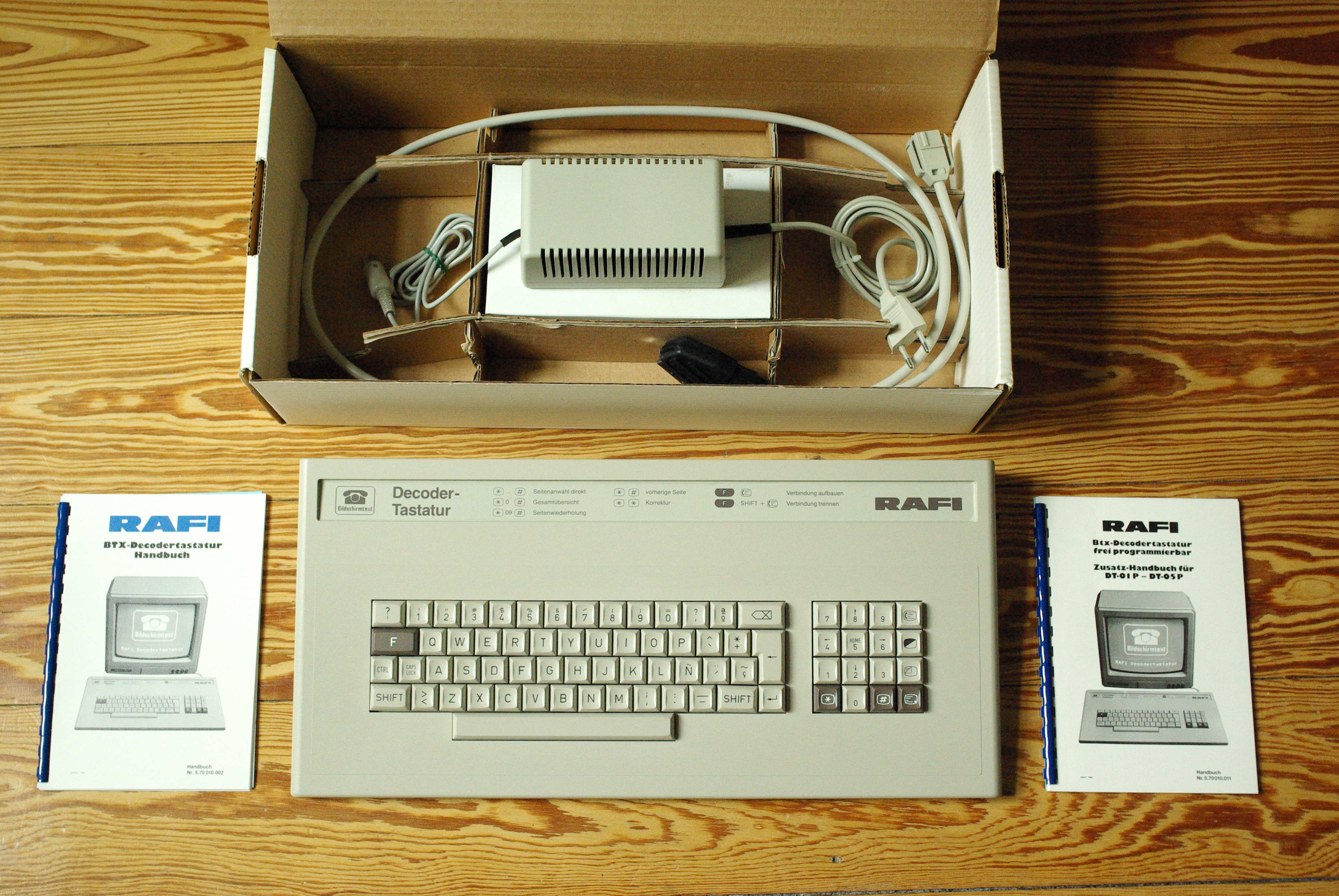

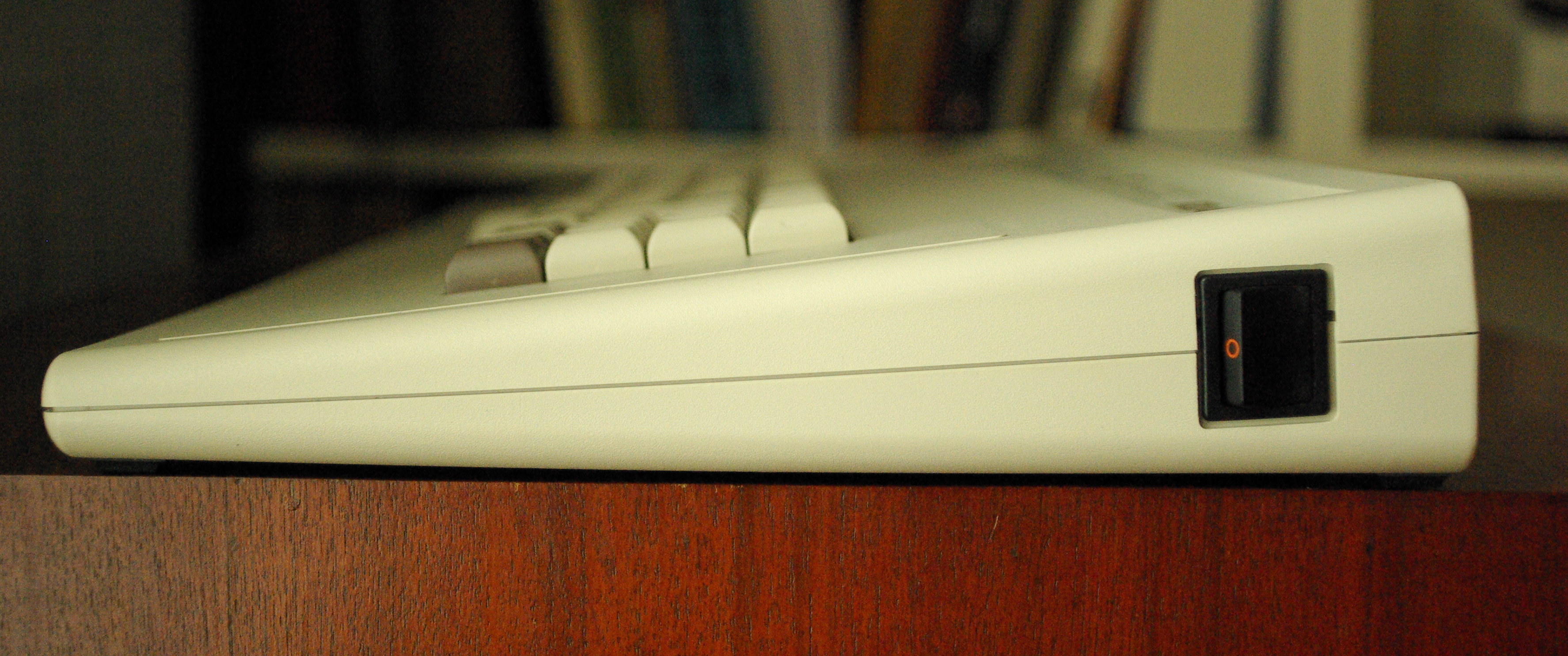

this is a BTX decoder keyboard from RAFI. If you care to read about BTX here is a link:
https://en.wikipedia.org/wiki/Bildschirmtext
I got this keyboard boxed, if it was used then little. Looks like new.
It comes with two manuals, a connector cable and a power supply.

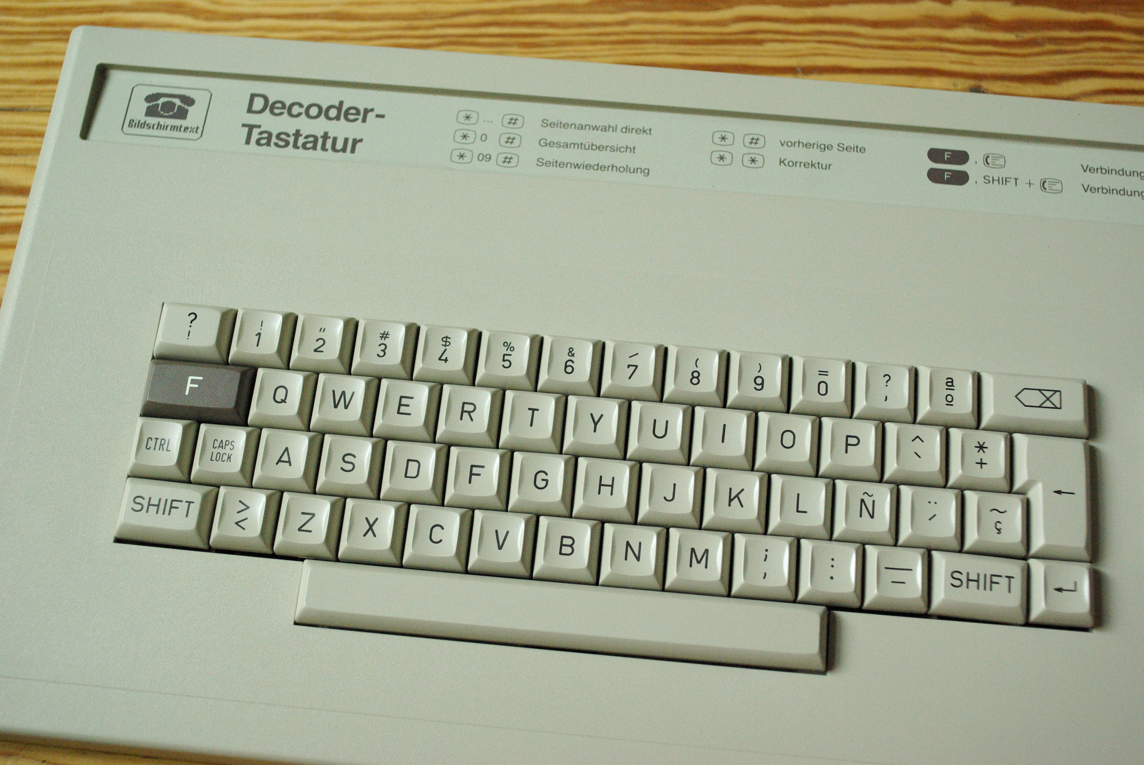

The case is very solid plastic all around. Being a BTX keyboard it has some unusual symbols on some keycaps. No yellowing anywhere.

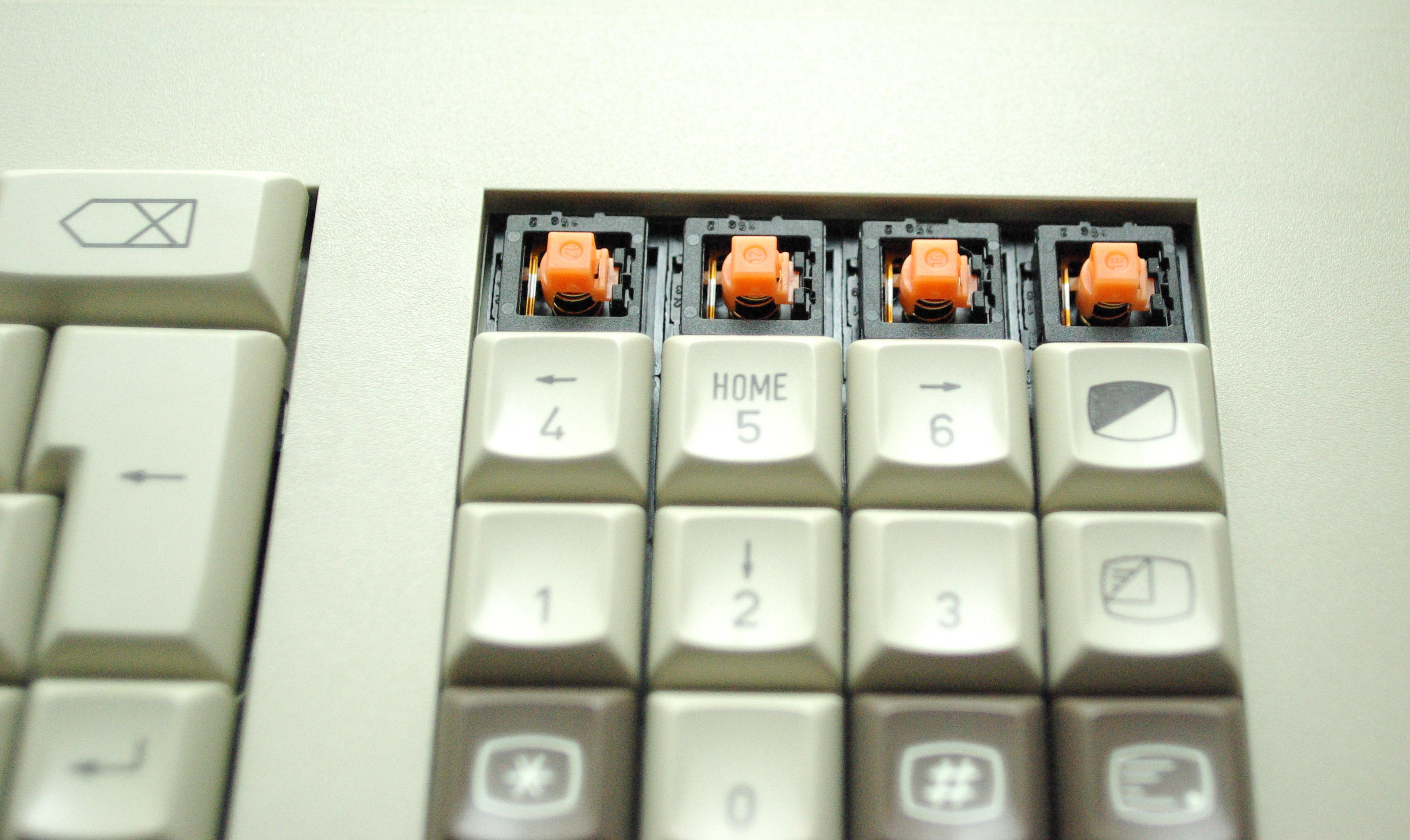

This keyboard has RAFI mechanical RS 76 M switches with orange sliders across the board except for caps lock. They feel very similair to the switches on the Compudent with the salmon sliders.
The keycaps are low profile doubleshots like on the Compudent keyboard.
Once again I fail to decrypt the RAFI codes on the PCB. But the manuals are dated 1987, so we have some indication.
Low profile.

The switches look a little bit like ITW Magnetic Valve switches, I think. Which I suspect are also Hall effect switches. Are these linear?

Isn't 76-C the hall effect one, and 76-M leaf spring?

Chyros: magnetic valve and Hall effect are different things that look somewhat similar. The former uses magnetic position to either couple or not couple two wires inductively. The latter use a Hall effect sensor that generates a voltage that is proportional to magnetic field strength. These look like Hall effect to me. Magnetic valve always has a telltale tiny ferrite bead.

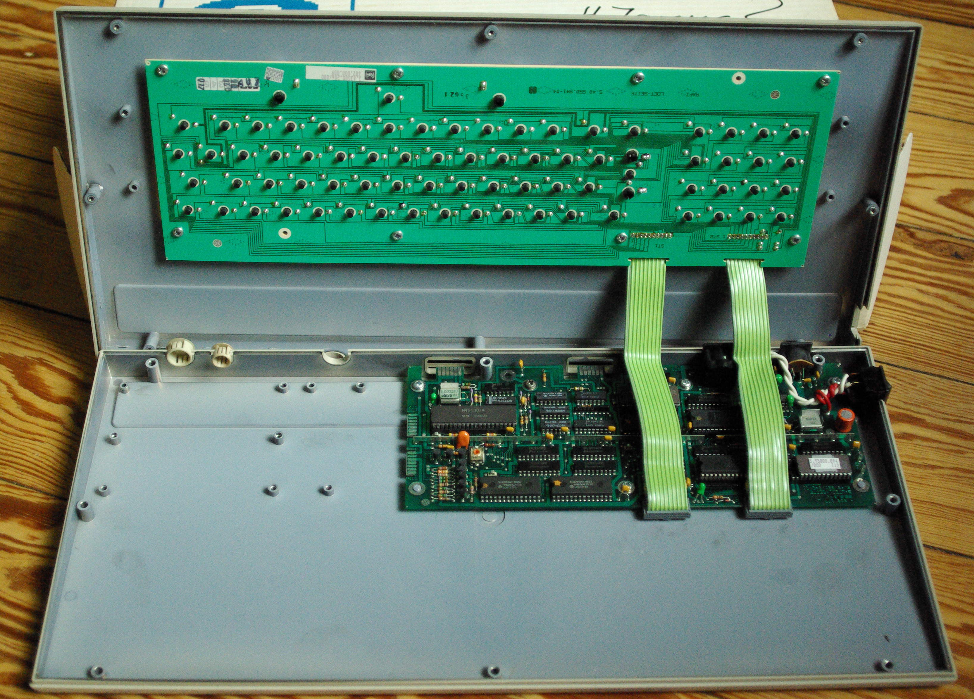

Sorry to disappoint you, but (as with the compudent board) these are mechanical keys, not hall effect ones. In photo no.5 (key caps off) you can actually see the metal leafs and the noses of the sliders, which hold them up from their counter contacts. And in photo no.7 (backside of the pcb) you can see that every key has only got two pins. Hall effect keys, however, need extra pins for the power supply.
14 Jun 2015, 10:36
No no OleVoip I want you to tell us. That's no disappointment at all. Thanks for letting me know. I corrected my post.

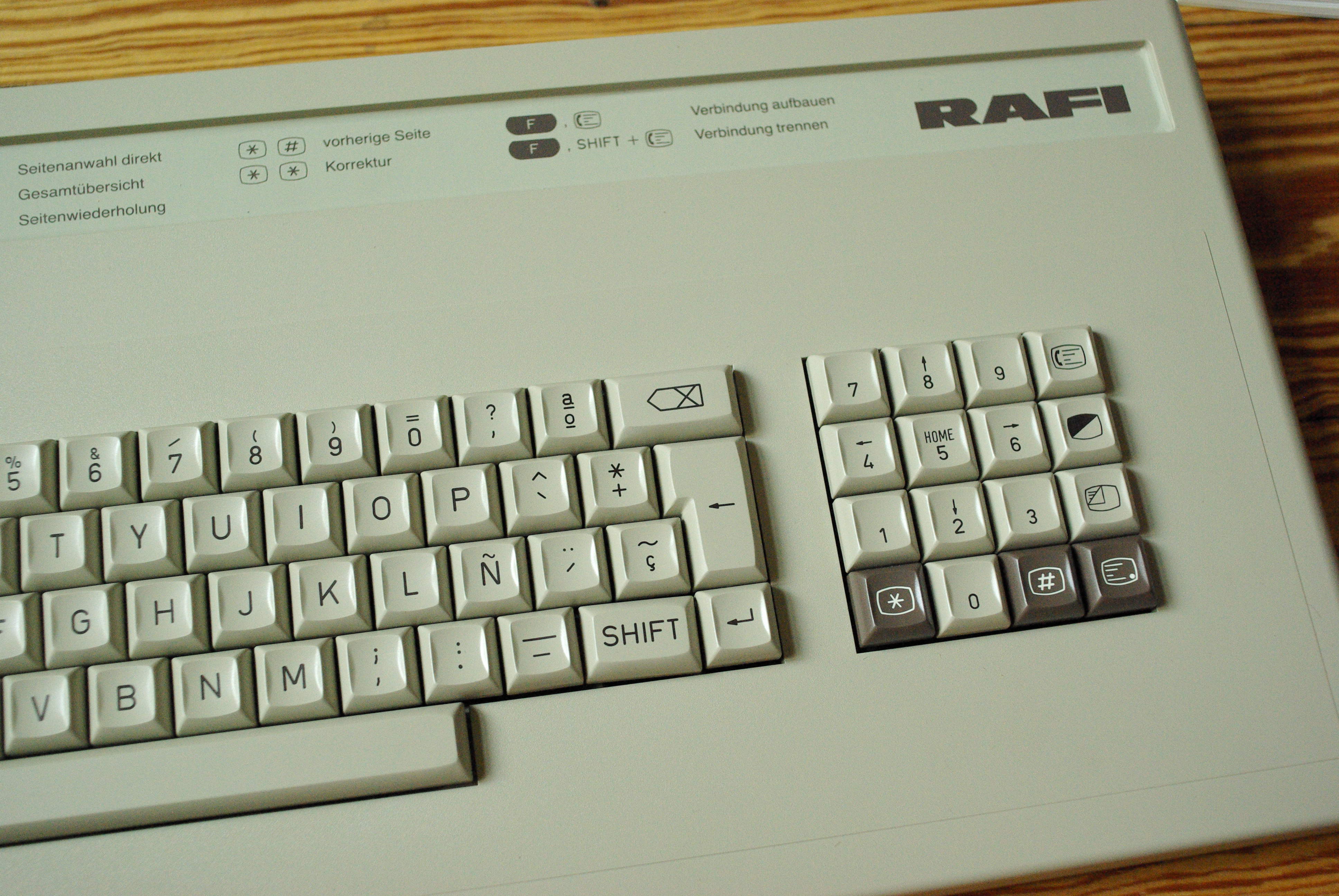

Small update; the caps lock switch has a white slider and is latching. More interesting is that while all keycaps are "scooped" the control keys are rounded. Interesting approach. Not sure if I've ever seen that. I hope you can see that in my picture.
Wait, I can't really see what you mean. I can see that most of the caps are concave but that the shift, F and ? keys are convex, is that what you mean...?
14 Jun 2015, 12:45
Yes Chyros that's what I mean. I lack your scientific terminology. :D
14 Jun 2015, 13:16
Ah, I thought you meant the Ctrl keys specifically, but they're look like the other keys, hence the confusion xD .
14 Jun 2015, 13:43
Spacebar, shift, function, return and backspace are convex. The rest are concave. Scientifically speaking. ;)
