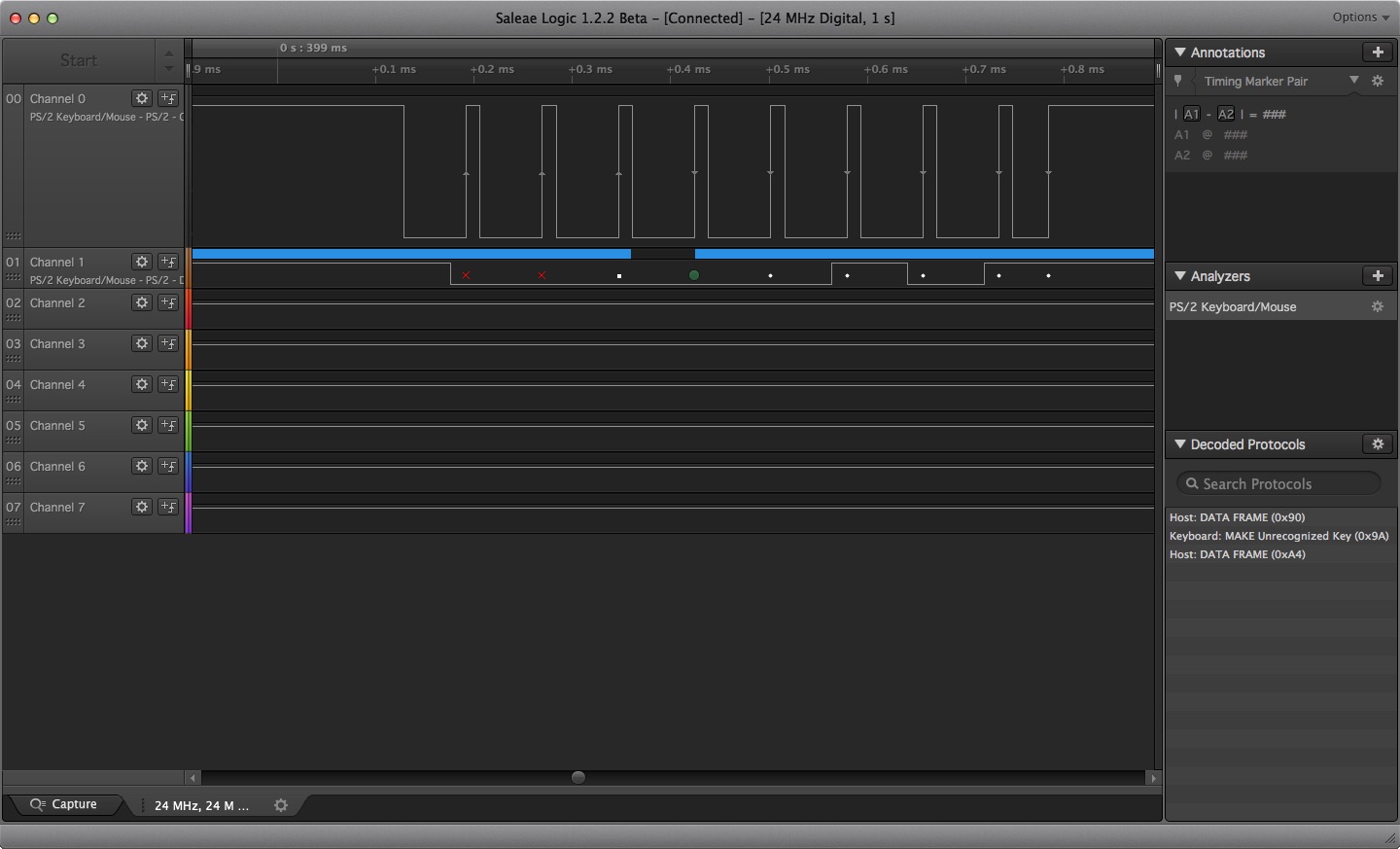

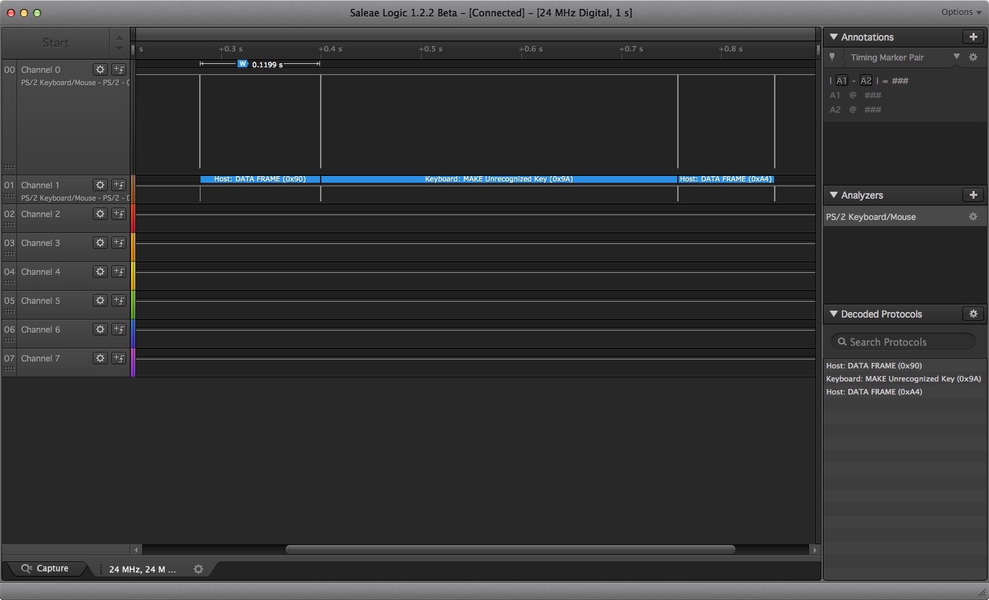

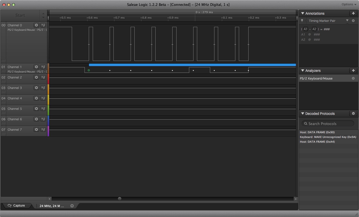

To show you what I mean I've attached screen shots from Logic, the application that connects to the Saleae logic analyzer. I typed "d t". Included are:
- key code for "d" make: 00000100
- key code for "d" break: 00000101
- overview of make and break for "d" and "t"
Pin 0 was clock and Pin 1 was data.
If this is how it's going to be I can grab the make and break codes for every key and write up a patch to TMK. Would like to know if anyone else has had success with this board without as much effort. :roll:

I tried both an orihalcon Soarer's Converter and a knockoff Pro Micro board. I saw the same results on both. Plus the logic analyzer traces above are straight off the PCB, no converter at all.
Plus those are not the scan codes I would expect at all for 'd' or 't'. For 'd', from http://www.computer-engineering.org/ps2 ... odes2.html :
MAKE 0x23
BREAK 0xF0,0x23

Are XT codes sent LSB first or MSB first? If you mirror the codes that I provided they match exactly (meaning that the keyboard works just fine). The bits that I typed in are in time order, left to right. This page suggests LSB first:
http://retired.beyondlogic.org/keyboard/keybrd.htm
This page also suggests a parity bit and a stop bit which are not evident in the diagram above. I bet that's the problem.

Yep, I see data bits only. You are reading them as I did, which I hope is correct! :-P

I built my own XT to PS/2 converter (uses an ATTiny85), so I am familiar with the XT protocol. Both XT and PS/2 send the LSB first, so the codes you are seeing are correct. The break code is just the make code with the MSB set. As facetsesame noted, the problem is with the start bit.
The XT protocol differs from PS/2 in that the data is read when the clock is high (instead of low) The keyboard pulls the clock low, sets the start bit (always 1) on the data line, followed by a high pulse on the clock line. It then sets bit 0 and pulses the clock high. This is repeated for each data bit. Finally a stop bit (more of a half bit) of sorts is sent by pulling data low and setting clock high.
TLDR; Confirming what facetsesame noted; There should be 9 high pulses. This keyboard sends only 8, so it is skipping the start bit. Furthermore, the idle state of the data line is high while XT uses low idle.
Looks like you'll need a converter that accepts XT data with or without the start bit and disregard extraneous data line state.
