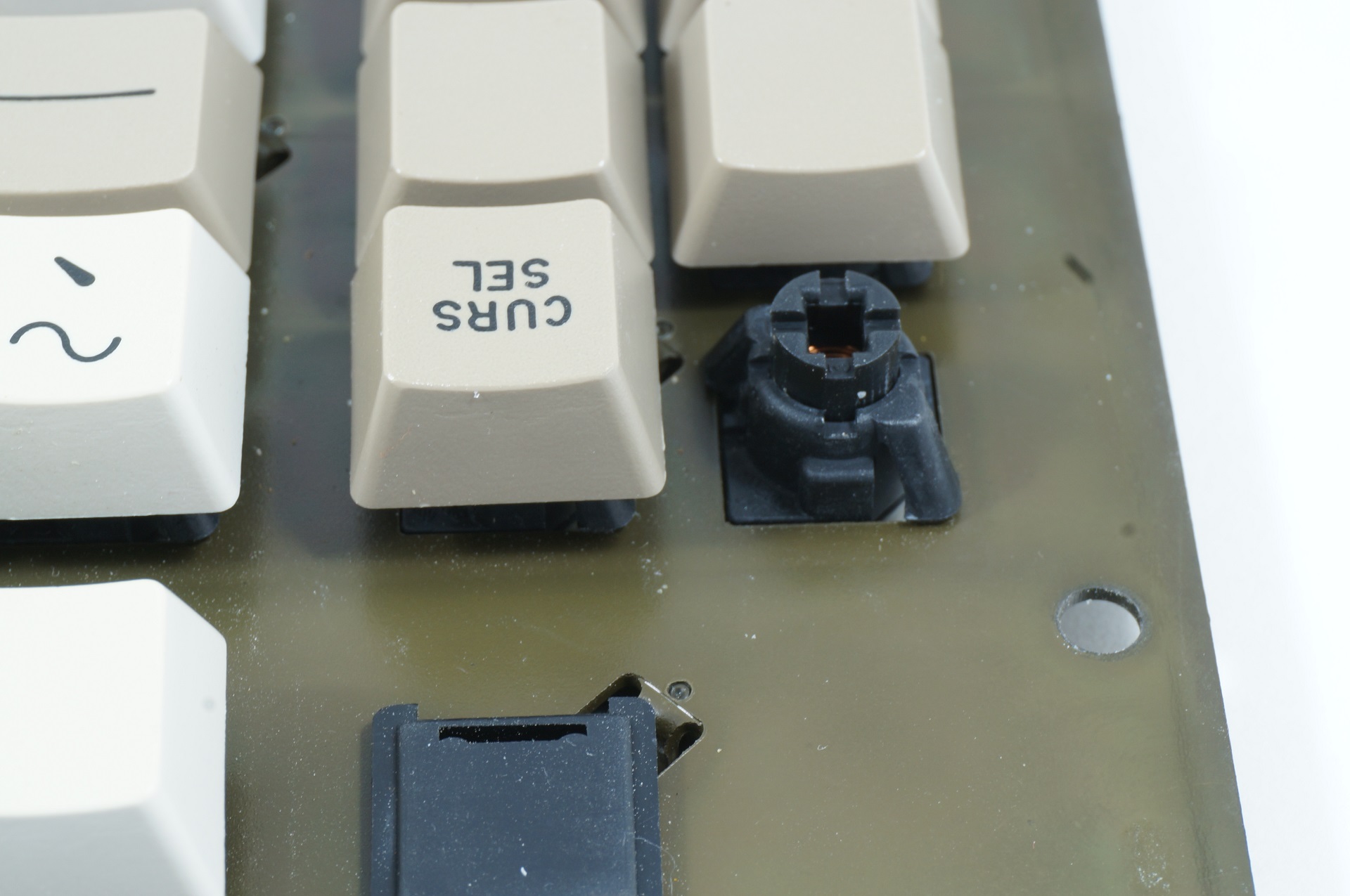

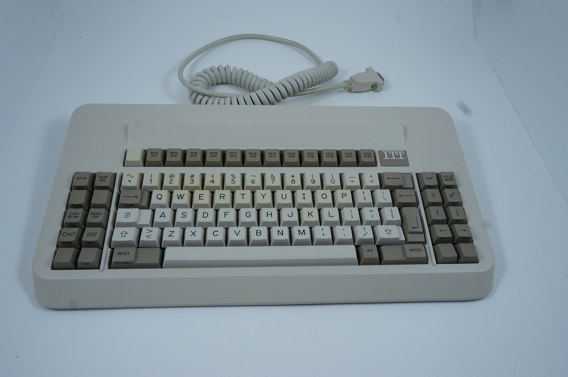

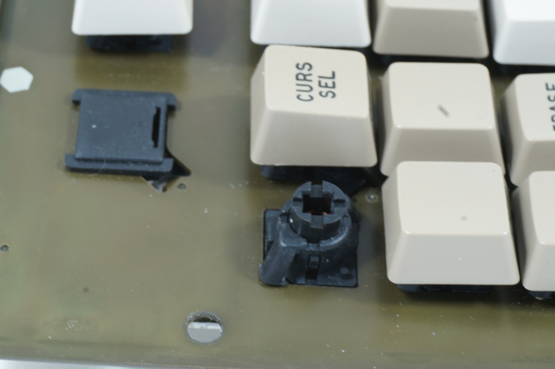

I recently picked up an ITT Courier keyboard that was used with the ITT Courier 1700 terminal, a competitor for the IBM 3178 in the early mid 80's. The keyboard is quite beefy at over 3 kg. It has cast upper and lower case halves. The switches are the interesting part. I am not familiar with them and was hoping someone could identify them. There is a Micro Switch sticker on the plate. The switches are very short and appear to sit on top of a single membrane, sandwiched between two plates. They are very tactile and make a metallic click very similar to one of those dog training clickers, giving me the impression they it may be some sort of metal dome or leaf. I hate to make this comparison, but they feel closest to buckling spring of any switches I have tried and they even sound a little similar in that they ring.
Here are the pics:

That's basically a honeywell rubber dome. Neat layout though. A bit odd that it 'clicks', I suppose :P
26 Jul 2015, 12:20
Need to see the insides. Rubber domes can be many things, but not clicky!

Interesting layout - looks like an IBM 3278 with the PF keys on top, instead of to the right.

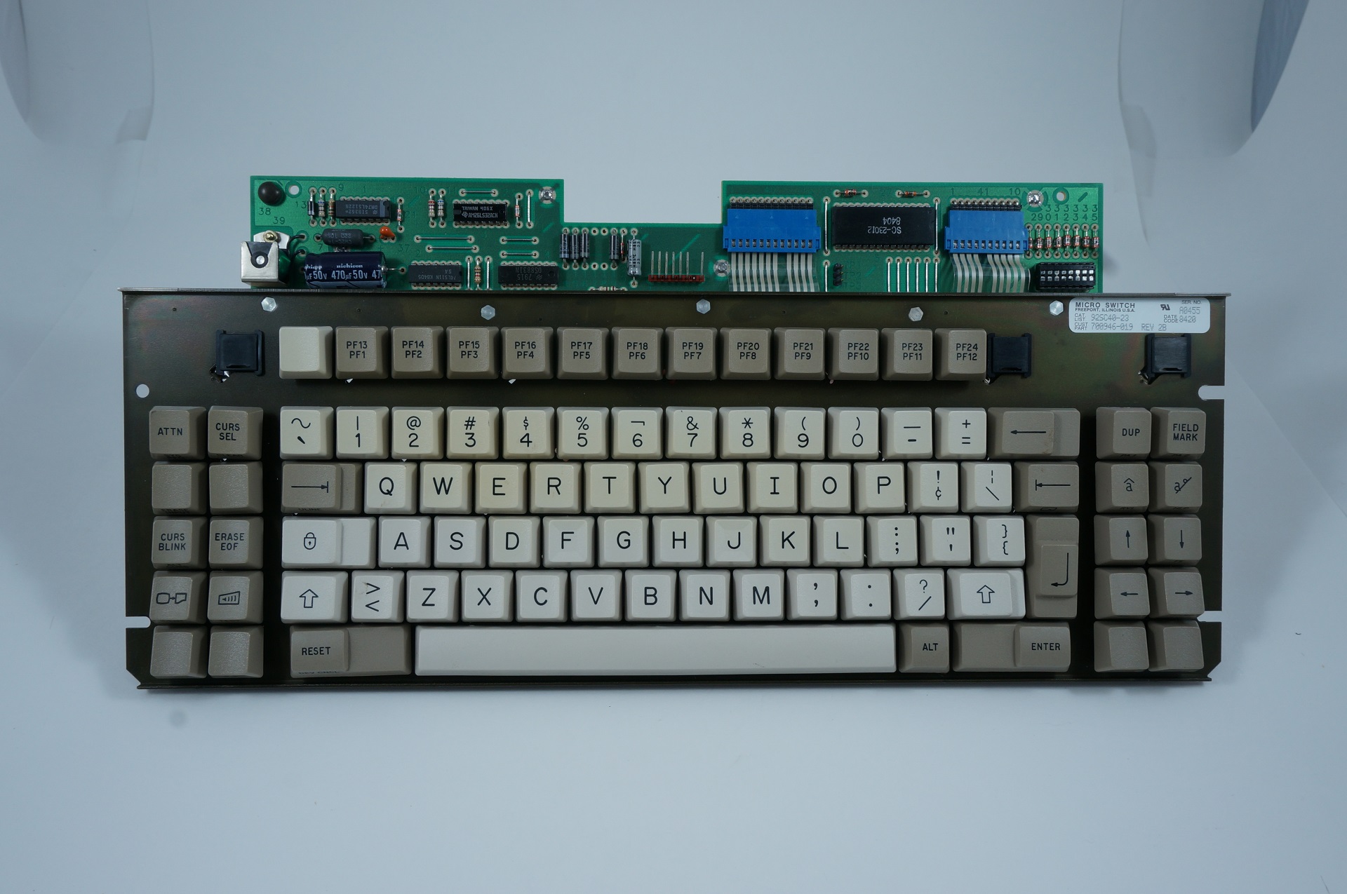

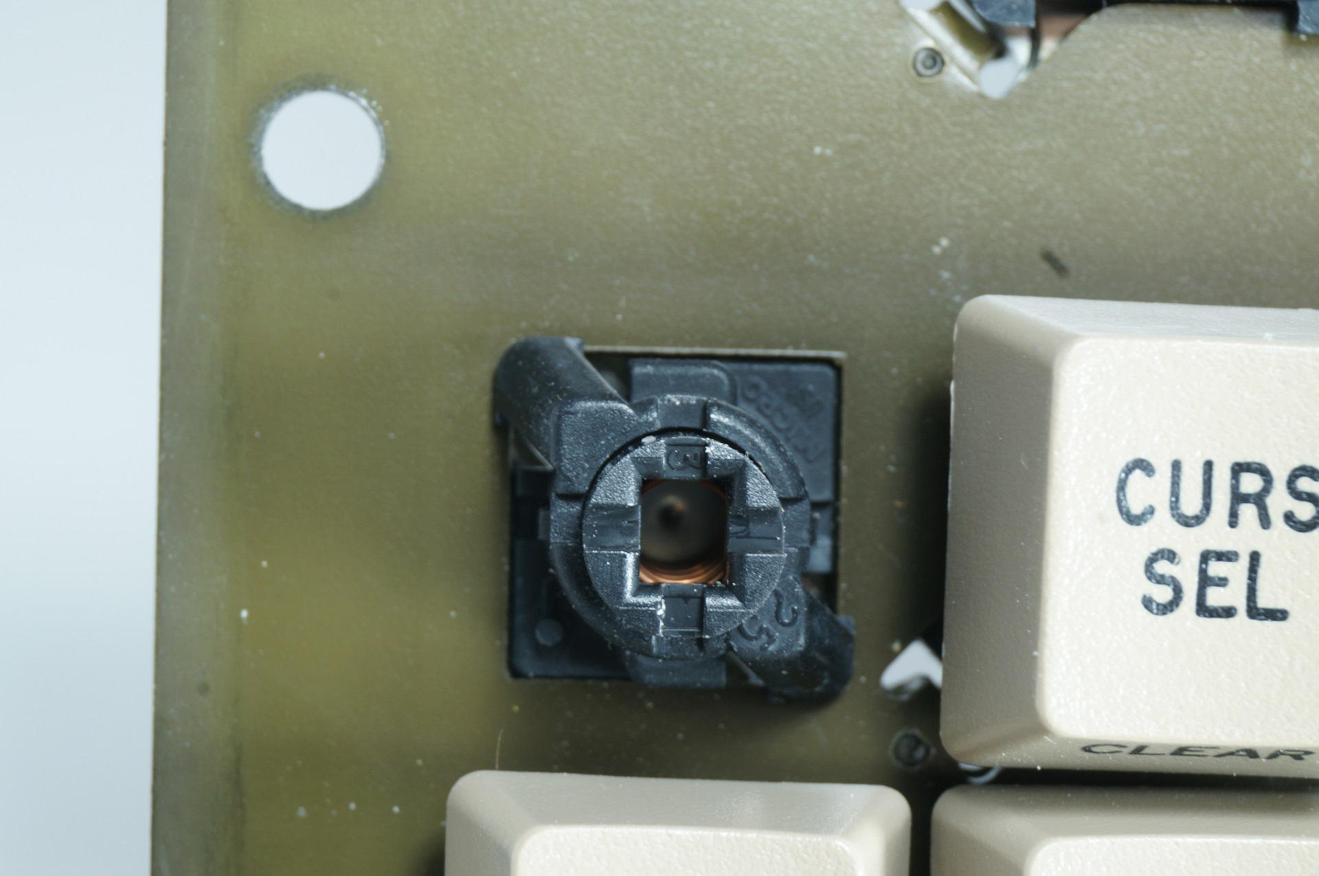

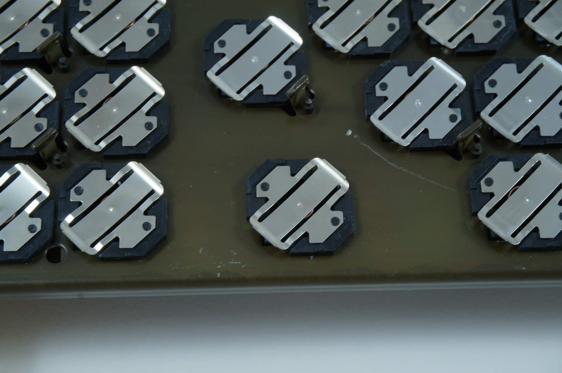

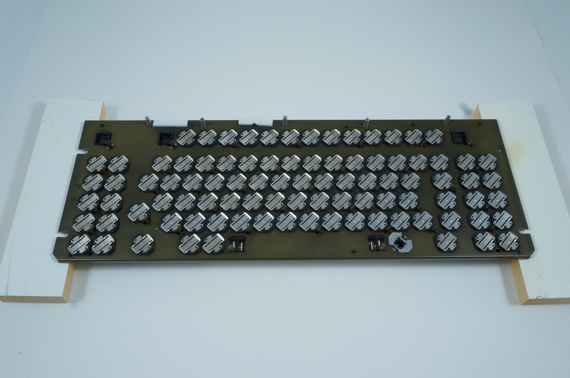

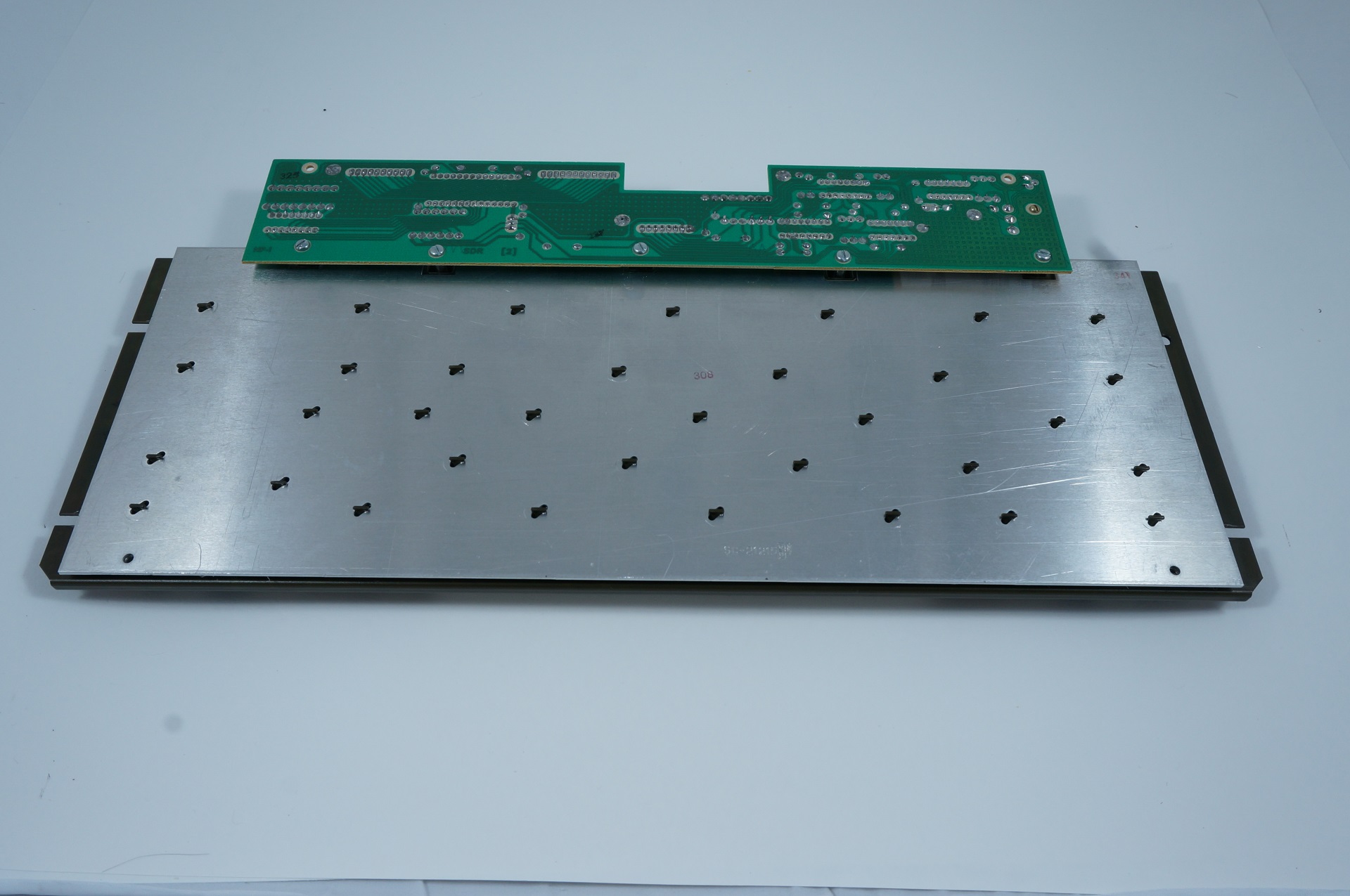

It turned out to be very easy to take apart. The tabs were very easy to bend and it appears it should go back together without great difficulty either. What did I find? Look for yourselves.
Note the small studs next to the tabs. These set the distance between the two plates, which will be helpful when I reassemble things.

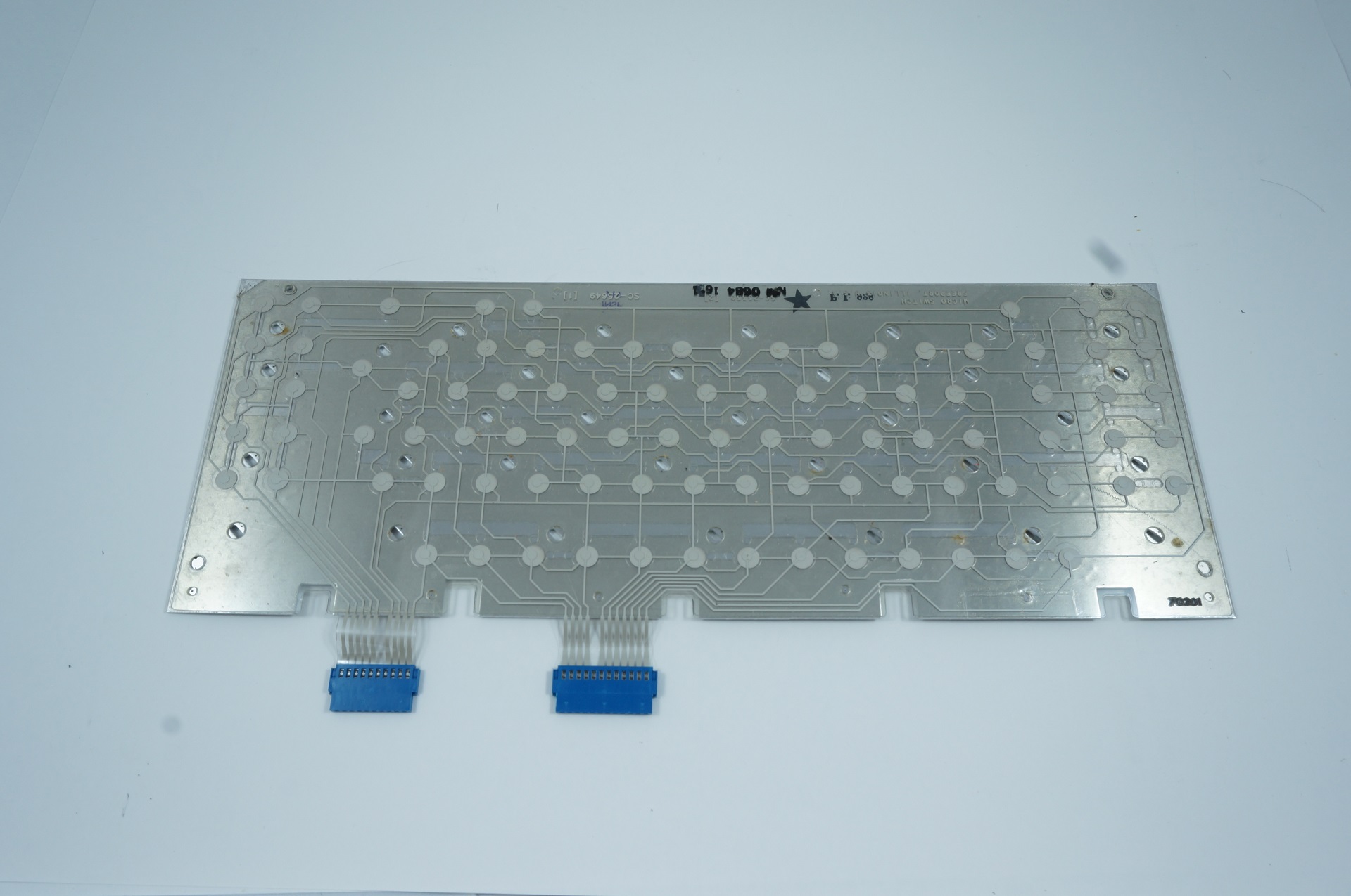

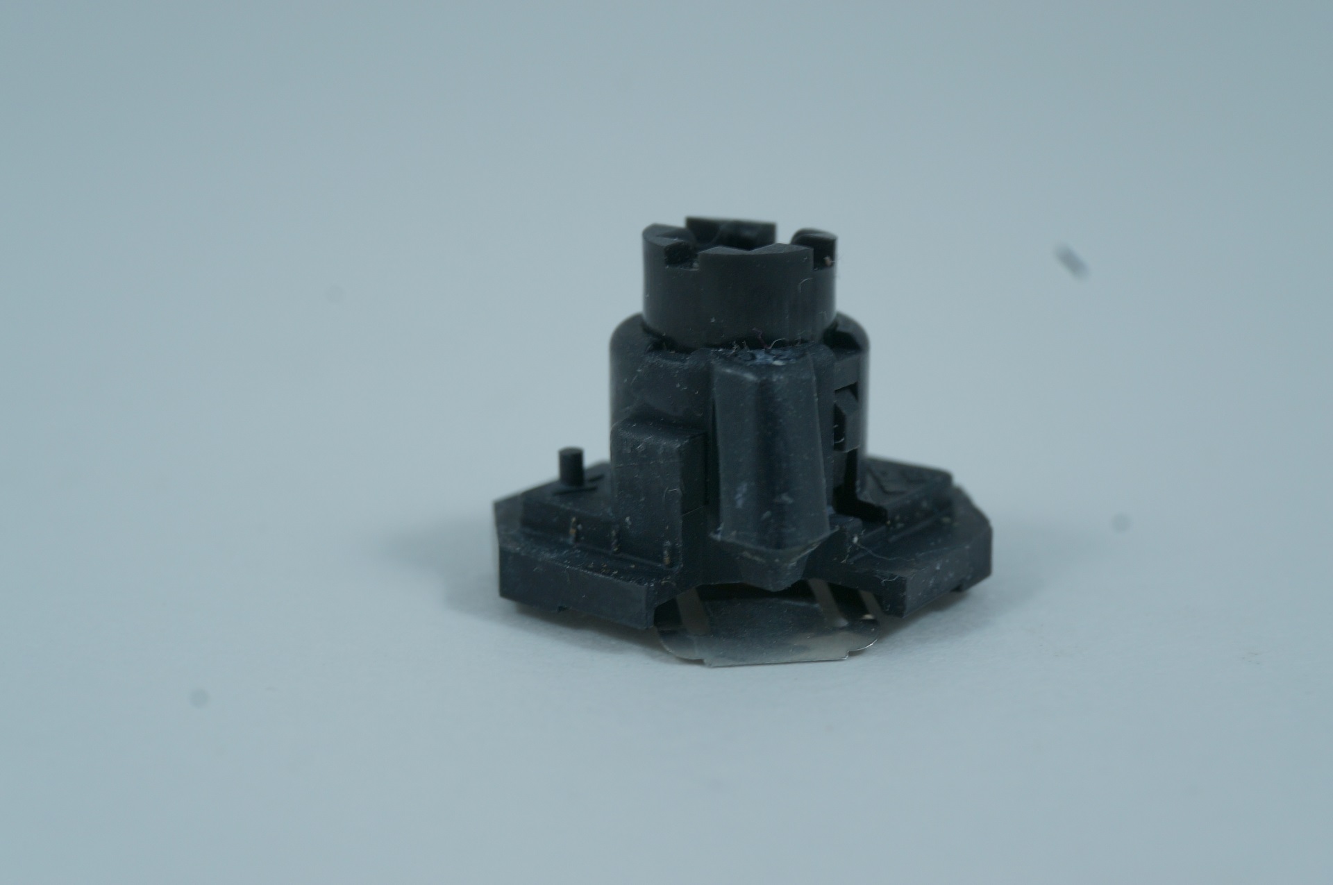

So it seems its a thin metal diaphragm spring. The diaphragm is attached to the switch housing with melted plastic rivets much like the plate on the model M, unfortunately. Above the diaphragm is coil spring (copper in appearance). When the plunger is pushed, the spring compresses a short distance before the metal diaphragm buckles, after which the plunger and spring continue to compress. Travel is limited by a plastic tab on the plunger that rides in a slot in the switch housing, which can be seen to the right of center below.
The membrane is two layers, but I was unable to easily separate them. It as if there is an adhesive holding them together and I didn't want to damage it. They membrane layers are very thick compared to those of a model M. They are thick enough that when held at one end they do not bend.

Sure thing, have at it. I will work on getting the keyboard itself added. If I might suggest classifying it as "metal diaphragm spring over membrane". I am going to disassemble one switch to get a few photos of the spring. I will add them later.

They are very similar in that both apply pressure to a spring steel "beam" until it buckles which results in a key stroke being registered. They differ in how the keystroke is registered/detected. The beam spring switch has a flyplate attached to the ends of the beam so that when the "beam" buckles and the ends turn up, it lifts the flyplate away from the pcb and changes the capacitance. This change in capacitance is detected by the controller as a key stroke. The ITT (Micro Switch) "beam" buckles and the dimple on the center section applies pressure to a pair of membranes which completes a circuit. The other slight difference is that with the ITT, the coil spring provides resistance and also acts directly on the spring steel "beam", while with the beam spring, the spring only provides resistance while a rigid plunger acts on the "beam".
