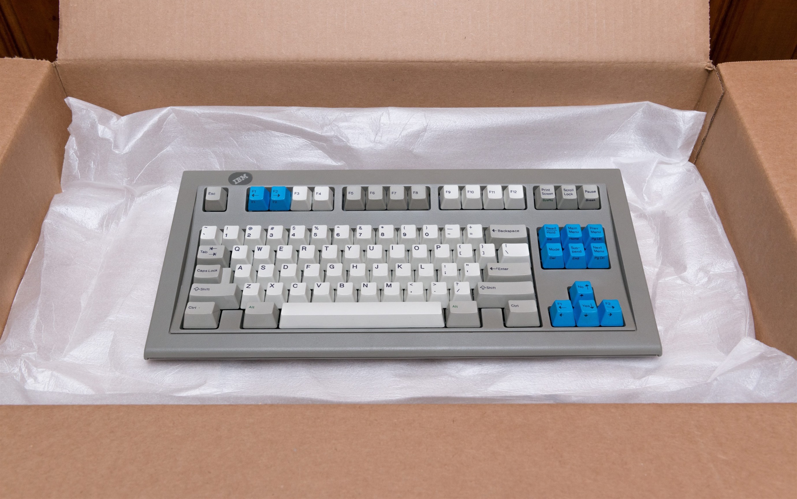

A couple of questions:
1. What are the dimensions of the cases for both F62 and F77?
2. Is the grey colour option meant to match the industrial SSK like this one? http://deskthority.net/f-o-r-s-a-l-e-f5 ... 10091.html
Ellipse
Case dimensions are around 16.5 x 7 in. for the F77 and 14 x 7 in. for the F62.
Yes the gray is intended to be approximately RAL 7030 which is similar to the bolt modded Industrial SSK I have for sale (this one is another ISSK of mine and is IMO a little more color accurate than the one in your link)

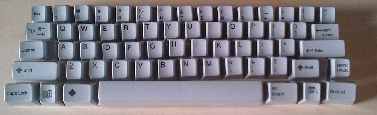

As I've said before, I really don't want an HHKB style split right shift, please. I'm only interested in the F77 at the moment. If others express enough interest, so be it, but I hope that HHKB style shift is not the only option available.
Ellipse
XMIT - regular F62 and regular F77 will be options, as well as HHKB style for both F62 and F77 - all but 17 or so of the preorders want the regular layouts instead of split right shift HHKB style.
jbondeson - for the HHKB style layout, the stepped caps lock key for the left part of the split right shift key and a regular 1 unit key for the function key (the right part of the split right shift key) is what the HHKB style crowd is asking for. If you don't want a stepped caps lock key in that place, it's my understanding you can buy a full JIS key set from Unicomp for that one non-stepped shift key, or you can just use the regular right shift key.
Allow me to repost an example HHKB style photo for reference:

I'd definitely prefer HHKB style, but I don't think the form asked me about that.

@webwit - Yeah I asked whether or not that could be an option, and if there are enough people then the price could go down for a HHKB F77. How many F77 interested people do we have including me?
@ellipse - What we can use a real right shift with the JIS set? That would be fantastic! But could be really use the normal right shift with HHKB layout? Shouldn't the barrels be in different places to even support the split shift? That would mean you have three options with HHKB style: normal, stepped split and JIS split?

Unicomp Japanese 106 key layout has the normal right shift key barrel positions, meaning a 1x on the left side and a 1.75x non stepped key on the right side. Yes, a normal right shift can replace both of those keys.hammelgammler wrote: -snip-
The F62 'HHKB' layout in my image above, has unique right shift barrel positions. A 1.75x key on the left and a 1x key on the right. A normal right shift cannot be used with this layout.

Yeah that makes sense, I would be quite confused if it was not the way.0100010 wrote: Unicomp Japanese 106 key layout has the normal right shift key barrel positions, meaning a 1x on the left side and a 1.75x non stepped key on the right side. Yes, a normal right shift can replace both of those keys.
Thanks for clarification.

Others who are going with hhkb style right shift: what are we going to do for the right shift key? Will we have to buy a complete set from unicomp for 1 key?

If such a key existed it would enable HHKB style barrel placement without requiring an HHKB style layout. This seems like it satisfies all parties. We just need such a key. It may require a new mold; I'm not sure.

"HHKB" style will never be possible starting from a "standard" right shift. The right side of a "standard" right shift has the pivot plate centered at the left edge of where you would want to put the Function key. A "Standard" style top plate and PCB can use either a standard 2.75x right shift cap OR a 1x cap + a 1.75x cap. A "HHKB" style top plate and PCB can only use a 1.75x cap + 1x cap (OK - you could use any smaller cap in place of the 1.75x cap, but there will be a gap on at least one side).
Unicomp made a stepped 1.75x cap with "Shift" on it for me once but the last time i asked for one, i had to settle for a blank.

Seems like it's good that i love blank keycaps. Would you say there are any differences between a "blank" original IBM cap and a Unicomp black one? Or is it just the font/lettering that's different?
But i think there is no non-stepped 1.75 key in blank right?... Man that would be so perfect to have that. But stepped would not be a real problem either, as my right shift usage goes against zero.
Btw, i would really love to own a F77 HHKB layout, how much people do we have for it?
I would say a number of 4 people should be sufficient for it? $25 more for HHKB layout would be worth it for me.
The FN key could come very handy to access the F keys on the number row.

FWIW, my solution to this issue on smaller keyboards is to use a small left shift, and put a Fn key between LShift and Z. Or, really, I use the key on the lower right corner of the main section of the keyboard (under RShift) as a Fn key.

Well yeah that would be my backup plan, and i would see no issue with that on the F77, but nevertheless i would like to have a F77 HHKB.
IMHO it's just nicer to have a smaller right shift, who presses the right shift further then 1.75 keys wide? 1.75 should be more then sufficient to press it, at least for me when i use it.
A huge advantage for me would be, that it doesn't need a stabilizer insert with the 1.75 key, which gives the key a MUCH better key feeling. In addition to that you would have another key left for whatever reason.
