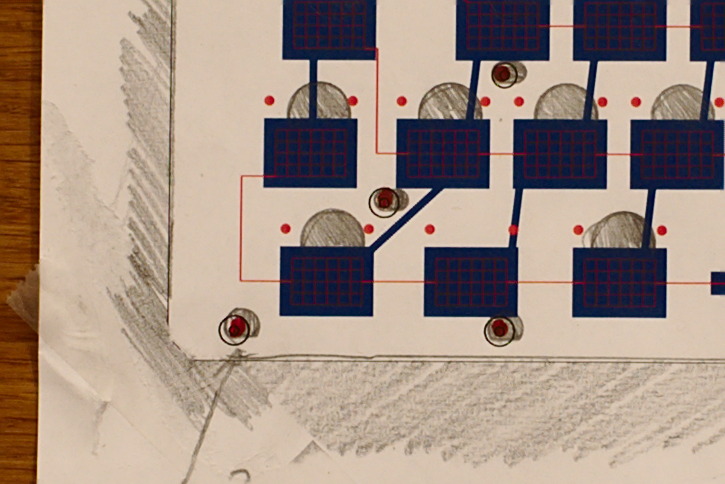

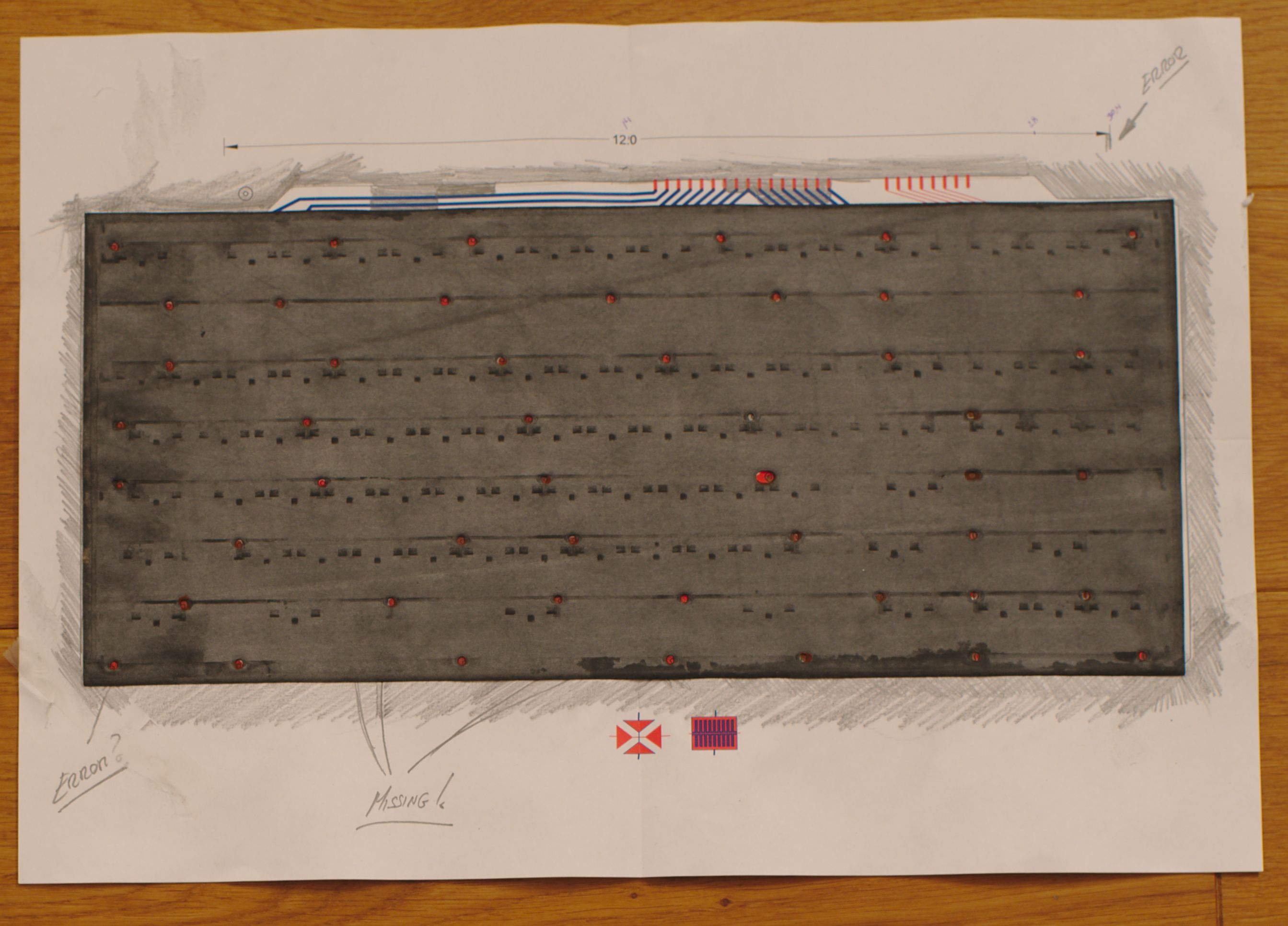

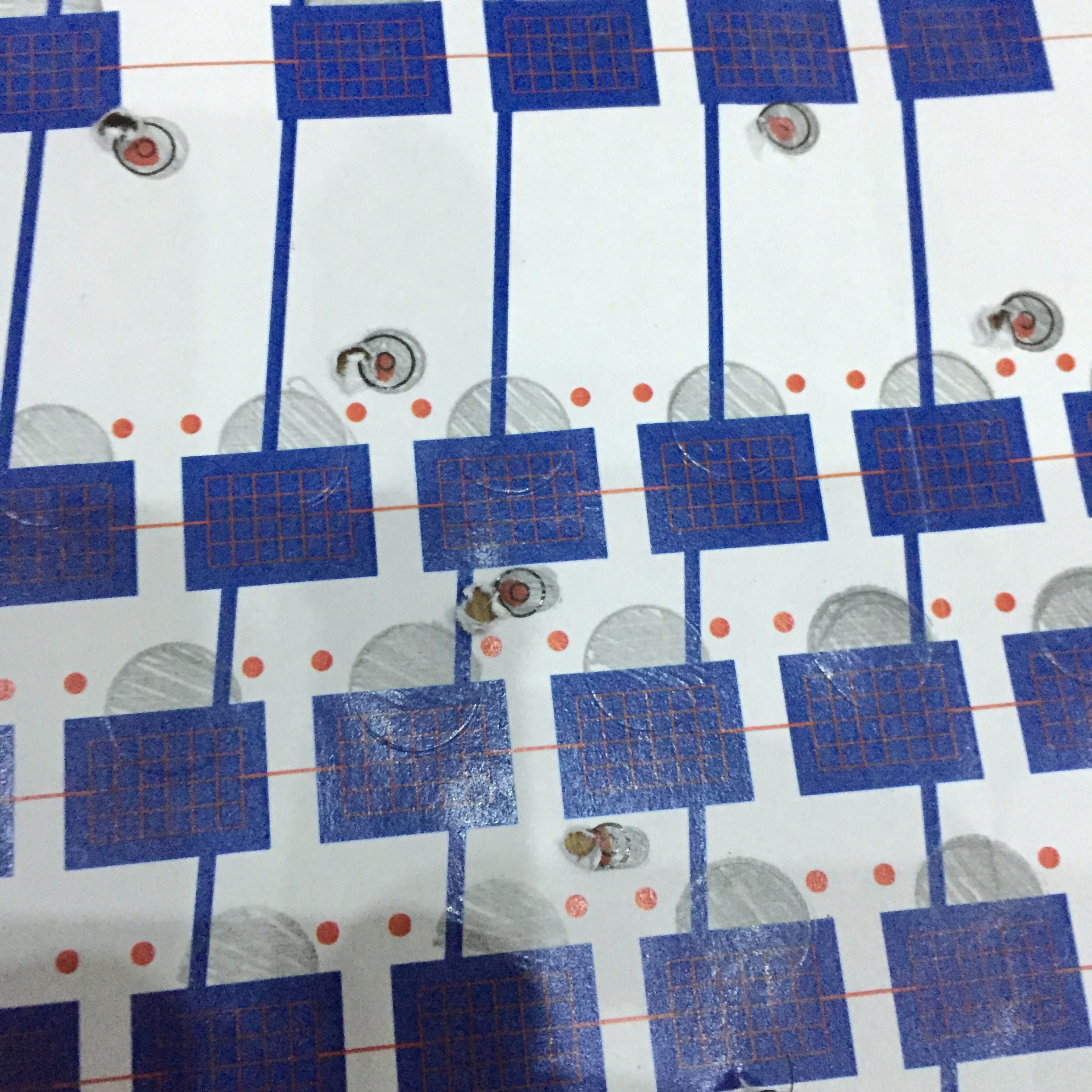

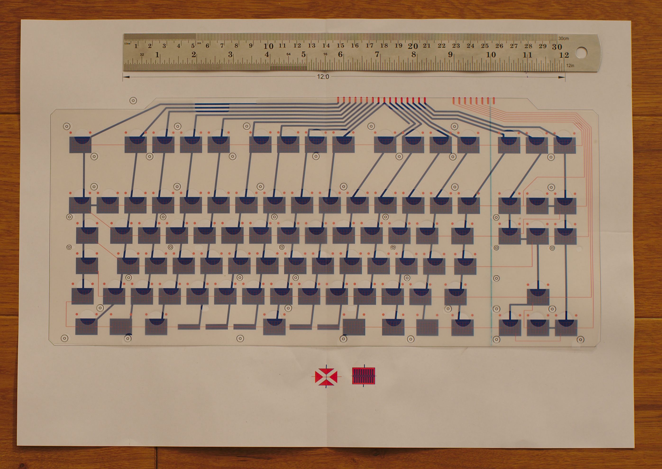

My conclusions are:
1.- Some missing holes
2.- Some error in the printing. Small
3.- Some errors in the position of the holes. The error is bigger than the printing error.
I guess that I need to learn how to create the PCB file, if not, the process will take ages.
My problem again is that I am very busy at present.

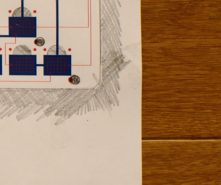

Regarding the errors comparison:
in this picture, if the border of the plastic is compared with the position of the hole, one can see that the displacement errors do not match
On the other hand, the hole error (red) is matching the printing error ... I cannot conclude if it is correct or not.

I also conclude that for the prototypes, it is not recommendable to order the PCBs with the holes done.
One can always drill them with enough precision.
This will remove a potential failure mode. I many PCBs are required after the initial prototypes (I do not think that this will be the case) they could be added later.

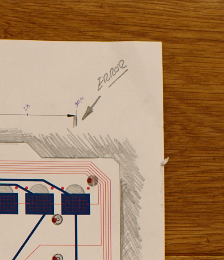

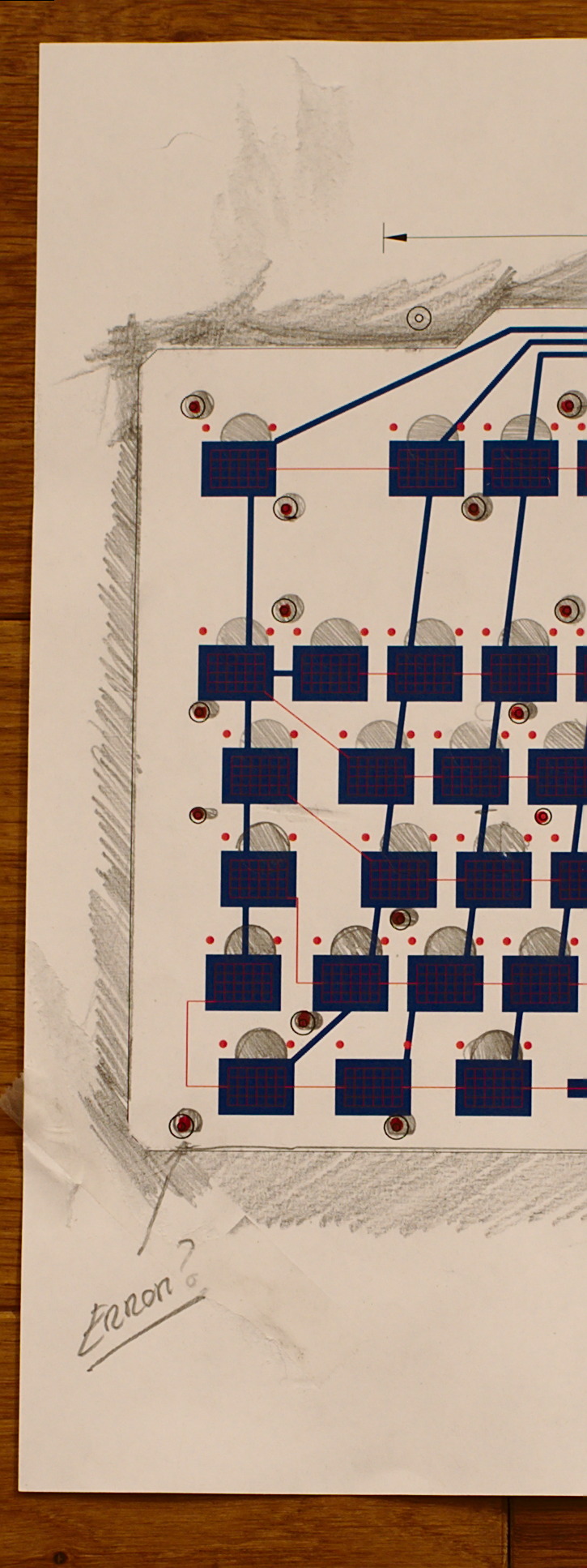

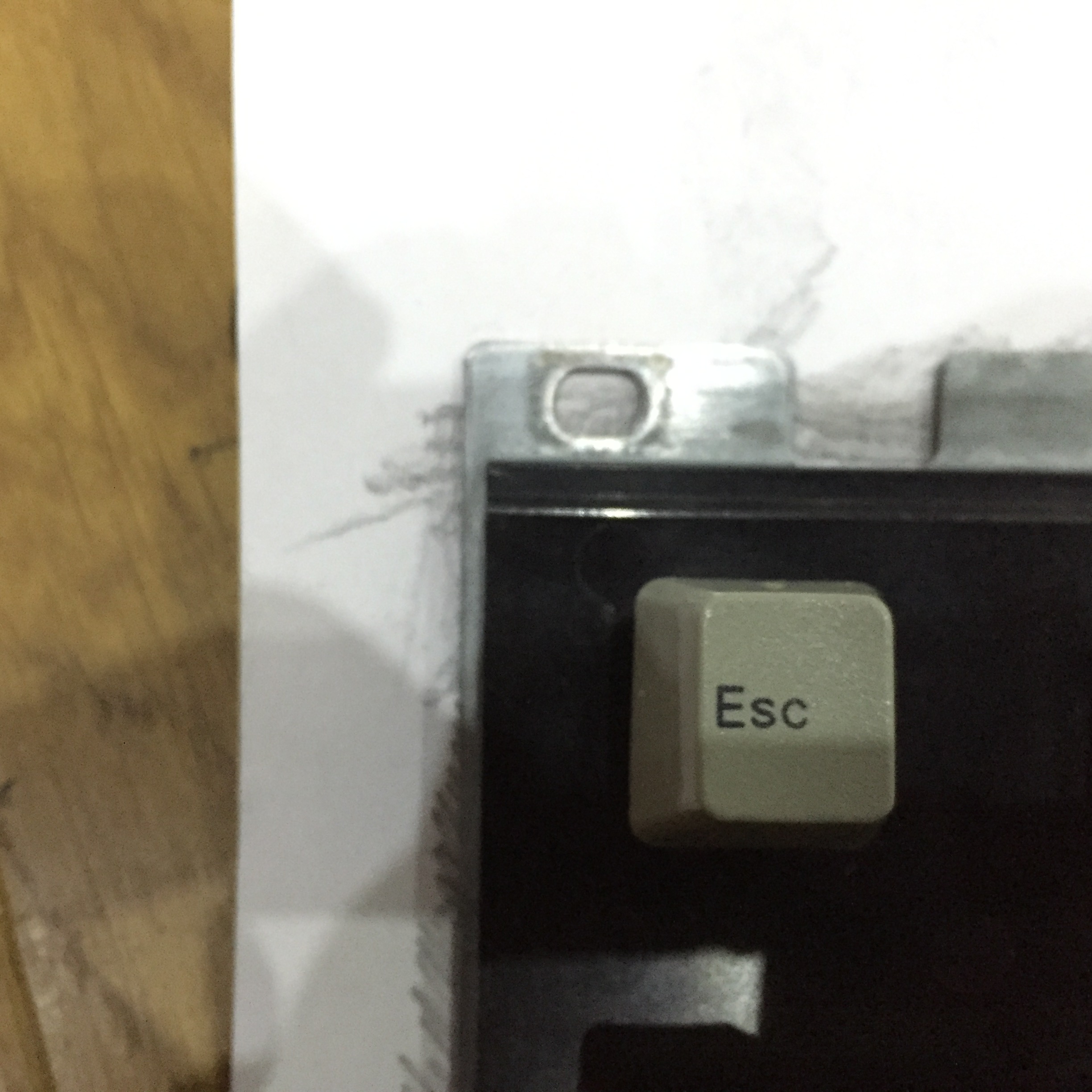

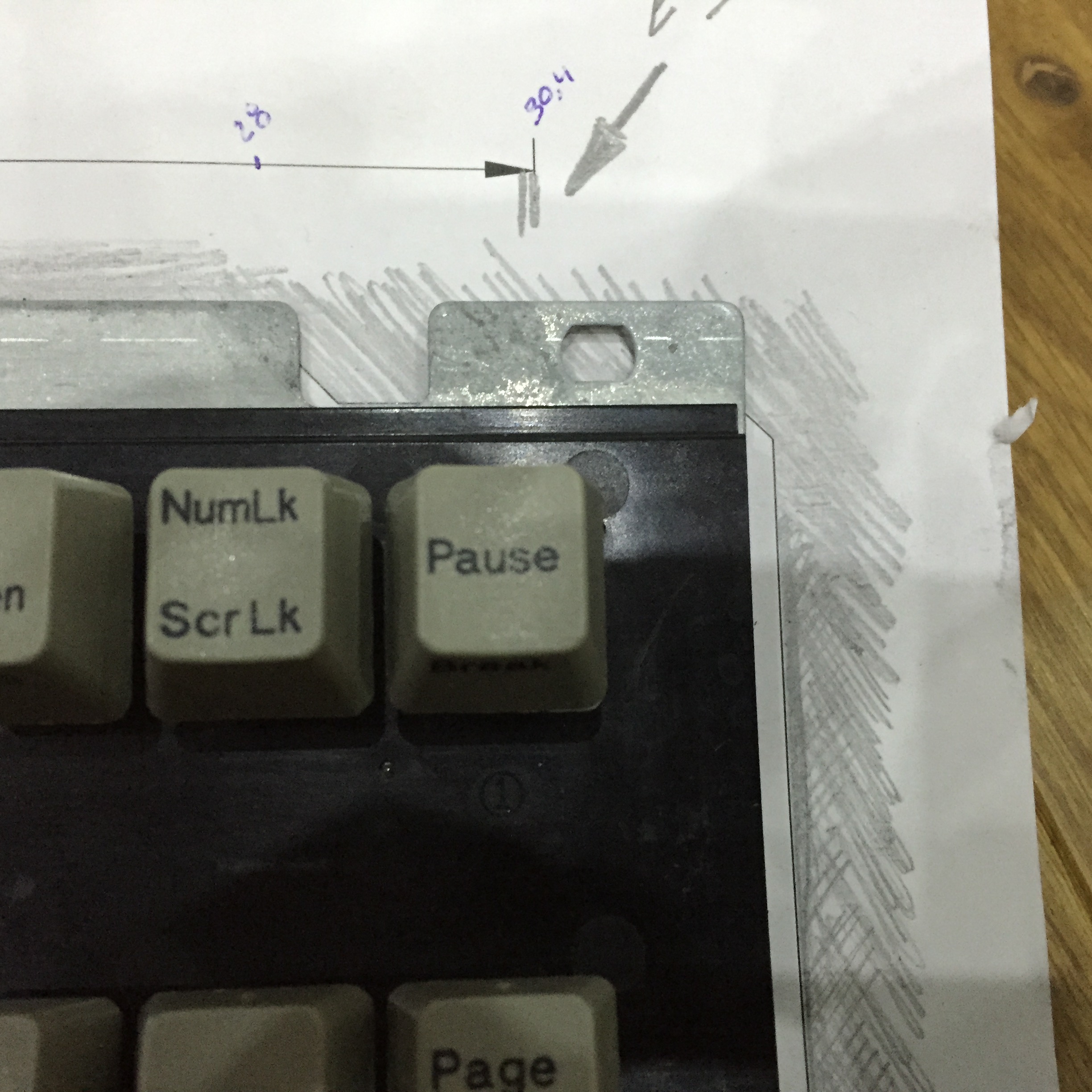

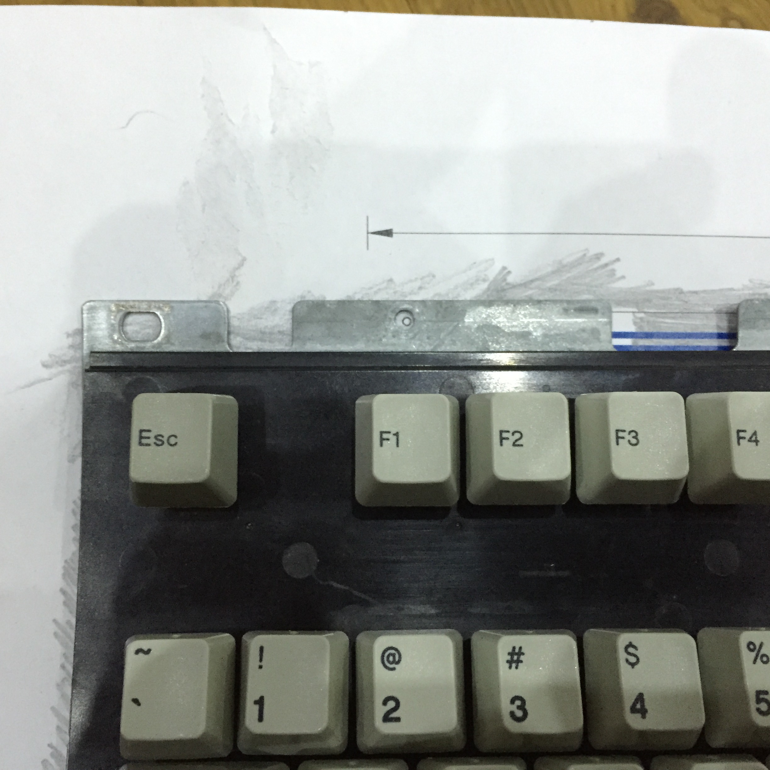

Alright: The following pictures are bad quality. The tripod is stored back. I was on my way to bed
I have placed the paper on the back of the metal plate. Looking down. Using the "pencil" technique that we all used when kids to copy coins I marked where the screws are. I then made holes with the top of the pencil to see where they were.
The results follow:

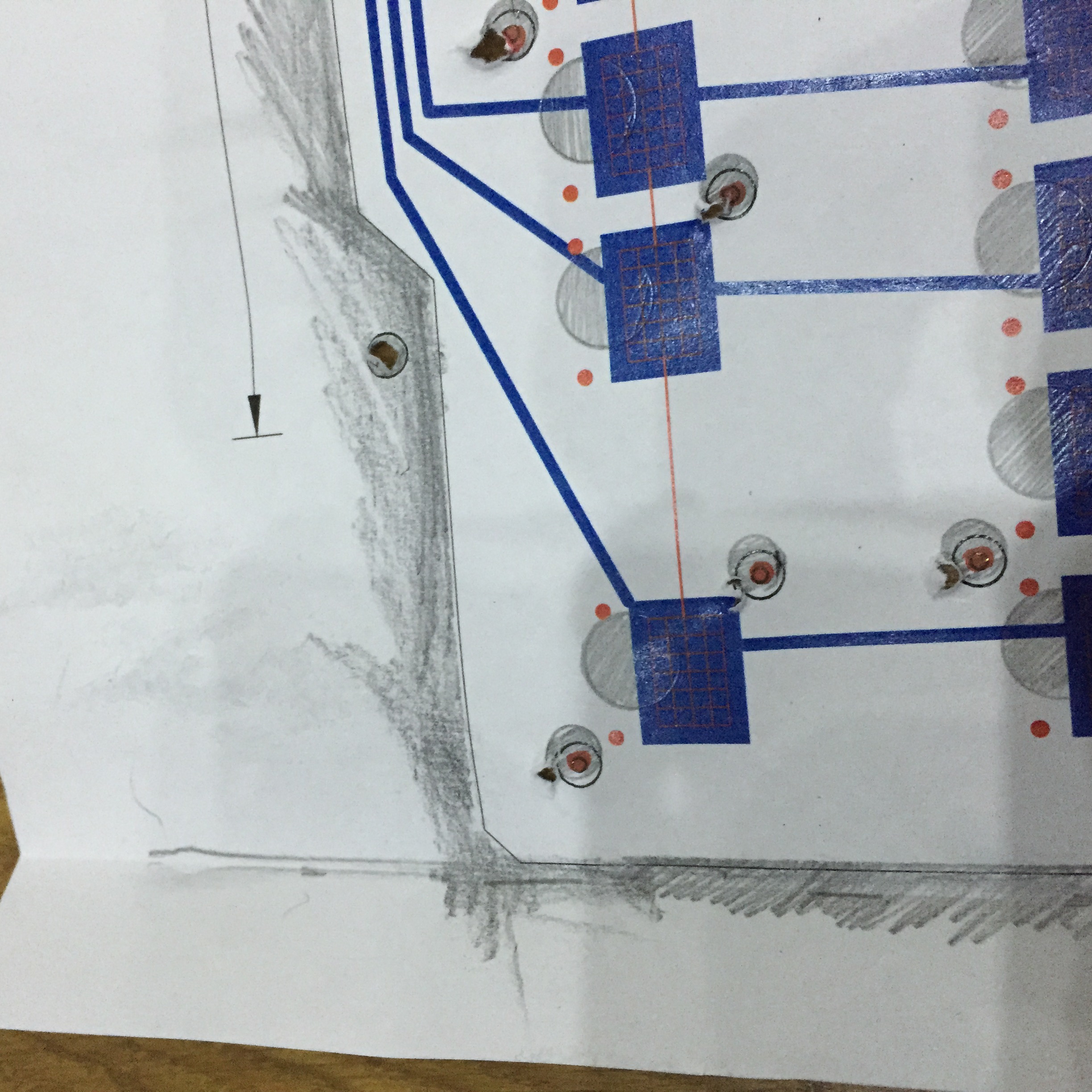

There is some lateral displacement:
More details follow:
Notice the lateral displacement again. I have folded the paper and marked the fold with a dashed line

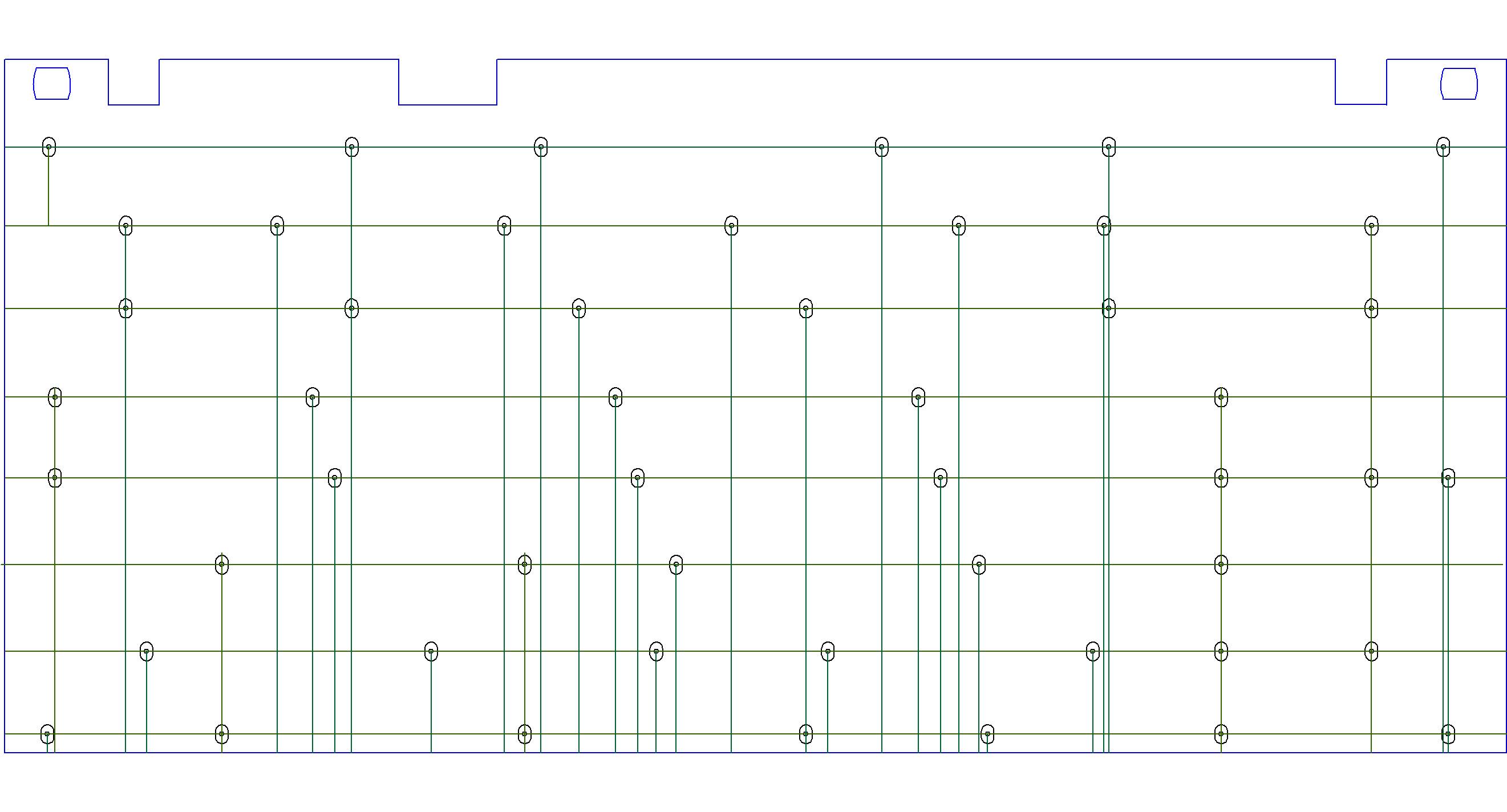

Hello,
I spend some time today to model the holes in the FSSK.
The next step is to paint the pads.
I decided to make my own version so we can compare the two independently made pcbs at the end as a kind of quality control.
There is no logic with these holes. One has just to measure, print and correct. A nightmare.
I need to find some time to continue with this.

In general the file works fine.
The extended model M has he holes in the same order. So I am thinking of creating a CAD file with one extra set of layers to cover the normal model M also:
I need to correct some errors. The holes are only there to avoid routing copper through this area. The plan is to order the PCB without the holes. But we better do things right from the beginning. This needs to be corrected:
I hope to progress this during the weekend. Lets see if we have a full PCB by then.
