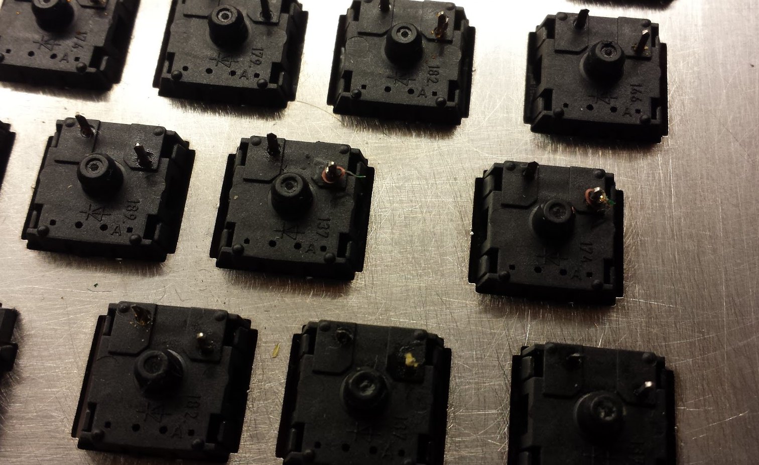

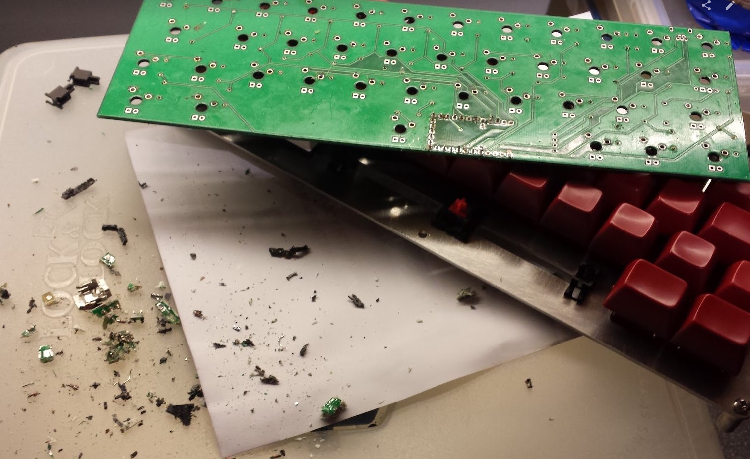

My soldering skills are fairly ninja - although my tools less so. I used de-soldering braid and coated the switch solder points in flux before heating the braid over the solder points to suck up as much solder as possible. The two legs of each switch are different - one is a flat, thin prong and one a square leg. It was quite easy to confirm that all the flat prongs were free by wiggling them and I started to get a little movement in the PCB relative to the switch plate. I probably should have been a little more patient but in the end I levered the PCB off gradually with a reasonable bit of force. The downside of this approach is that some of the pads on the PCB have been lifted where the solder was holding firm on the other side of the board.
The upshot of this is that I will have to manually check connectivity between each switch pad and the other end of the PCB trace, repairing where necessary. At least the diagnostic approach will be very straight forward, if a little laborious.

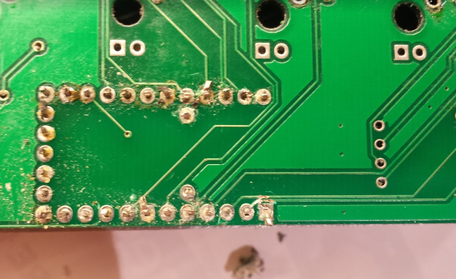

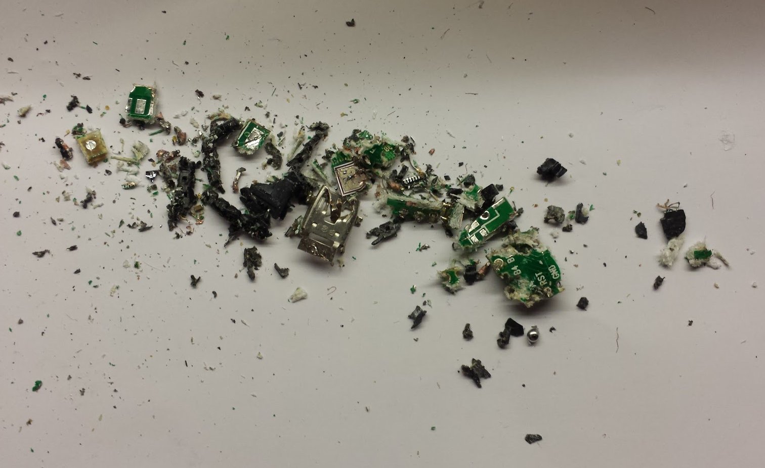

The other interesting part was removing the Teensy. Given the hole sizes and the proximity of the pins at 0.1" pitch I didn't hold much hope out that I would be able to remove it whole. The alternative approach was to work from one end and use a small pair of snips to get in and cut the legs between the Teensy and the JD40 PCB. In the end I resorted to breaking down the Teensy using the snips (well two pairs actually, I broke the first pair!) and then slowly uncovering the individual pins. I have yet to remove them - it is a particularly three-handed job (anyone who has done any soldering knows that the whole process is designed for three handed people at the best of times) so I'll leave it until I've replaced my soldering iron (the end of which just plopped off - thankfully not on to anything to precious!)
I'm pretty sure I have some teensy's kicking around so will be looking to get one back on the board. I should then be able to diagnose each of the PCB switch pads before soldering the whole kabudle back together (and remembering to install the spacebar stabilizer!

With the PCB removed:
Teensy off the board - just the pins remaining:
Copper rings around some of the switch pins indicating where a little too much force was used!
This is what a 'deconstructed' Teensy looks like!
chzel
03 Feb 2016, 01:00
urbancamo wrote: My soldering skills are fairly ninja...
http://lydz25.deviantart.com/art/Ninja- ... -334288378
Poor little teensy...looks like it met the ninja above!

I was also removing a teensy from a board once ... I ended up snipping all the legs through the black plastic that's between the PCBs. Then I had to remove the remains of the pins from both the Teensy and the PCB - but I actually ended up with a functional Teensy. I also lifted some pads.
BTW this is how you can tell cheap PCBs from the better ones - the better ones (apart from usually being ENIG plated - the contacts look golden) survive desoldering a few times even after a few years.
Finally - I recommend getting at least a solder sucker (a.k.a. desoldering pump) for desoldering switches - I've used both a braid and a sucker and I can tell you that it's way easier with a sucker.
