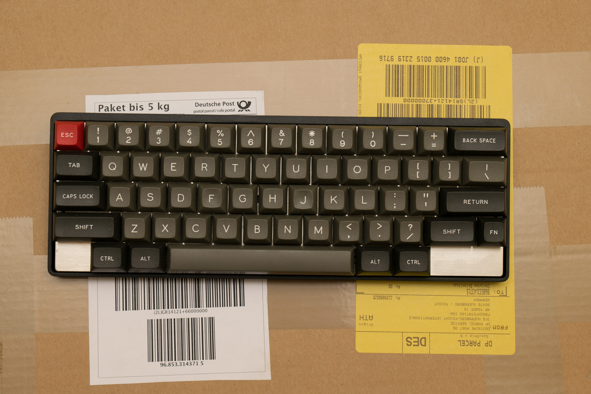

My Alps Party order
I can't imagine how far this package has traveled. The box looked incredibly beaten and the plate was slight bent/twisted in the top right corner. I covered the bent with a towel and gently hammered it back to place (well, it's still kinda bent but it's not very noticeable).
PCB: 60% Hasu Alps PCB
Plate: HHKB style blue plate. I don't remember ordering it blue but I don't really care
Switches: 70x Matias Linear Switches
Diodes
Diodes
I thought everything came pre-soldered but apparently not the diodes. I had never soldered diodes but a quick google showed me what had to be done. The main thing that I learned was:
- The diode should be facing the case and the pins should be facing the plate
- Orientation matters
- One of the diode holes is a square and the other is a circle. I made sure the black part of the diode was always facing the square.
- The diode pins are huge so you have to clip them
Another thing I learned is that soldering the diodes before clipping is not a very good idea. My soldering came out so bad that I don't dare showing it.
Testing the diodes seemed like a crucial thing so do so I used this ghetto setup
I connected the PCB to my computer and used the "Switch Hitter" software you can download from EliteKeyboars. Then I used a solder wire to connect the two switch holes, lighting up the key I "pressed" in the software. It's kinda rudimentary but it's a fast way to test it. I found out I forgot to solder one diode pin. Upsy.
Switches
I proceeded to mount and solder the switches. Everything went great
That K11 switch had a bet pin that I didn't realize until I started soldering. Doh!
After soldering everything I went back to the Switch Hitter software and tested everything again. Fortunately it all worked great.
Case
All that was left was to add the case. I used a wood case I got from massdrop.
It's not ideal because the case doesn't cover the missing keys from the HHKB layout but it looks very pretty. It also looks amazing on my desk!
What's left
  1. I am yet to flash the correct HHKB layout to the keyboard. I have never done this before so I will have to search a bit before doing it.
  2. I have received some stabilizers from Matias' website but I haven't really opened the package yet.
  3. I ordered the Alpine Winter keycaps but apparently there was a problem with the keycap profiles and all orders are being produced AGAIN. I have asked the GB leader the ship me the defective keycaps anyway, I just can't wait to actually try this keyboard!
