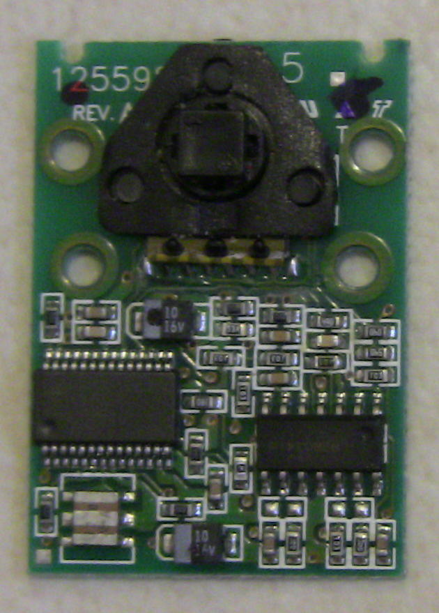

For a start, this is the first one I came across:
According to the seller, it's from a keyboard for the ThinkPad A22p, also compatible with A20, A21, A22 (none of which I can confirm). I think this is a common type, since it also appears in Suka's DIY keyboards (look at his thread for the electrical pinout). As far as mounting is concerned, here are my measurements:
- The trackpoint reaches through an 8mm hole in the keyboard "plate" from underneath.
- On the original keyboard, there is a space of 2mm between the bottom of the keyboard plate and the top of the PCB, so that the black triangular part (whose top is some kind of foam or rubber) is pushed against the keyboard plate when installed.
- Two of the mounting holes (ø2.5mm) are in a line with the trackpoint, at a distance of 10.5mm to either side of it.
- The other two (also ø2.5mm) are 19mm apart, 8mm across from the trackpoint (down in the photo).
ħ

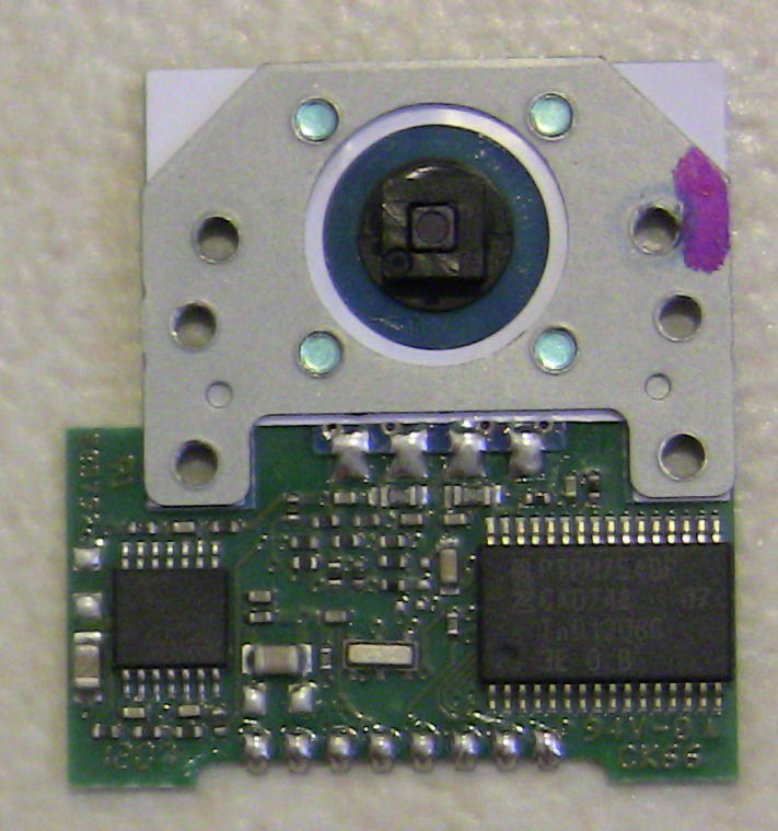

Here's the second one:
It's from a chiclet keyboard, apparently for the W530, T530, T430, T430s, X230, therefore of newer date than the previous one. It's still based on the TPM754, so I guess it has the same electronic interface (except maybe the pinout).
Here are measurements:
- The hole in the keyboard plate is still ø8mm.
- This time, the device was mounted using two screws (apparently M2, thread pitch unknown) from the top of the keyboard, using the threaded holes on either side of the trackpoint. Their distance is 19mm.
- There are four more threaded holes, same thread, 20.9mm apart horizontally (in photo), about 3.5mm and 9.5mm from line of the other two.
- The metal plate with the threaded holes is designed to be in contact with the keyboard plate, no spacer required this time.
That's what I have for now.
