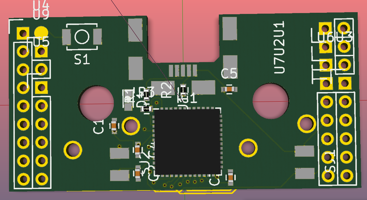

Can we design the teensy alternative for keyboards?

quick update.
MD might be also interested at selling this controller, of course they wouldn't have exclusivity and we will still produce the needed boards for ourselves but that would let us reach higher tiers (=lower costs).
In addition to that I was thinking we could also design 3-4 barebone keyboard PCBs compatible with our controller. Basically you plug in the controller and you get a fully functional PCB. Would be nice to have a standard 60% (possibly alps/mx), maybe a 65% or 75% and so on.
also, would it be possible to design the ELF board pinout for kicad? we could offer that as well I guess
mohitgarg
10 May 2016, 10:05
I'll be travelling because of work this week, but I should be able to have the PCB done on this weekend.
Regarding the barebones PCBs, It should be possible and specially with the controller sorted out, it should be a quick job. I'd like to concentrate my efforts on the ELF this weekend, I can then look to design ELF-TKL, ELF-60, ELF-65, ELF-75. About the 60/65/75, what are your thoughts on one single PCB, with breakable (Might need a bit of sawing) top row and right-most column.
Regarding the pinout, currently the pins on the last design consist of various KiCAD components. However now that the new layout seems to be figured out, I was thinking of using one large component. This can easily be exported and made available for use, along with a nice illustration of the pin-outs.
-[°_°]-

pomk
10 May 2016, 14:05
Hi all, I've been following this thread closely and I wonder if something like this could be useful?
I did not route it beyond checking that it's probably doable with some component position fine-tuning, as routing this would take some time :lol: . I used 2mm pin headers and a mid-mounted USB connector, the same that is used in a number of Samsung phones. It fits neatly under a 2u space and can be directly mounted to two switches. Alternatively it could be fixed with some screws through the same holes. Some consideration should be taken as to how the mounted switches should be connected if a hand wired design is used.
I'm a bit late to the party, but hopefully this can give out some inspiration, or laughs :D .
edit: just noticed that I have the smd components on the wrong side :?

pomk wrote: Hi all, I've been following this thread closely and I wonder if something like this could be useful?
This is an interesting concept. What are the exact dimension of this board? You would also need to consider other switch orientations (namely upside down :)) and compatibility with alps.

flabbergast
10 May 2016, 19:03
I've been busy with work&family recently, but I may have some time later this week. I can take a stab at the controller (if Mohit agrees :)
mohitgarg
10 May 2016, 20:24
I've got the pin layout created as a component and the schematics updated as well. I'll upload to the GitHub repo later today.

mohitgarg
11 May 2016, 14:45
It was considerably easier to route this because of the larger area. I'll upload this to the Git soon. If you want we can fit the logo on the front as well. Dimensions are 38.1 x 17.78 (+2.9718) mm
-[°_°]-
11 May 2016, 15:30
wouldn't printing on 2 sides be more expensive? I would also add "https://elf.io" and the board revision. "Elf 1.0 - https://elf.io" (all people involved will be credited on the website of course)
Apart from that the only thing that worries me a little is 38.1mm width
