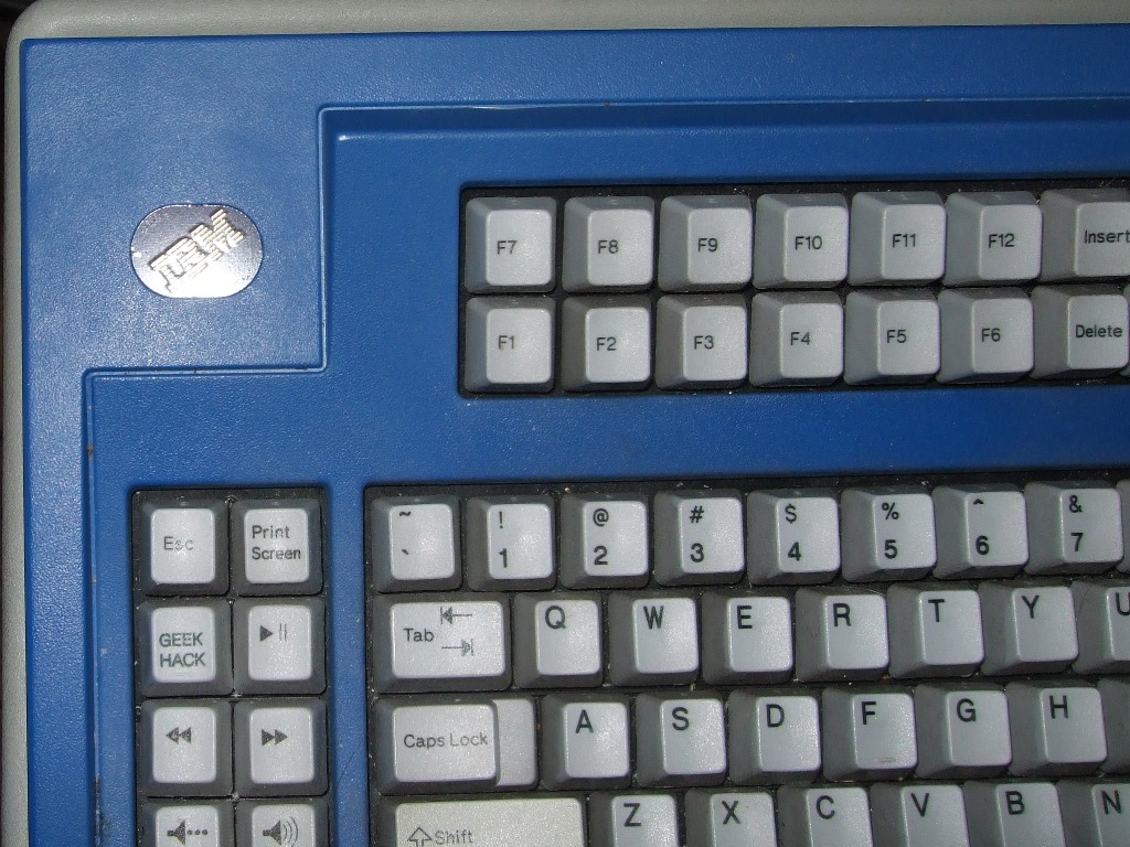

I'd be interested too, but they don't look to be particularly close replicas of the badge; the logo does not appear to be raised like on an original badge, it looks like there is just a bevel around the entire logo.
I think it would help to get photos of the side profile.

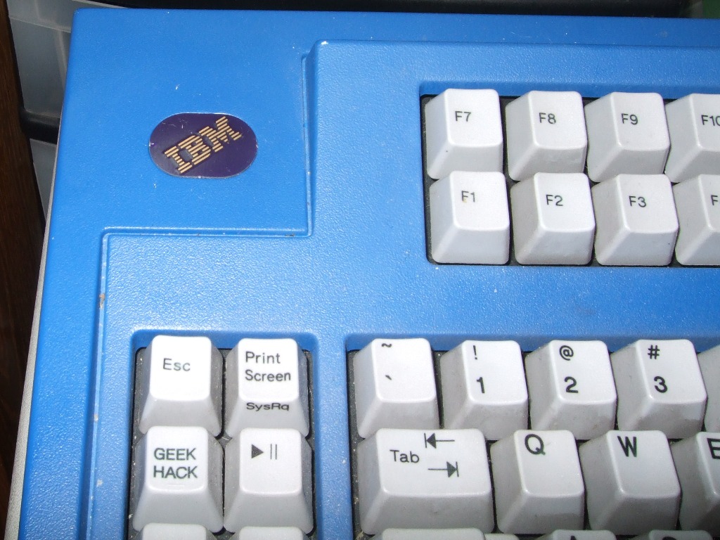

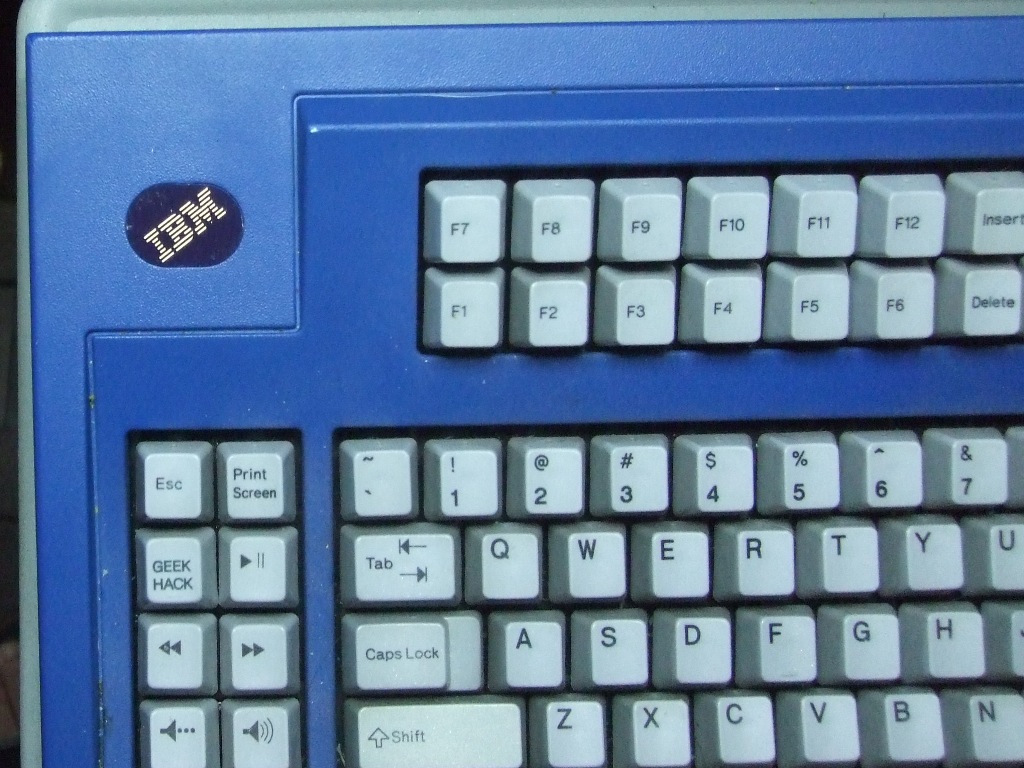

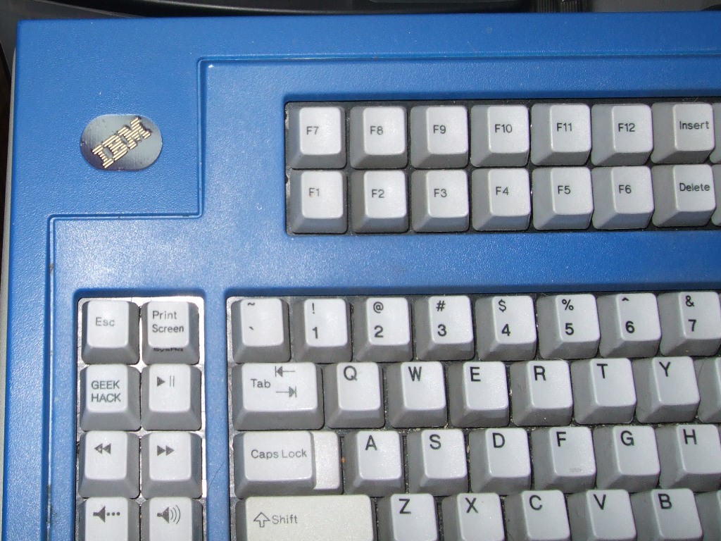

Update:
wcass wrote: The zip file below is what i sent to OshPark. If you send them this same file, you will get a couple of warnings that the there is no drill file, bottom mask, bottom copper, silkscreen - this is normal as this doesn't have any of those things; check the box that says "continue anyway". When you get to the "Cart", check the option for "2 oz copper, 0.8mm thickness". The text will be gold and the mask will be dark purple - same as in these pictures. The price it shows is the price delivered. Mine arrived about 3 weeks after i placed the order, but i have heard that international delivery can add a few additional weeks.
If you order from another vendor, delivery will likely be quicker (even coming from China) and edge quality will likely be much better. You also have options for PCB thickness (.06 would be a good option), mask color (lots), and text color (HASL for silver, ENIG for gold).
Now the question is ... what to use to stick it on the case?
I had time to dig out my Dremel and i cleaned up the edges some. Here are some quick pictures.

Something like rubber cement or double-sided tape would make removal easier, but if you are sure then hard glue or epoxy.
PS - I use naptha (old-fashioned cigarette lighter fluid) to remove the original labels - but work quickly and clean up thoroughly because naptha is harsh and you don't want it sitting on a plastic surface for any length of time.

Is there a cover or film remaining on the badge seebart? I looks like it in the picture.
